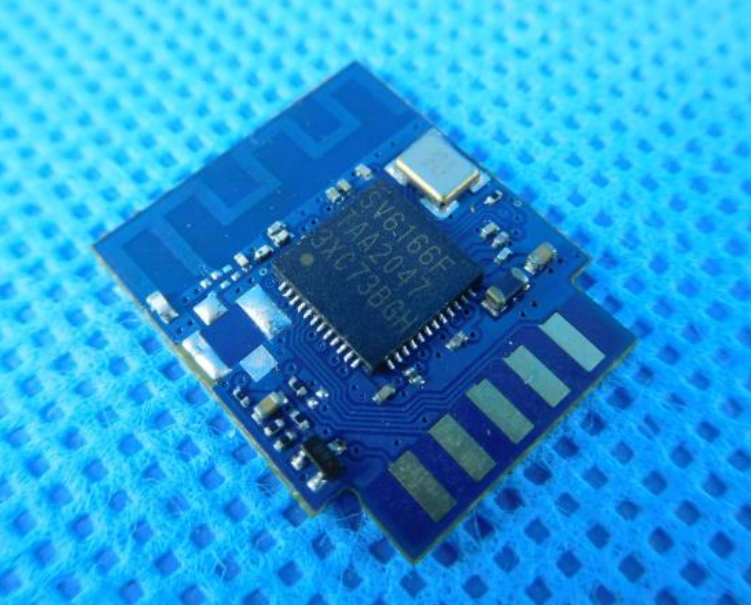

    The MCU is an Icomm-Semi SV6166F (aka CKW04) - the subject of previous musings here https://www.elektroda.com/rtvforum/topic4086605.html
    Module RE705-MB-v0.1 also seen here and probably in a few other Sonoff devices: https://fcc.report/FCC-ID/2APN5B02FA19/5455362
    The ESOP8 chip is a Reactor-Micro RM9012GB LED driver - datasheet attached

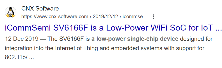

    Interesting, I've known Sonoff products for BL602 usage, but not for SV6166F. Still, SV6166F doesn't seem to be new, I see mentions dating back to 2019:
    Google search result showing an article about the iCommSemi SV6166F, a low-power WiFi SoC for IoT.
    See: https://www.cnx-software.com/2019/12/12/icomm...-andes-risc-soc-for-iot-and-embedded-systems/

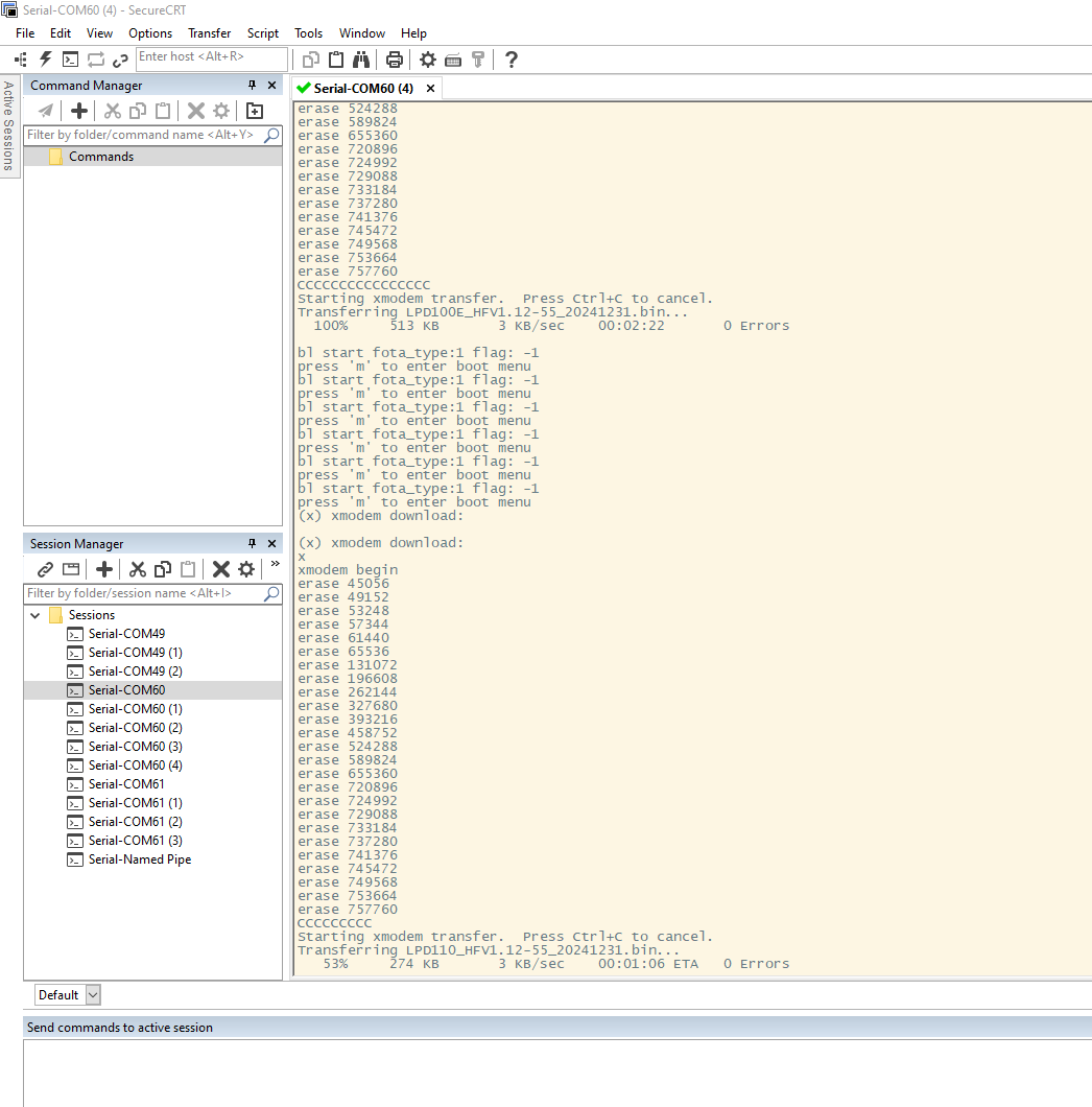

    yes indeed.
    I'm sending various HF firmware to it now to see which boot if any
    Screenshot of SecureCRT software displaying a binary file transfer over a serial port using the Xmodem protocol.
    Added after 18 [minutes]:

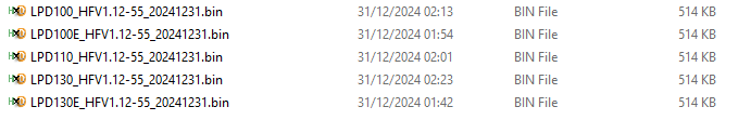

    these do not
    A list of five firmware BIN files starting with LPD, showing name, date, type, and size details.

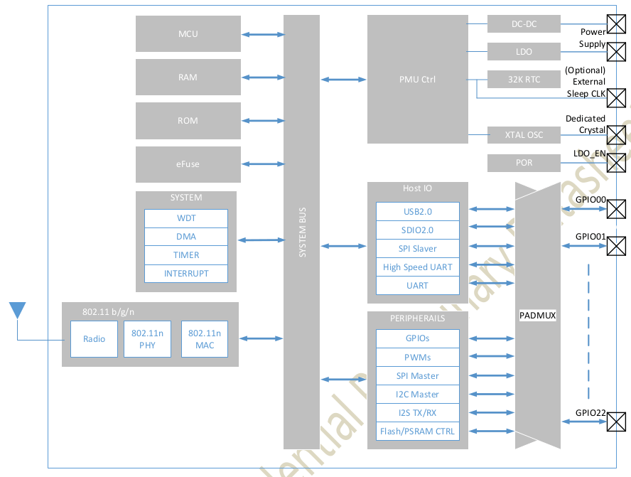

    What is DP, DM? For a moment I hoped for USB, but I see no mentions of that on the diagram:
    Block diagram of a Wi-Fi module with interfaces, memory, power, and I/O connections.

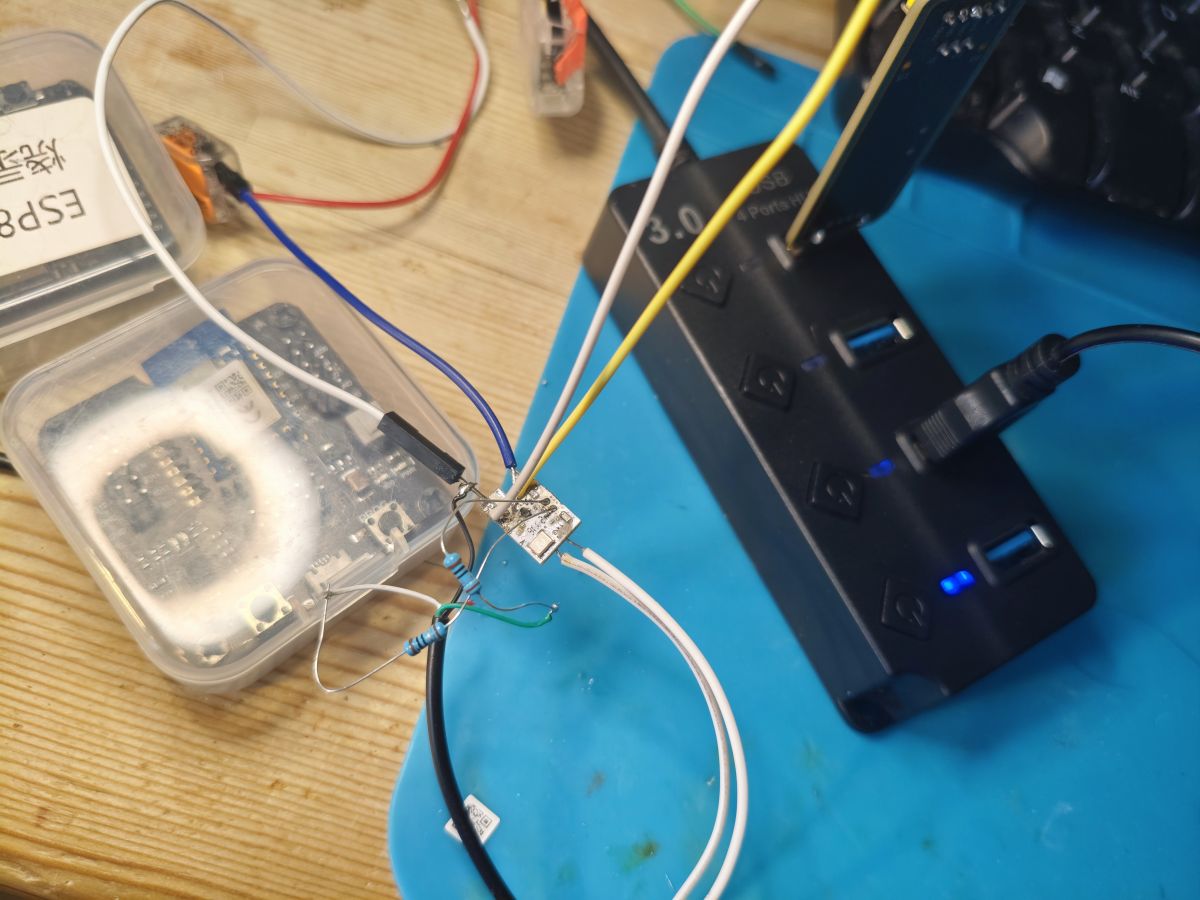

    With that USB program in mind, I hooked up D- and D+ pads to a USB cable I cut up in the hope it would detect as something, even an unknown device, in Windows for use with that program. That seemed like the most likely way I could read the flash and then maybe flash whole chip, including BL, if necessary. Sadly nothing was detected.
    I have not been able to find a firmware dump from a proper Sonoff SV6166F device - yet.
    Added after 56 [minutes]:
    yes. I think I should focus on the USB function. Also, why are GPIO14/15 exposed as test pads on this module? What purpose do they serve? Could pulling one, the other, or both low put it into USB download mode or something? I'll investigate.
    Added after 35 [minutes]:
    the module might actually be by Shenzhen Water World Co., Ltd. There are other RE7xx modules in FCC docs with SV6166F chips https://fcc.report/company/Shenzhen-Water-World-Co-L-T-D
    eg the RE730 https://fcc.report/FCC-ID/2AYCN-RE730
    Blue Sonoff SV6166F electronic module with visible chip, traces, and antenna, placed on an anti-static mat.
    Added after 8 [hours] 49 [minutes]:
    this curious arrangement is HSDP/HSDM to USB via 10ohm resistor, TX/RX to terminal and tails for GPIO14/15. No sign of any USB life in Windows with any GPIOs tried low

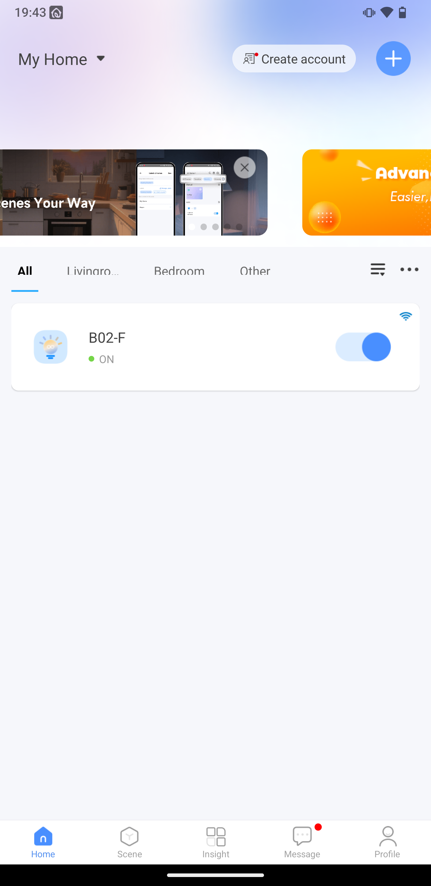

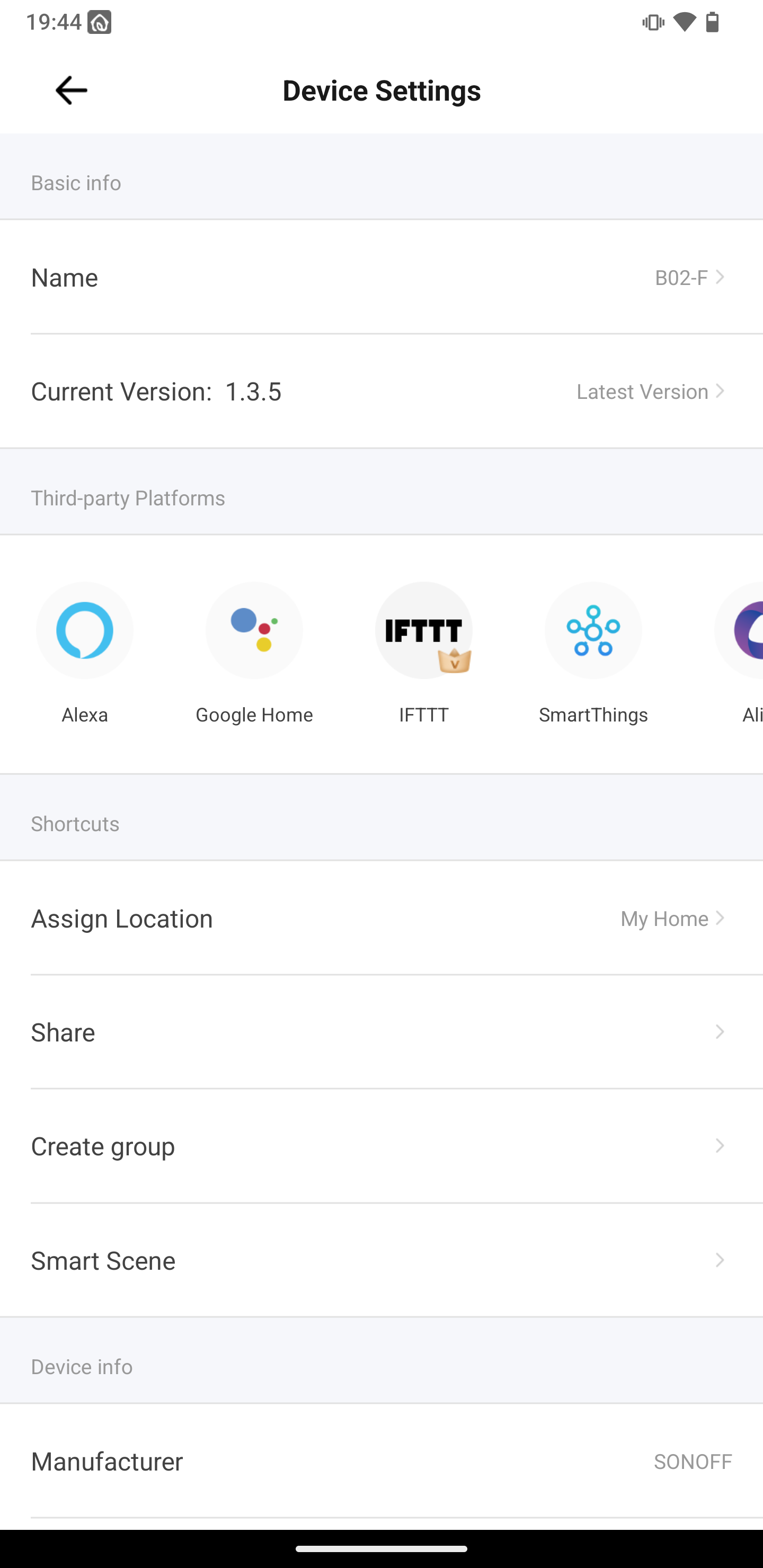

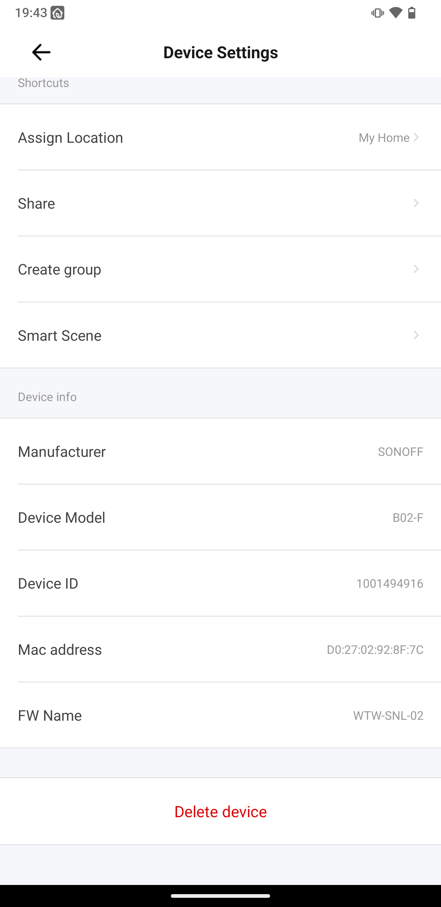

  • Paired with eWeLink app and WTW-SNL-02
    #6 21532820
    Posts: 5195
    Help: 446
    Rate: 913

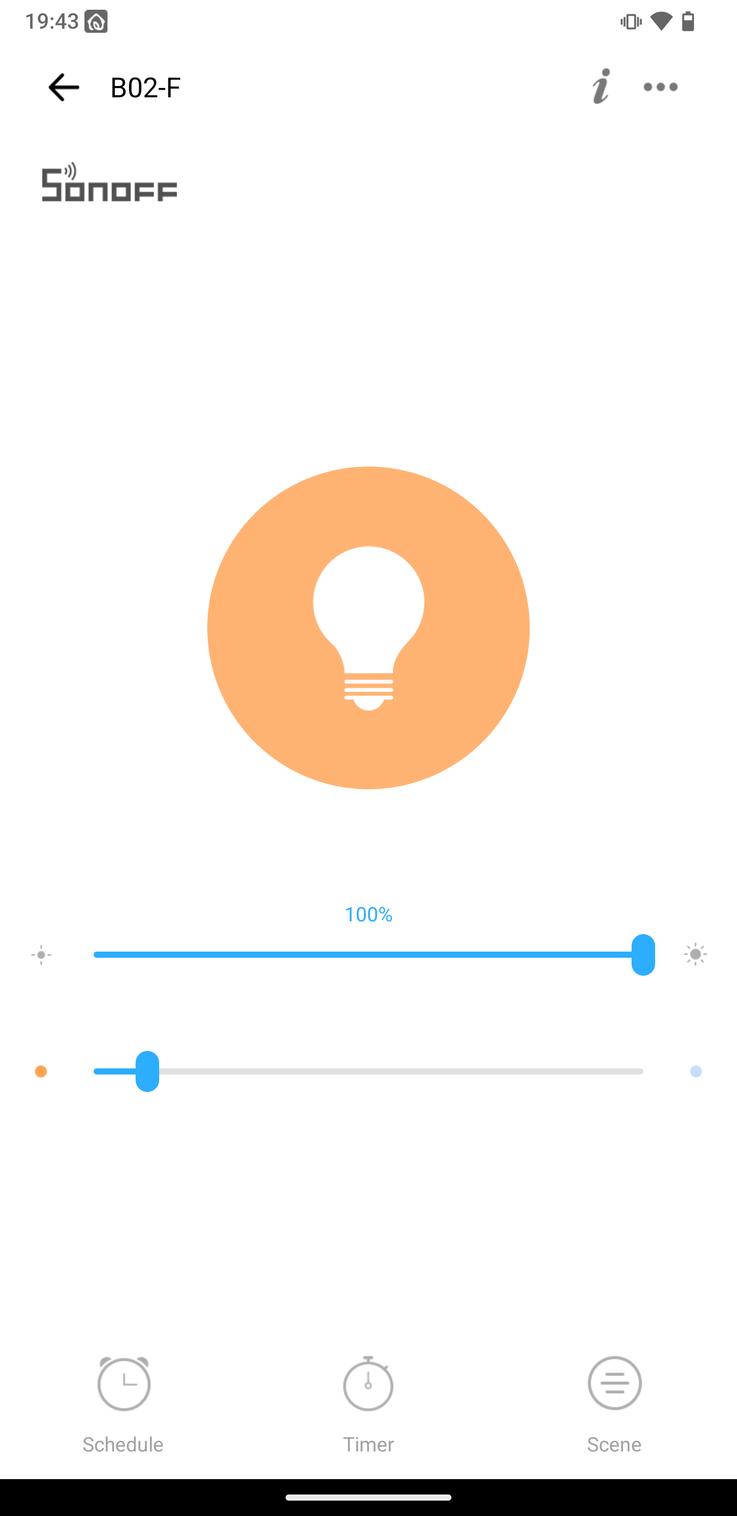

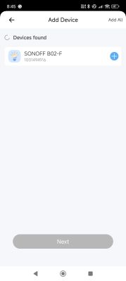

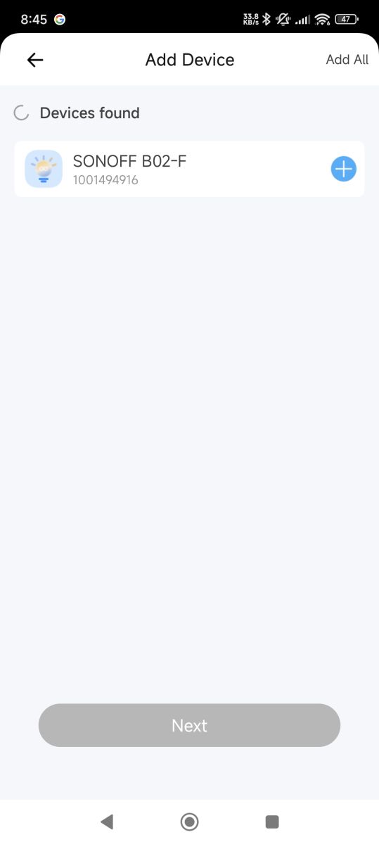

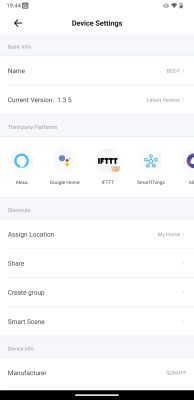

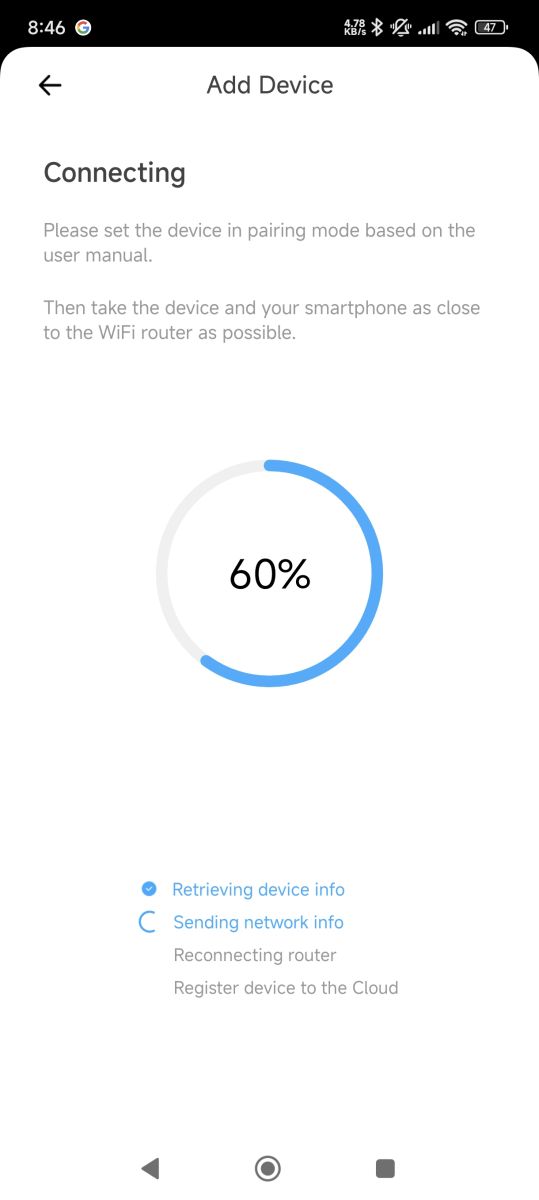

    eWeLink app screen showing found device SONOFF B02-F ready to add. App screen showing device pairing progress with Wi-Fi, including a 60% circular progress bar. Screenshot of the eWeLink app showing device B02-F turned ON in the My Home section. eWeLink app screen controlling a Sonoff bulb, with the brightness slider set to 100%. Device settings screen in the eWeLink app showing details for a SONOFF B02-F smart device. Device settings screen in the eWeLink app, displaying details for a SONOFF device.
    WTW-SNL-02

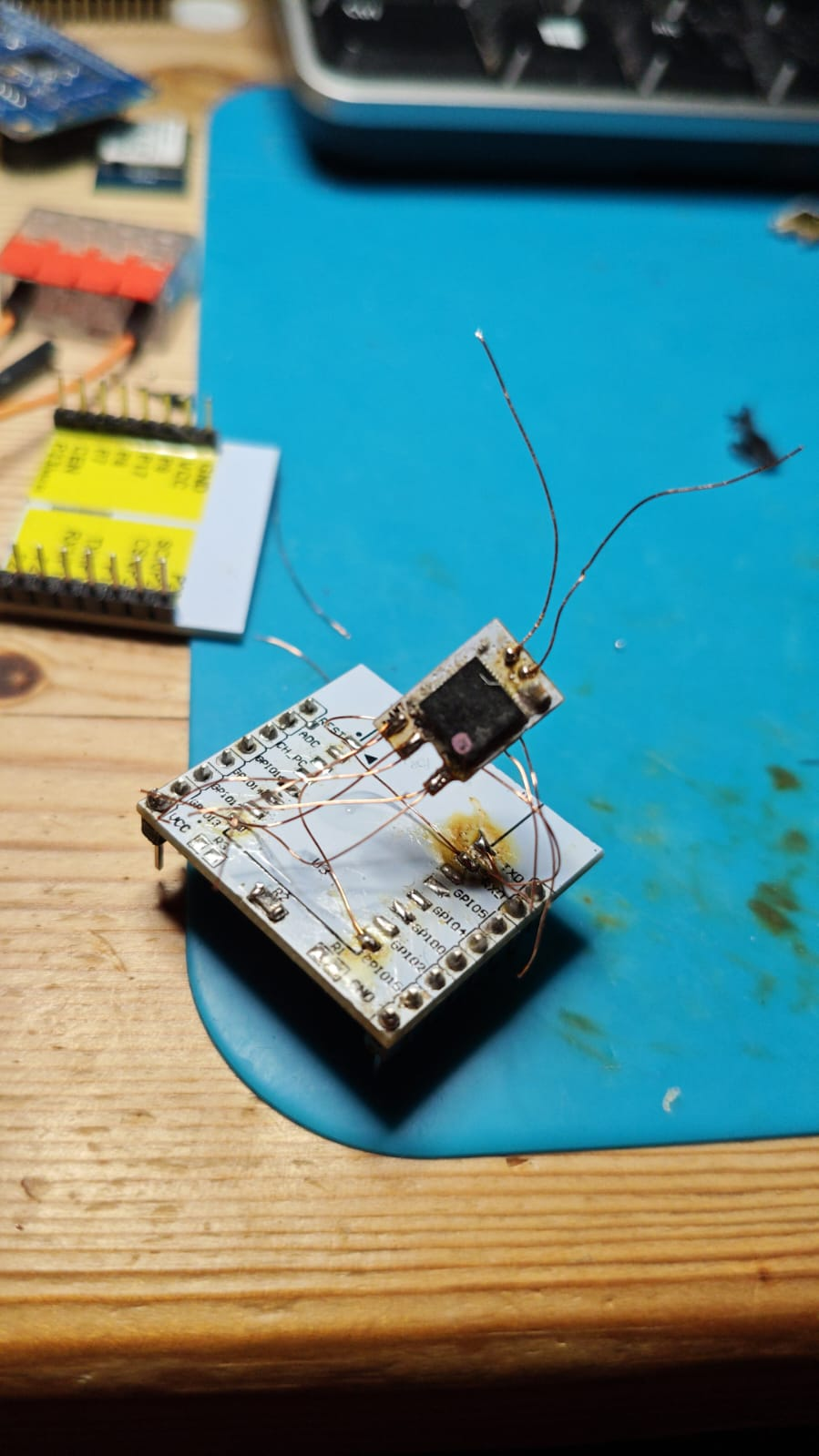

    made this little SV6166F monster. ITEAD firmware in tact on this one.
    Small circuit board with thin wires and a scorched component on a blue work mat
    exploring flash dump options further.
    AT response is something new:
