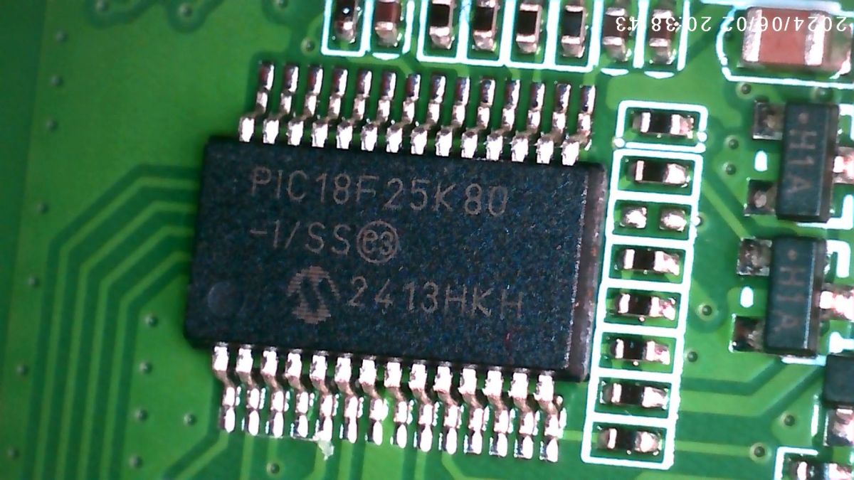

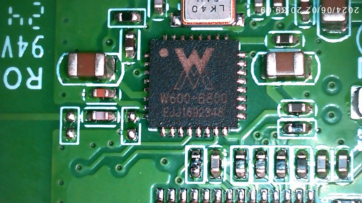

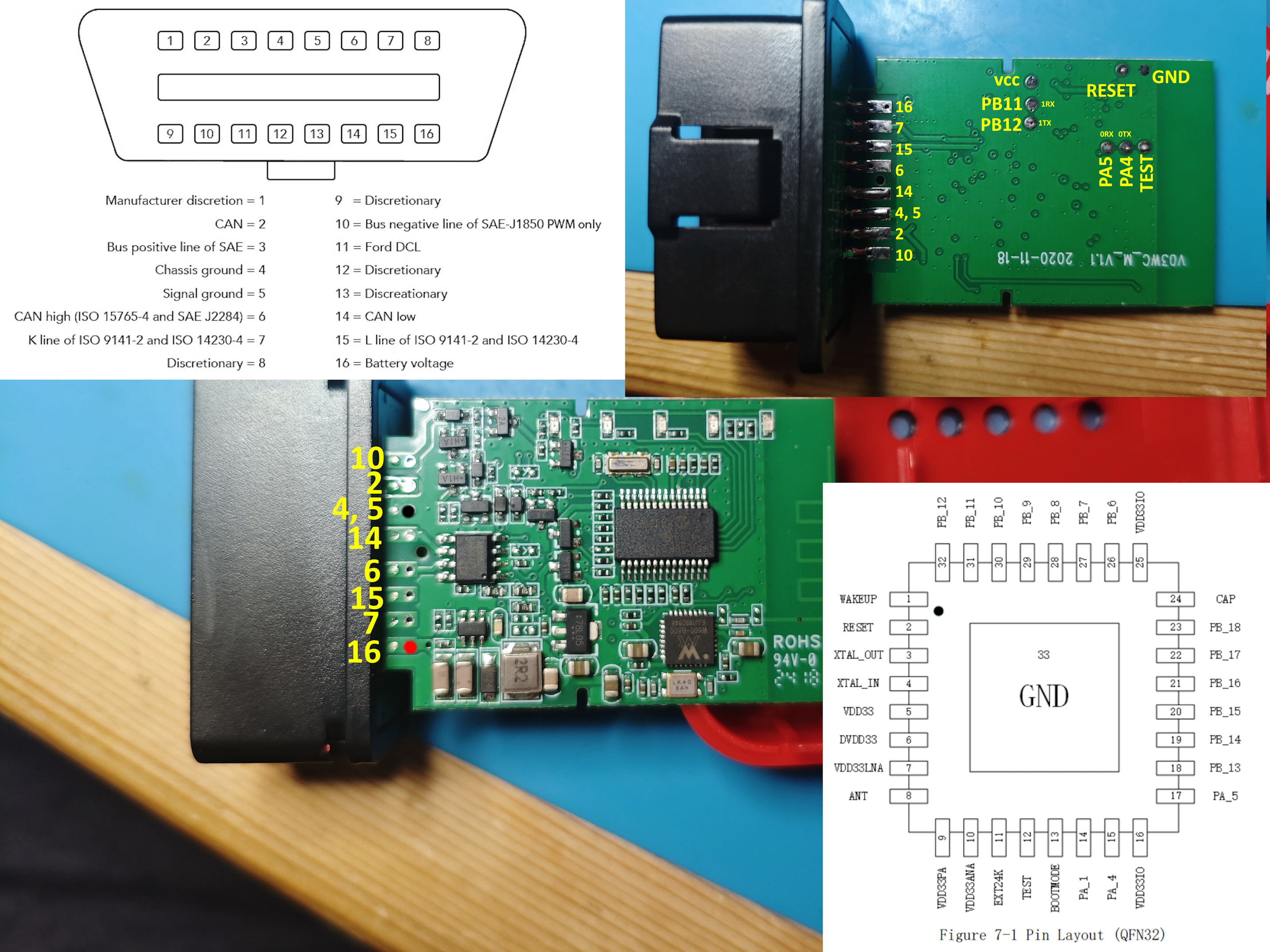

    Here's another ELM327 I got just to see what was inside.
    ELM327 V1.5 OBD2 diagnostic interface with WinnerMicro chip.
    It's a WinnerMicro W600-B800!
    Close-up of the WinnerMicro W600-B800 chip on a printed circuit board. Close-up of PIC18F25K80 integrated circuit on a green printed circuit board. Close-up of an integrated circuit on a printed circuit board, marked ST1040.
    and from 0TX:

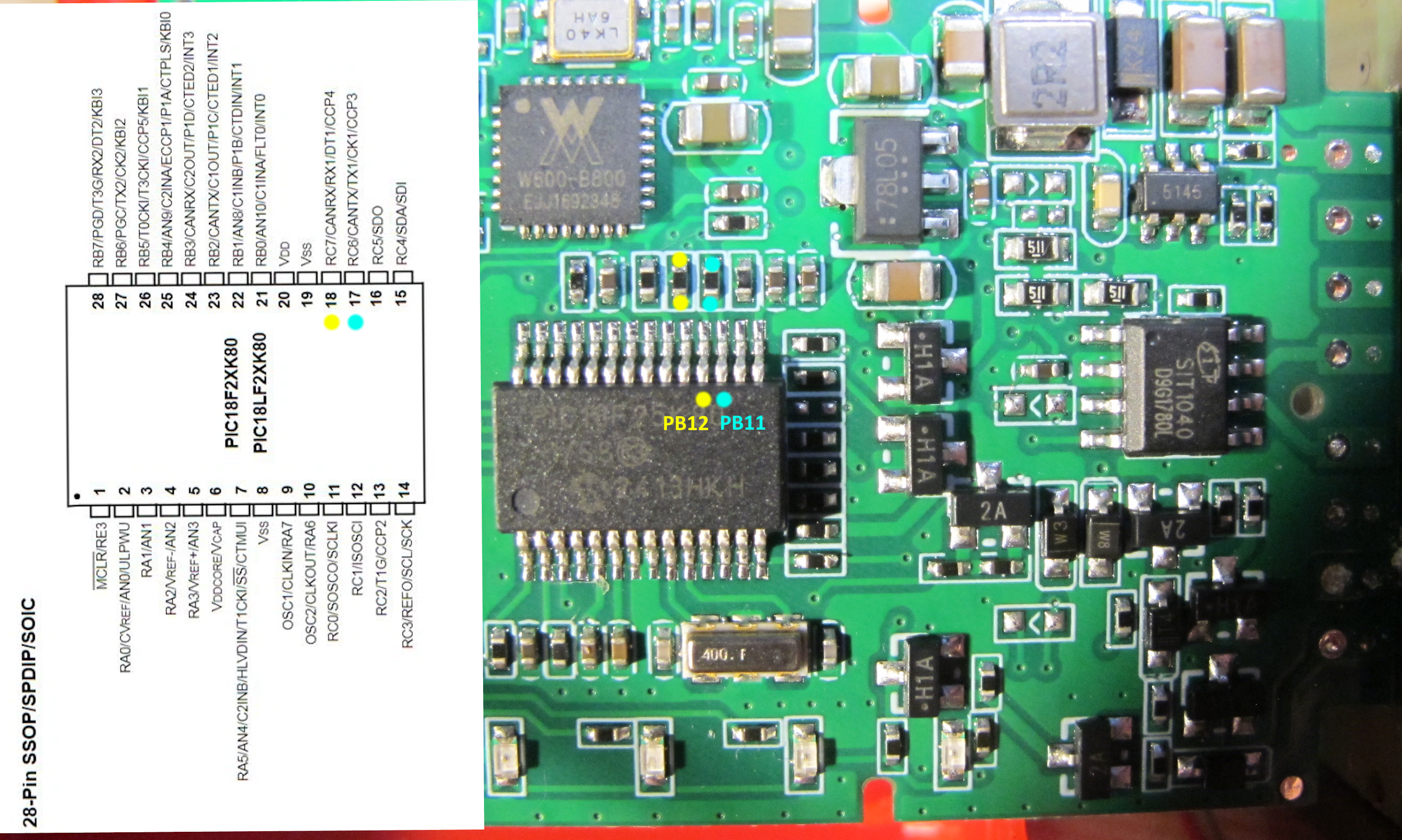

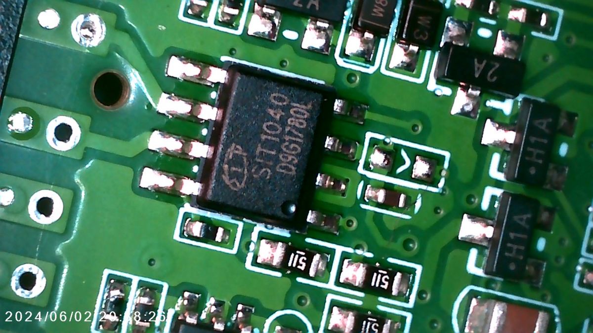

    Test pads and OBD2 connectors traced:
    Image showing the interior of an ELM327 interface with pin labels and a circuit diagram.
    I don't think there's any way to backup the firmware of the W600 so as soon as I try flashing OpenW600, the device is no longer any use as an OBD2 reader. I think I will anyway, even though it cannot be used for much after.
    PCB keywords:
    V02-1_S 2017-09-28 Ver:1.2
    V03WC_M_V1.1 2020-11-18
    • SIT1040-V1.7_en.pdf (1.28 MB) You must be logged in to download this attachment.
    • W600-Datasheet.pdf (760.56 KB) You must be logged in to download this attachment.

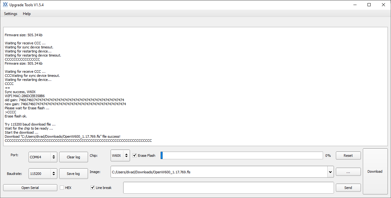

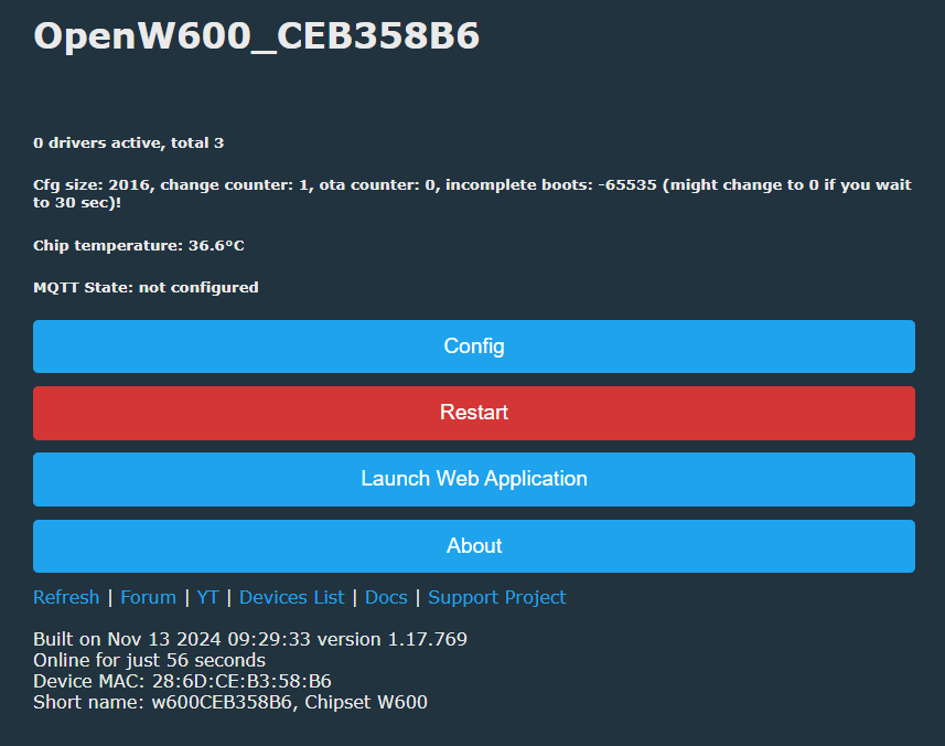

    Screenshot of OpenW600 interface with buttons and system information. Interface of Upgrade Tools V1.5.4 showing firmware update process.
    flashed over PA4/5
    Added after 1 [hours] 39 [minutes]:
    and PB11 and PB12 UART of the W600 traces to these legs of the PIC18F25K80 via resistors
    Image of a circuit board featuring integrated circuits, including PIC18F25K80 and W600, with connections PB11 and PB12 marked.

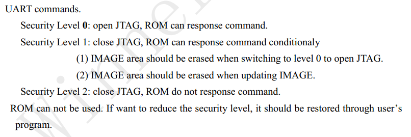

  • W600 ROM query shows security level 0
    #24 21814867
    Posts: 5212
    Help: 446
    Rate: 914

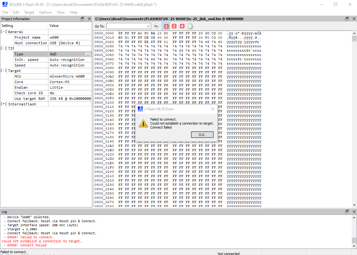

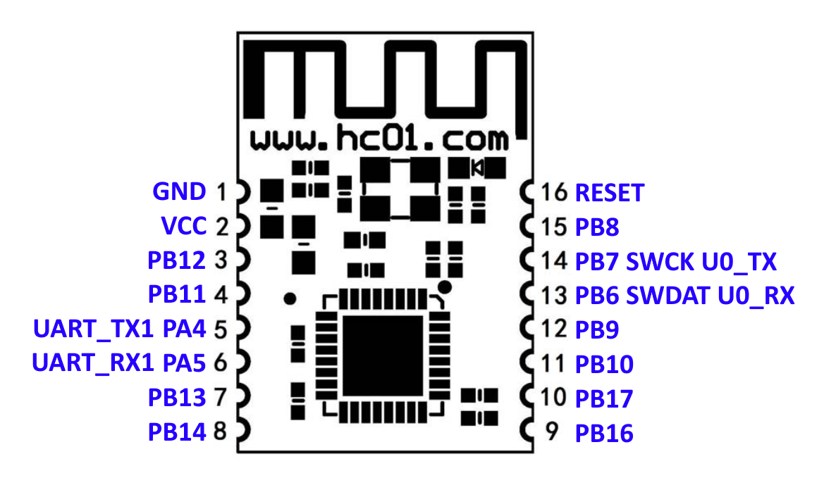

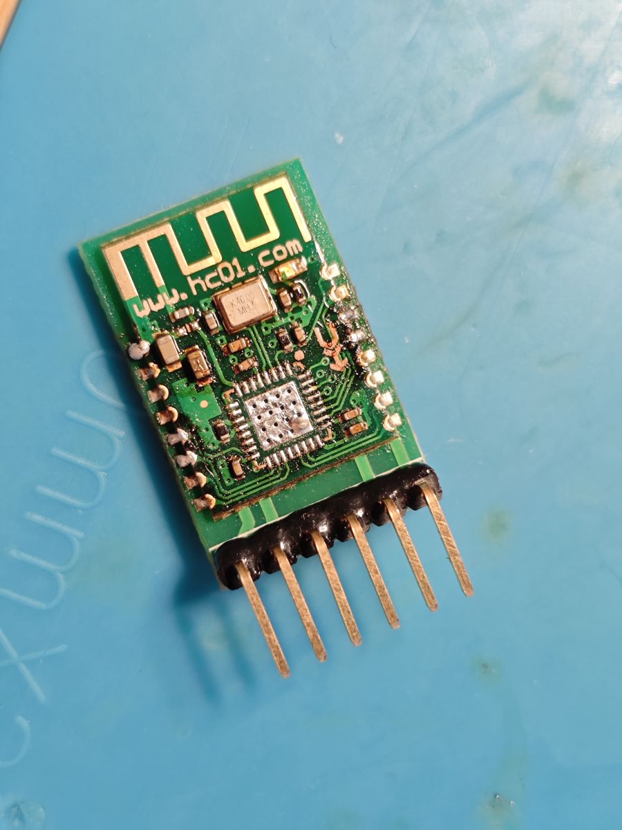

    darn. I transplanted W600 from ELM327 onto the HC-25 for easier SWD dumping but I think maybe SWD is disabled in efuse or something.
    HC-05 Bluetooth module with IC and pin header on blue background
    There is continuity to IC legs and I checked Jlink connected OK still with original chip. WiFi_OBDII AP broadcasts so it's working.
    I was really hoping to get a dump of the OBDII W600 fw
    Connection error in SEGGER J-Flash V8.30 with hexadecimal memory view
    HC-01 wireless module with labeled GPIO and UART interface pins

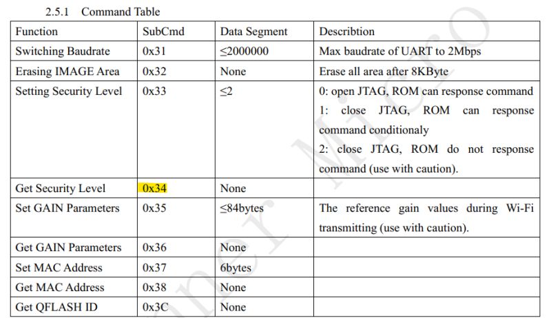

    Added after 9 [hours] 54 [minutes]:
    testing Python thing to query ROM about security level. This is on Air602
    as one would expect on the Air602, [0x34] 'S:0' shows security level to be least restrictive.
    Command table from documentation with “Get Security Level 0x34” highlighted
    Documentation excerpt listing UART/JTAG security levels 0–2 and whether ROM responds to commands
  • PA0 boot mode exposes open JTAG access
    #25 21815929
    Posts: 5212
    Help: 446
    Rate: 914
    holding PA0 down at power-on means rom mode and no secboot. here we can get a response to 38, 34 and 3c. Seems to show the OBDII W600 is not locked:
