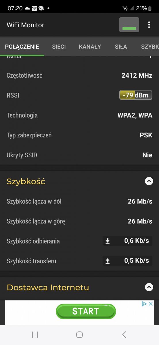

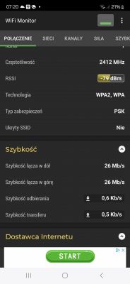

  • #2 21325874
  • #3 21326091
    pioooo9999
    Posts: 11
    Shows -79 dB. Sonoff Mini R2 - device disappears from eWeLink app, is it a coverage issue? .
  • Weak Wi‑Fi signal likely causing Sonoff R2 dropouts
    #4 21326136

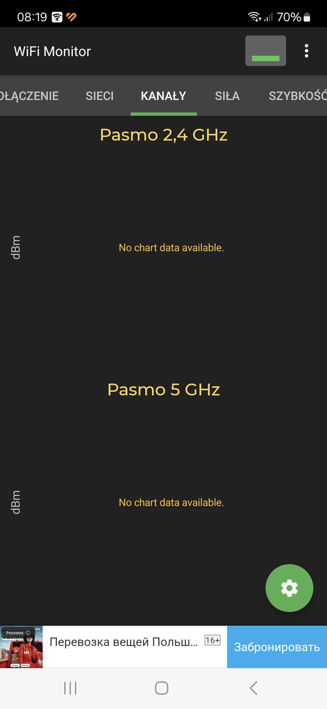

  • #5 21327287
    pioooo9999
    Posts: 11
    R2 is in a small switchboard, also separated by only thin plastic.
    • Sonoff Mini R2 - device disappears from eWeLink app, is it a coverage issue? Screenshot_20241201_081950_WiFi Monitor.jpg (123.57 KB) You must be logged in to download this attachment.
  • #6 21327543

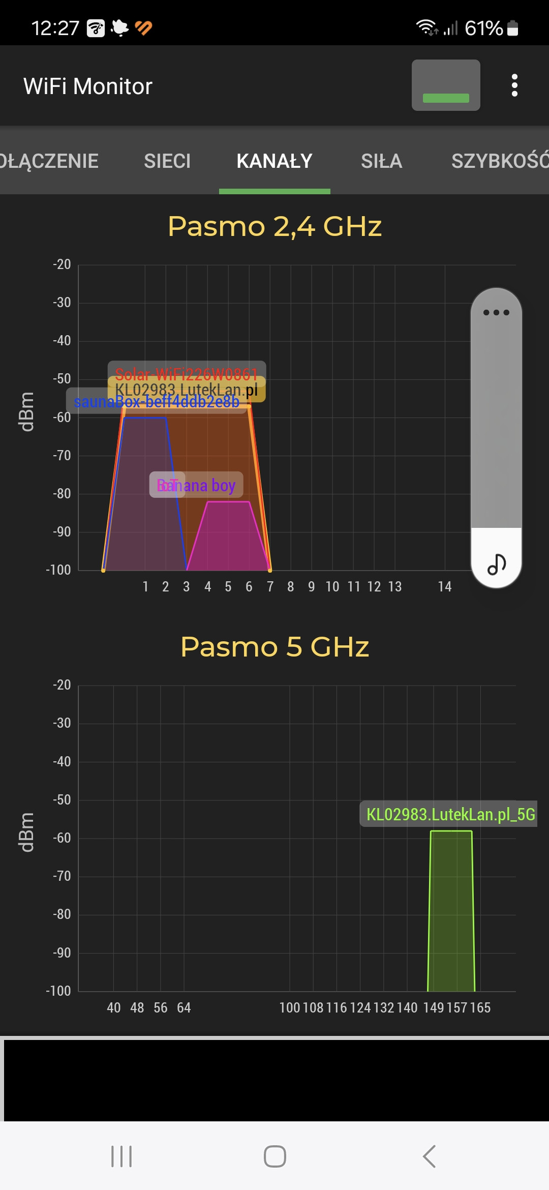

  • #7 21327559
    pioooo9999
    Posts: 11
    This is what it looks like...
    • Sonoff Mini R2 - device disappears from eWeLink app, is it a coverage issue? Screenshot_20241201_122737_WiFi Monitor.jpg (192.06 KB) You must be logged in to download this attachment.
  • #8 21327758
  • #9 21327773
    pioooo9999
    Posts: 11
    How do I move them away?

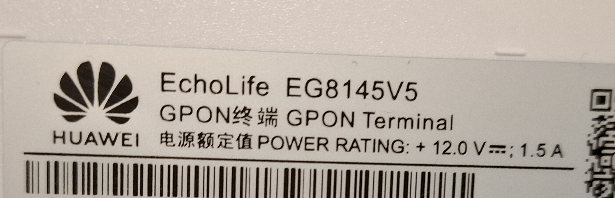

  • #10 21327782
  • #11 21328134
    pioooo9999
    Posts: 11
    It is a Huaweii router.
    My network is luteklan while solar is an inverter from photovoltaic.
    • Sonoff Mini R2 - device disappears from eWeLink app, is it a coverage issue? 20241201_185456.jpg (281.45 KB) You must be logged in to download this attachment.
  • #12 21328223
A Sonoff Mini R2 device located approximately 15 meters from a Huawei router on a 2.4 GHz Wi-Fi network intermittently disappears from the eWeLink app and cannot be manually controlled, although scheduled commands execute correctly. Signal strength measured near the device is around -79 to -80 dBm, which is weak but potentially still functional for low-data IoT devices. The device is installed inside a small switchboard behind thin plastic, which may further attenuate the Wi-Fi signal. Multiple Wi-Fi networks overlap on the same channel, causing interference. It is recommended to access the Huawei router's WLAN settings and change the Wi-Fi channel, preferably to channel 9, to reduce channel overlap and improve connectivity stability for the Sonoff Mini R2.
