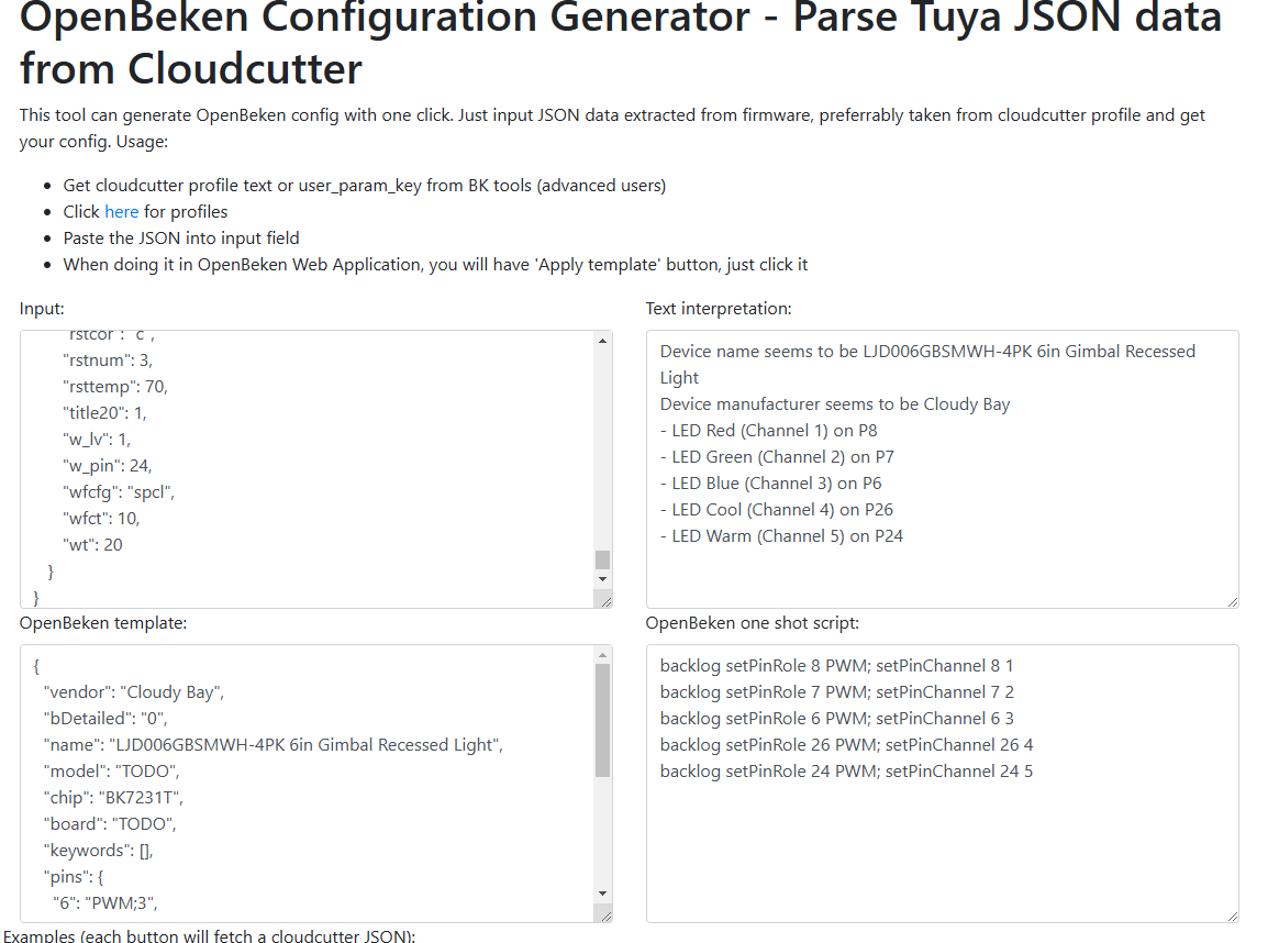

    I just flashed 4 CLOUDY BAY 6inch Smart Wifi LED Recessed Lights however 2 behave properly and 2 do not the ones that do not crash every time you try to change from RGB to CW. I am at a loss on where to start for sorting this issue out and help would be great I will provide whatever info is needed
    version is 1.17.697
    AI: What app or method are you using to control the CLOUDY BAY lights?
    HTTP and Home assistant
    AI: Have you tried any troubleshooting steps so far, and if so, what were they?
    full reset, different flags

    and here is the template
  • #4 21327701
    Posts: 14796
    Rate: 12954
    So it's just a PWM-based device?
    Screenshot of the OpenBeken Configuration Generator for parsing Tuya JSON data.
    Well, then try maybe enabling PowerSave on OBK... I am not sure.... I expected it to be a current setting related problem of I2C-like LED controller, SM2135, etc, etc.

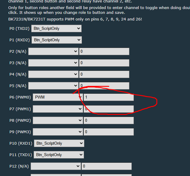

    it just flashes off and restarts but I just noticed that one of them if I use the test buttons in the web app all the channels are out of order for instance 100% blue turns on warn white

  • #8 21332096
    Posts: 14796
    Rate: 12954
    Maybe enable "raw PWM controls" flag and try to first order the channels correctly? First is RED, then is Green, then Blue, etc...
  • #9 21333527

    ok i tried the raw flag
    channel 1 does nothing
    channel 2 does warm white
    channel 3 does cool white
    channel 4 does red
    channel 5 does blue
    I am confused that this one acts so different compared to the others
  • #10 21333657
    Posts: 14796
    Rate: 12954
    You've got wrong channel order and probably one of wrong pins has PWM role. Please check other PWM to see if it's green LED and reorder channels so it goes like this: RGBCW

    How do I reorder channels? I set this up using the same template as my other lights that are same model
  • #12 21334731
    Posts: 14796
    Rate: 12954
    You can change numbers here:

  • #13 21334754
    yonubear
    Level 4  
    Posts: 29
    I got it working changing the channels worked but I got curious and I found if I use the cloudy bay template in the web app it has the pins wrong if I use the cloudcutter template "LJD006GBSMWH-4PK 6in Gimbal Recessed Light (Cloudy Bay)" they match what I found was right
  • #14 21334806
    Posts: 14796
    Rate: 12954
    It's good to see you got it figured out, but you can share the final template in JSON format?;
