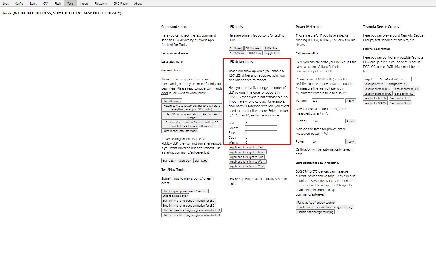

    Hello, you need to do the colors remap. The easiest way to do it is currently via Web App, here:
    Screenshot of the control panel for LED color remapping tools.
    You can try guessing remap or getting one from here:

    Yes, I did fiddle around with the LED Tools option, and my bulb's actual settings are 4 2 3 1 0...
    I have applied the above settings, but it's not working. I know I must be doing something wrong.

    Did the order of colors change? Try another order of colors.
    It is very simple. Enter number 0 for first field, click "apply and set to red" - is it red? If yes, then okay. If not, then enter number 1. Try again. Is it red? Good, check the next field. You can just brute force it...

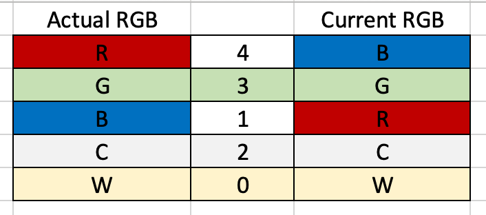

    Yes, orders changed and somehow I am just not able to understand how this mapping works.
    As of now, only Green, Warm & Cool are perfectly matching... RGB is interchanged for Red & Blue.. but if I just change the numbers for Red & Blue, everything gets messed up.
    Table showing differences between actual and current RGB mapping and values for C and W.
    Also, how do I retain the last power / memory status if there is a power outage...? If the bulb was on and there was a power outage, the bulb doesn't turn back on when the power resumes.

    I would say you need to swap the indices that are currently for Red and Blue. Or maybe' let's approach it from a different angle. Can you do Tuya config extraction?

    Happy to report that I have got the mapping right for the BP5758D Bulb which had color interchange issue.
    Below is the correct mapping
    BP5758D_Map 4 3 1 0 2
