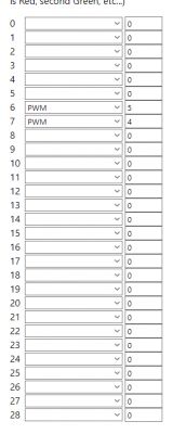

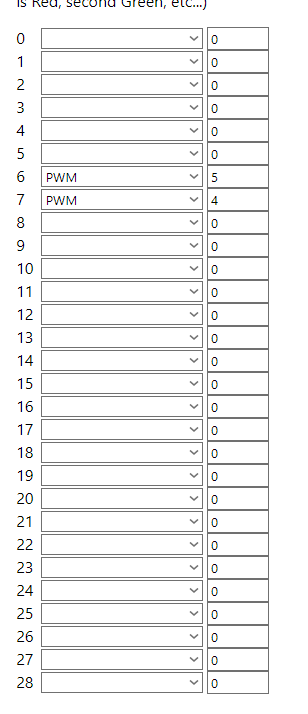

    - LED Cool (Channel 4) on P7
    - LED Warm (Channel 5) on P6
    Device seems to be using CB3L module, which is using BK7231N.
    And the Tuya section starts at UNCOMMON POSITION 0
    I have configured it accordingly however I cannot turn it on or off as there are things missing I think.
    Setting Up GPIO for LED Garage Batten Light with BK7231N - 1.17.157 Flash
    Can anyone help with the Turn Off/Turn On part of the configuration?

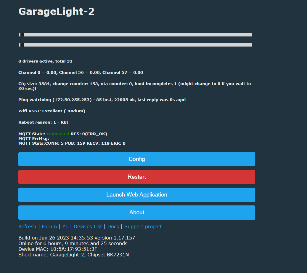

    Yes, all is there on the main page. Nothing is missing.
    But with the current GPIO configuration, the light doesn't turn off or on when I press the button on the web page.

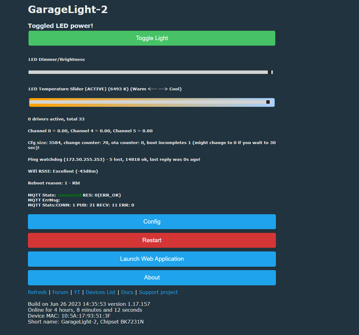

    That is what I am saying - nothing happens. I press the ON button on the main page - The lights do not come on.
    Since lights are not on when I press the OFF button nothing happens.
    As the lights are not ON then the sliders will not work either.
    So in summary - can not turn ON the lights.

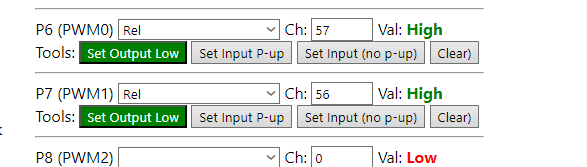

    Ok, so, maybe, let's try with basics. Use GPIODoctor to test each pin in relay mode (on and off), try to set all pins to state 1 (ON, aka high) and tell me, does anything light up?
    https://www.elektroda.com/rtvforum/topic3976371.html
  • #7 20632623
    MnM1
    Posts: 175
    Rate: 13

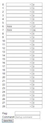

    Ok only PIN 6 and PIN 7 turned ON the light.
    PIN 6 - Warm White
    PIN 7 - Cool White
    The rest of the PINS did nothing
    Added after 7 [minutes]:
    But now the front page looks like this

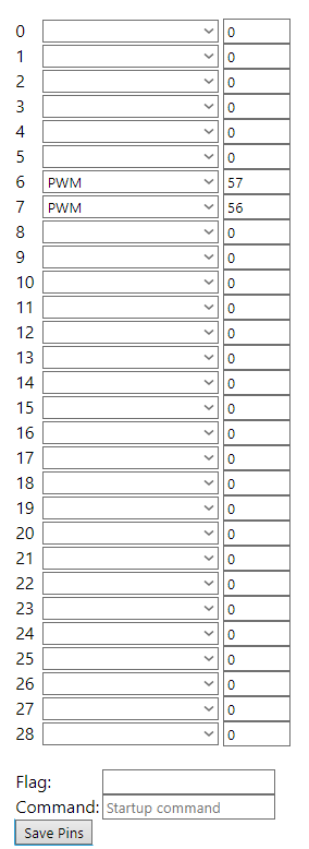

    Ok, now change the roles of P6 and P7 to PWM, does the light work now?
    If not, go to flags, enable "show raw PWM controllers" to show raw sliders for each PWM. Change those sliders on main page. Do they adjust the light colors, one for cool, second warm?
  • #9 20632645
    MnM1
    Posts: 175
    Rate: 13
    Changed them:
    Enabled the raw option but there is no button for ON or OFF on the main page now:
    Sliders do work and light dims or increases if I use them.

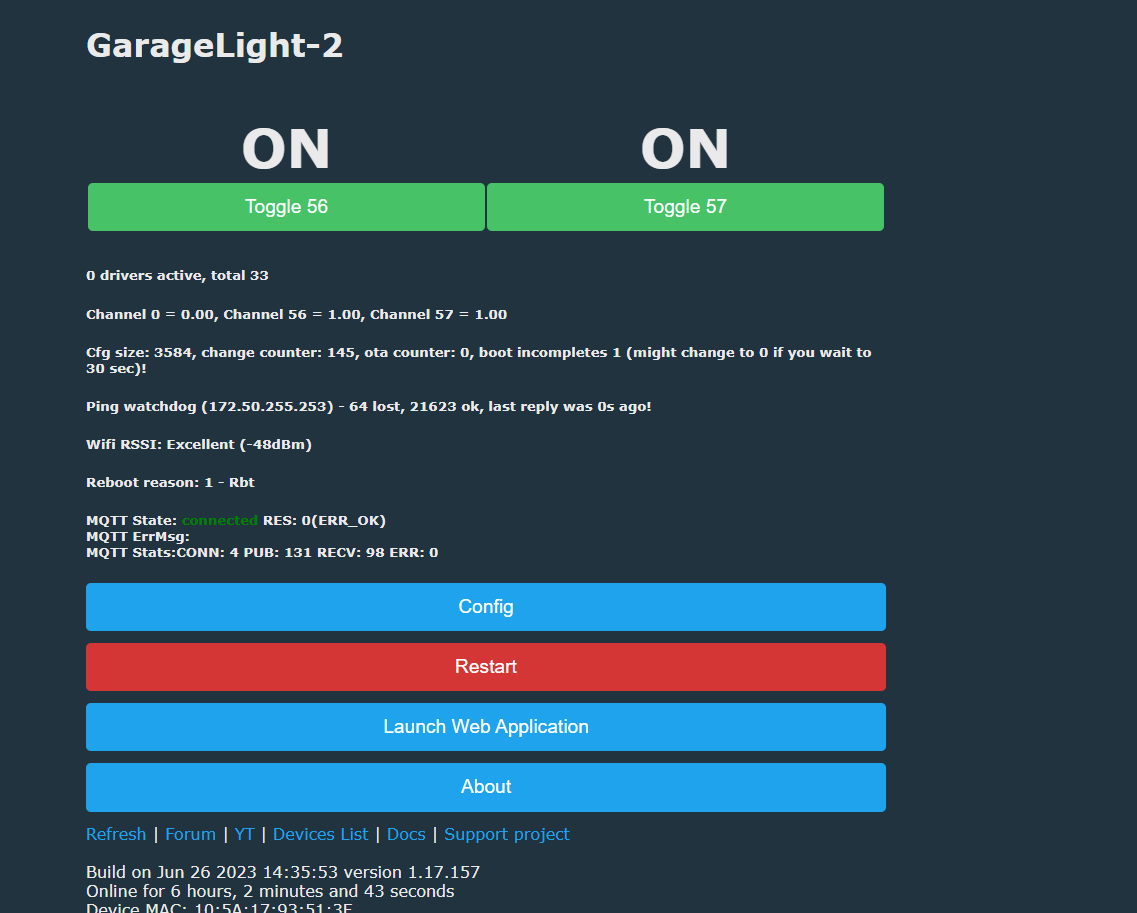

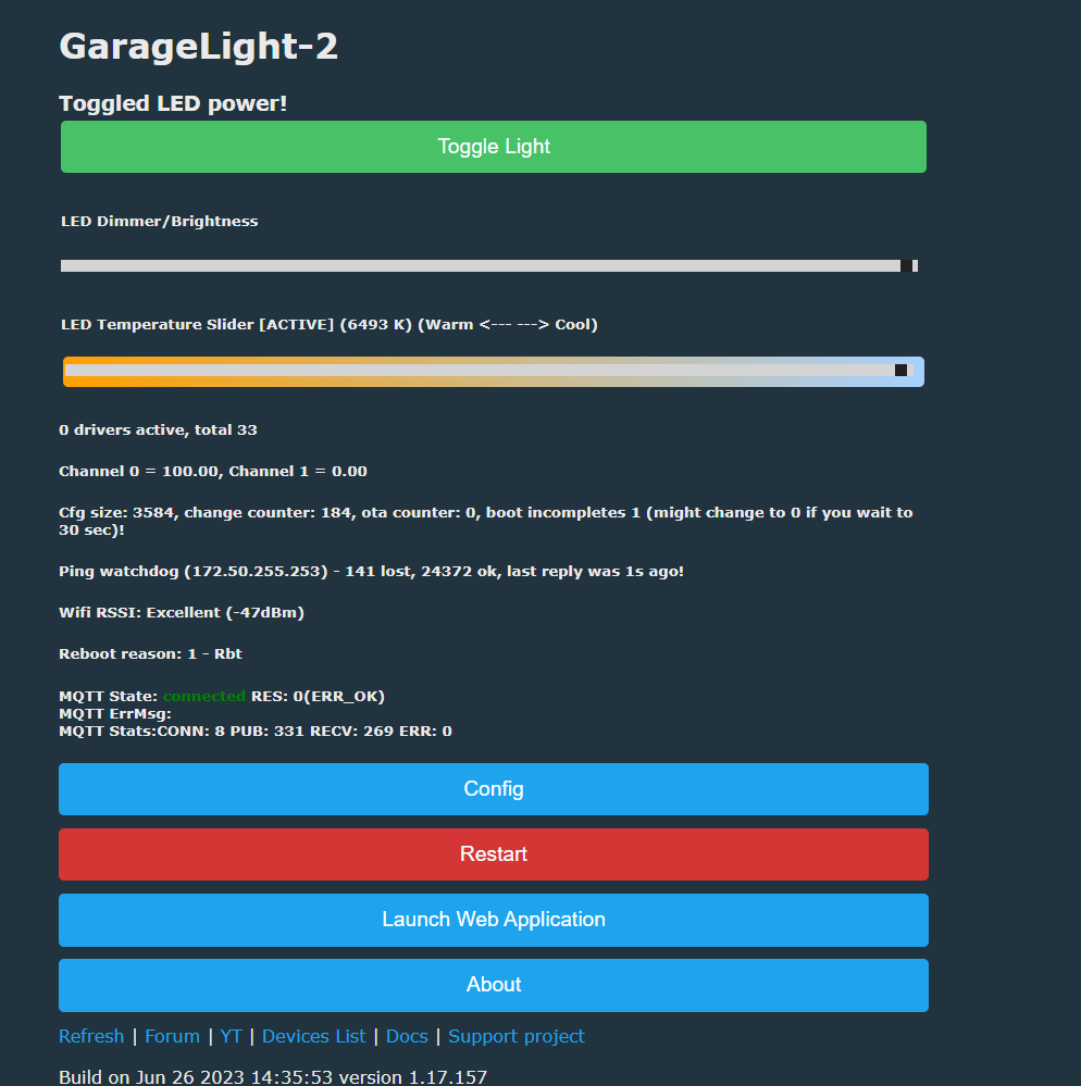

    And now, if you disable "show raw PWM controllers", does the main page work?
    If not, try setting cool channel to 0 and warm to 1...
  • #11 20632682
    MnM1
    Posts: 175
    Rate: 13
    Setting the PWM 6 to 1 and PWM 7 to 0 seems to have worked.
    However, there is one issue - the light is not as bright as it was when it was running the Tuya firmware. It is much dimmer now.
    I find that when I go to GPIO Doctor on HIGH, the light is much brighter too.
    Any ideas?

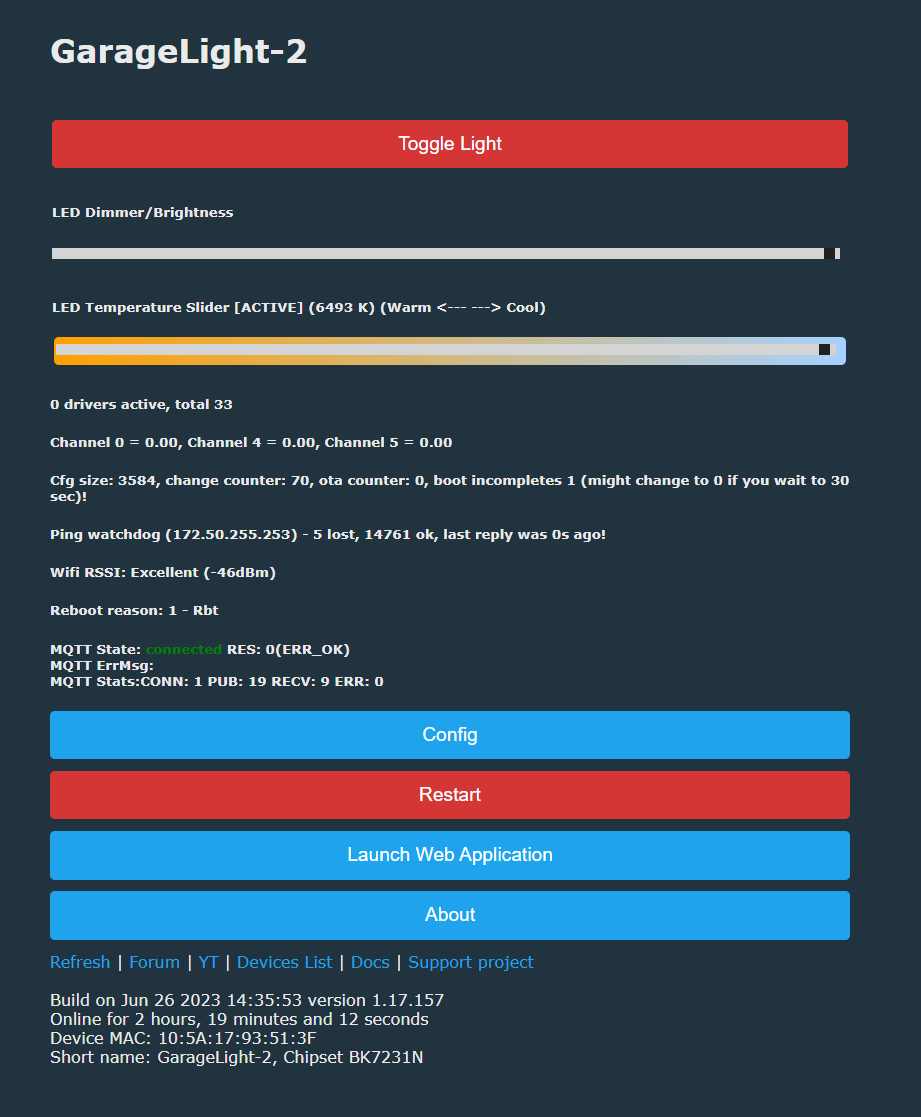

    #12 20632695
    Posts: 14768
    Rate: 12911
    What do you have on the main page now, what are the channel values at full brightness?
    Maybe you need to enable alternate PWM frequency in flags.
  • #13 20632697
    MnM1
    Posts: 175
    Rate: 13
    This is the main page now, with light working:
    I will try your suggestion and see.

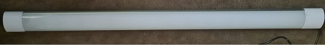

    Lights installed.
    They seem very bright in the garage - the issue where they seemed not that bright might had been a perception error.
