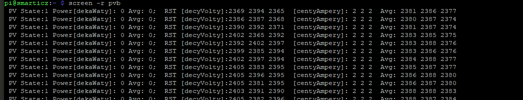

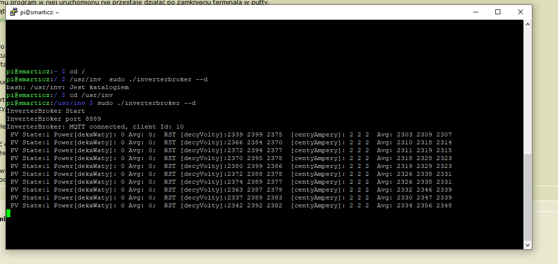

  • #10 21403730
    Daro1003
    Posts: 2715
    Help: 295
    Rate: 608
    My progress is:
    1. installed screen
    sudo apt install screen
    2. i ran
    screen -S pvb
    3. I ran from the /usr/pv directory
    inverterbroker --d
    Terminal screen with InverterBroker running and PV data displayed. .
    4. now if I fire up after turning on putty
    screen -r pvb
    Then I have the data immediately:
    Screenshot of a terminal displaying photovoltaic panel data. .

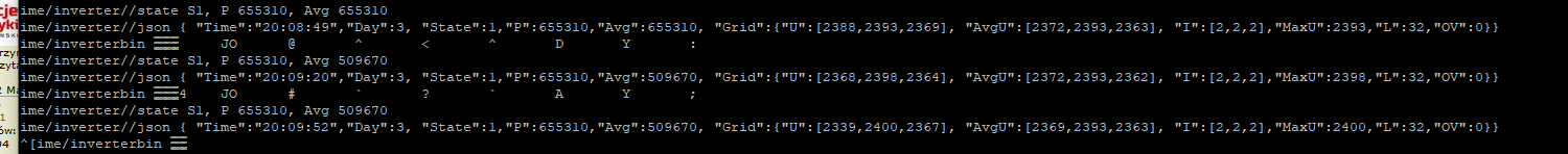

    #11 21404832
    michal.zd
    Posts: 1693
    Help: 85
    Rate: 276
    michal.zd wrote:
    then open putty another terminal and in it:
    mosquitto_sub -h localhost -v -t ime/#
    Now here see the data that comes into mosquitto.

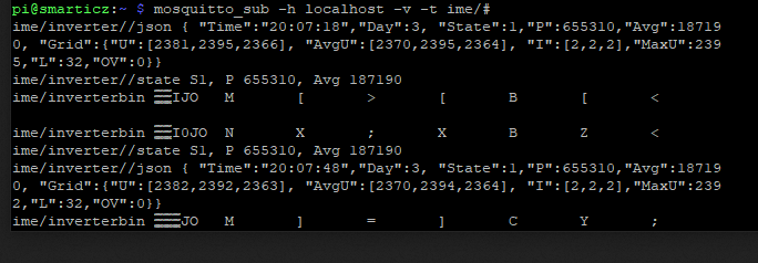

  • #12 21405255
    Daro1003
    Posts: 2715
    Help: 295
    Rate: 608
    michal.zd wrote:
    Exactly the data is flying:
    Screenshot displaying MQTT message data about an inverter's status.
    Console screenshot with JSON data related to inverter status. .
