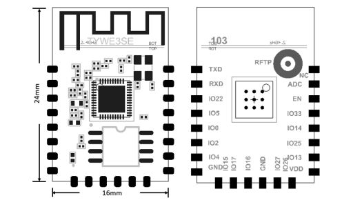

    This really looks like a simple PWM-based device. Have you tried to enable "show raw pwm controls" flag in flags and then check if each PWM is working?
    WE3SE module? Interesting, so it was supposed to be ESP32?
    Diagram of the WE3SE module with pin labels and dimensions.
