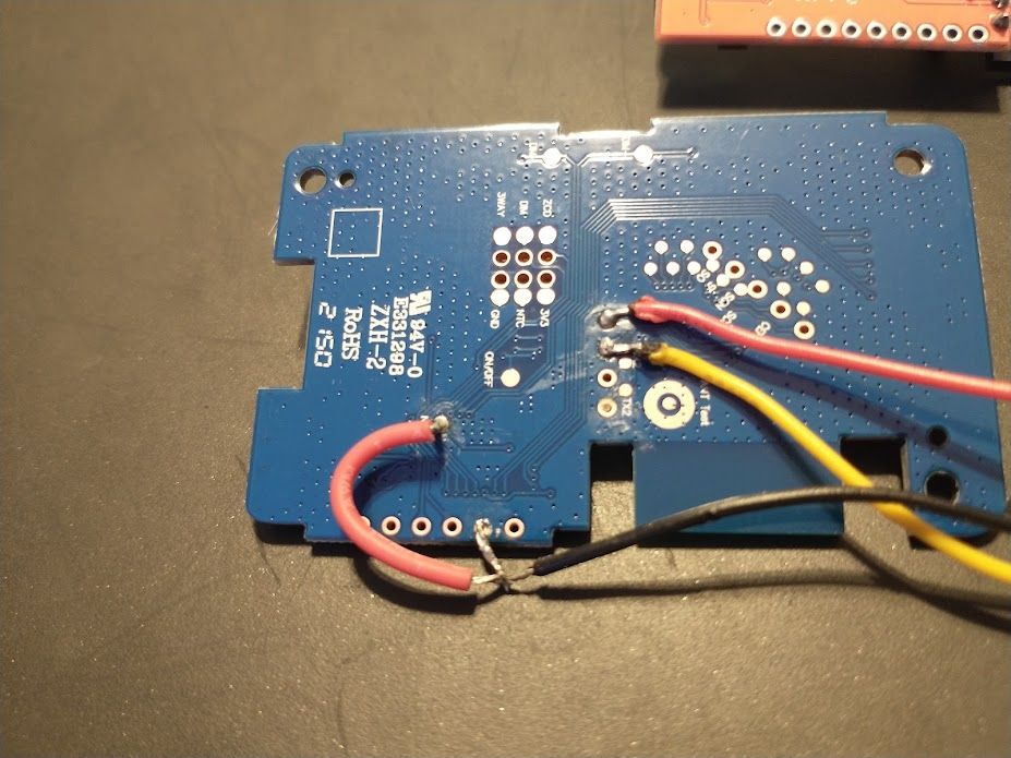

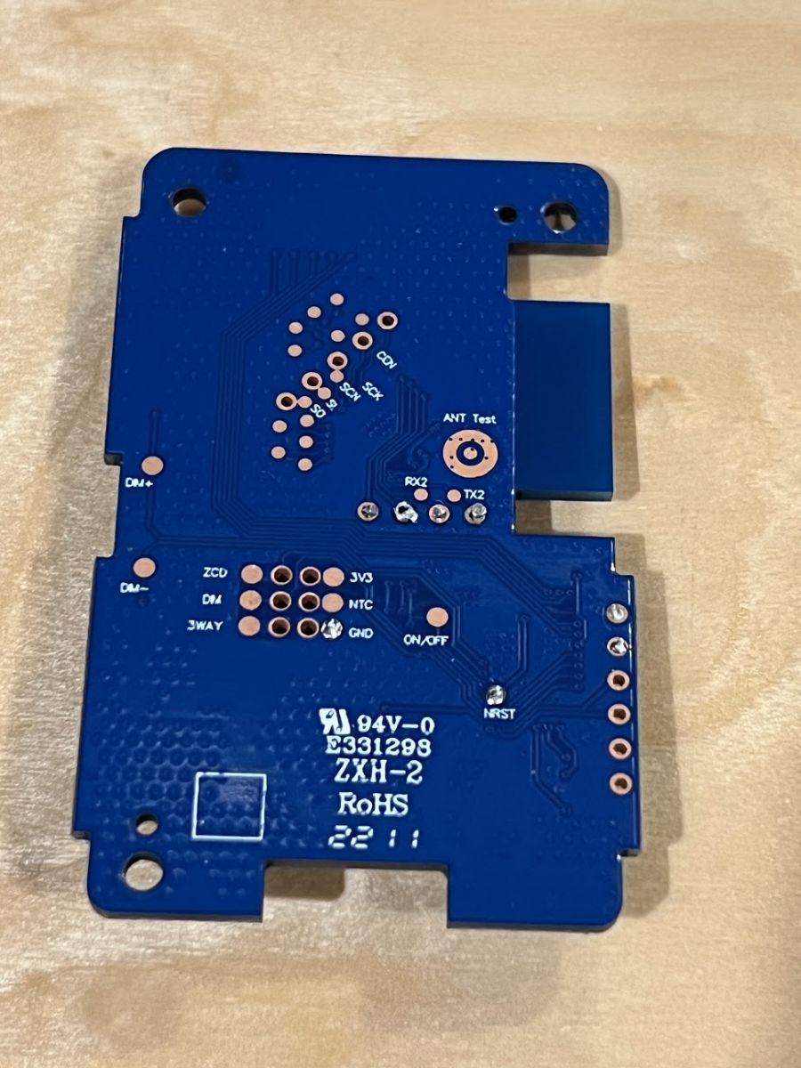

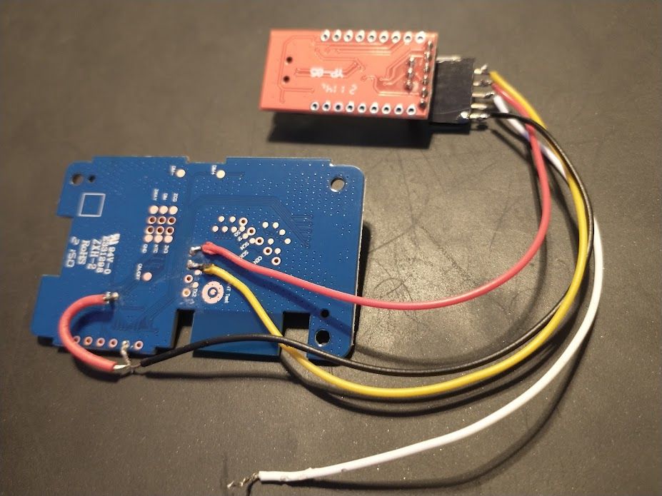

    To program, I grounded the NRST pad on the back. Then attached wires to RX1, TX1, 3.3 and GND. Ran the program and it was able to flash the file.
    Once I had it flashed and on my wifi. I then added an autoexec.bat file for the TuyaMCU. Below is the code I have in it. In my testing, I wasn't able to use the dimmer buttons until I added the other OutputChannel 3. I'm not sure if that is correct, but it worked for me.
    I am still very new to the TuyaMCU devices, and if this isn't correct, please let me know.

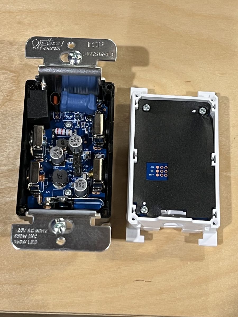

    I also forgot to post the FCC ID. This is what I found on the FCC website.
    SYW-DIMSMART
    • DIMSMART Dimmer User Manual JXY2.938.100S.100 SD06 2019-07-19 new art Feit Electric.pdf (5.22 MB) You must be logged in to download this attachment.
    • DIMSMART Dimmer Teardown Internal Photos Appendix-DIMSMART-Photos Feit Electric 2.pdf (3.52 MB) You must be logged in to download this attachment.
    • DIMSMART Dimmer Teardown Internal Photos Appendix-DIMSMART-Photos Feit Electric.pdf (3.19 MB) You must be logged in to download this attachment.

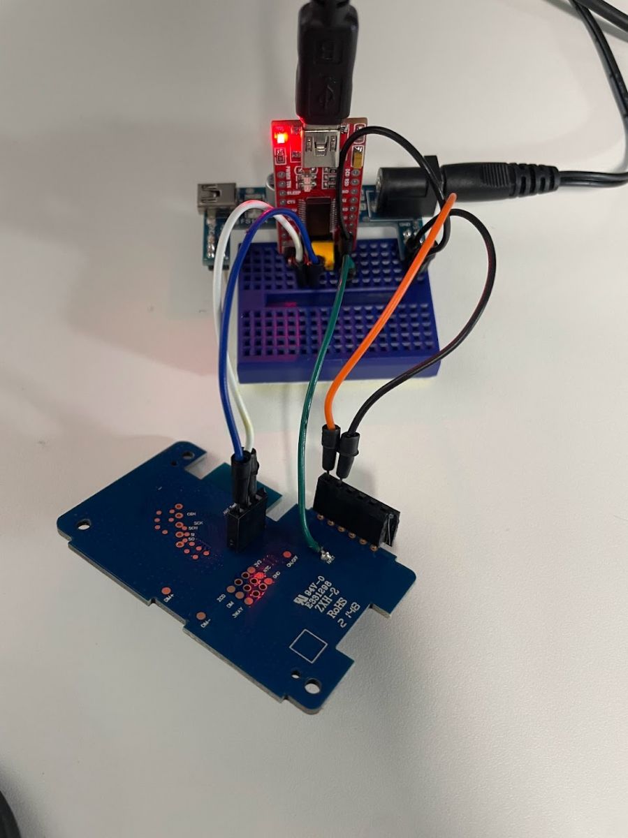

    I have the same switch and I used 3.3V ground, TX1, RX1, and NRST with a FTDI USB to TTL chip.
    I use NRST to restart the chip but it won't connect. I even try to swap the TX1 and RX1 cables, no change.
    I flashed plenty of Tasmota devices with my FTDI cable so this is not the first time I'm trying to flash a firmware.
    Any pointer?

    You’ll need to keep the nrst point grounded the entire time. This basically bypasses the Tuyamcu chip. Then you can flash like before. Hope that helps.

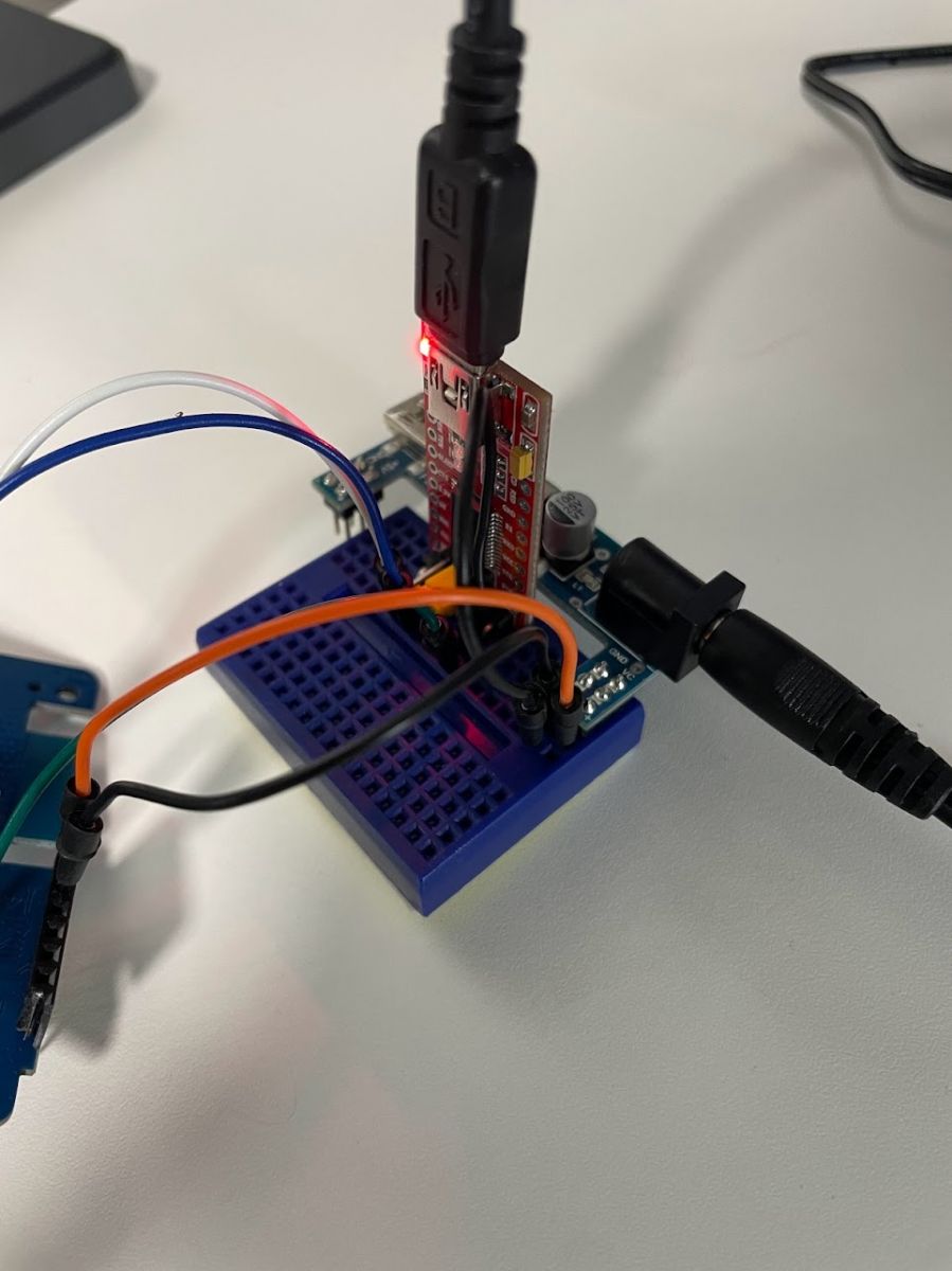

    Just to add to what @bleeblak8 said. I didn't realize at first you need to have the timing just right with bkwriter and power up. Try connecting TX1, RX1, GND, and ground NRST. Hit program on bkwriter and during the 15 sec timeout connect 3.3V. bkwriter should start flashing it. I use a separate power supply with a switch to make it a little easier.
  • Need separate 3.3V power to avoid USB disconnects

    Just to add to what @bleeblak8 said. I didn't realize at first you need to have the timing just right with bkwriter and power up. Try connecting TX1, RX1, GND, and ground NRST. Hit program on bkwriter and during the 15sec timeout connect 3.3V. bkwriter should start flashing it. I use a separate power supply with a switch to make it a little easier.
    I did as you said, but as soon as I touch the 3.3V on the light switch, the computer makes a disconnect sound and the program would crash and no flash.
    Are you using FTDI chip usb to ttl or something else?

    Please post a picture of your setup. I will also add that I often flash without using CEN/RST/etc, just GND, VDD, RX and TX and then I reboot with reconnecting power from an external reliable 3.3V supply.
  • #15 20430641
    tryingbe
    Here you go. I haven't tried an external 3.3v. Guess I will be trying that next.
    BK7231T Feit Smart Wifi Dimmer: TuyaMCU, Programming & 3-Way Mode Tips (Amazon Purchase) BK7231T Feit Smart Wifi Dimmer: TuyaMCU, Programming & 3-Way Mode Tips (Amazon Purchase) BK7231T Feit Smart Wifi Dimmer: TuyaMCU, Programming & 3-Way Mode Tips (Amazon Purchase)
  • #16 20430717
    Posts: 14782
    Rate: 12920
    You're getting 3.3V from that small USB to UART dongle? It won't work, you need to have a reliable 3.3V power supply.

  • #18 20433488
    tryingbe
    Success!
    I used an Arduino with a wall plug and USB cable to supply 3.3V and ground to the light switch and I was able to flash the light switch!
    Thanks for the help!
  • #19 20433588
    Posts: 14782
    Rate: 12920
    Good job!
    Arduino 3.3V has good current capability and is a way to go. Getting 3.3V directly from USB to TTL is not going to work and it never worked for me.

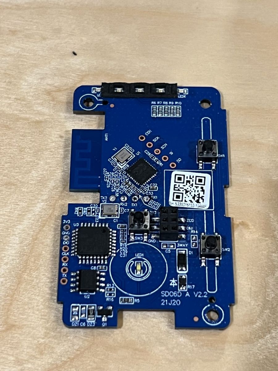

    Just wanted to say thanks to all here! :D I had struggled with this device for a bit, and put it away. The instructions here worked great! (Not sure if it was my use of the built-in 3.3v adapter or not properly grounding the NRST, but it works now.)

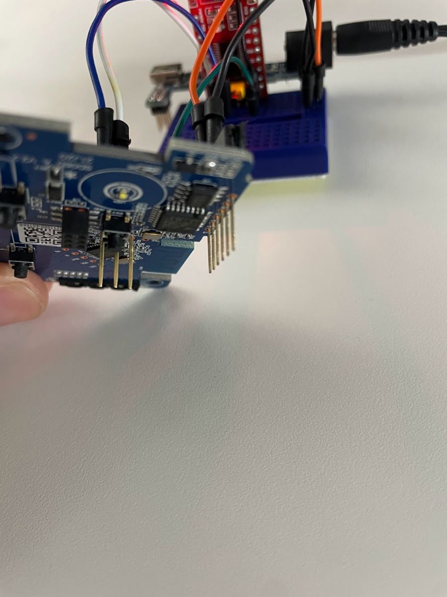

    Side note: using some old header pins makes it so a single solder point on the NRST pad is the only thing required. I am tempted to whip up a 3D printed jig to make this easily repeatable (I've got a handful of these to flash).

    I've been thinking of doing 3d printed jigs for various Beken modules and boards, especially since there is already a TYWE3S one so that could be a good start, but I've never gotten around to it, I always just prefer to solder.
    Still, it's a great idea! Please post it here if you make one, @Matt_J

What hardware is inside the Feit Smart Wi-Fi Dimmer from Amazon/Costco?
The latest boards carry a BK7231T or BK7231N 32-bit ARM-based SoC plus a TuyaMCU co-processor that exposes dpIDs 1, 2, 3 and 101 for on/off, dimming, min-brightness and LED level [Elektroda, bleeblak8, #20385261; GoofySpeed, #21030177].
How do I put the dimmer into flash mode?
Ground the NRST (or CEN) pad continuously, connect TX1, RX1, GND and an external 3.3 V supply, then apply power within the 15-second timeout of ltchiptool/BKwriter [Elektroda, guppy, post #20426991]
Can you show a 3-step flashing procedure?
  1. Solder or clip a wire to NRST and keep it shorted to GND.
  2. Run ltchiptool flash write OpenBK7231N_QIO_1.17.772.bin (or T build for BK7231T) with external 3.3 V ≥250 mA.
  3. Release NRST, reboot; the device starts in AP mode for setup [Elektroda, olidel001, post #21362064]
Why does flashing crash when I connect 3.3 V from my FTDI adapter?
Most black/yellow CH340/FTDI dongles output 5 V on the “3.3 V” pin; the over-voltage makes the PC USB port reset and the flasher crash. Use a regulated 3.3 V source such as an Arduino board or bench supply [Elektroda, p.kaczmarek2, #20430717; tryingbe, #20428837].
