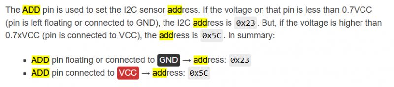

    Addresses:
    Code: C / C++
    With this knowledge I would start by trying to connect two BH1750s to one I2C, but so that each has a different address. .
    And as for the second I2C bus, do you have any SDA1 and SCL1 and SDA2 and SCL2 there separately? Because as far as I can see there must be two buses of 2 sensors each.
    Fragment of the instruction for configuring ADD pins for the BH1750 sensor. .

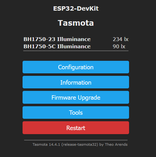

    I've just caught up once before somewhere on the web with what you pasted about addresses but there was no time to connect.
    So the result:
    Tasmota interface on ESP32-DevKit showing readings from two BH1750 sensors. .

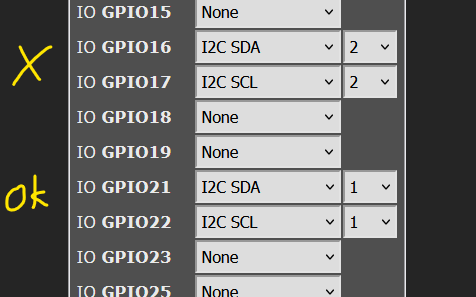

    As for the second I2C bus, do you have any choices there for SDA1 and SCL1 and SDA2 and SCL2 separately? Because as far as I can see there must be two buses of 2 sensors each.
    I have just set it up like this:
    Fragment of the GPIO configuration interface with sensor settings. .
    Unfortunately it only sees two sensors on bus 1 GPIO 21 and 22 on the other bus it does not.

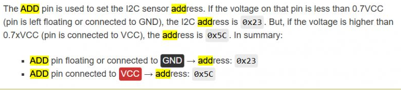

    PS Please drop a link to this spreadsheet:
    Instructions for configuring the I2C sensor address using the ADD pin. .
    I'm looking in the history but can't find it.

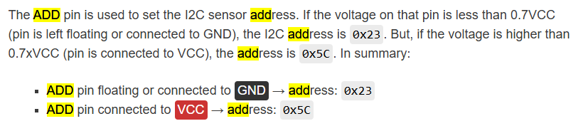

    This screenshot is from this page:
    https://randomnerdtutorials.com/arduino-bh1750-ambient-light-sensor/
    Well unfortunately the author of the code there did not foresee more than two sensors, you have to at least change this condition with two and here the size of the array:
