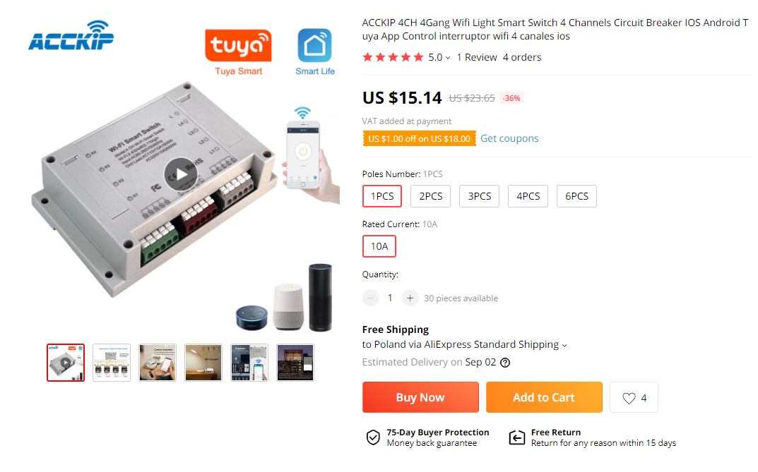

    Hello, here I will sho the teardown, detailed photo documentation, PCB analysis and schematic drawing of another Tuya product. This time it will be a controller for 4 relays, pluggable into a DIN rail, controlled as usual via WiFi via a phone application.
    Update 2022 - This device is fully supported by OpenBeken. Scroll down to find pin configuration and Home Assistant information
    Product purchase
    I found the product by searching for "4CH 4Gang Wifi Light Smart Switch 4 Channels Circuit Breaker IOS Android Tuya App Control interruptor wifi 4 canales ios" for about PLN 60 (supposedly in promotion, normally for less than PLN 100). Below are screenshots of the offer:

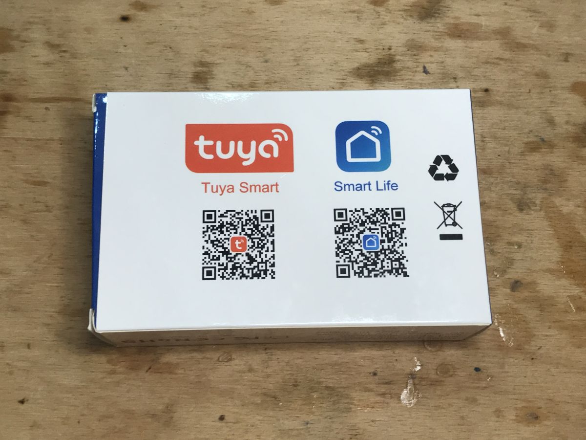

    Kit contents
    The set includes only a relay and instructions (I censored the seller's sticker because there is no need to do unnecessary advertising):

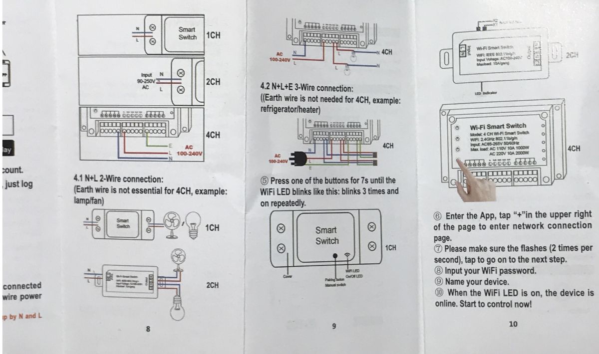

    Instruction (information on how to pair with mobile App, etc.):

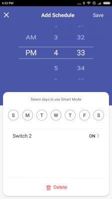

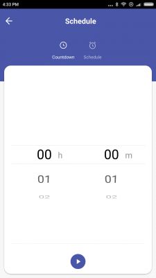

    The Tuya application allows you to control each of the relays separately, as well as turn them off / on at once.
    A few screenshots from the Tuya mobile app:
    Four-channel relay controller Tuya WiFi SmartLife 4CH 10A [schematic] Four-channel relay controller Tuya WiFi SmartLife 4CH 10A [schematic] Four-channel relay controller Tuya WiFi SmartLife 4CH 10A [schematic] Four-channel relay controller Tuya WiFi SmartLife 4CH 10A [schematic] Four-channel relay controller Tuya WiFi SmartLife 4CH 10A [schematic] Four-channel relay controller Tuya WiFi SmartLife 4CH 10A [schematic] Four-channel relay controller Tuya WiFi SmartLife 4CH 10A [schematic]

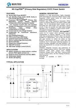

    On the manufacturer's website I managed to find a few pages from the HX5923 catalog note (I provide them as images, no pdf file available). HX5923 is a flyback converter controller with built-in MOFSET transistor working in PSR mode (Primary Side Regulation, voltage regulation by feedback through primary auxiliary winding, without optocoupler etc.).
    HX5923 pin roles:
    Internal diagram
    (also important to realize that e.g. between pins 5/6 - Drain, and pin 4 - CS, Current Sense, there is simply a MOSFET in HX5923):
    Characteristics:
    A description of the operation:
    After all, this converter does not provide galvanic separation because the manufacturer, instead of separating the "mass" of low voltage from the "high" one, connected them together (instead of putting a Y-class capacitor between them).

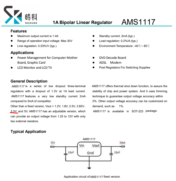

    The power supply gives about 5V, there are also relays working at 5V. Next is the LDO regulator AMS1117 3.3 to get 3.3V for the module with WiFi:
