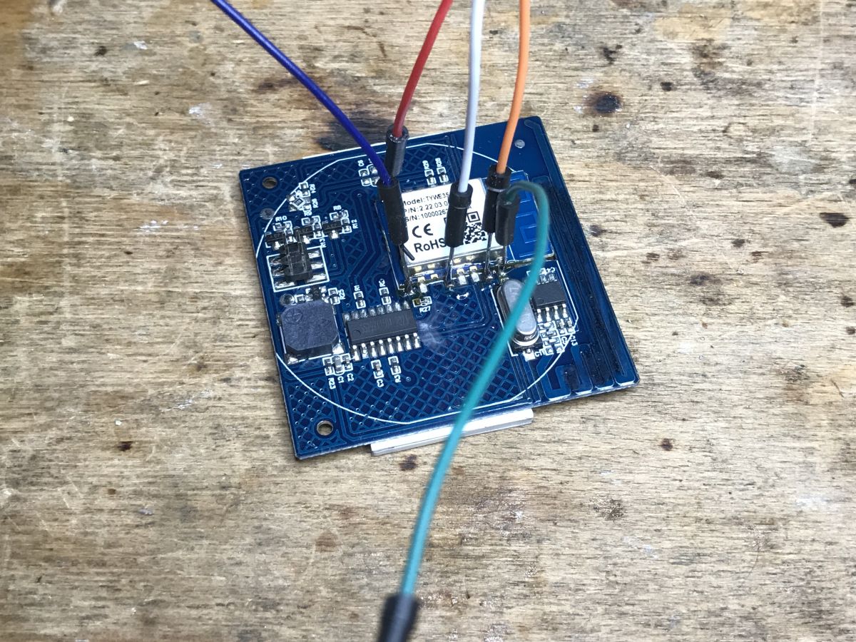

    Really, just the power supply, RX, TX and IO0 to ground. I didn't have to connect anything else.

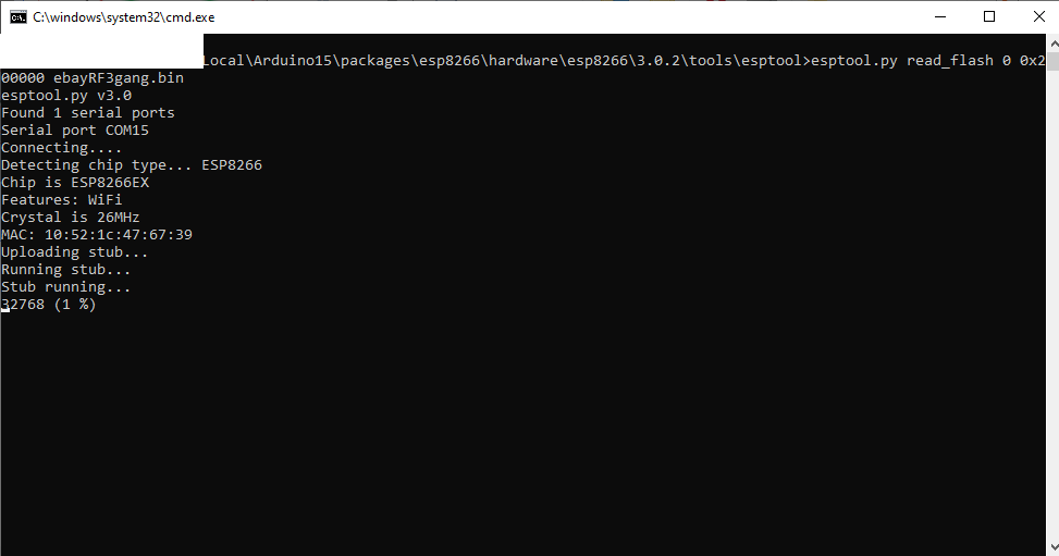

    I also made a backup of the batch.
    Here is a breakdown of the connections:
