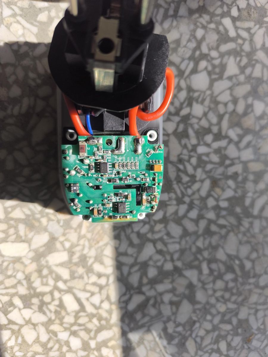

    Sorry, due to lack of time I was not able to revisit the topic earlier.
    I only found 2 ICs on the board:
    lnk625
    hlw8012
    I attach a picture in addition.
    I am totally green but you Masters will surely come up with something ;) .

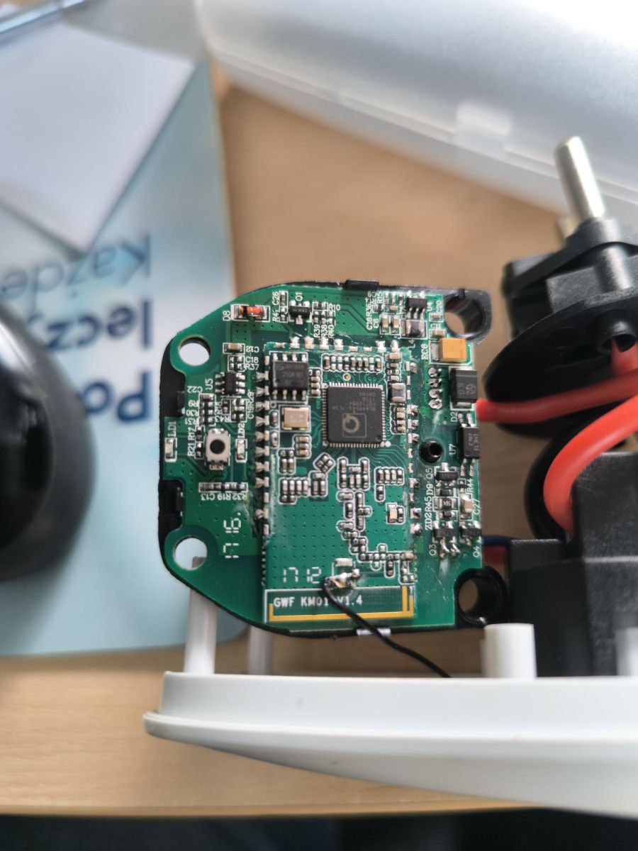

    Added after 37 [minutes]:
    I found one more tile. It was super hidden.
    The main component is an integrated circuit, maybe a processor of some sort:
    qca4004x
    I will add a picture of the board
    Integration of SC71 smart plug sockets with Tuya or Smart Life without Wicon .

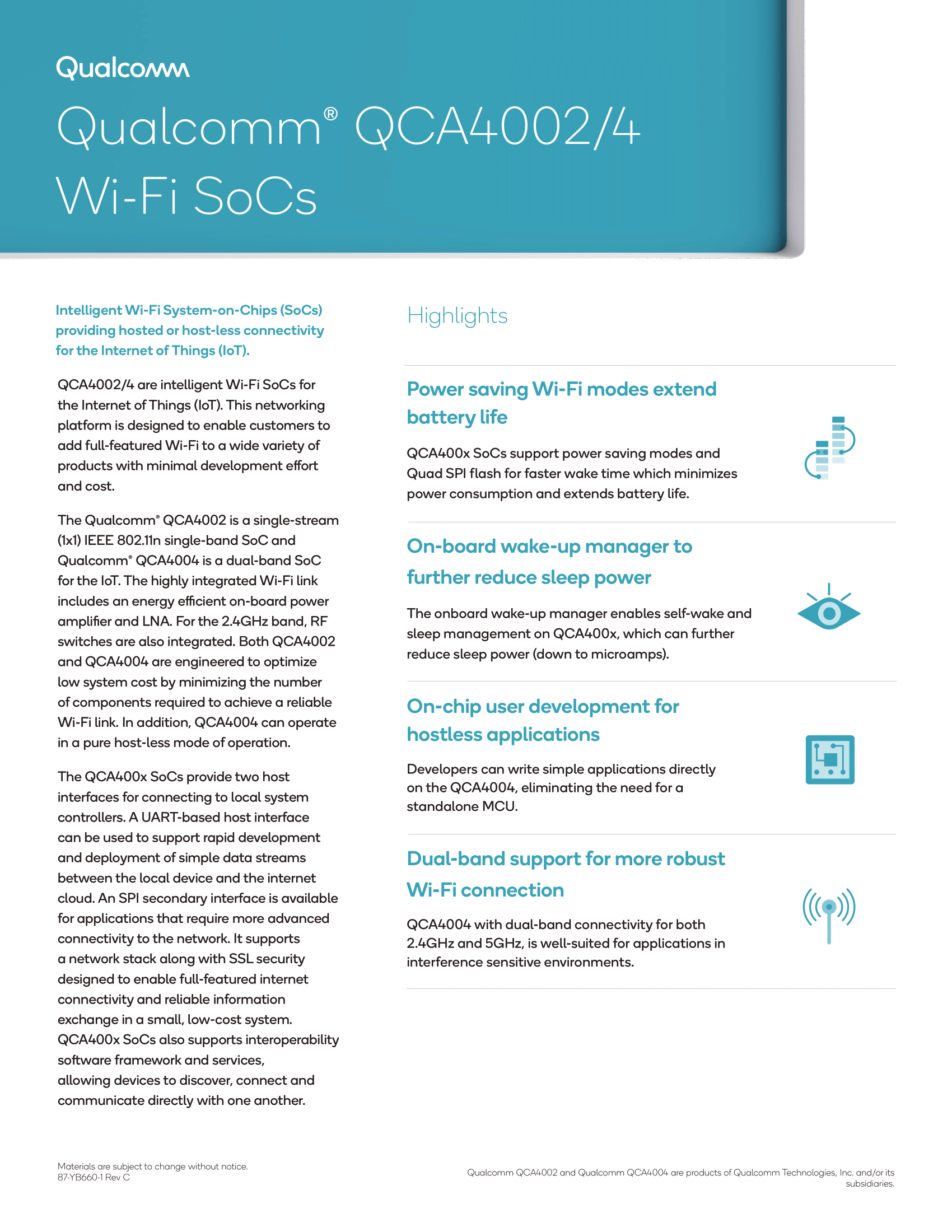

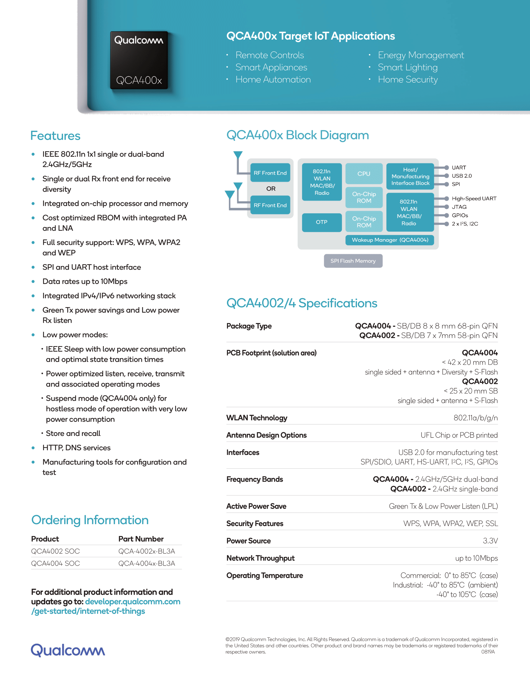

    I didn't even know there was such a chip as the qca4004x. I'm adding the datasheet note:
    Qualcomm QCA4002/4 Wi-Fi SoC datasheet with feature highlights and technical details Qualcomm QCA400x chip datasheet with block diagram and technical specifications
    I don't see much information about this chip on the web. It's a completely different MCU than Tuya has. I don't see open source firmware for it either. It's hard, and probably footprint incompatible with other modules, although it would be uneconomical to play with a swap anyway.
