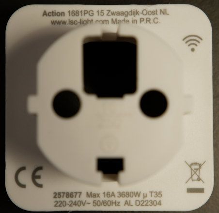

    Physical appearance:
    [BK7231T] Teardown Action LCS Smart Plug (without Energy Meter) 2578685

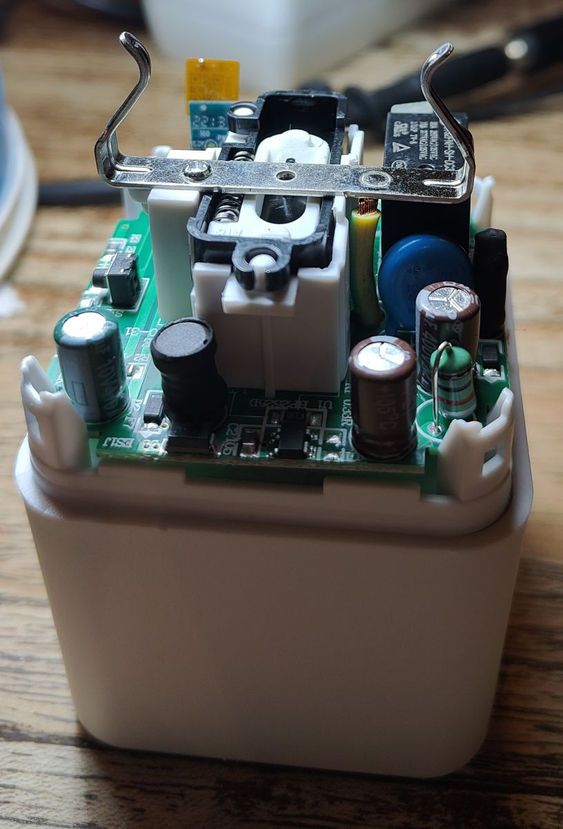

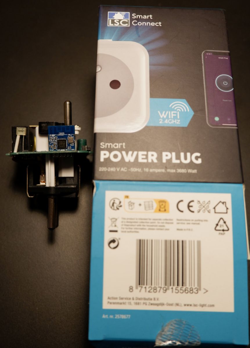

    The inside:

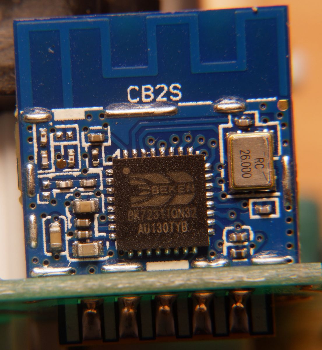

    And the stuff we care about:
    These plugs do have a drawback; they are mislabeled. The Tuya board is labeled CB2S, which should be a BK7231N, but once you remove the label on the chip, it is a BK7231T. This did result in some extra frustration in the beginning, but once this was clarified, flashing went quickly.
    And because we are using cloud-cutter, there is no need for soldering.
    Flashing is straightforward, and I've attached the whole process.
    I choose the 1.1.8 BK7231T / oem_bk7231s_rnd_switch and SS01S Single Pole Smart Light Switch (TreatLife)
    PINs
    As this is a very basic plug, there is not much configuring.
    PIN6 LED_n 1
    PIN7 Btn 1
    PIN8 Rel_1 1
    PIN26 Wifi
    And finished

    Close-up of the CB2S module with a Beken BK7231T microcontroller.
    In an earlier post, someone wrote that the same dyno (i.e. same "Art. no.") has BK7231 N , so it looks like the Action shack has the same lettering and different guts.
    Some other pictures of this plug-in:
    LSC Smart Connect power plug and its packaging. Top view of an opened electrical plug with visible electronic components. Front view of an electrical plug with a Wi-Fi logo.
    I uploaded the OpenBK version for "T" to this and it works.
    I didn't unsolder the module, Tx and Rx aren't connected to anything, and Gnd and Vcc don't appear to be loaded with anything other than a capacitor for voltage stabilization, so for the upload I connected ground with a crocodile to the electrical outlet plug (it's connected to Gnd), power to the uninsulated fuse leg at the relay (it's connected to Vcc), and I touched the data lines with pogo-pins directly at the module.
