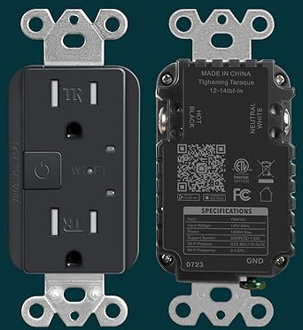

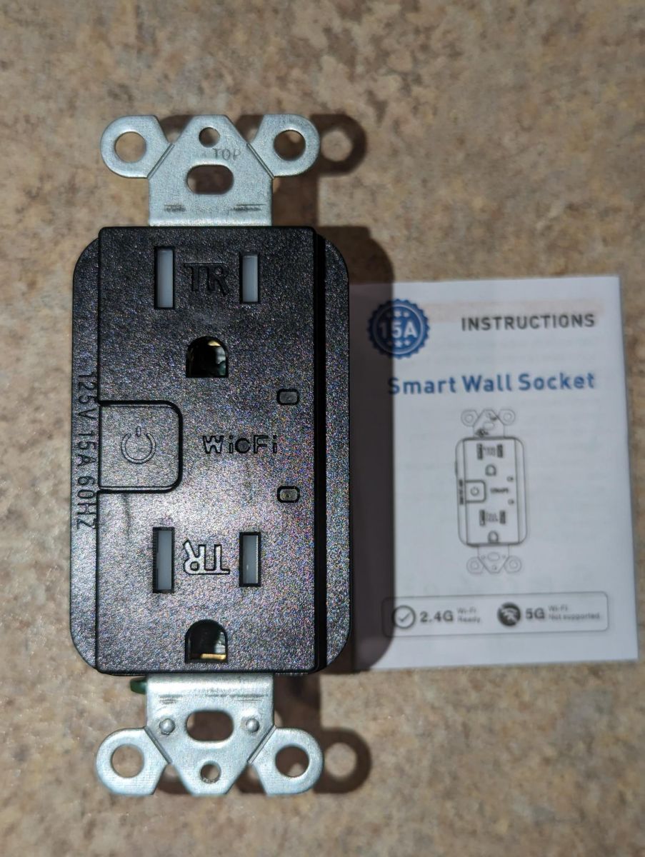

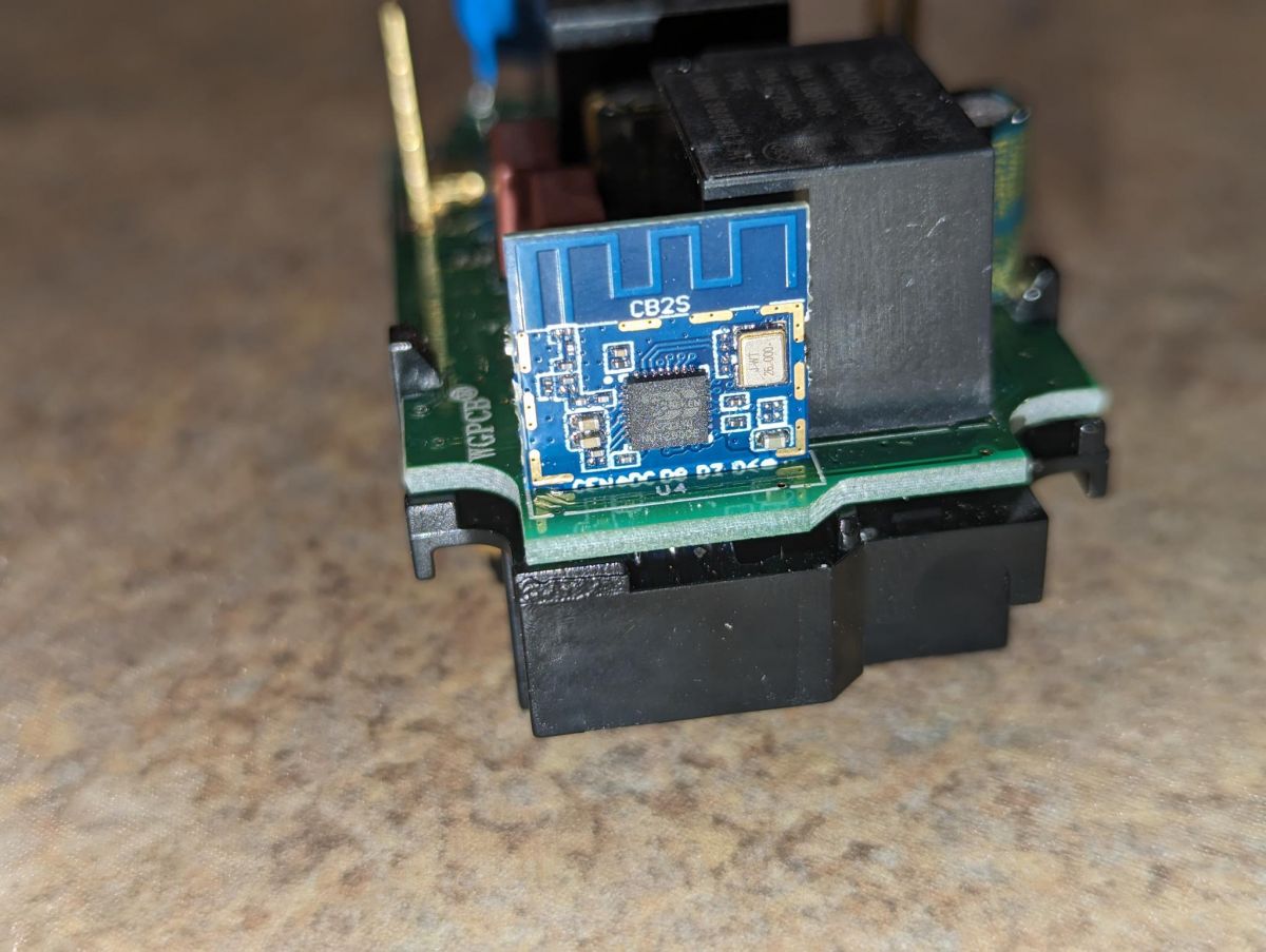

    Purchase from Amazon under the brand of Topeler, but also available under the brand of junlit. The model I recieved is YSW102, but it looks like there is also a YSW101, likely very similar.
    Front and back view of a Topeler/Junlit smart socket with two independent outlets.

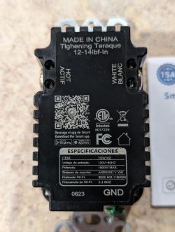

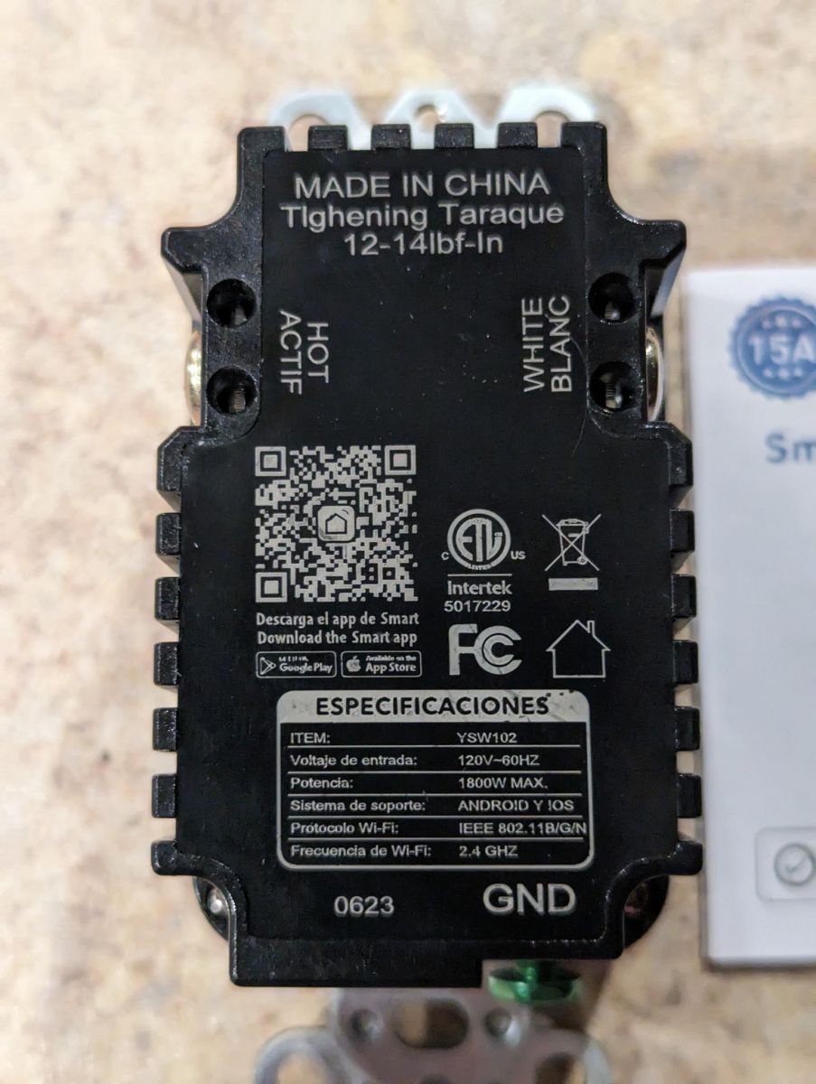

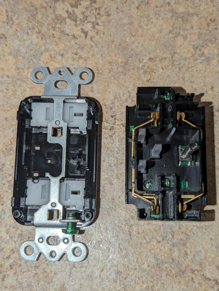

    Teardown Pics:

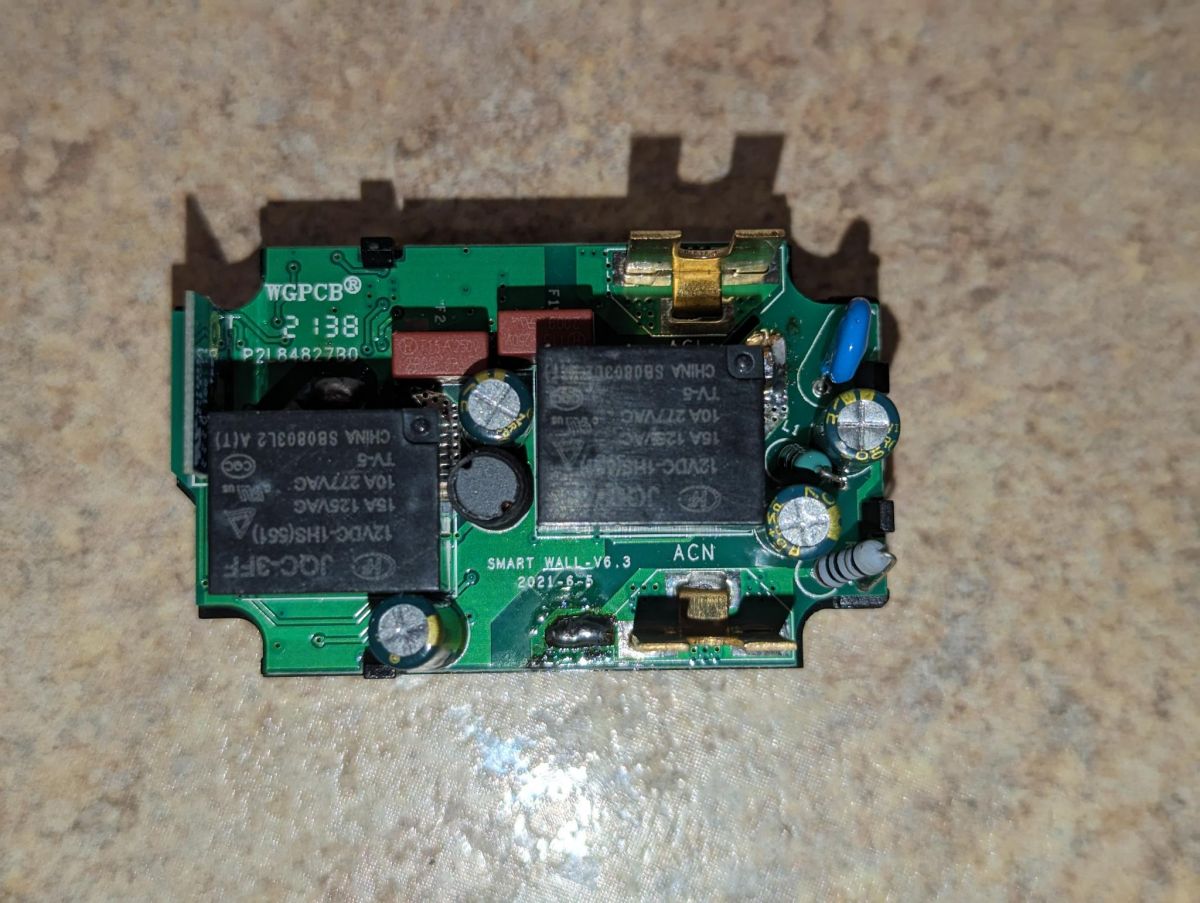

    YSW102 WiFi wall socket with instructions. Back of YSW102 smart electrical socket with technical specifications. Disassembled interior of the YSW102 WiFi smart socket. Close-up of the interior of the YSW102 smart socket electronic module. Close-up of a CB2S module on a circuit board of an electronic device.
    At this point I realized there were no easy access points and I didn't want to have to de-solder to remove the plastic backing to gain access to the pins of the CB2s module, so I decided to try tuya-cloudcutter. I paired the outlet to Tuya to find the firmware version was 1.1.8 (which was vulnerable to tuya-cloudcutter), reset the device, and started the process. This outlet didn't appear to be on the list of available dev ices, so I started tuya-cloudcutter without any parameters, used the 'By firmware version and name' option, and selected an item from the list that had a version of 1.1.8 and the name started with oem- (don't remember the full name). This worked without issue and was able to flash openBeken.
    From there, I used the web UI to pull the GPIO config and the BK7231 East UART Flasher to extract the config.

    - WiFi LED on P11
    - Relay (channel 2) on P26
    - Pair/Toggle All Button on P10
    - Relay (channel 1) on P8
    Device seems to be using CB2S module, which is using BK7231N.
    And the Tuya section starts at UNCOMMON POSITION 0
    Config was uploaded, and everything seems to be working fine.
