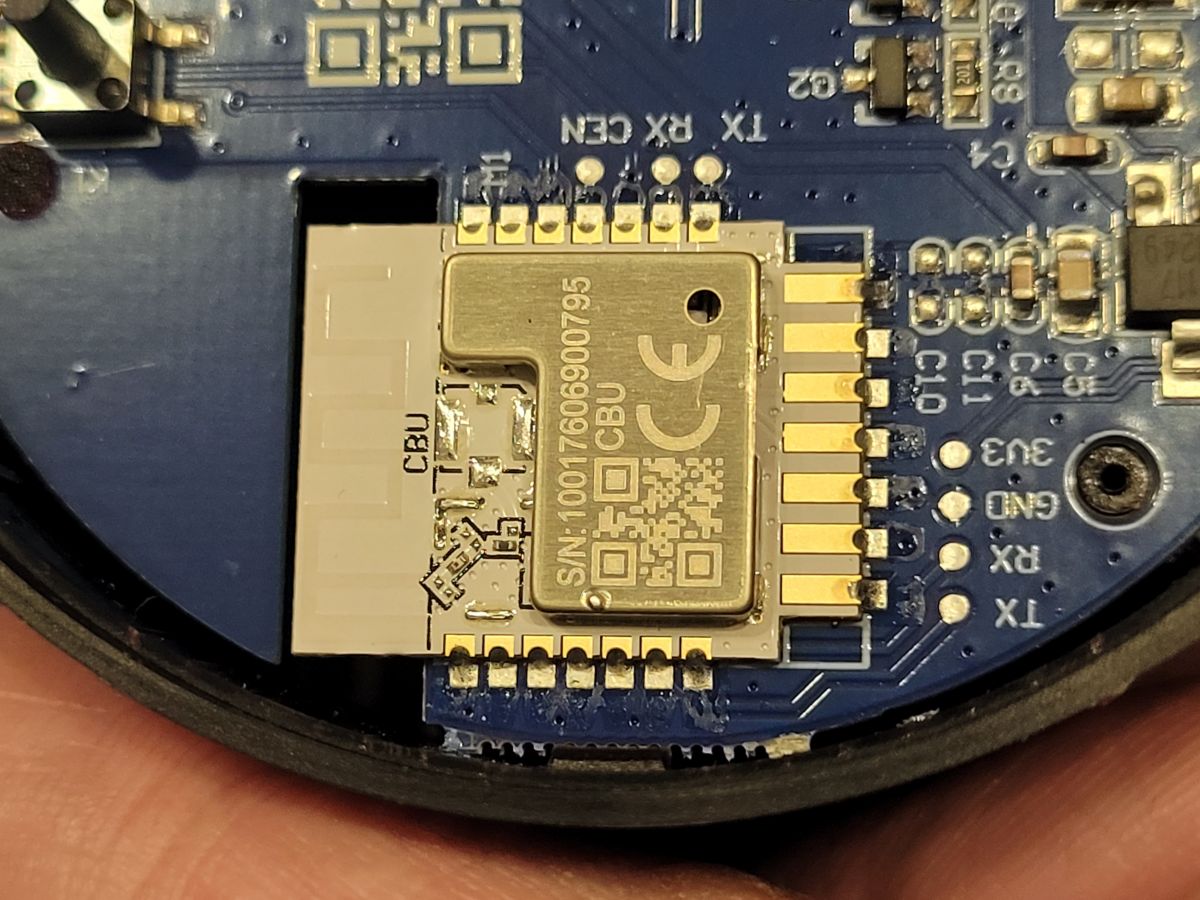

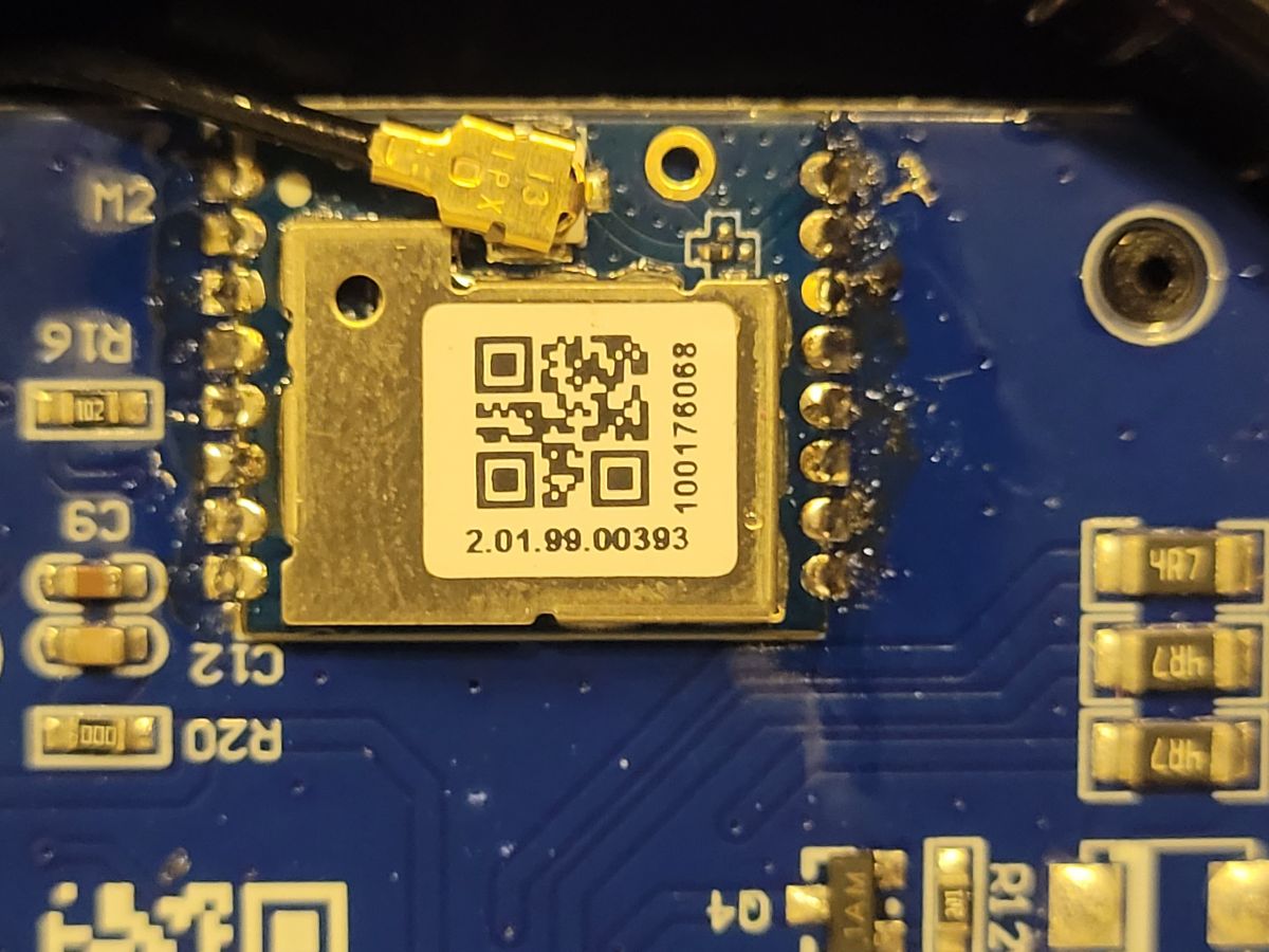

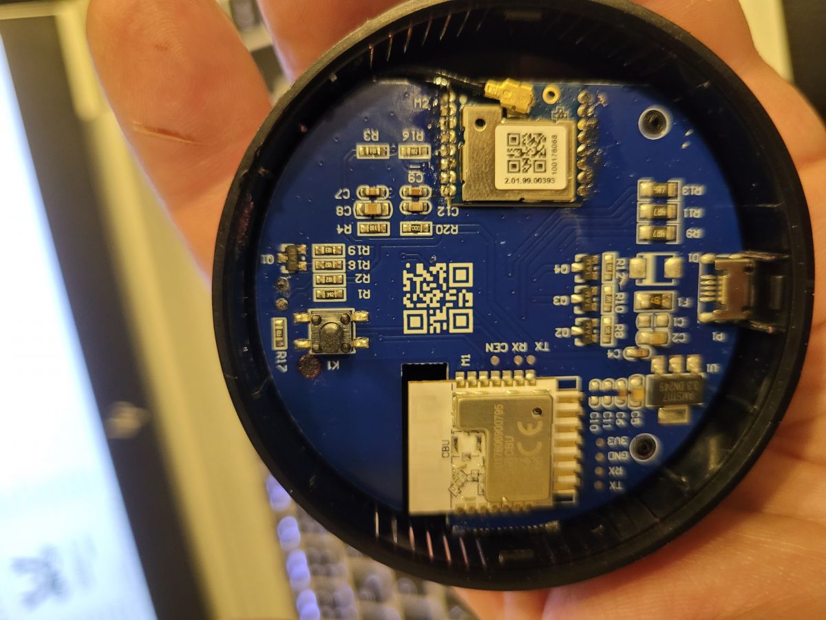

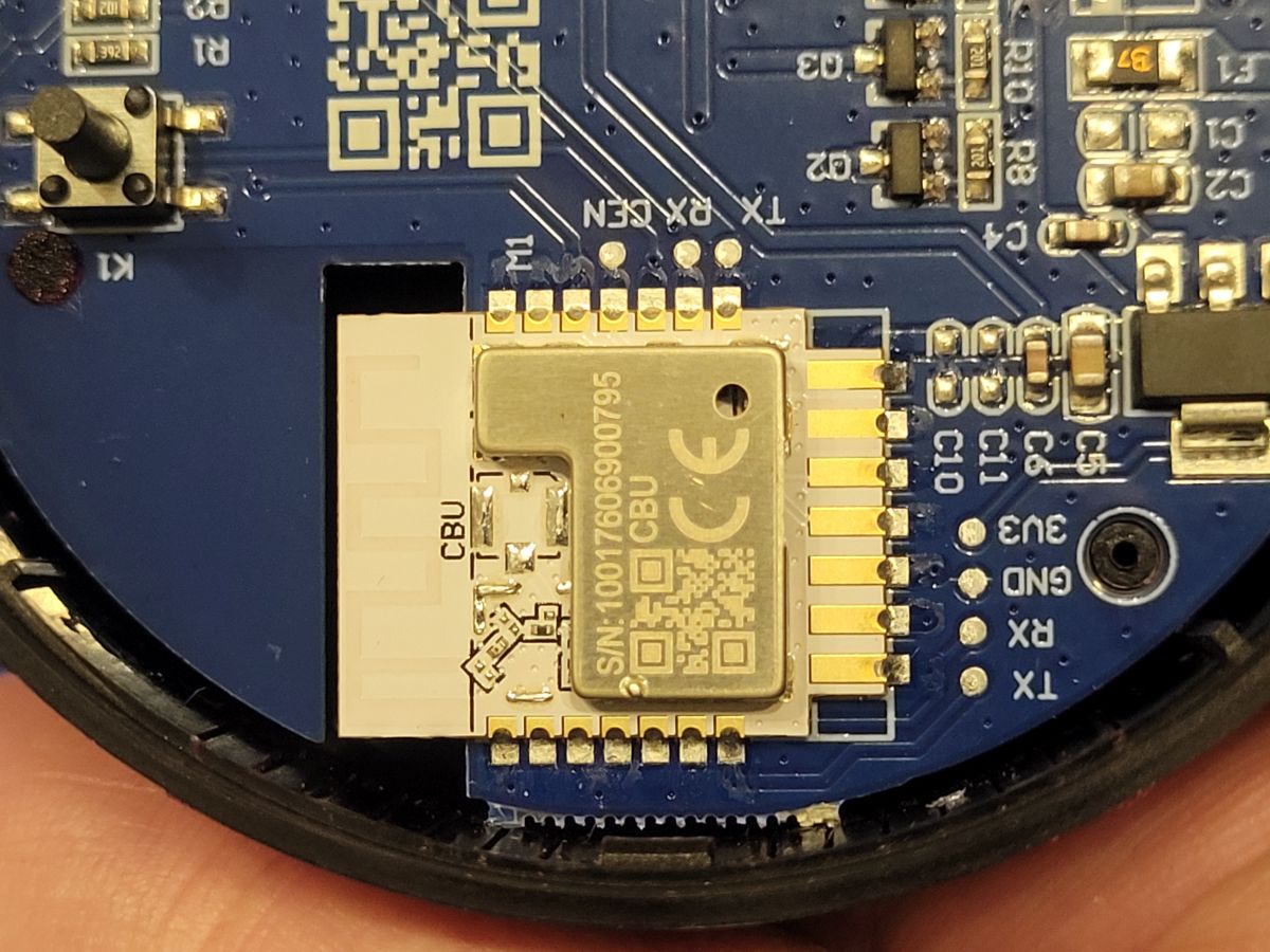

    I bought as a test IR remote 433MHz radio remote. Chip is CBU i.e. BK7231N plus special chip for 433MHz I do not know.
    At least IR part should be supportable.
    Does anybody know this or got it to work?
    Ali link: https://vi.aliexpress.com/item/1005006796540561.html
    A circuit board with visible integrated circuits and electronic components.
    Electronic module on a blue printed circuit board
    Close-up of a blue circuit board with an electronic component and a sticker with a QR code.
    Interior of an electronic device with visible circuit board and components.

    CC1101 module incoming, SH4 module is on the long wait... we'll see.

    We added basic RF support for 1-pin receivers based on SYN590 for now, principal for CC1101 is the same but it will need time to add codebase and test, we are still working on it.
The discussion concerns a Tuya-based IR and 433 MHz radio remote built on a BK7231N CBU module with an unknown RF chip. The device configuration shows IR receiver on P8, IR transmitter on P7, Wi-Fi LED on P9, and a button on P23, but the RF module is identified as likely SH4/CMTOV30 and initially unsupported in OpenBeken. IR functionality was questioned, but no IR codes were observed. Later updates mention that basic RF support was added for 1-pin receivers based on SYN590, while CC1101 support is still under development and SH4 remains on the waiting list.
