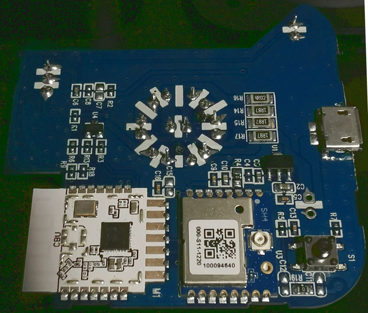

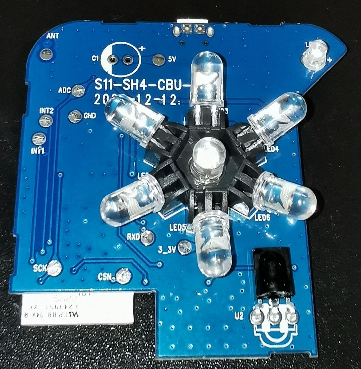

  • SH4 RF section appears to use CMT2300-compatible SPI
    #1 20566501
    JustAnotherUser
    Pictures:
    [CBU/BK7231N and SH4/CMTOV30] Wi-Fi IR+RF Remote Control (S11) [CBU/BK7231N and SH4/CMTOV30] Wi-Fi IR+RF Remote Control (S11)
    [CBU/BK7231N and SH4/CMTOV30] Wi-Fi IR+RF Remote Control (S11)[CBU/BK7231N and SH4/CMTOV30] Wi-Fi IR+RF Remote Control (S11)

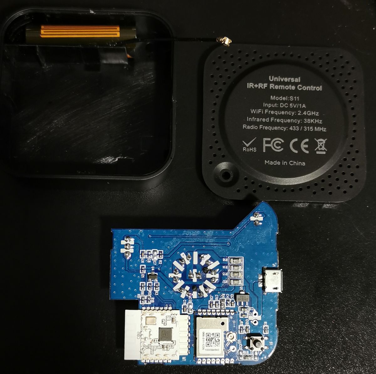

    Purchased on Amazon https://www.amazon.com/dp/B0BY2C68BJ

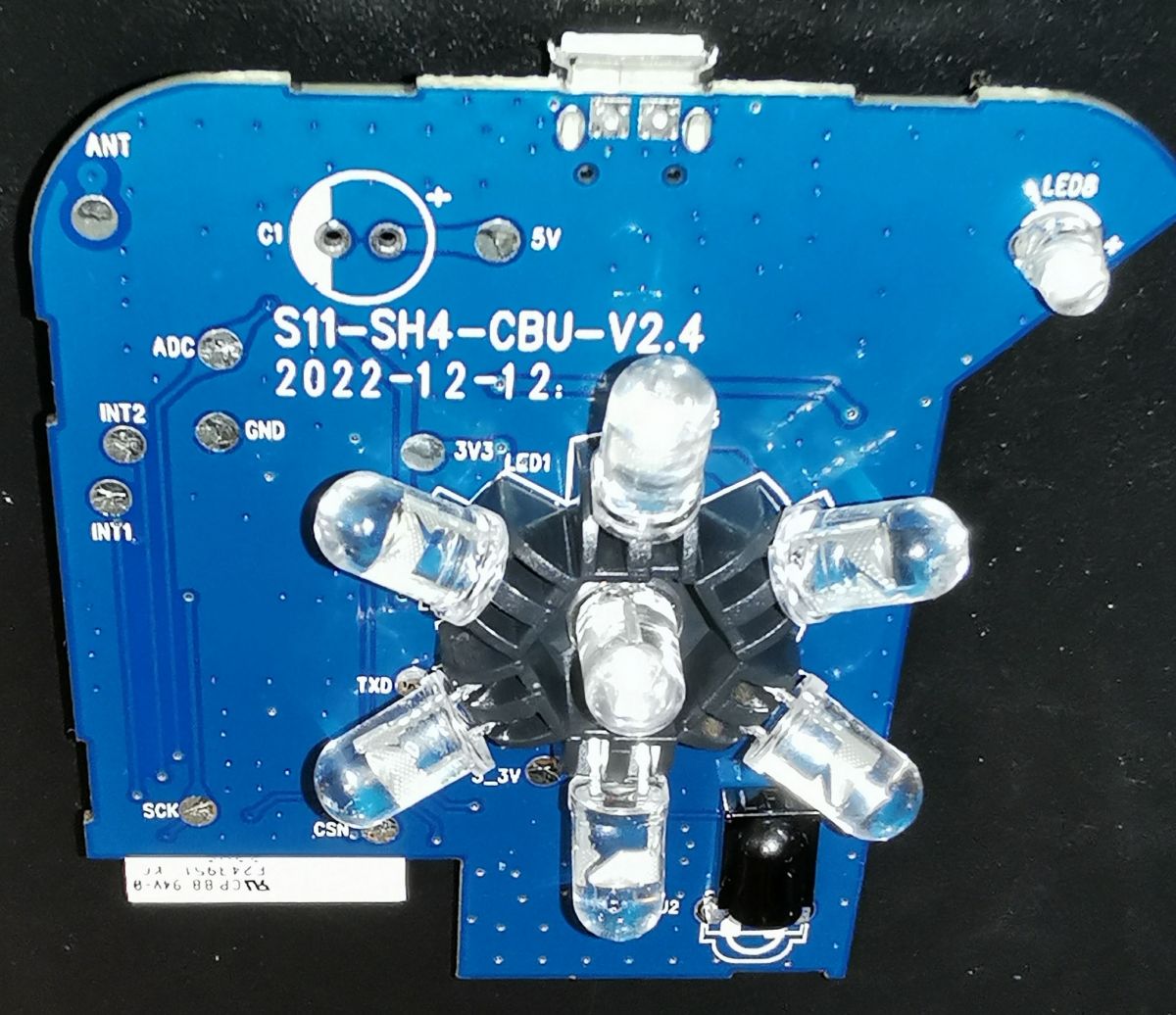

    Pinout:
    CBU PinBK7231NFunctionBoard TP
    1P14 (SPI_SCK)SH4 CLKSCK
    2P16 (SPI_MOSI)SH4 SDIO via R9
    3P20SH4 GPIO1INT1
    4P22SH4 GPIO2INT2
    5ADCButton via RC networkADC
    6RX2
    7TX2
    8P8IR receiver
    9P7IR tx
    10P6
    11P26
    12P24
    13GNDGNDGND
    143V33V33V3
    15TX1TXD
    16RX1RXD
    17P28
    18CENCEN
    19P9Status LED
    20P17 (SPI_MISO)SH4 SDIO via (not populated) R18
    21P15 (SPI_CS)CSN

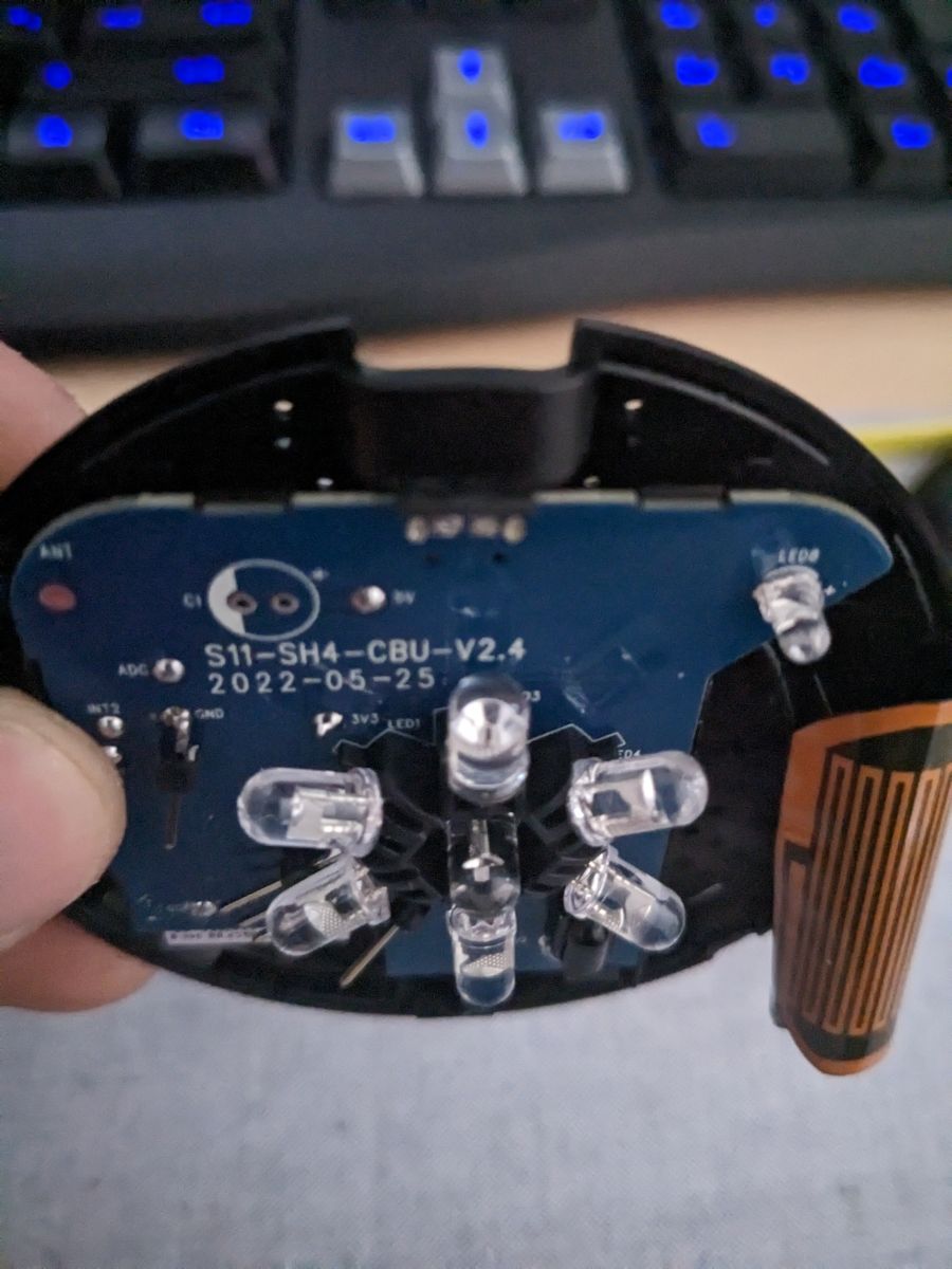

    The button is connected to ADC via a RC network:

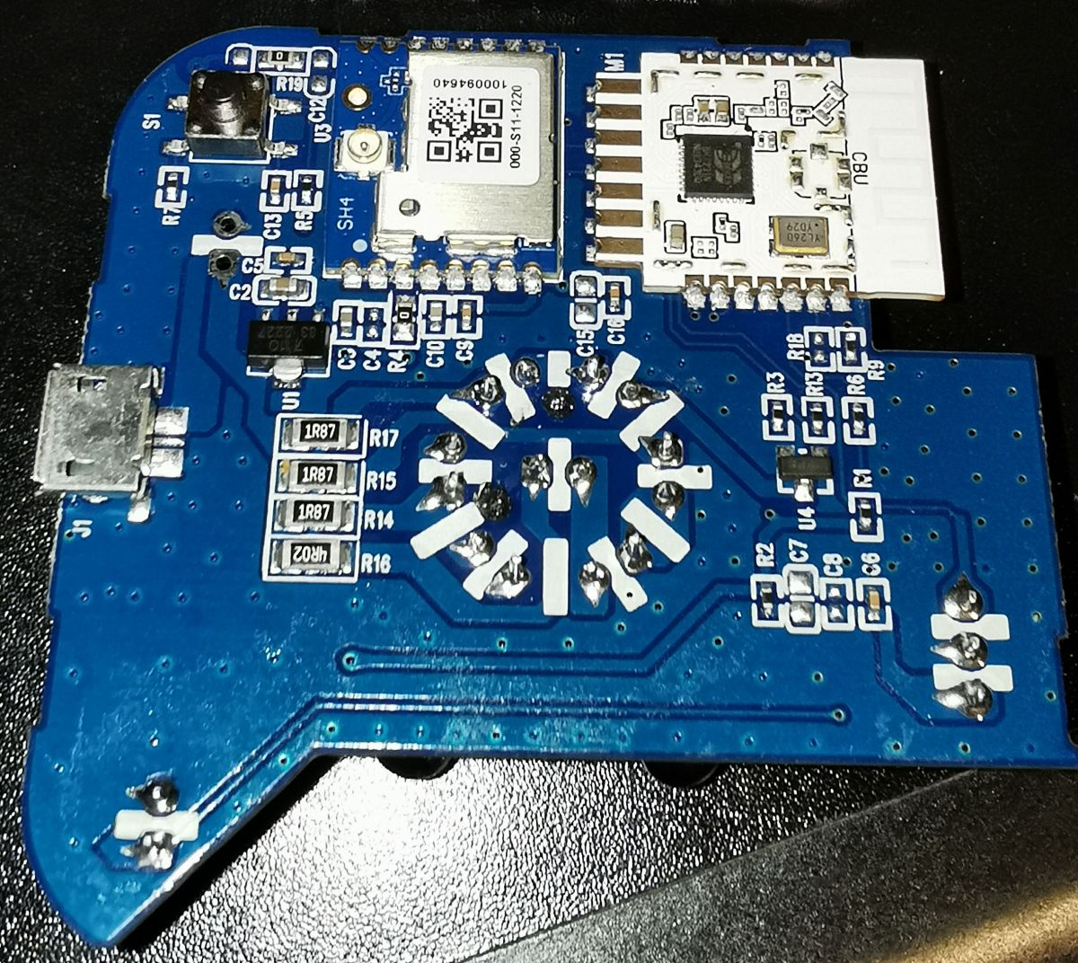

    As the IR section is identical to the well-covered S08 at https://www.elektroda.com/rtvforum/topic3920360.html I'm mainly focusing on the RF section.
    According to https://developer.tuya.com/en/docs/iot/sh4-module-datasheet?id=Ka04qyuydvubw the SH4 module is based around a CMTOV30-EQR chip. While I was not able to find information on this chip, CMOSTEK's CMT2300 has a suspiciously similar part number (CMT2300A-EQR) and the same pinout. Looking at the SPI traffic it looks like the register map is the same as well.
    The SH4 is connected to the CBU via 2 interrupt lines, 2 chip select lines, a clock line, and a bi-directional data line. Although the datasheet for the CMT chip says it can do SPI at 5 MHz, the CMU is only moving data at approximately 500 kHz. Looking at it with a logic analyzer it looks like they might be bit-banging the data instead of using the hardware SPI peripheral as the frequency changes slightly between sending and receiving:
    SPI traffic on boot: sh4-boot..b.csv (1.64 kB)You must be logged in to download this attachment.
    That's about as far as I've gotten so far. It looks like using this RF chip involves a whole lot of copying and pasting.

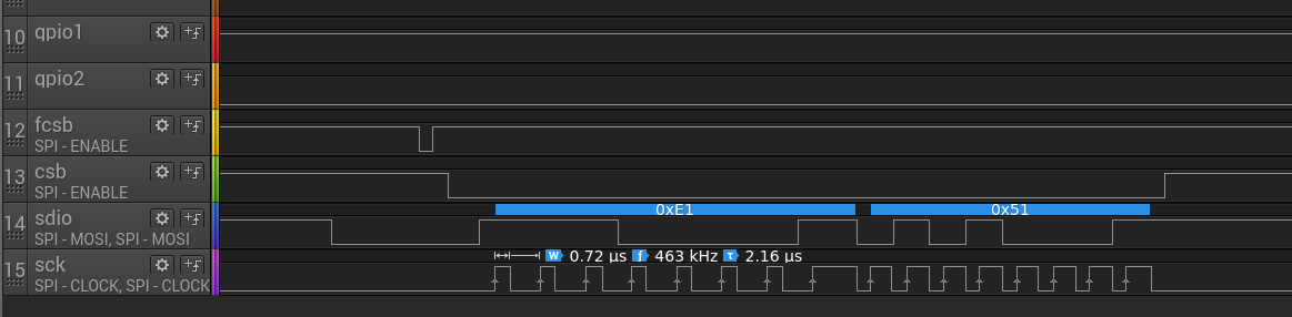

  • CMT2300A uses bidirectional SPI data line
    #3 20567166
    JustAnotherUser
    It's SPI, but it uses a bi-directional data line so the master needs to write the register address out on it and then change it to an input to read the response. It's described in the CMT2300A datasheet http://www.cmostek.com/download/CMT2300A-EN-Rev0.7.pdf page 27, and the register table is on page 40. Basically the CSB line goes low, the master writes 7 address bits plus the read/!write bit, and then either reads or writes 8 bits of data before setting CSB high again.

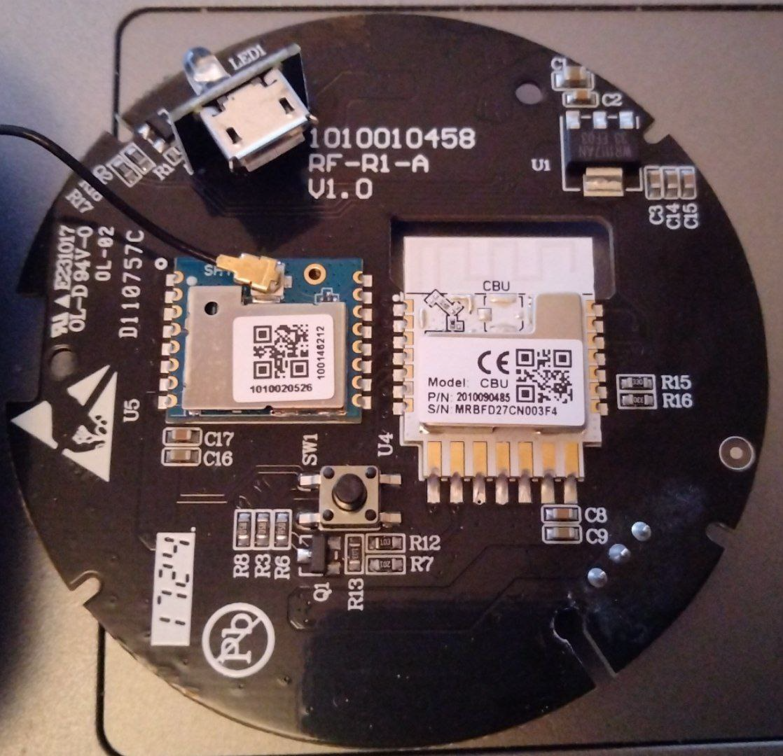

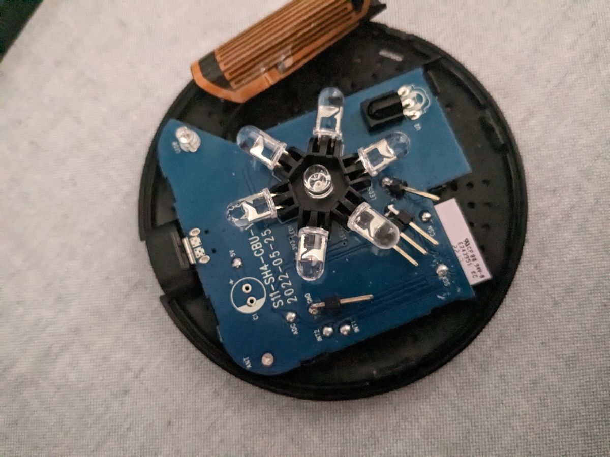

    Mini diagram for non-square CBU/BK7231N board

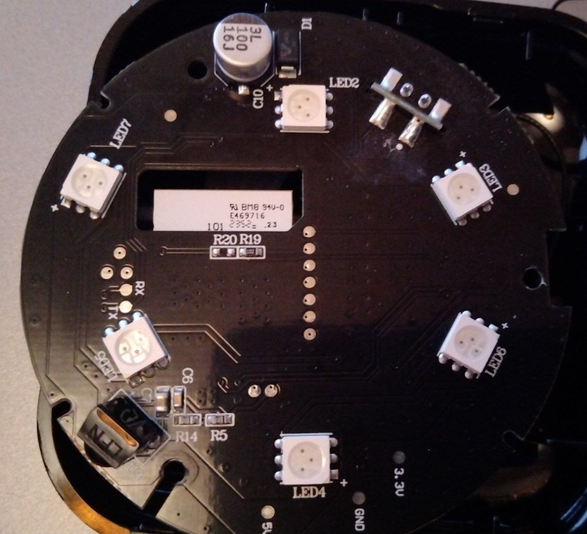

    #10 20734835
    romsenin
    Hi, i have the same board but my device is not square.
    Black circular electronic device with Bluetooth, WiFi, and Tuya labels, featuring IR and RF433 functions.
    I confirm that it use CBU/BK7231N and SH4/CMTOV30
    I have draw a mini diagram
      │                      CBU                                            │                  SH4
      └───────► │ P14                 P15  │                                │           │ NC       ANT │
      ┌───────► │ P16                 P17  │                                │           │ GPIO3     NC │
      │ ┌─────► │ P20                  P9  │ LED                            │           │ GND      GND │
      │ │   ┌─► │ P22                 CEN  │                                └────────── │ SCLK      NC │
      │ │   │   │ ADC                 P28  │                                      ┌──── │ SDIO      NC │
      │ │   │   │ RX2                 RX1  │                                  ┌───┼──── │ CSB    GPIO1 │ ────────────────┐
      │ │   │   │            P P G 3       │                                  │   │     │              │                 │
      │ │   │   │ TX2  P P P 2 2 N V  TX1  │                              ┌───┼───┼──── │ FCSB   GPIO2 │ ─────────────┐  │
      │ │   │   │      8 7 6 6 4 D 3       │                              │   │   │     │              │              │  │
      │ │   │   │                          │                              │   │   │     │ VCC      GND │              │  │
      │ │   │          I I ▲ ▲                                            │   │   │     └──────────────┘              │  │
      │ │   │          R R │ └────────────────────────────────────────────┘   │   │                                   │  │
      │ │   │          R T └──────────────────────────────────────────────────┘   │                                   │  │
      │ │   │          X X                                                        │                                   │  │
    Also the CBU use the 3 wires SPI (SDIO) protocol to communicate with SH4.
    And in the log when we use the RF is mention "CMT2300A_IsExist" so it seems that we can use the CMT2300A as reference.
    On the product page of CMT2300A, there is two demo with some source code (where there is a function "CMT2300A_IsExist"):
    * CMT2300A_DemoEasy_v1.2
    * CMT2300A_Demo(STM32)V1.0.1
    I don't know if this can help you and if we can use it in OpenSource project, let me know.

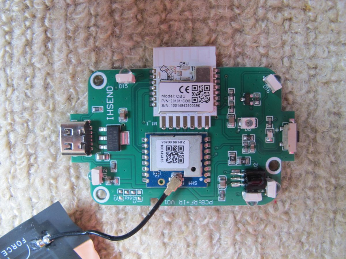

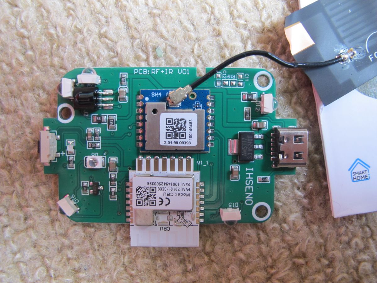

    I just got a moes UFO-R2-RF and it uses the same CBU/SH4 combo. I didn't check (yet) if the connections are the same. (edit: I checked now and they seem to match).
    Any progress on this module?
    Electronic board with CBU modules and antenna Image of a circular printed circuit board with various electronic components such as LEDs and capacitors.

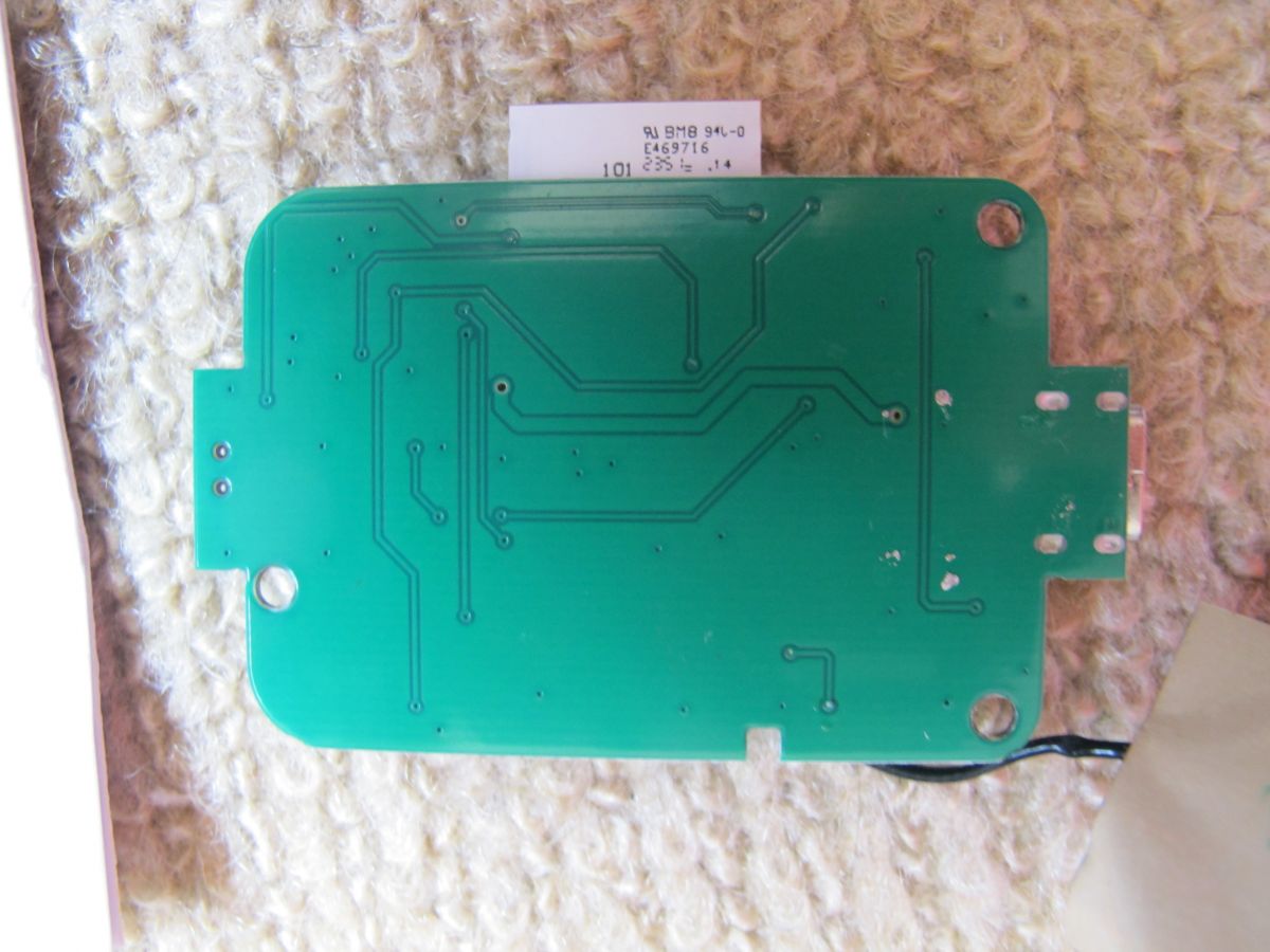

  • Direct spi capture enables direct mode control
    #20 21181007

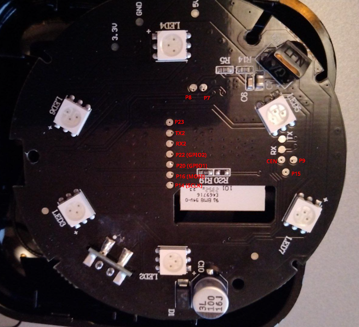

    olivluca
    Posts: 16
    I bit the bullet, soldered some more cables and captured the spi communication of the original firmware.
    Now sending mostly works (sometimes I have to repeat the same button more than once before it is received), receiving is still not working.
    Oh, and the trick is to use direct mode, avoiding the decoding/encoding on the cmt2300a and its fifo.
    Edit: I labeled the test points, P6 (CSB) and P16 (FCSB) are not available on this side of the pcb, you have to get them from the cpu on the other side.
    Circuit board with test point markings and LEDs

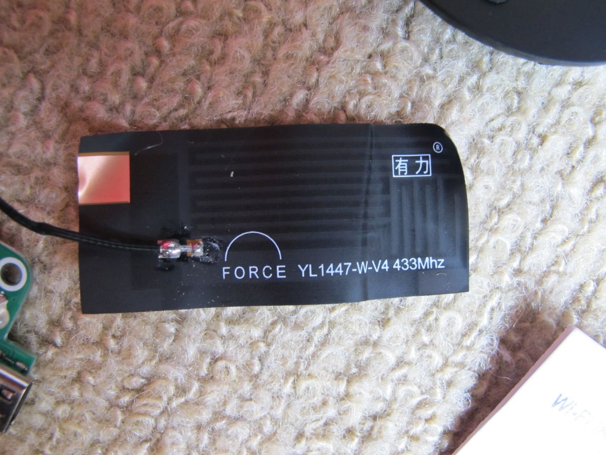

  • Flexible aerial pad on the back of the circular unit

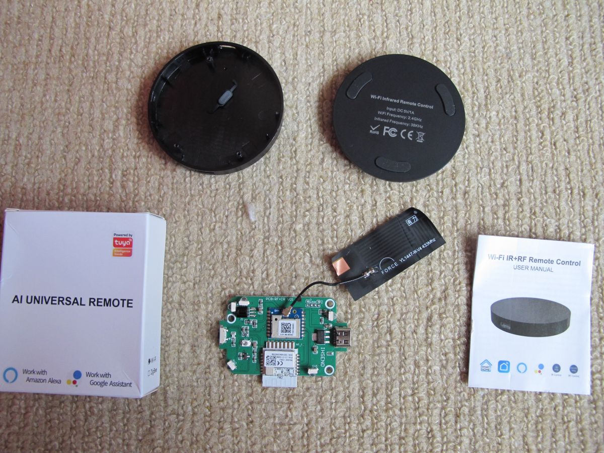

    #23 21234412
    Posts: 5216
    Help: 448
    Rate: 917
    Circular type. Interesting flexible aerial pad stuck to the back
    Circuit board with electronic components and communication modules. Green, rectangular printed circuit board with visible traces on a beige background. Black flexible antenna pad YL1447-W-V4 433MHz with FORCE written on it, placed on a carpet. Electronic board with components including a module marked with QR codes. Components of AI universal remote with Wi-Fi IR+RF, including manual, electronics, and box.

  • The CBU module exposes 21 listed pins; key RF lines include P14 SCLK, P16 SDIO through R9, P15 CSN, P20 INT1, and P22 INT2. [#20566501]
  • The SH4 link uses about 500 kHz in captures, although the referenced CMT chip datasheet allows 5 MHz SPI. [#20566501]
  • Power and service points include 3V3 on CBU pin 14, GND on pin 13, TXD on pin 15, and RXD on pin 16. [#20566501]
  • A failed hid_download_py attempt dumped only the first 1.2 MB before the BK7231N device became unresponsive. [#20595929]
  • RFPK can export CMT2300A register values for parameter files, but the thread reports no working reverse conversion from registers back to radio settings. [#21164026]
What pinout does the CBU/BK7231N module use in the S11 Wi-Fi IR+RF remote with the SH4 RF module?
The S11 maps the 21-pin CBU to SH4 RF, IR, UART, LED, ADC, power, and reset lines. RF uses P14 as SH4 CLK, P16 as SH4 SDIO through R9, P20 as GPIO1/INT1, P22 as GPIO2/INT2, and P15 as CSN. IR uses P8 for receiver and P7 for transmitter. The status LED sits on P9. UART flashing points are TX1/TXD on pin 15 and RX1/RXD on pin 16. Power is 3V3 on pin 14 and GND on pin 13. [#20566501]

How can I capture SPI traffic from the original S11 firmware to reverse engineer the SH4/CMT2300A RF module?
Attach a logic analyzer to SH4 SCLK, SDIO, CSB, FCSB, and interrupt lines while the original firmware boots or learns RF codes. The first capture in the thread recorded SPI traffic on boot. Later work added more soldered wires and captured original firmware communication during RF use. Capture both transmit and learn actions, because parameter sets can change by mode. Keep the original firmware installed until you record the register writes and direct-mode timing. [#21181007]
