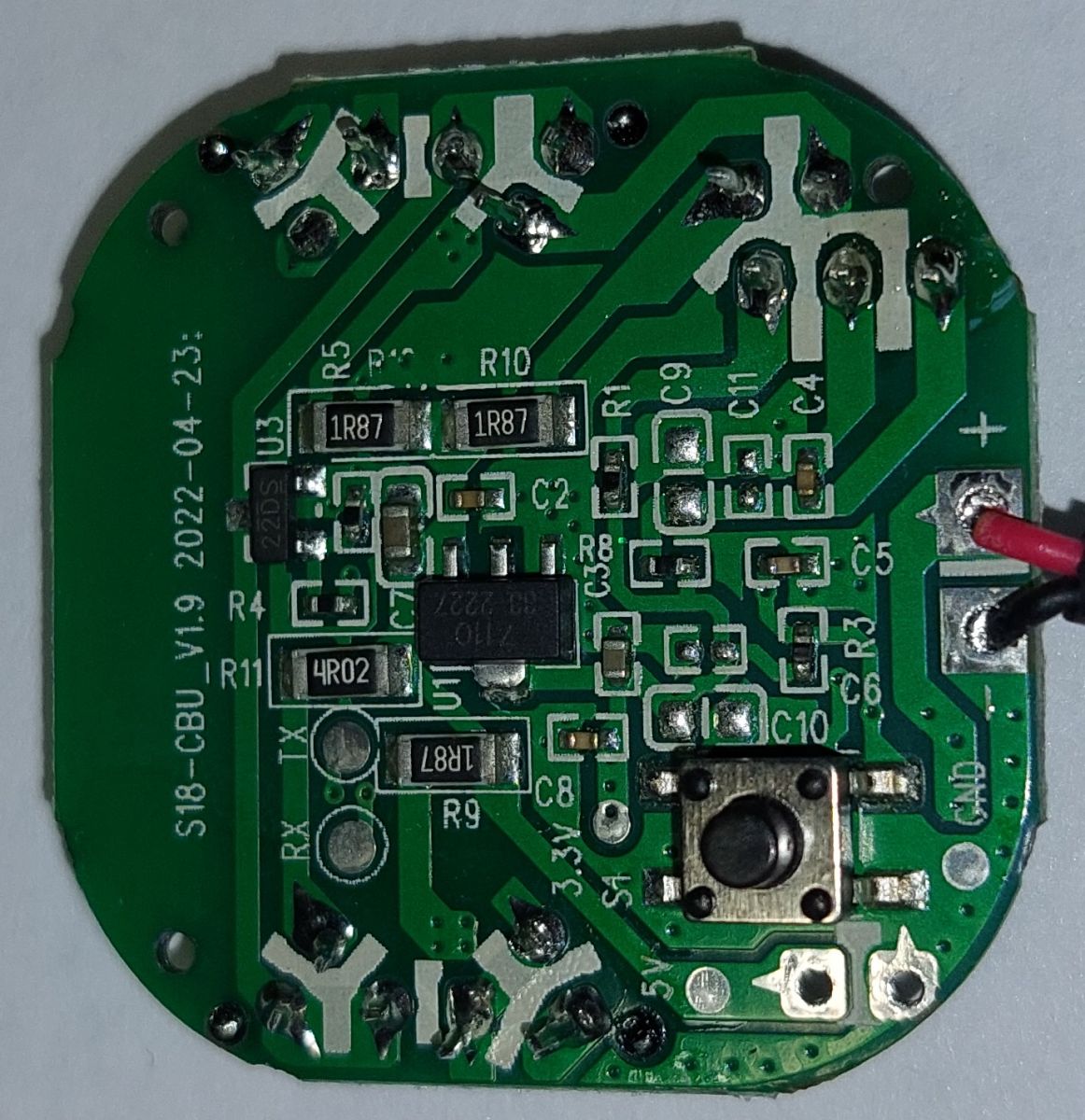

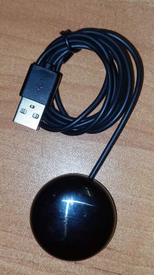

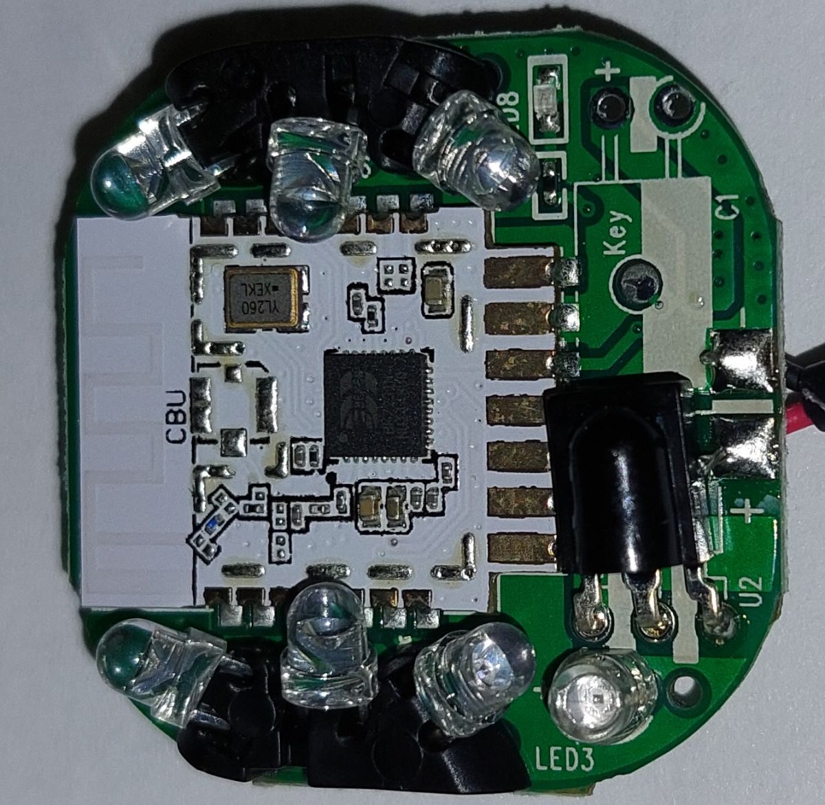

  • Mini Universal IR Remote M-18 based on the CBU module with BK7231N.
  • Firmware flashing uses the standard procedure with wires soldered to the marked pads on the board.
  • The unit measures 40 mm in diameter and 15 mm thick, and it uses a two-core power cable about 1 m long.
  • Pin mapping includes P8 for the IR receiver, P7 for the IR transmitter, P24 for the LED, and P26 for the button.
  • Reset requires shorting the CEN output to GND, and soldering is awkward because the LED lens sits very close to the pads.
  • Modul CBU, BK7231N
    Device dimensions: diameter 40 mm, thickness 15 mm.
    The power cable is two-core, about 1 m, non-pluggable.
    For firmware - standard procedure, soldered to the pads marked on the board.
    To reset, the CEN output, soldered the output to gnd, when starting the firmware, I touch the module output directly, because it is problematic to solder, the LED lens is in the immediate vicinity.
    Matching contacts:
    P8 - IR receiver
    P7 - IR transmitter
    P24 - led
    P26 - button

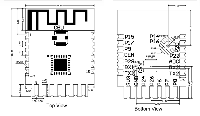

  • #3 20327367
    Pawek881
    hi, i have the same chipset to flash. can you tell me if your points on the rx and tx board are connected to the CBU to tx1/rx2 or tx2/rx2? because I have to connect directly to the CBU.
  • #4 20327551
    Posts: 14676
    Help: 656
    Rate: 12700
    RX1/TX1 is used for flashing and TX2 is a debug log output

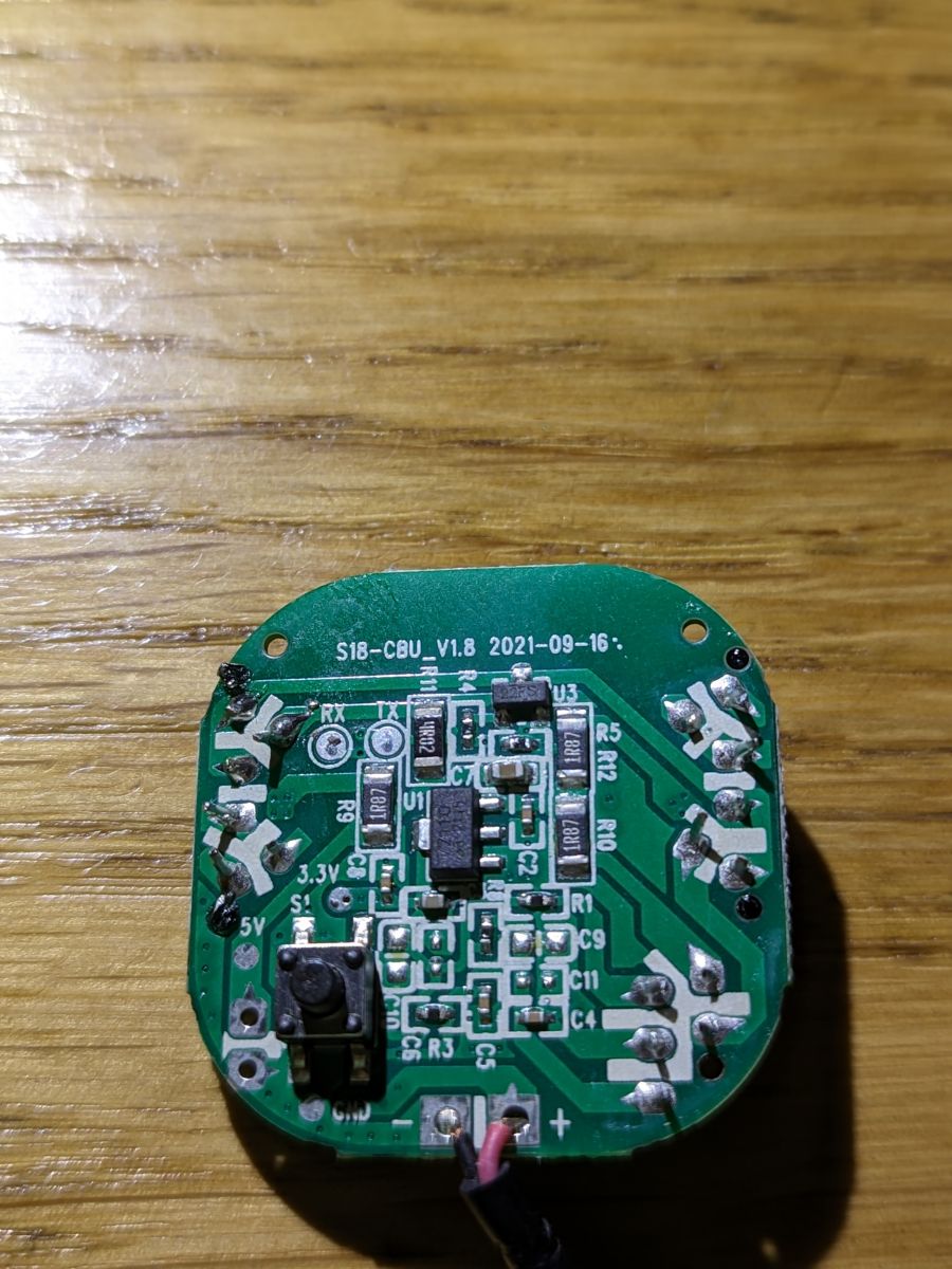

    #6 21297552
    sipe
    Hello all,

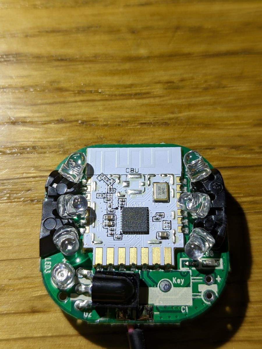

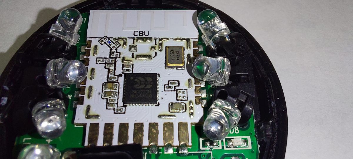

    I need help with this device to see if its properly configured or maybe defective.
    I got it flashed with tuya-cloudcutter, then flashed via OTA to version 1.17.767
    My pins configuration are
    "7": "IRSend;0",
    "8": "IRRecv;0",
    "24": "LED;0",
    "26": "Btn;0"
    And everything is working except IRSend. I tried Samsung TV and lamp remote, there is no light output on mobile camera (front or back).
    Button, Wifi LED and IRRecv all works perfectly fine, I can receive IR, toggle wifiled and button press is visible in Logs.
    Triggering in GPIO PIN 7 does not light up LEDs.
    Can someone recommend what to test out? I'm sending simple NEC IRSend which is read fine from device
    Debug:IR:IR decode returned true, protocol 7
    Debug:IR:Address=0x80 Command=0x1
    Debug:IR: Raw-Data=0xFE017F80
    Debug:IR: 32 bits
    Debug:IR: LSB first
    Debug:IR:IR decode returned true, protocol NEC (7)
    Info:IR:IR IR_NEC 0x80 0x1 0 (32 bits)
    Debug:IR:IR fire event took 0ms
    Debug:IR:Repeat
    Debug:IR: Gap 40050us
    Info:IR:IR IR_NEC 0x80 0x1 1 (0 bits)
    Info:IR:IR send NEC 0x80 0x1 0 protocol 7 addr 0x80 cmd 0x1 repeats 0 bits override 0
    No light output and no response from lamp.
    Close-up of a circuit board labeled S18-CBU_V1.8 2021-09-16. Electronic circuit board with several LEDs on a wooden surface.
  • #7 21297597
    Posts: 14676
    Help: 656
    Rate: 12700
    Maybe IR Send LED requires an extra pin to be set to High? How is it connected?
  • #8 21297614
    sipe
    >>21297597
    I'm not sure, everything should be the same as in first post, how I can check how it's connected?
