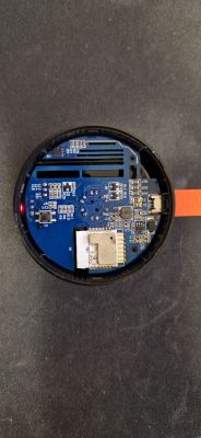

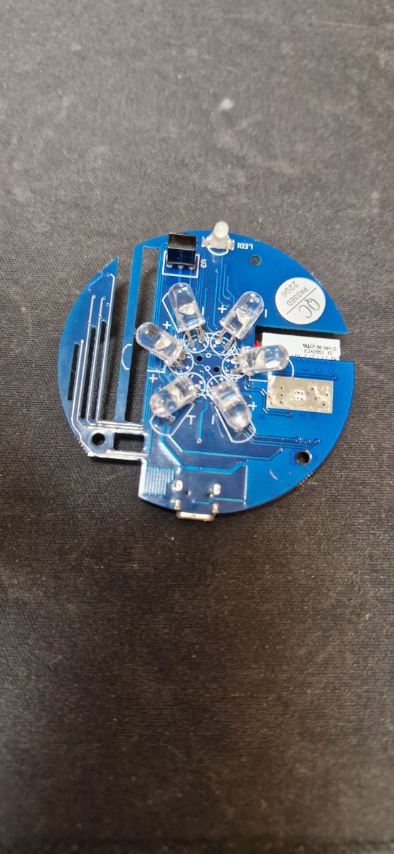

    Here is a short teardown of a generic IR controller with CBU module and CHT8305 temperature sensor. Sorry now links or prices but it looks very similar to this topic - https://www.elektroda.com/rtvforum/topic3933390.html#20348190
    Easy to open and disassemble:
    [BK7321N] IR smart receiver with CHT8305 sensor with CBU module [BK7321N] IR smart receiver with CHT8305 sensor with CBU module

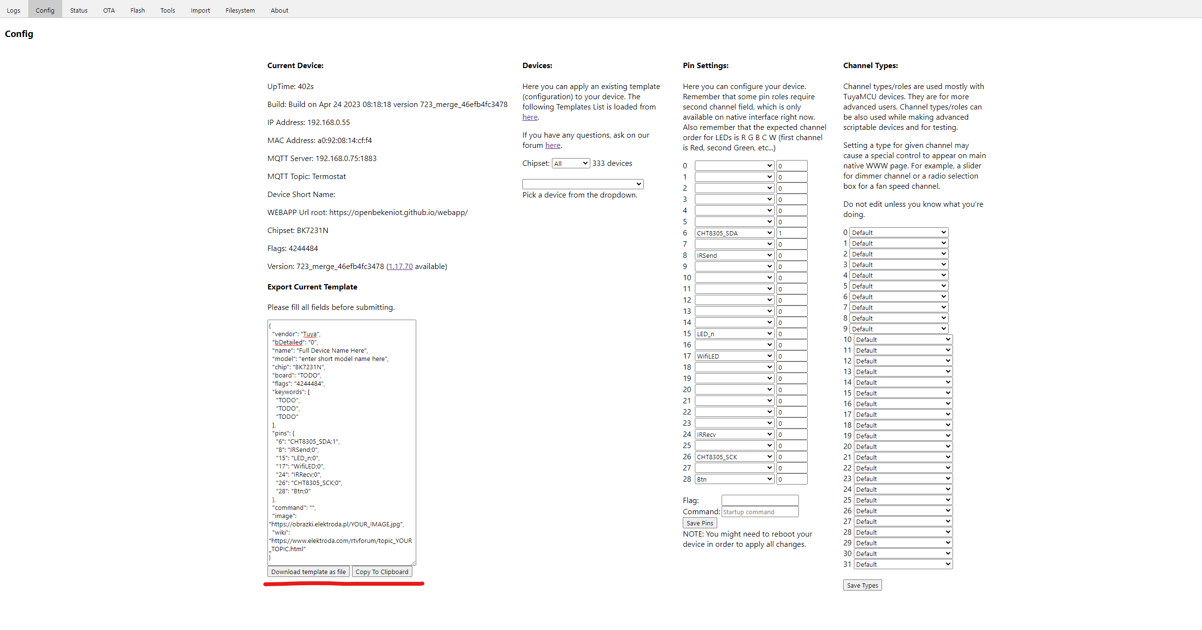

    You can now use new features in the web app to get the templates and save them locally, this is mine for this device
    also see here is the working config:
      "vendor": "Tuya",
      "bDetailed": "0",
      "chip": "BK7231N",
      "board": "TODO",
      "flags": "4244484",
      "keywords": [
        "TODO",
        "TODO",
        "TODO"
      "pins": {
        "6": "CHT8305_SDA;1",
        "8": "IRSend;0",
        "15": "LED_n;0",
        "17": "WifiLED;0",
        "24": "IRRecv;0",
        "26": "CHT8305_SCK;0",
        "28": "Btn;0"

  • Test CH8305 GPIO with two separate channels
    #10 20585942
    Posts: 14765
    Rate: 12899
    I am totally confused right now.
    I understand your description (I was wrong at first, so I cleared some posts) but still confused.
    Okay, let's do one test. Please clear all pins (maybe even reset whole device, if that's not a problem - ClearConfig command), configure it via AP again, and then, set ONLY CH8305 GPIO in the Configure module.
    Remember, set also two channels for CH8305 (two separate channels), and then post a screenshot and check.
