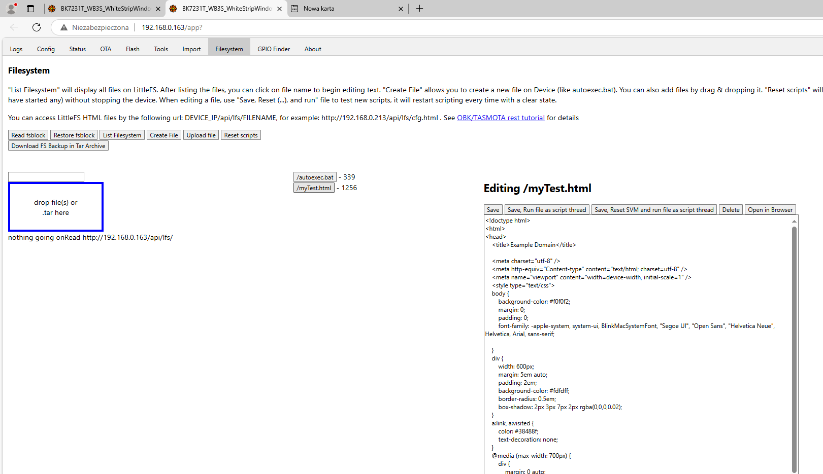

    SendGet command downloads URL to file
    #2 21509927
    Posts: 14749
    Rate: 12849
    I haven't tested this in a long time, but in the code I have:
    // SendGet http://192.168.0.112/cm?cmnd=Power0%20Toggle
    // addRepeatingEvent 5 -1 SendGet http://192.168.0.112/cm?cmnd=Power0%20Toggle
    // addEventHandler OnClick 8 SendGet http://192.168.0.112/cm?cmnd=Power0%20Toggle
    // Following command will just send get:
    // SendGet http://example.com/
    // Following command will send get and save result to file:
    // SendGet http://example.com/ myFile.html
    // test code: addRepeatingEvent 30 -1 SendGet http://example.com/ myFile.html
    Let's try...
    SendGET http://example.com/ myTest.html
    Screenshot of the LittleFS management panel viewed in a web browser.
    it works for me, something downloaded.
  • #3 21509985
    uszatekmis
    Posts: 22
    Actually it works as it should, but in the documentation there is only one argument given - TargetURL :-) maybe it is worth adding a second optional one there?
