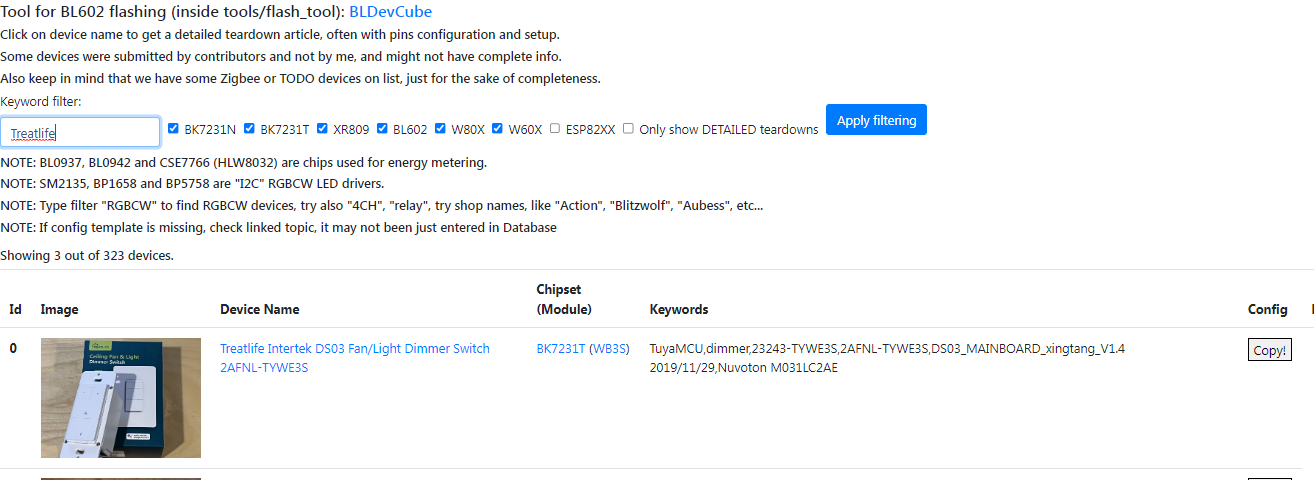

    First, you can search our detailed teardowns list, here:
    Here you can use various filters to browse devices list effectively, you can also click device name to get more or less detailed guide and discussion topic open:

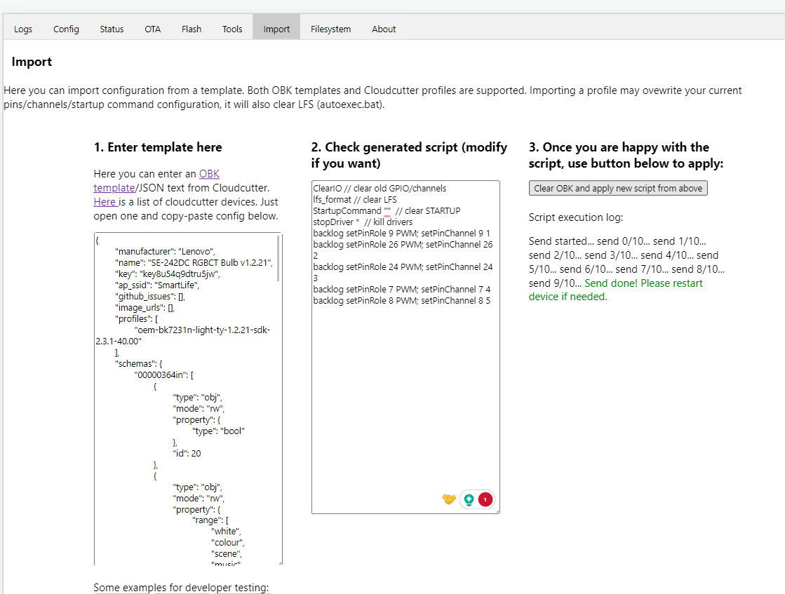

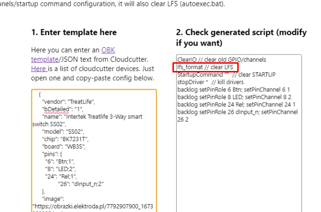

    Now we assume that you have copied your device JSON profile, either from OpenBeken list (use Copy button) or from Cloudcutter.
    Those profiles are in different format, but can be very easily imported to OpenBeken.

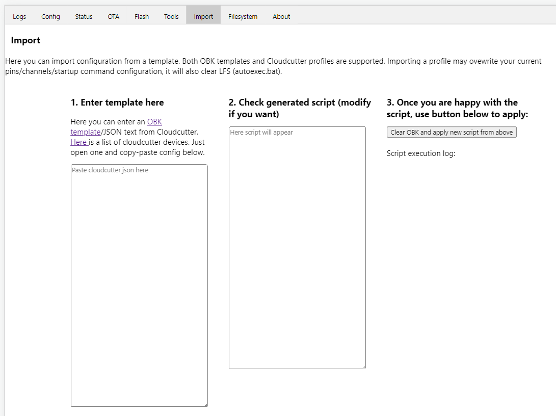

    On OBK device, open Web Application and then Import tab:
    How to import OpenBeken/Cloudcutter templates - automatic GPIO/device configuration
    Here you can paste the JSON config. Multiple JSON formats are supported. Please paste to first field (step 1). JSON will be converted to OBK commands in the second column (step 2).

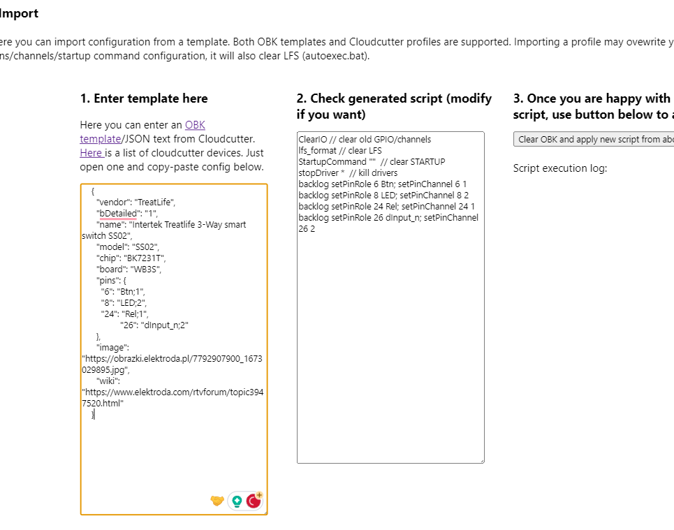

    You can modify resulting script if you want. For example, you can change commands. Once you are happy, press the big apply script button. Here is a correct import:

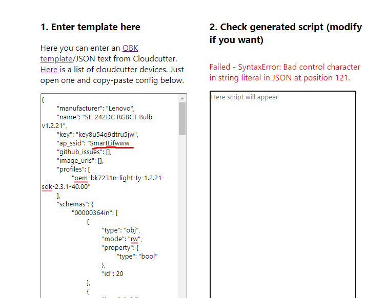

    The import field features error detection. It will show an error if pasted JSON is invalid:

    OpenBeken JSON template format also works:

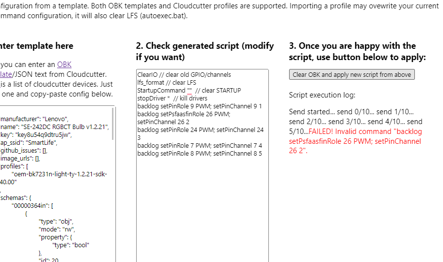

    Both text fields have error checking implemented.
    If you edit command manually and do a typo, you will get a failure during execution:

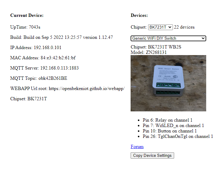

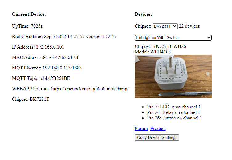

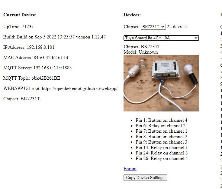

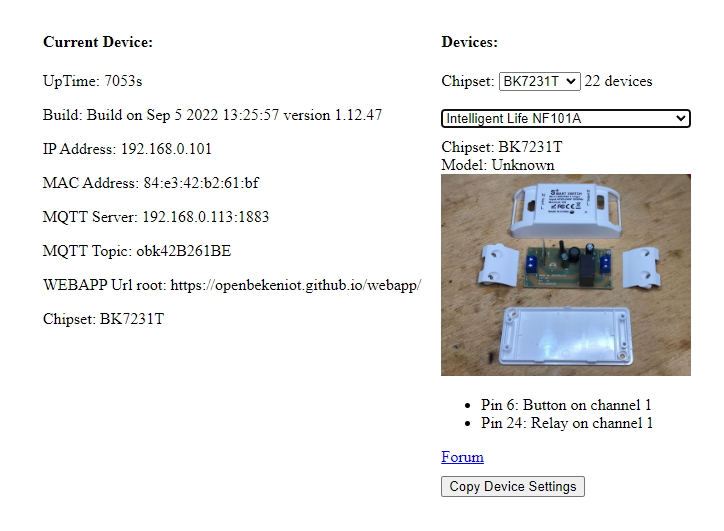

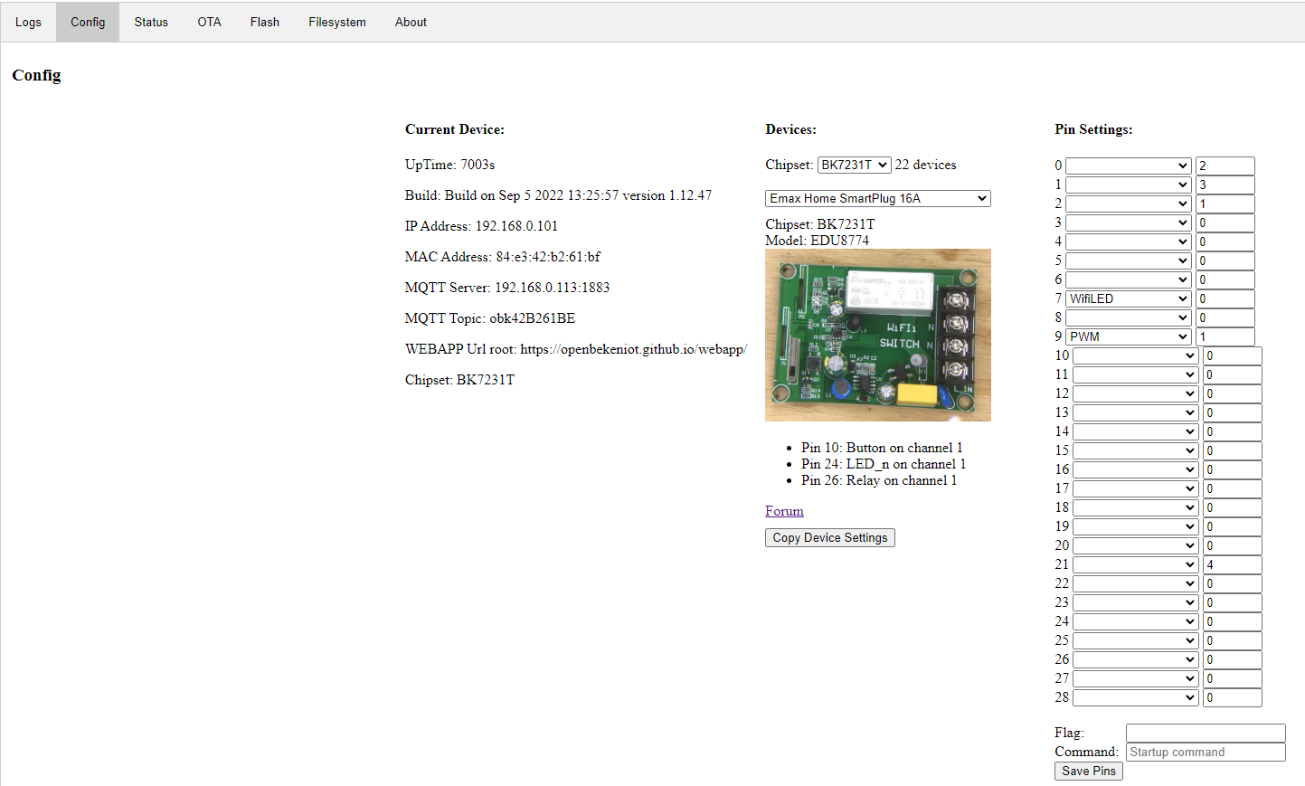

    Don't forget that you can just select device from drop down list on OBK Web Application. There you can also automatically import template, even without doing copy+paste:

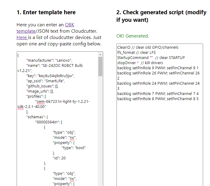

    Just to mention that you need latest OBK build (1.17.29 at the time of writing) for this to work.
    One thing to note if you are importing JSON files, it will purge the autoexec.bat so make sure to back it up if you have it on your device!!
    To do that go to filesystem tab on web app, click List Filesystem and if present click on Download Tar of FS and save it to a known location.
  • #3 20552305
    Posts: 14771
    Rate: 12914
    Very good point. It is, however, also useful to notice that the autogenerated script in second column includes lfs_format command:
    so, if desired,this command can be just removed before execution.

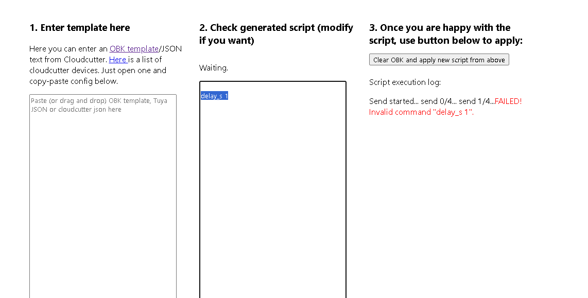

    mvz0209
    Posts: 20
    Please tell me, the compiler does not want to process simple commands: delay_s 1, waitFor MQTTState 1, waitFor NTPState 1
    User interface with a script editor showing a command error.

    Posts: 14771
    Rate: 12914
    This is a template importer, not the autoexec.bat runner. You should create autoexec.bat in LittleFS:
    You can write it like:
    delay_s 1
    waitFor MQTTState 1
  • #6 21297855

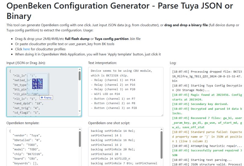

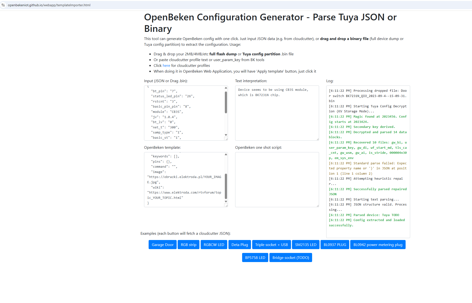

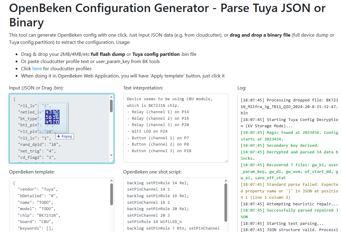

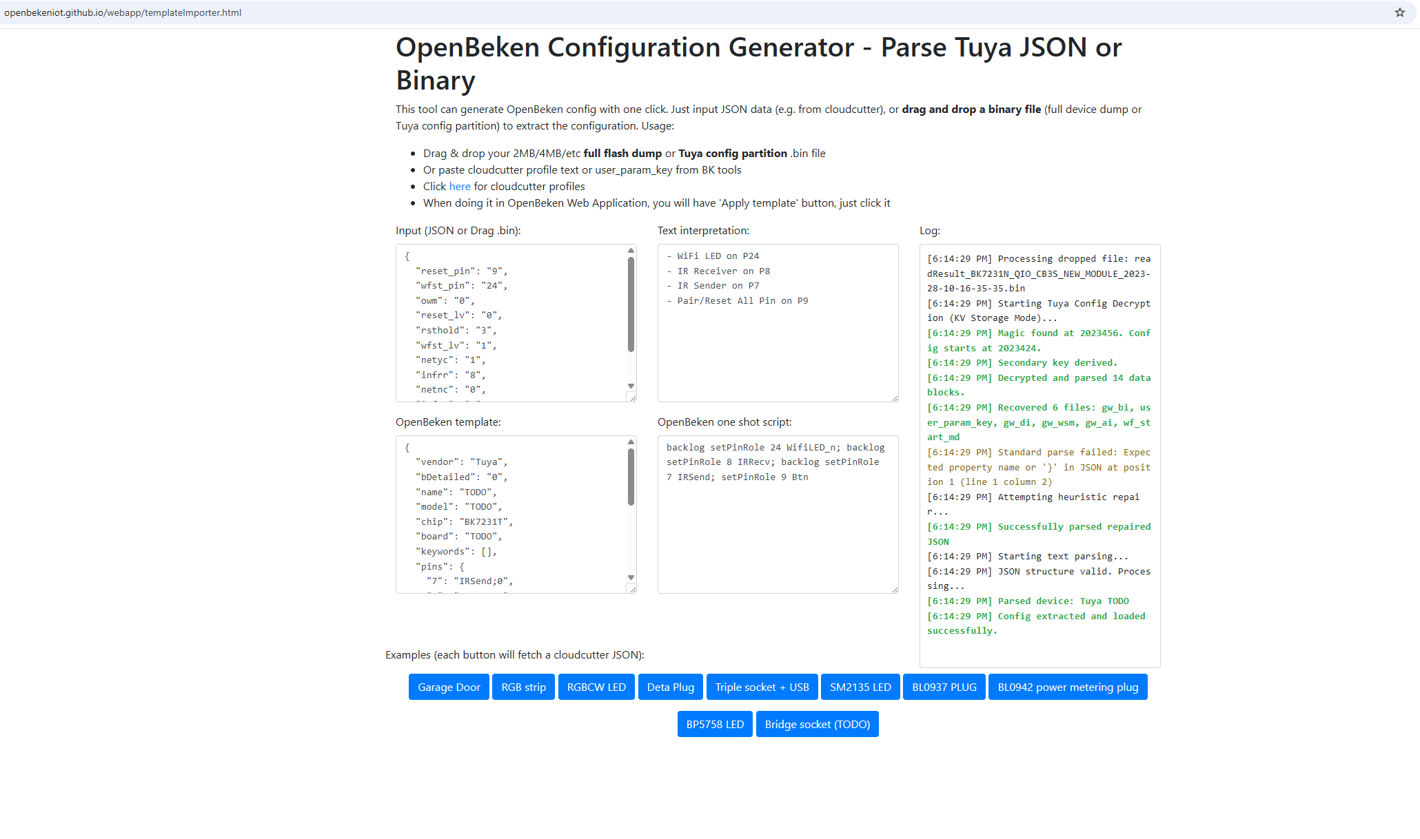

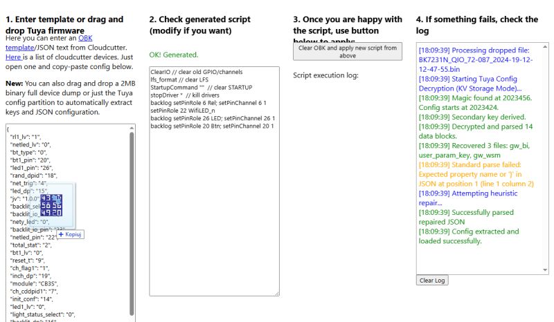

    Web App can now import tuya config from 2MB dump directly, can anyone help testing? @divadiow @insmod @max4elektroda @DeDaMrAz
    OpenBeken configuration generator with JSON input and text interpretation
    https://openbekeniot.github.io/webapp/templateImporter.html
    Tuya configuration interface with generated script and decoding log

    Posts: 5220
    Help: 449
    Rate: 918
    Good work. But damn. I have a load of revisions in web app in a pr coming soon ;)

    @divadiow please open pr and test it and merge asap so we don't get merge conflicts
  • #12 21818560
    Posts: 14771
    Rate: 12914
    Can you show screenshots and brief summary, if possible?

How does the OpenBeken web app import Tuya configuration directly from a 2MB firmware dump?
The web app can extract Tuya configuration from a 2 MB firmware dump and feed it into the template importer. This feature appeared in the thread on 2026-01-24, with a request for testing. A tester reported that it worked at first glance, with more testing planned. [#21818501]
