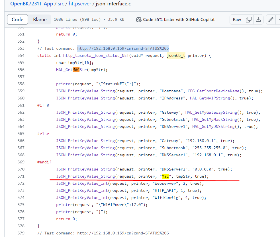

  • #3 21141567
    andresmorago
    Hello and thanks for your reply and information.
    One Quick question while I check for your posted advises and sorry if I have missed it: how can I extract the device MAC address with a command?
    I am considering a REST method (POST) instead of using MQTT and I would like to include the MAC address inside the payload
  • #4 21141571
    Posts: 14782
    Rate: 12920
    Device MAC address is always shown at the bottom side of HTTP page. It's also published via MQTT after reboot.
  • #5 21141582
    andresmorago
    Indeed, but is there a command to store the MAC address on a variable so I can send it inside the payload of an API rest?
    Custom function to publish MQTT with MAC address
    #6 21141642
    Posts: 14782
    Rate: 12920
    We have some constants for scripts but MAC is not present:
    https://github.com/openshwprojects/OpenBK7231T_App/blob/main/docs/constants.md
    However, you can easily create a custom function to do that:
    Code: C / C++
    The code above is not tested but shoud work, more or less...
    and if you want REST API, you can also check Tasmota STATUS packet support, it can already return MAC address and some more data

    Added after 14 [minutes]:
    Here is a sample of OBK Tasmota-compatible JSON command which can return MAC:
    http://192.168.0.159/cm?cmnd=STATUS%205
    See what is returned:
    Screenshot of C code in the json_interface.c file from the OpenBK7231T_App project on GitHub.
