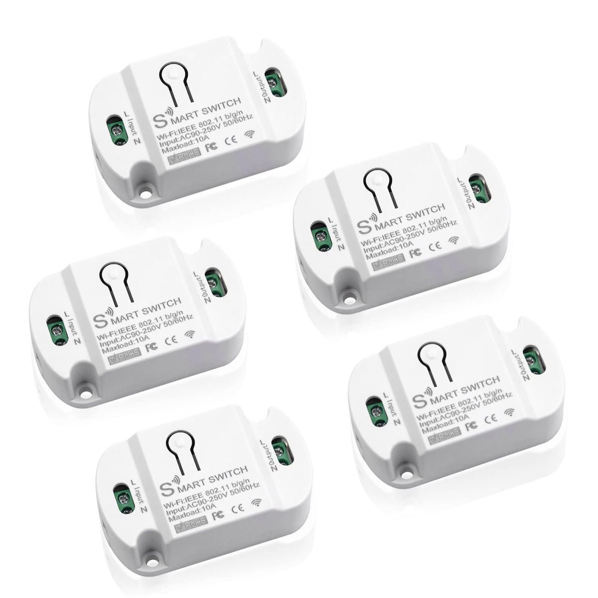

    I have a hot water recirculating pump that I was earlier operating using smart-life scenes. The routine failed if there was an internet outage at any triggers. I also did not want the pump to needlessly run 24/7. So, I converted it to OpenBeken. It was easy to open and see the marking on the chip. It wasn't glued. Used tuya-cloudcutter on this device and then wrote this autoexec.bat for it to work autonomously. More refinements with DST implementation and MQTT and HA are in my bucket list. Let me know if there are any suggestions to improve this:

    Five white Wi-Fi Smart Switch relays with labeling and screw terminal connectors.
    AI: Could you share the exact brand and model of your hot water recirculating pump or the Tuya-based device you converted to OpenBeken?
    1. Watts Hot Water Recirculation 120V Pump (0955800)
    2. 10A KR2201WB Wi-Fi Wireless Smart Basic Switch for Smart Home Smart Life APP Compatible with Alexa & Google Home Assistant No Hub Required
    AI: Are there any specific issues or limitations you've noticed with your current script, or are you mainly looking for general suggestions and best practices?
    I am using a manually changeable channel 11 for Daylight adjustments. I wish there was a way to compute and change to daylights automatically based on the NTP data. Or if there was an easy IF Endif combo that would allow me to to change DST time without any manual interventions.
