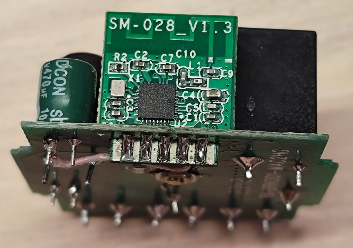

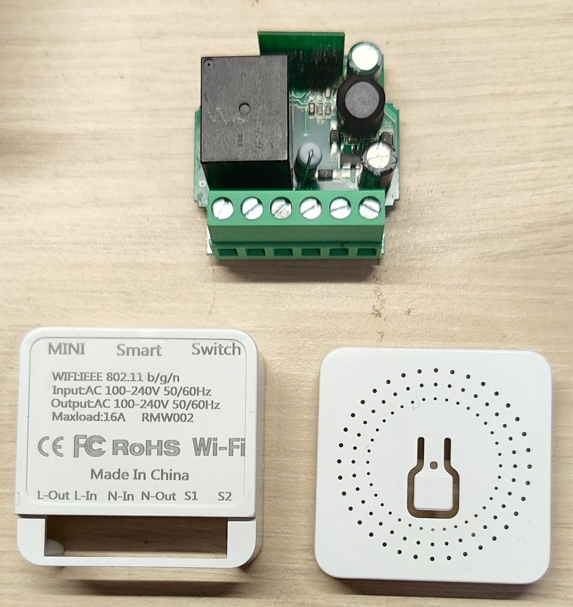

  • View of SM-028_V1.3 module PCB with BL602L20 chip. SM-028_V1.3 relay module with visible circuit board and components. SM-028_V1.3 module with BL602L20 chip on a circuit board. SM-028_V1.3 module with BL602L20 chip on a green PCB, featuring electronic components and a screw terminal. Image of SM-028_V1.3 module with BL602L20 chip showing RM-BRK001-MAC2HG marking.
    Relay based on SM-028_V1.3 module with BL602L20 chip.

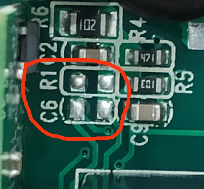

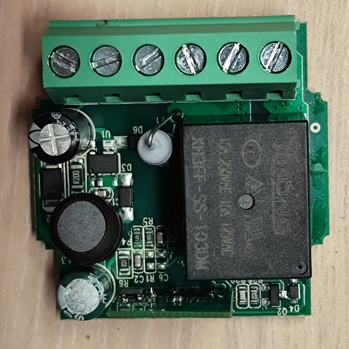

    These relays have a massive problem with the fact that they randomly turn the relay on and off. In order to fix this, you need to solder components C6 0.1 uF and R1 10 kOhm.
    Close-up of a PCB showing component locations for C6 and R1.
    For firmware, I unsoldered the SM-028_V1.3 module, connected the
    SM-028|UART
    TX--------RX
    RX--------TX
    GND-----GND
    3V3------3V
    BT--------3V module with the uart adapter, and then connected the uart adapter to the PC.
    I flashed it using the blflash program with the command '.\blflash-windows-amd64.exe' flash OpenBL602_1.17.402.bin --port COM7.

    pavlenkoblok wrote:
    To fix this, solder elements C6 0.1 mF and R1 10 kOhm in the place indicated in the photo.
    0.1 mF or maybe 0.1 uF ?

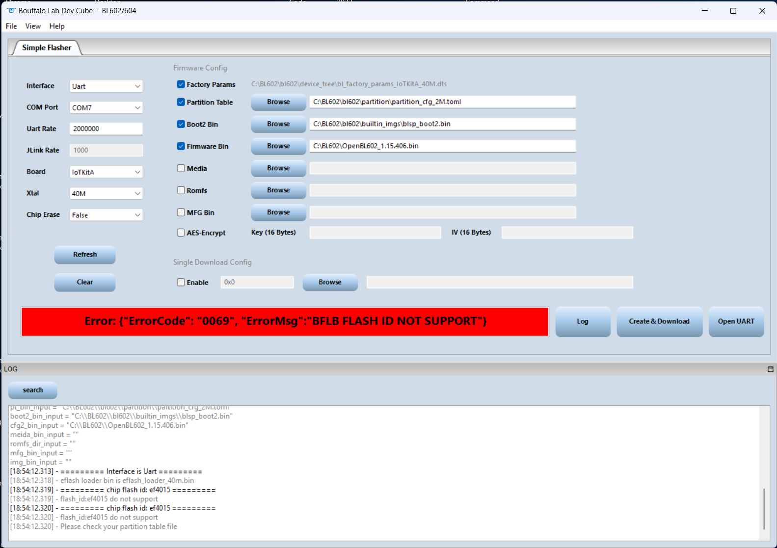

  • BLDevCube flashing error on BL602 module
    #13 20905651
    pavlenkoblok
    >>20904846

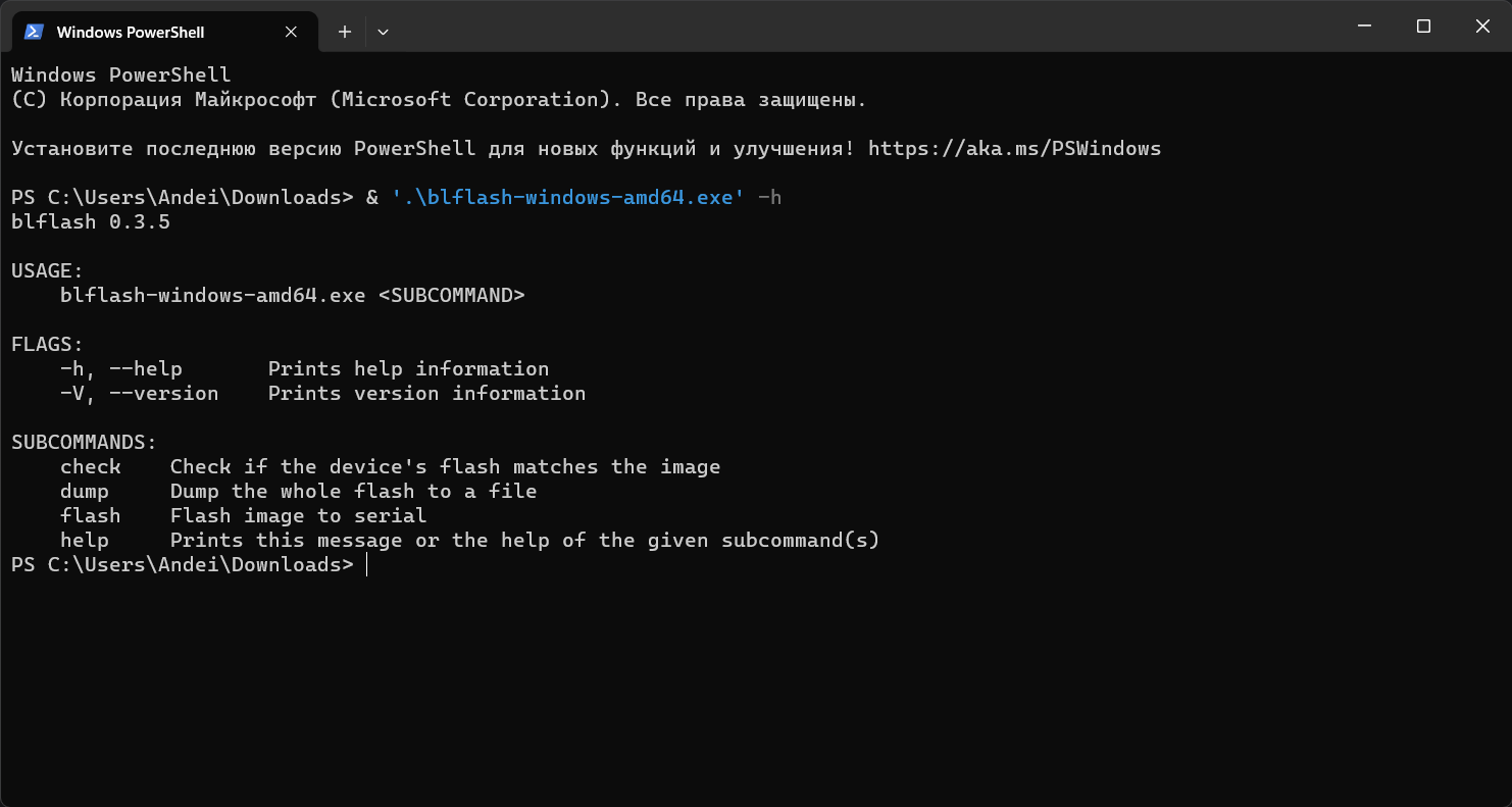

    by supported commands - can read flash
    Screenshot of Windows PowerShell showing help for the blFlash program.
    I couldn't flash it using BLDevCube.exe, it throws an error and I couldn't do anything about it.
    Screenshot of Bouffalo Lab Dev Cube program displaying a flashing error.

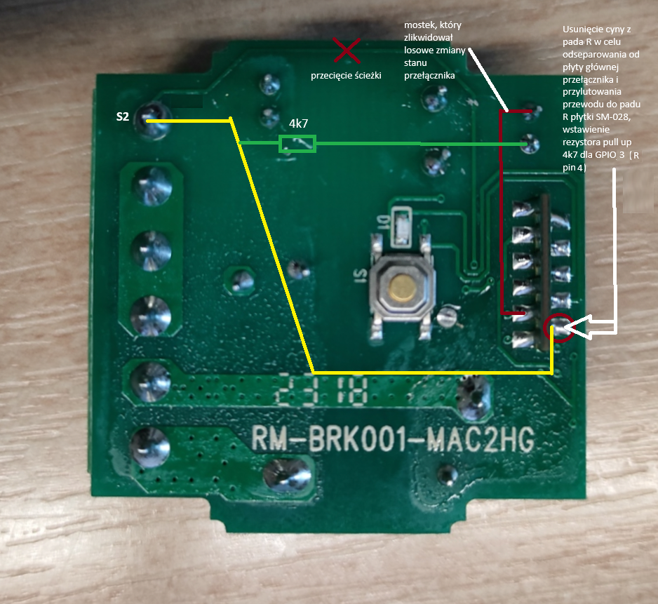

    Adinfo
    Posts: 26

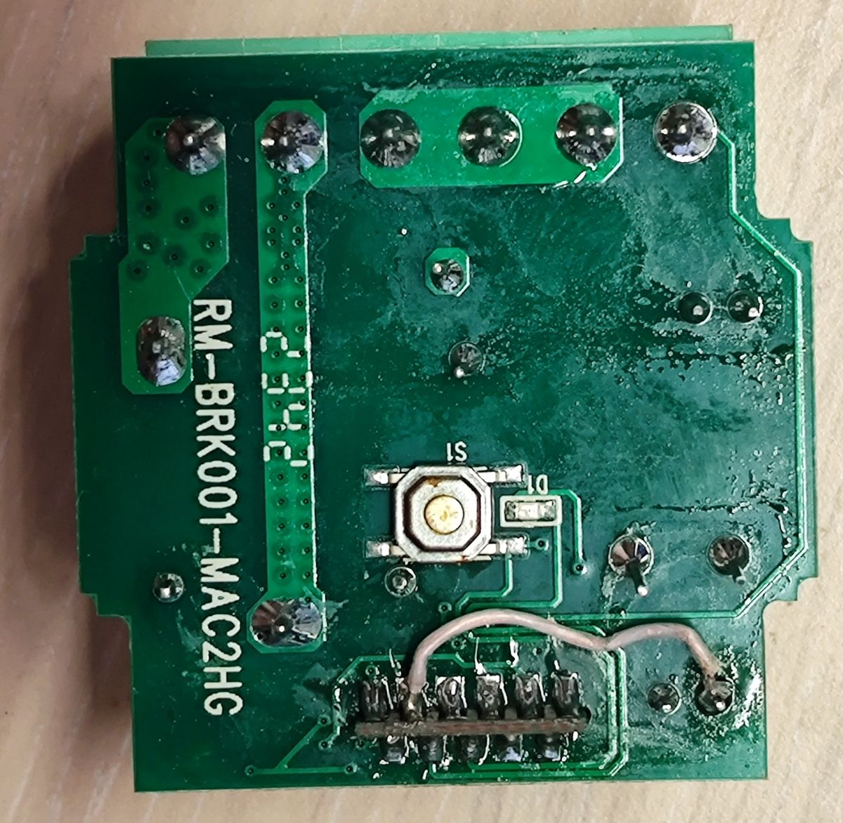

    Just today I came across this thread (after last week's reprogramming of such a switch as in the thread) I took to testing with the swapped firmware on OBK.
    Unfortunately, I did not get a response to shorting contacts S1 and S2. I changed the settings in the configuration to do so, but to no avail (I thought there was something corrupted). Unfortunately, I did not check the operation of contacts S1 and S2 beforehand - before reprogramming the circuit.
    I found out that something is wrong on the way from the connector with pin S2 and pad R in the SM-028 board. I removed excess tin from the pad marked R, which caused the disconnection of this path from the board with BL602. I found the thread https://www.elektroda.pl/rtvforum/topic3945435.html helpful. Thanks to this, GPIO_3 - pin 4 (R) and, in addition, for testing, also GPIO_2 - pin 3 (W) - both signals began to work correctly - the circuit responded to shorting with GND. I made a bridge between the pads of the R board and the via at S2 (as a precaution I inserted an additional pull up 4k7) and cut the path so that there were no elements on the way that caused the above-mentioned problem - in the circuit from the main PCB. After this operation, the circuit responds correctly to the shorting of S1 and S2.
    However, there were repeated random changes of state (transient) which caused frequent clicking and switching of the contactor (even a dozen times in a minute) - inserting a pull up resistor did not improve anything. Only the creation of a bridge between GND as in the first post of this thread solved the problem with the random change of state of the switch.
    I did not detect a short circuit, the resistance of the path on this section close to zero - full transition (not counting the leads from the meter). As for the components at the top of the board - resistor and capacitor - in my case they are factory-installed such as in the photos in the thread - but their presence does not improve the stability of the circuit at least at the time I tested, only the bridge I wrote about to GND stabilized the operation of the circuit.
    Drawing/view photo.
    Printed circuit board with marked connections, track cut, and pull-up resistor. .
  • Suggesting separate pull-up and pull-down module versions
    #16 20913377
    Posts: 14755
    Rate: 12877
    @Adinfo are you using the ToggleChannelOnToggle role here? Maybe it is indeed time to separate it into three versions (versions with pull up, with pull down and without pulls) and let users choose as required. Perhaps one of these versions would do better in the original configuration of this PCB.
    But in general it's hard for me to say more, I have such modules on BK7231 alone and on them nothing switches on its own (and I know, because I even have a night light on such and somehow it doesn't turn on by itself, exactly from this topic https://www.elektroda.pl/rtvforum/topic3895572.html )
  • ToggleChannelOnToggle role triggers state-change issue
    #17 20913404
    Adinfo
    Posts: 26
    @Adinfo are you using the ToggleChannelOnToggle role here? Maybe it is indeed time to separate it into three versions...
    Yes, I am using ToggleChannelOnToggle - in this case the problem occurred, when I changed for testing, for example, to Btn then the problem with changing the state was not observed. As for the idea with versions of ToggleChannelOnToggle is great, by the way, this topic came up today during a conversation with a friend who has seen the behavior of this switch - he just happens to have experience with ESP and there he is sometimes resorted to pull up from the level of software and internal capabilities of a particular circuit. I will try to do more tests because I have 7 more similar switches to the one in the thread (different PCB versions, but most on BK7231N and one under ZigBee). The plan is to use some staircase solutions with two mechanical switches and the others under single switches wired to S1 and S2.

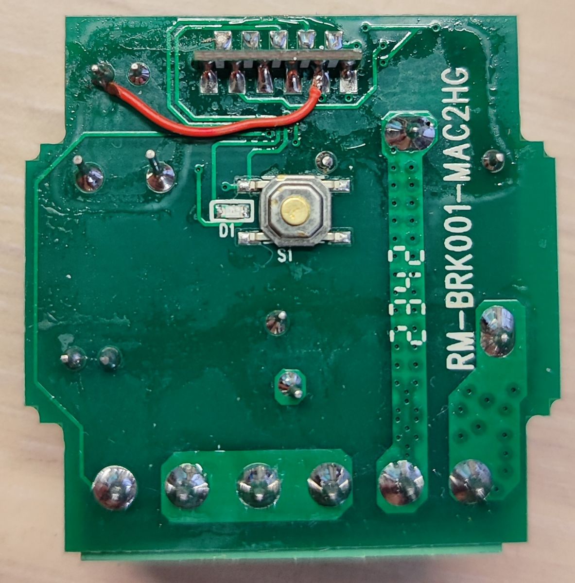

  • #18 21012867
    dhanushkadx
    Posts: 8
    I also have BK7231N chip and its also chnage the state of S1 so it makes the relay on and off randomly. I removed the on board buttons but the issue is exist. I ll try to add a pull out resistor.
  • #19 21013733

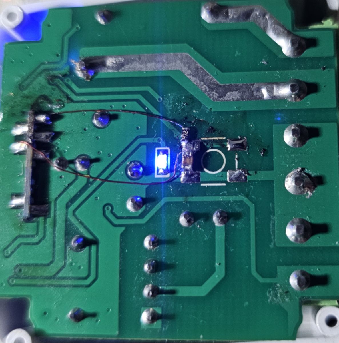

    dhanushkadx
    Posts: 8
    Circuit board with a blue LED and visible traces and solder joints.
    I made this external pulled up with 4.7k with 104 cap for low pass filter. It works 100%. Pcb down side button removed. My casing has no hole for downside button. BButton existence is not relevant to this problem . I think software pull up dosent seems to be worked. Laptop screen displaying logs and configuration for an electronic project.
