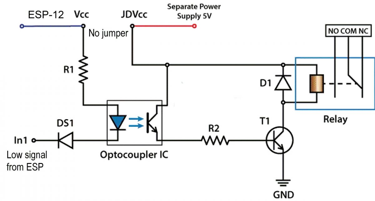

    I started by uploading the supli on the ESP, uploaded it all configured from the software side. I am attaching a diagram of how I have it wired up. According to the connection as in the diagram, only the ESP works for me, the relay does not work only when I put a jumper on VCC | JD-VCC and 5V+ is connected to VCC near IN6, but as far as I know, if I have a separate power supply for ESP and relay, it should be without a jumper. The problem is that when I connect something to the power strip or the second input in the socket (double socket), when I switch the device on and off (e.g. a bedside lamp or a fan) the set (ESP and relay) resets itself, it also happens that ESP switches off and I have to disconnect the power completely, wait and switch it on again. I have only marked the connections on the ESP-relay-lay diagram in colours so as not to make the diagram tangled.

    Well, you can see what happens in the network without filters when you switch devices on with a key.

    Check the supply voltages from the 5V and 3.3V inverters to see if either squats when the relays are servoed.

    I checked the power supply from the 5V inverter and there is actually a drop for a moment at 4.9V. On the 3.3V inverter I didn't notice a drop, but I suppose that could also be because they are on the same power supply

    Maybe add the 3.3V inverter ground to the control board. Also check that when controlling the ESP12 with the 5V inverter supply disconnected you have similar behaviour. Clearly something is resetting-your ESP.

    And with such a connection that the 2 inverters are on one power supply, isn't their ground shared? So the 3.3 V ground is also at the relays. I was also reminded of one more thing when switching the night light or fan, the diodes at the relays from their on state blink for a fraction of a second when switching.

    I finished the battles, today my D1 mini from aliexpress arrived I swapped the ESP-12 for the D1 mini and everything works fine. The conclusion is that the inexperienced should not order a bare ESP
