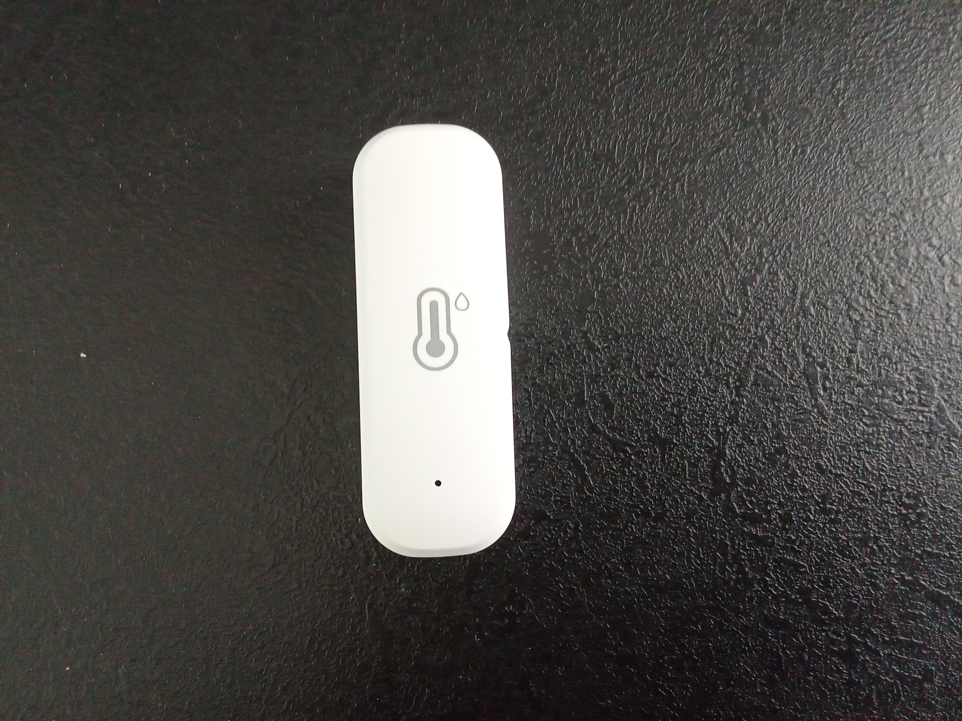

    I have a problem with a Wi-Fi temperature and humidity sensor, it does not want to pair.
    Out of the 5 sensors I bought 4 I can't pair, The blue LED on the fifth one lights up red and it found the device with no problem.

    • Wi-Fi temperature and humidity sensor - 4 out of 5 do not connect, blue LED on 1746455790966417393931477018788.jpg (4.53 MB) You must be logged in to download this attachment.

    When pairing, enable GPS on the smartphone and grant access for the app, without GPS it will not pair.
    The sensor only works in the 2.4 Ghz WiFi range.
    Check the power supply batteries for nominal voltage of 1.5 V.

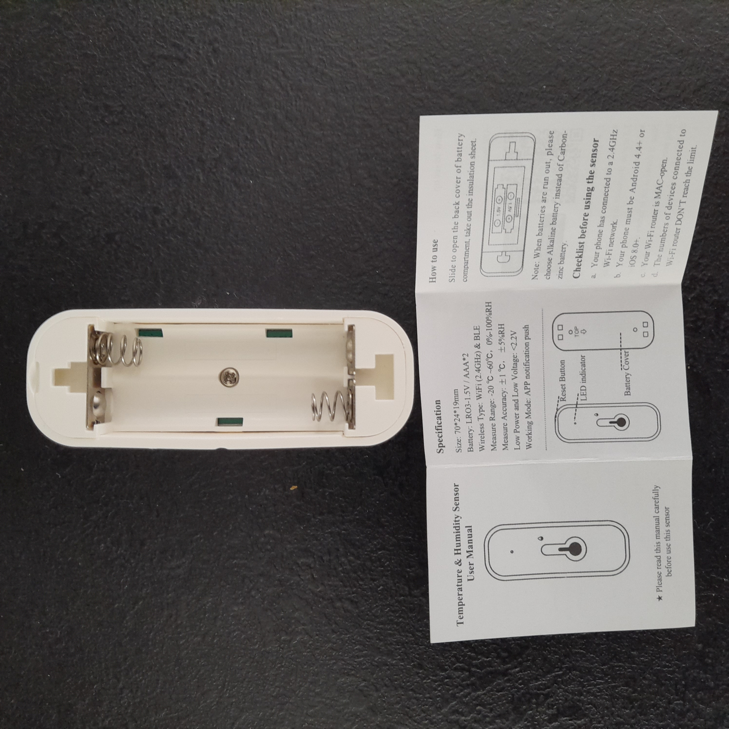

    Take a photo of the board from the battery side. In the instructions on page 1 will be the model name, e.g. Model: TH01
    From the link it looks like the sensors should work over Wi-Fi, that doesn't mean they sent you the model you ordered, maybe you got the model for ZigBee.
  • #9 21541770
    stasiek37
    Posts: 8
    Ok, I'll send it later.
    Added after 7 [hours] 25 [minutes]: .
    Temperature and humidity sensor with an open battery compartment and a user manual on a black surface. .
    • Wi-Fi temperature and humidity sensor - 4 out of 5 do not connect, blue LED on 20250507_160647.jpg (2.32 MB) You must be logged in to download this attachment.

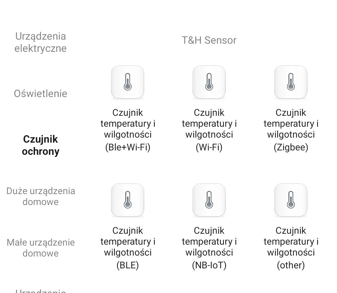

    It is not clear from the pictures what model it is. Disassemble the case and take a photo of the board.
    Try manually selecting the device type when pairing.
    Screenshot from an app showing different types of temperature and humidity sensors to select during device pairing. .

    By hand
    Information label on a box with product and manufacturer details for a temperature and humidity sensor. also tried, I am sending the model
