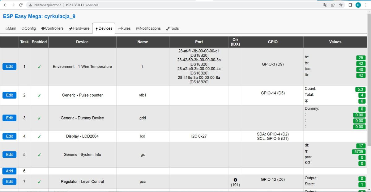

    Is there a command to disable the level control? In my case it is no.7 called pcc.
    If I want to disable the GPIO12 pin with the command GPIO,12,0 or GPIO,12,1, the relay returns to the position the regulator tells it to.
    I tried such a command, but it does not work:
    ControllerDisable,<pcc,7>
    https://espeasy.readthedocs.io/en/latest/Reference/Command.html
    https://www.letscontrolit.com/wiki/index.php/ESPEasy_Command_Reference
    https://espeasy.readthedocs.io/en/latest/Rules/Rules.html
    https://www.letscontrolit.com/wiki/index.php/Tutorial_Rules
    ESP Easy Mega device panel showing a list of seven configured tasks and devices. .

    Well,
    I've also been to this site, but I don't quite understand what I'm supposed to type in.
    levelcontrol,Remote,[1]
    But how is it supposed to know which device I am referring to ?
