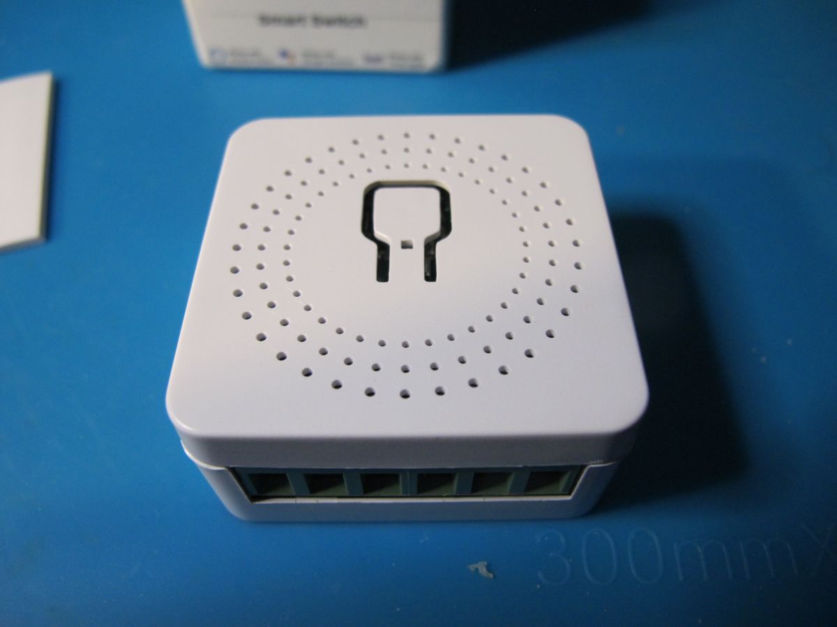

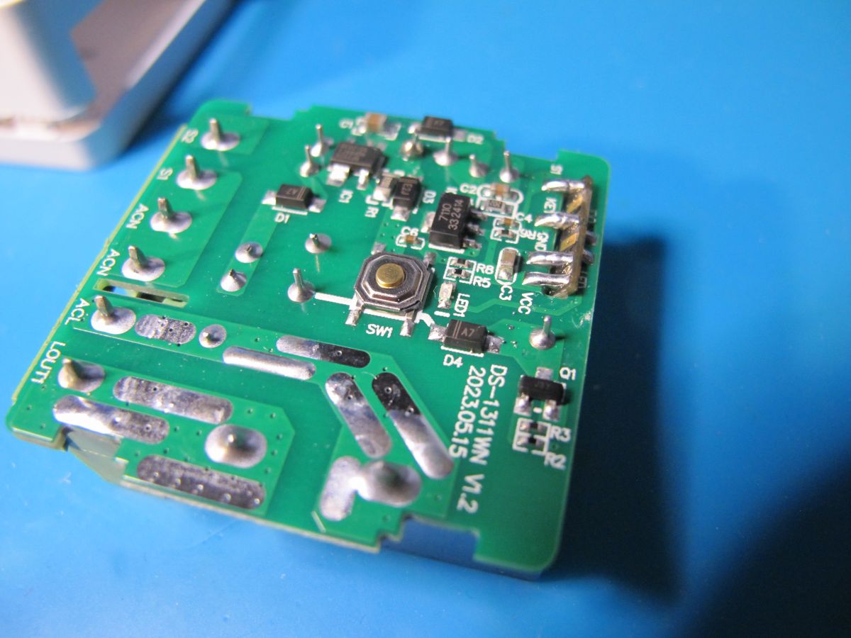

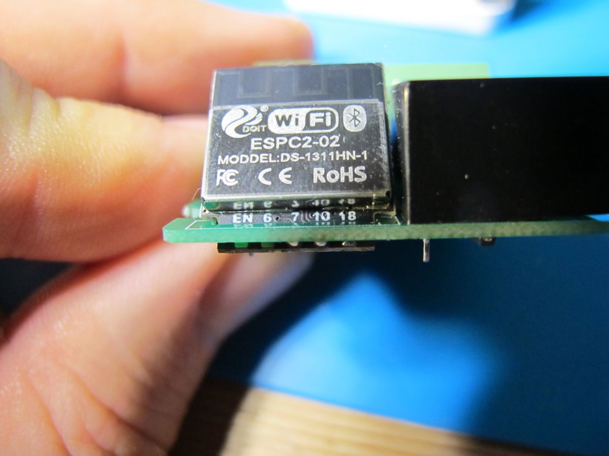

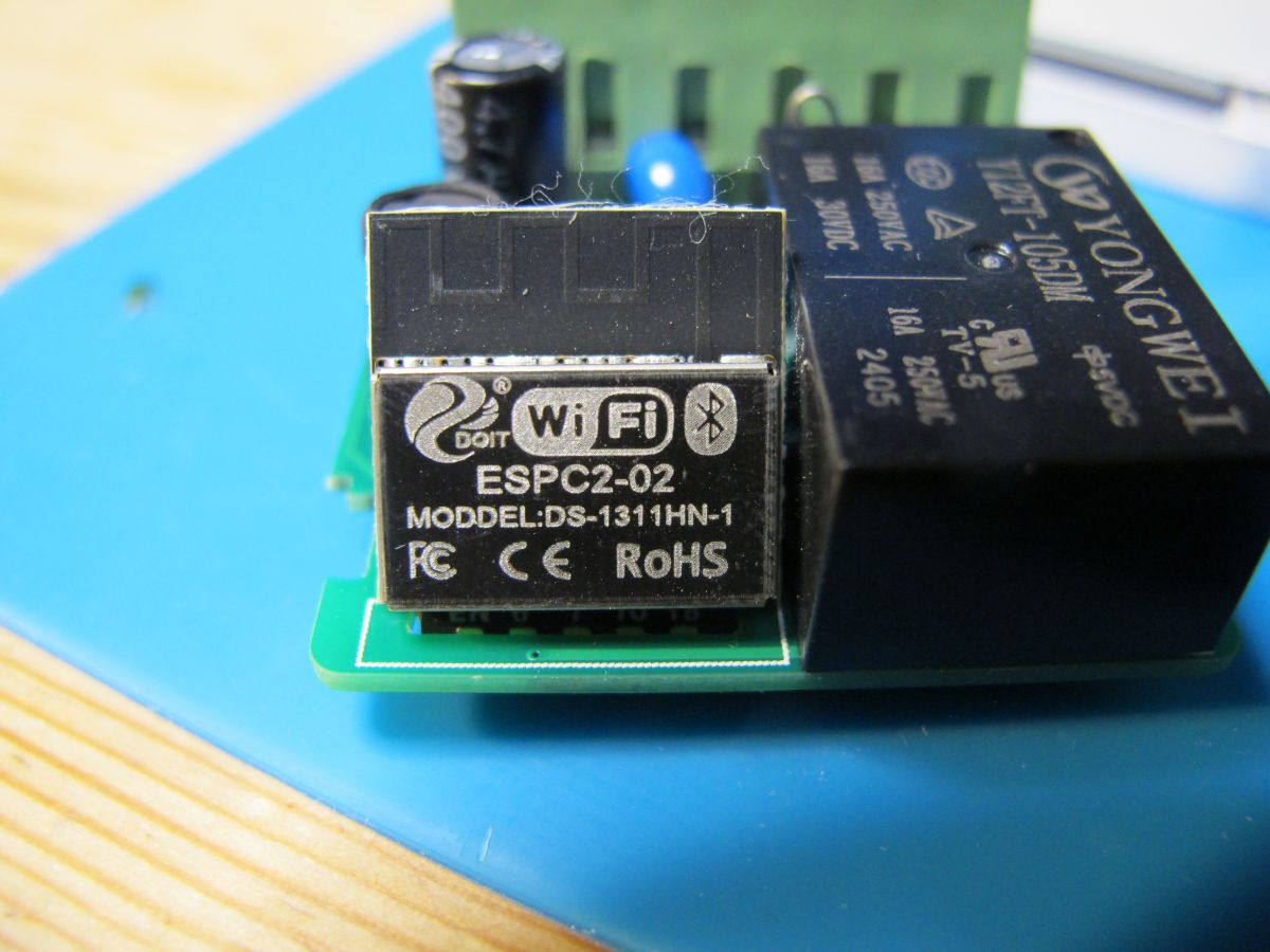

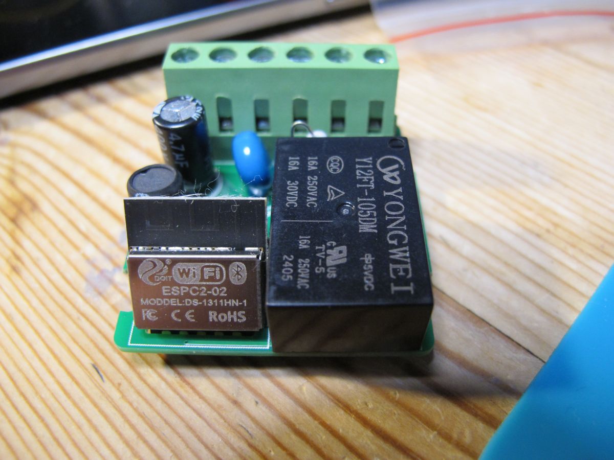

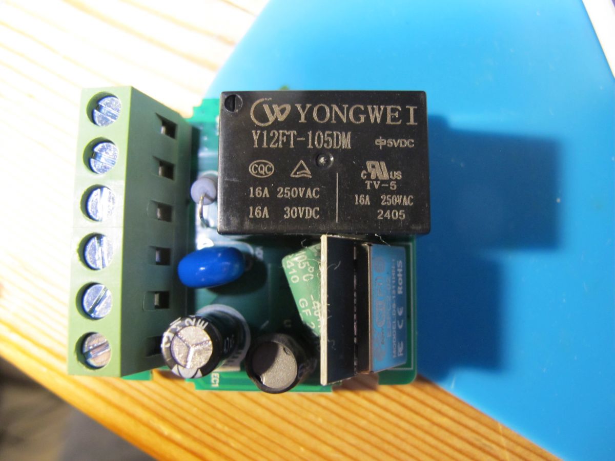

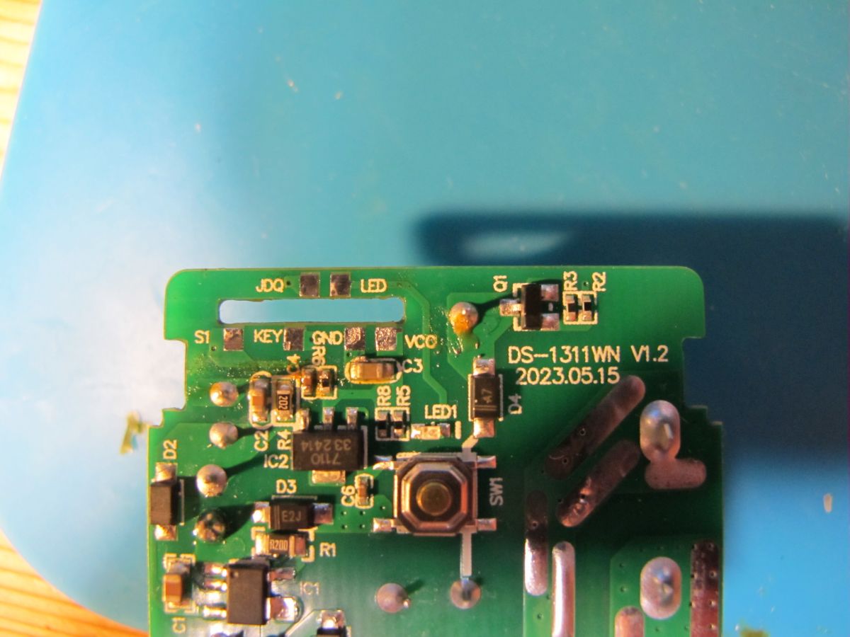

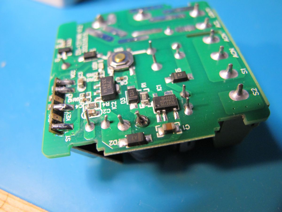

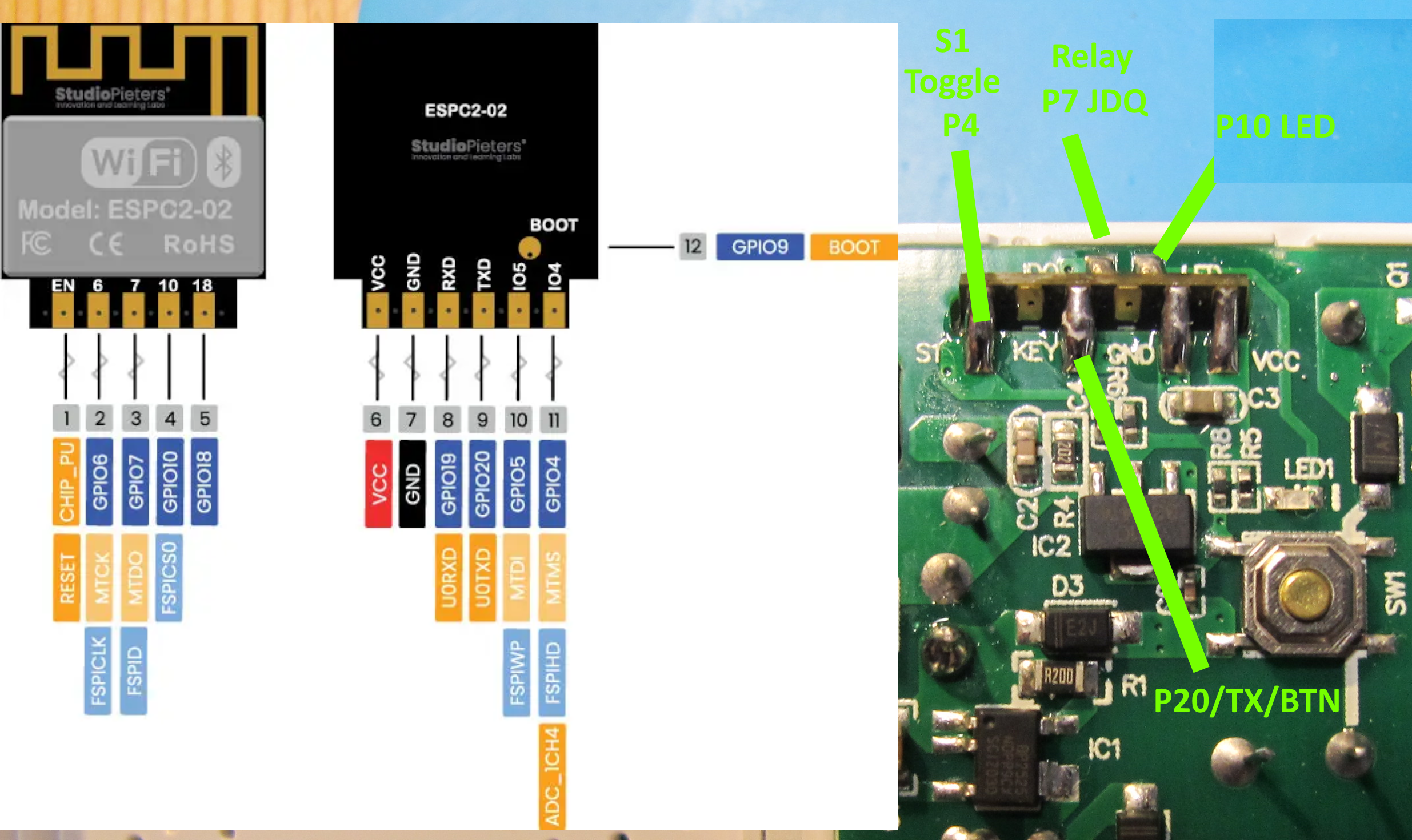

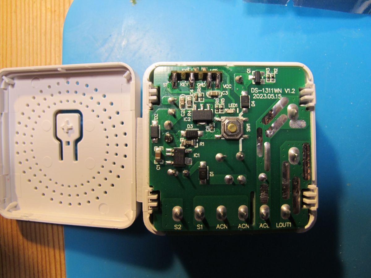

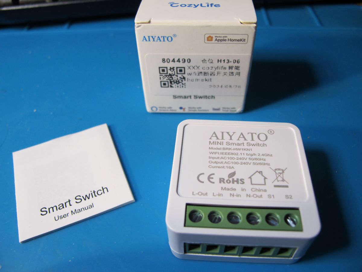

    Here's another DOIT/Cozylife ESP-C2 based mini smart switch. It looks to have the same origins as this breaker https://www.elektroda.com/rtvforum/topic4075524.html with related SDK/boot log/factory app/module. This is branded as an Aiyato BRK-HW1KN1.
    On the PCB is printed DS-1311WN V1.2 2023.05.15 which links it to this CB2S version posted by @p.kaczmarek2 https://www.elektroda.com/rtvforum/topic4057978.html
    Flashing/backup and log capture was the same as with the BSD16, so I'll not detail that. Straight to some pics and logs.

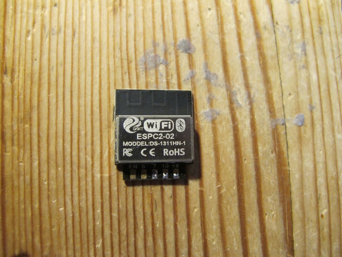

    Aiyato BRK-HW1KN1 smart switch and packaging on a blue background. ESP-C2 module on a wooden surface ESP-C2-02 module with Wi-Fi and Bluetooth on a wooden surface Close-up of DS-1311WN V1.2 circuit board from May 15, 2023. Wi-Fi/Bluetooth module ESPC2-02 on a PCB with markings. Image of a green PCB labeled DS-1311WN V1.2 with electronic components and a button. Close-up of a PCB with electronic components and connectors. ESPC2-02 module on PCB labeled DS-1311HN-1 YONGWEI Y12FT-105DM relay on a circuit board. ESPC2-02 module on a PCB with a relay. PCB module of a smart switch with a relay and capacitors. Close-up of the PCB of the Aiyato BRK-HW1KN1 smart switch. Side of the packaging with product and manufacturer information for a smart switch. Product box with information on compatibility with Apple HomeKit. Mini smart switch in a white casing with a perforated pattern. ESP-C2 module with connected colored wires.

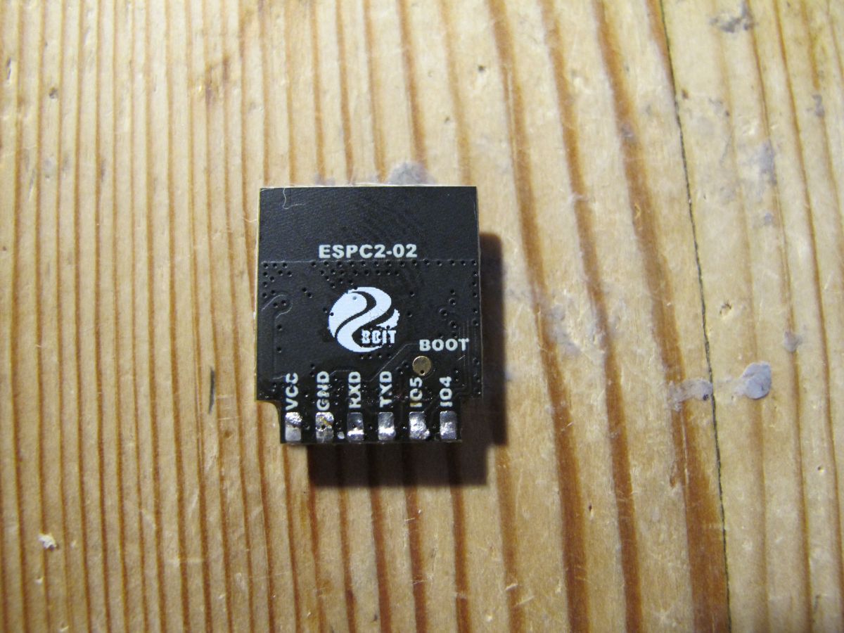

    Using trial-and-error, multimeter and cross-referencing PCB pin labels (KEY. JDQ) with the CB2S version I believe these should be the correct assignments
    ESPC2-02 schematic with PCB connections.
    However, the LED works and so does the toggle button BUT there is no relay operational with any configuration I've tried.
    On occasions the log will say this and switch the LED on/off

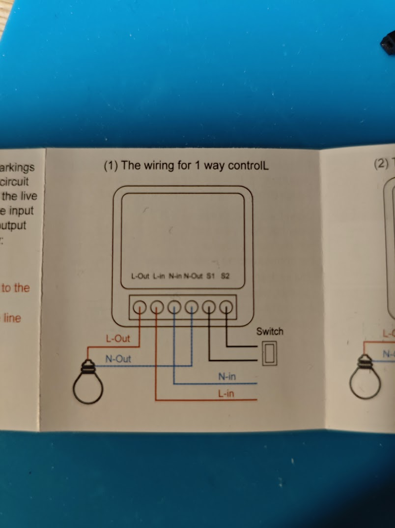

    Currently the device is wired with bulb and switch as per this diagram for 1-way control
    Wiring diagram for one-way control using a switch.
    So I'm not sure if my config isn't right (quite possible) or if this relates to anything ESP dev that needs adjusting.

  • #2 21237189
    Posts: 14755
    Rate: 12880
    It's interesting that they reused the PCB label...
    Regarding button presses, maybe this needs configurable pull up on ESP? @insmod
    So you're saying that you're unable to control GPIO7 on this platform?
  • #3 21237193
    Posts: 5210
    Help: 446
    Rate: 914
    it's certainly the case that nothing I've tried is opening/closing the relay
  • #4 21237195
    Posts: 14755
    Rate: 12880
    So GPIO7 in general is not working on ESP platform? Even on dev boards? It can't toggle LED?

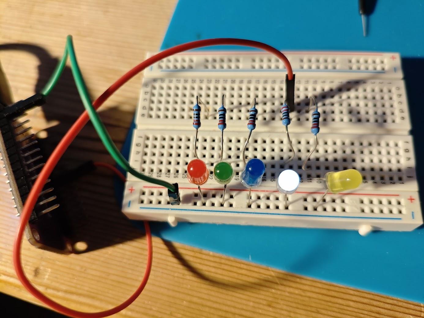

  • #5 21237209
    Posts: 5210
    Help: 446
    Rate: 914
    I've just tried IO7 on C2 and C3 with LED assignment and the LED is always lit dimly after assignment. So always pulled high? it is not controllable
    Close-up of a breadboard with connected LEDs and resistors.

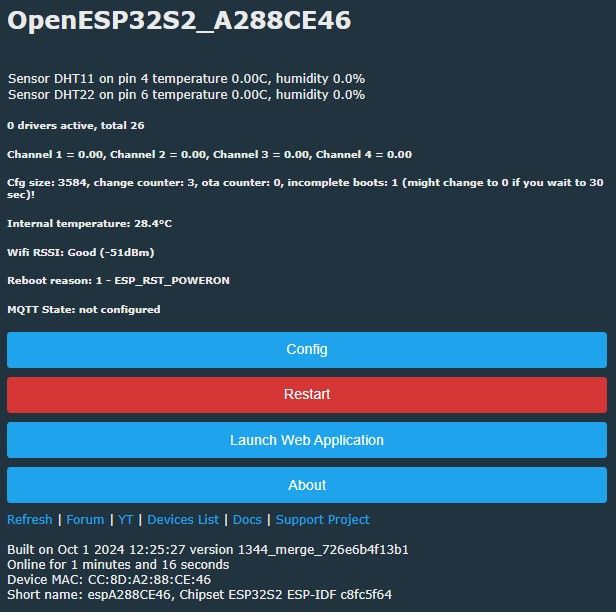

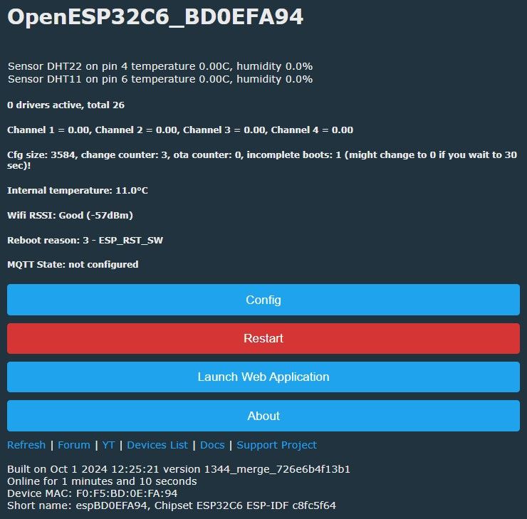

  • #6 21238286
    Posts: 5210
    Help: 446
    Rate: 914
    1344_merge_0d72382ec124
    To extend testing and in summary:
    ESP32S3 - IO7 controllable
    ESP32C2 - IO7 not controllable - dim LED
    ESP32C3 - IO7 not controllable - dim LED
    ESP32C6 - IO7 not controllable - dim LED
    ESP32 - IO7 always dim high - cannot assign pin - maybe not meant for GPIO?
    anyway, maybe the issue is just with the Cx types

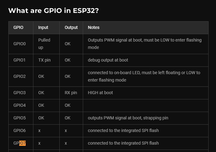

  • #7 21238295
    Posts: 14755
    Rate: 12880
    GPIO7:
    https://www.flux.ai/p/blog/esp32-pinout-everything-you-need-to-know
    Table showing GPIO pin functions on ESP32.
    @ElektrodaBot how to use GPIO7 on ESP32C2, ESP32C3 ,ESP32C6, etc, as digital output? It seems to be always pulled high for me. Does it have some external function that I need to disable?
  • GPIO7 reserved by flash or strapping functions

  • #9 21244368
    Posts: 5210
    Help: 446
    Rate: 914
    Built on Sep 29 2024 21:52:31 version 1344_merge_77dfe2ae2220
    Toggle now works on this build and the relay is opening and closing on this device from OBK GUI and with the physical button.
    current assignments:

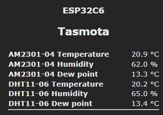

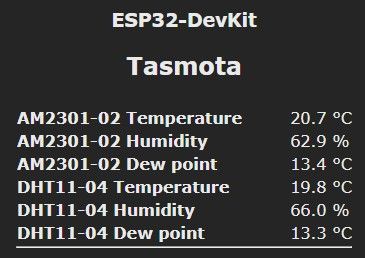

  • #11 21246663
    Posts: 14755
    Rate: 12880

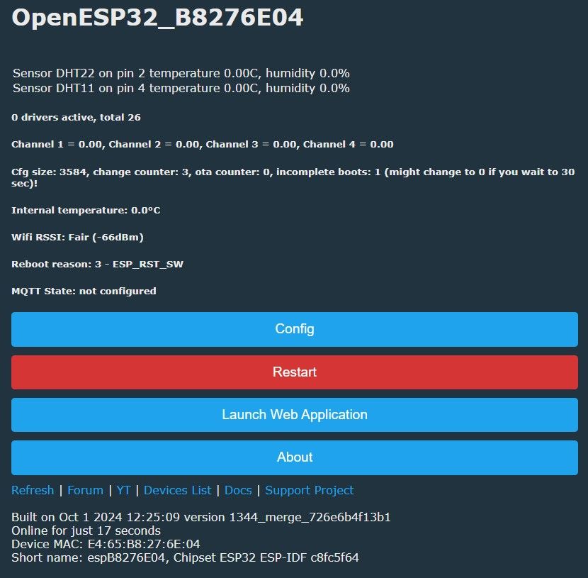

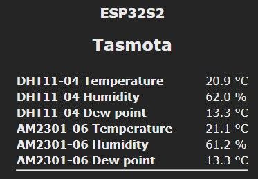

    I guess now it's time for a DHT11 mod or something? Just take care, those things have non-isolated power supplies so you can get mains on that DHT! Still, it should have some unused GPIO....
  • Tasmota may tolerate fake DHT sensors better
    #12 21247316
    Posts: 5210
    Help: 446
    Rate: 914
    I guess this could be an option. But..
    Maybe Tasmota drivers are more forgiving of fake sensors or there's an ESP issue.
    A table displaying temperature, humidity, and dew point readings from AM2301 and DHT11 sensors connected to an ESP32-DevKit using Tasmota. Screenshot of the OpenESP32 user interface displaying DHT22 and DHT11 sensor information
    Display with readings for temperature, humidity, and dew point for AM2301-04 and DHT11-06 sensors on ESP32C6 with Tasmota. OpenESP32C6 user interface with sensor data.
    Screenshot of sensor readings for DHT11-04 and AM2301-06 showing temperature, humidity, and dew point values. OpenESP32S2 user interface displaying DHT11 and DHT22 sensor information.
    I should add to that that I recall inconsistent experience with these same DHTs even on Beken
