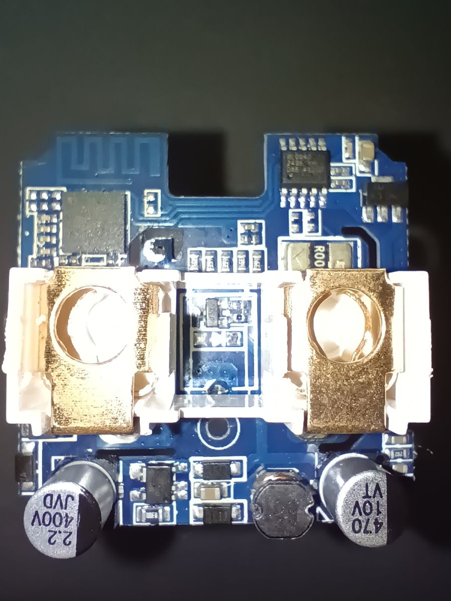

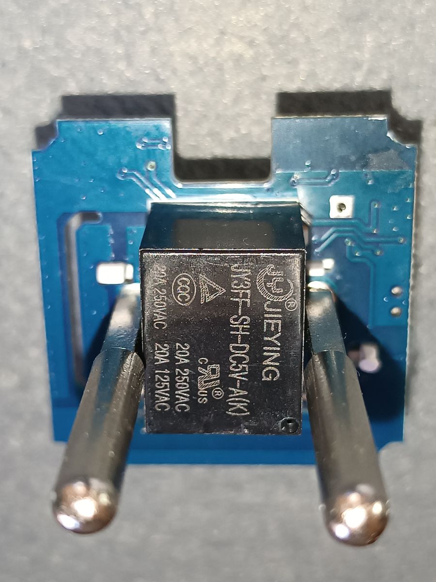

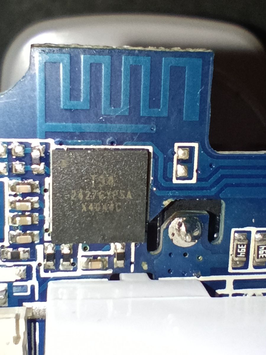

    I just got another new one lspa9.
    It's again with a t34 and with monitoring chip bl0942.
    I got surprised when I saw that there are no soldering spots around the t34. So there would be no chance to contact TX RX without desoldering the t34 I thought.

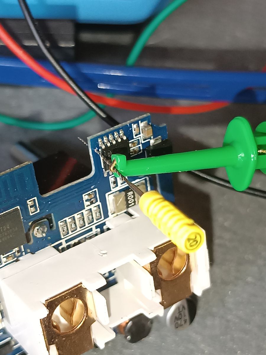

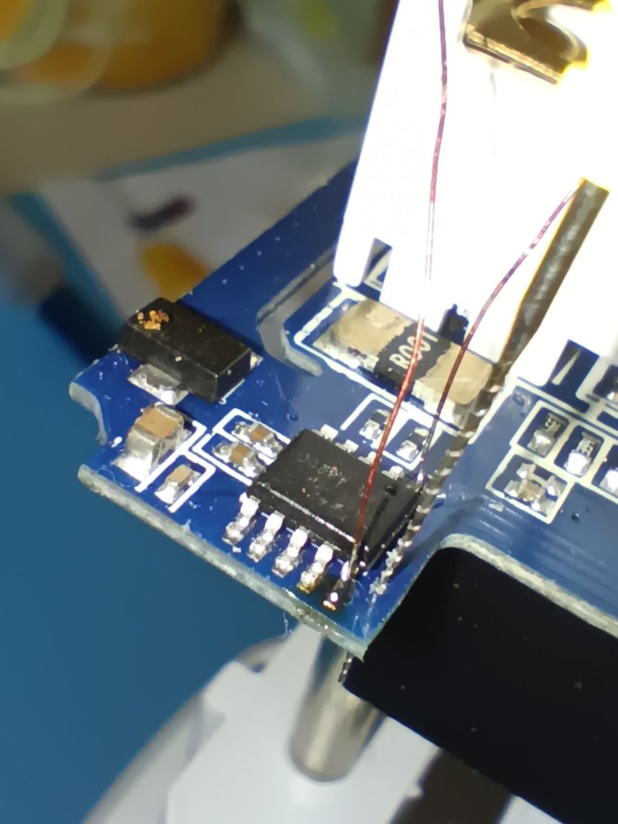

    But after some minutes I detected that TX and RX are directly connected to the power monitor chip bl0942. And his pins are reachable.
    Don't wonder about the drill in my pictures. This is a drill that your dentists need to use when the nerve in your tooth must be removed.
    It gives a first class chance to make contact through the PCB through contacts without any soldering. :-) so I save a bit stress with soldering a wire.
    By the way here the pin config:
