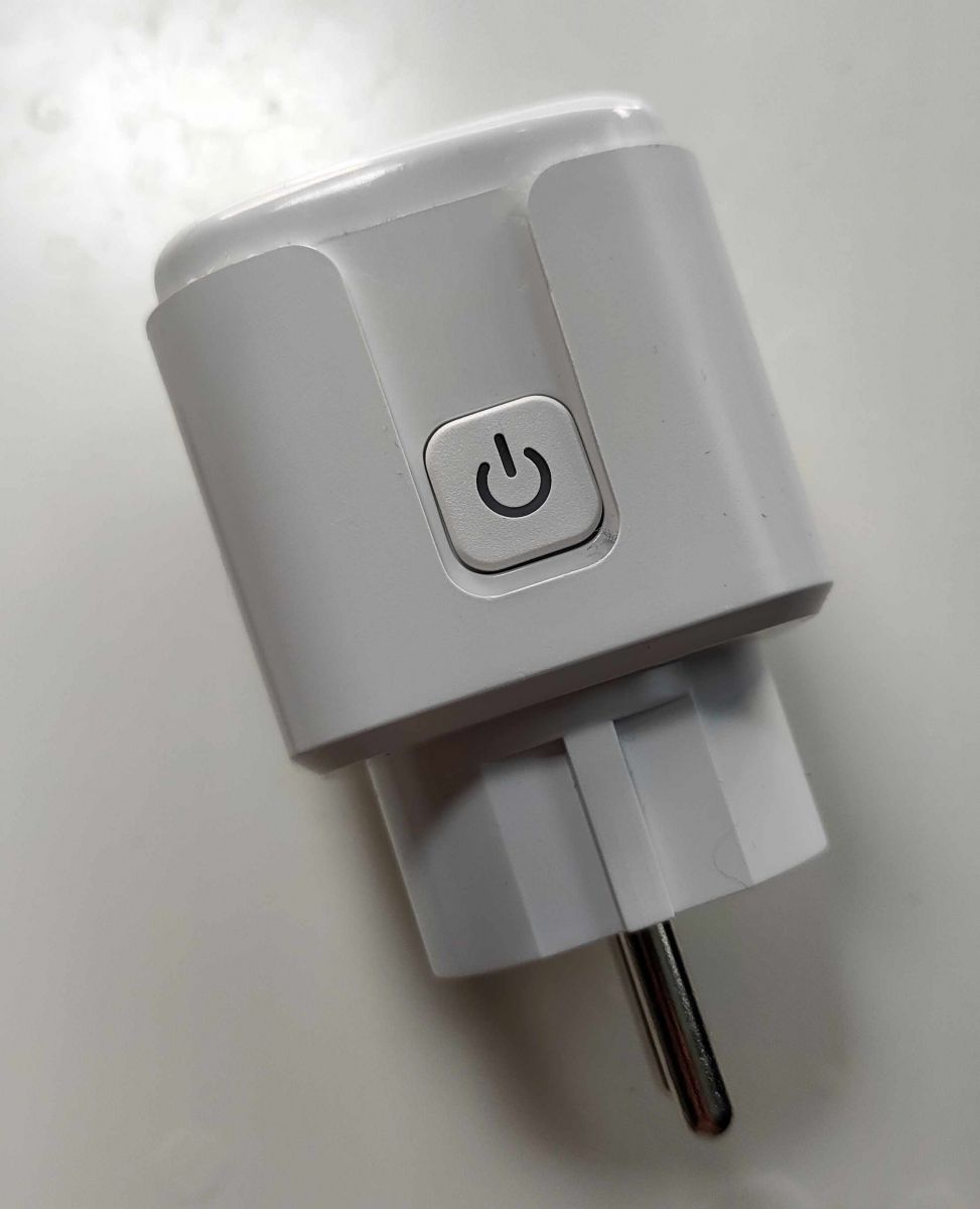

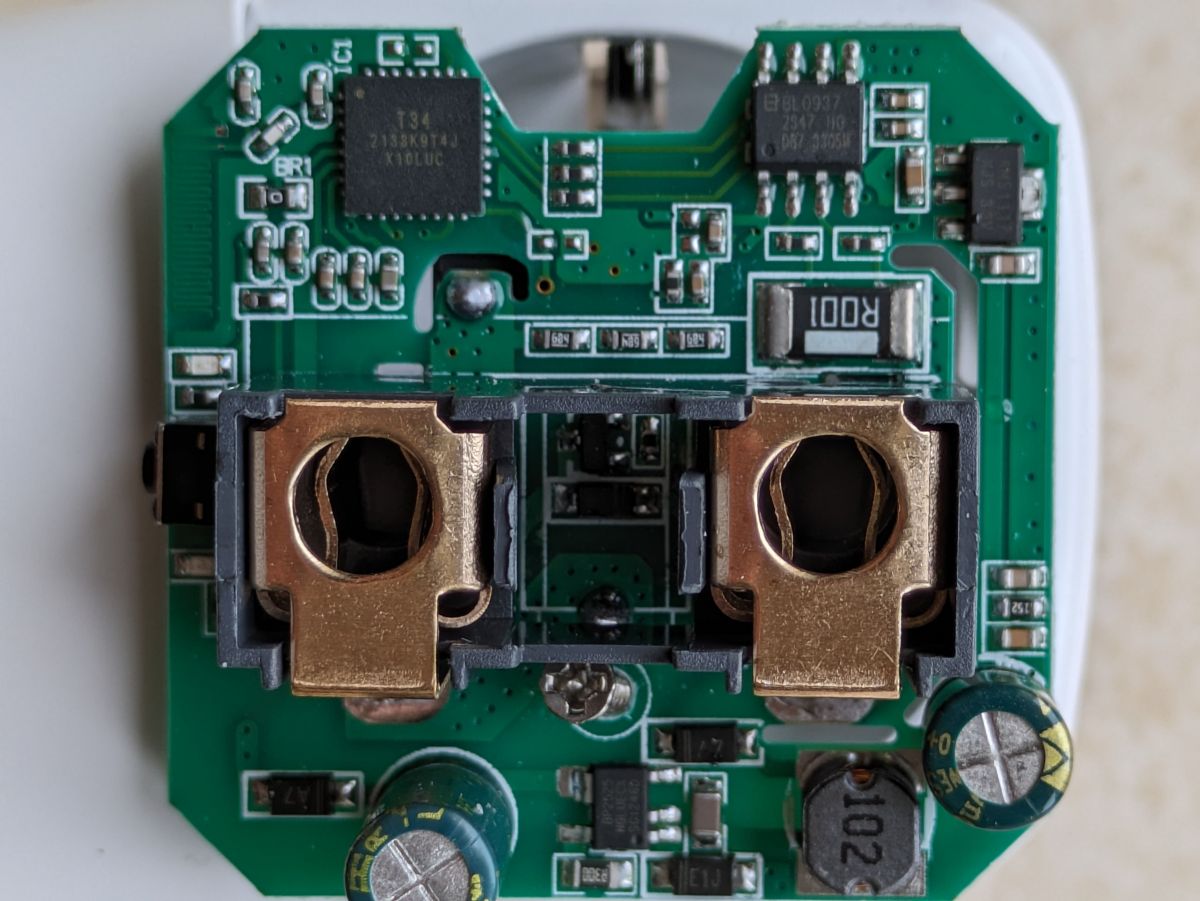

    I ordered some more cheap Smart Sockets / Smart Plugs from a big chinese online warehouse.
    The box with a badly copied label.
    White box with Smart plug label and icons of various devices. White box with a label featuring a barcode and product information, including CE markings and Made in China.

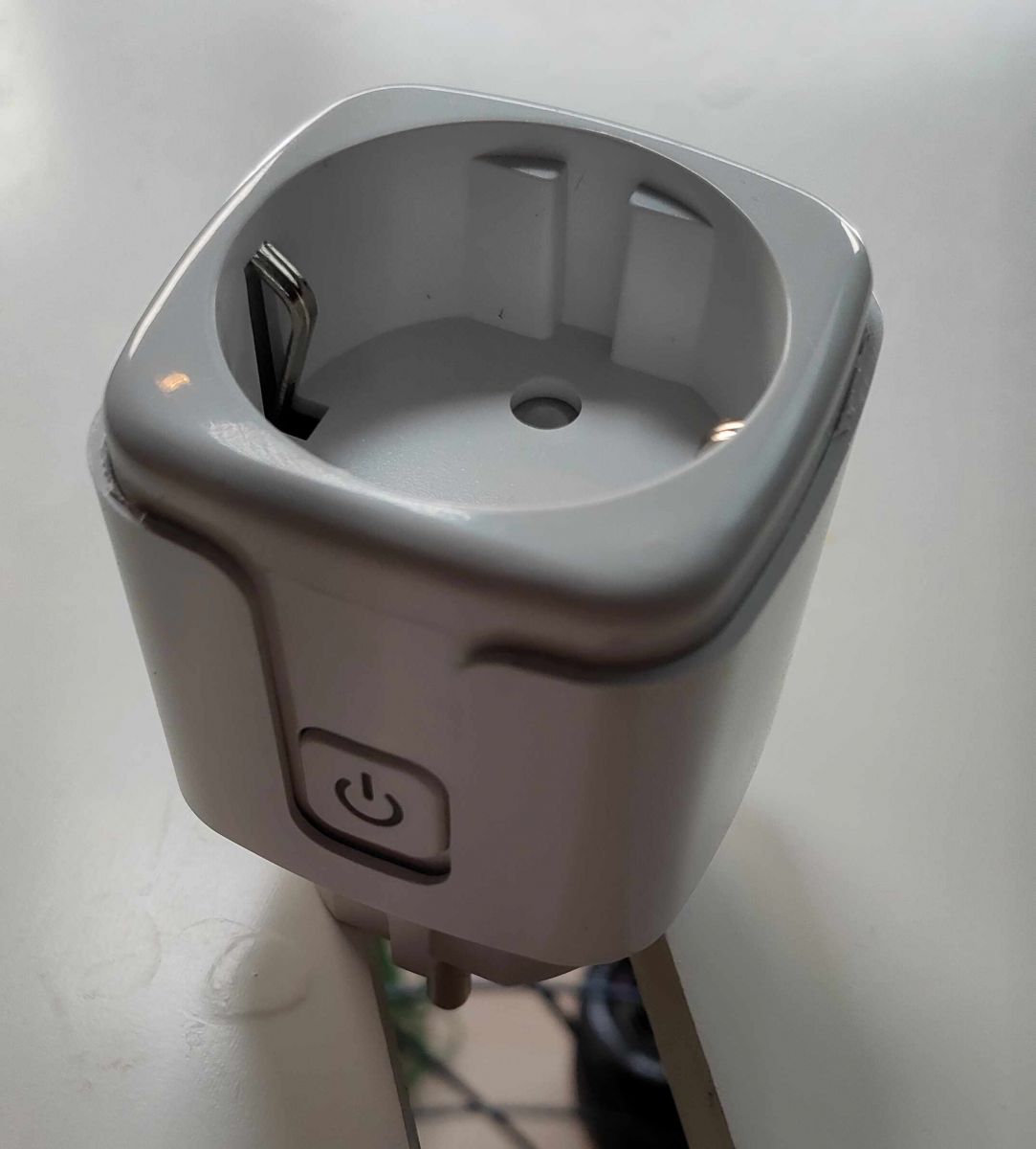

    The plug itself has label or so.
    Close-up of a smart plug with a power button. Photo of a white smart plug with a power button on the casing.

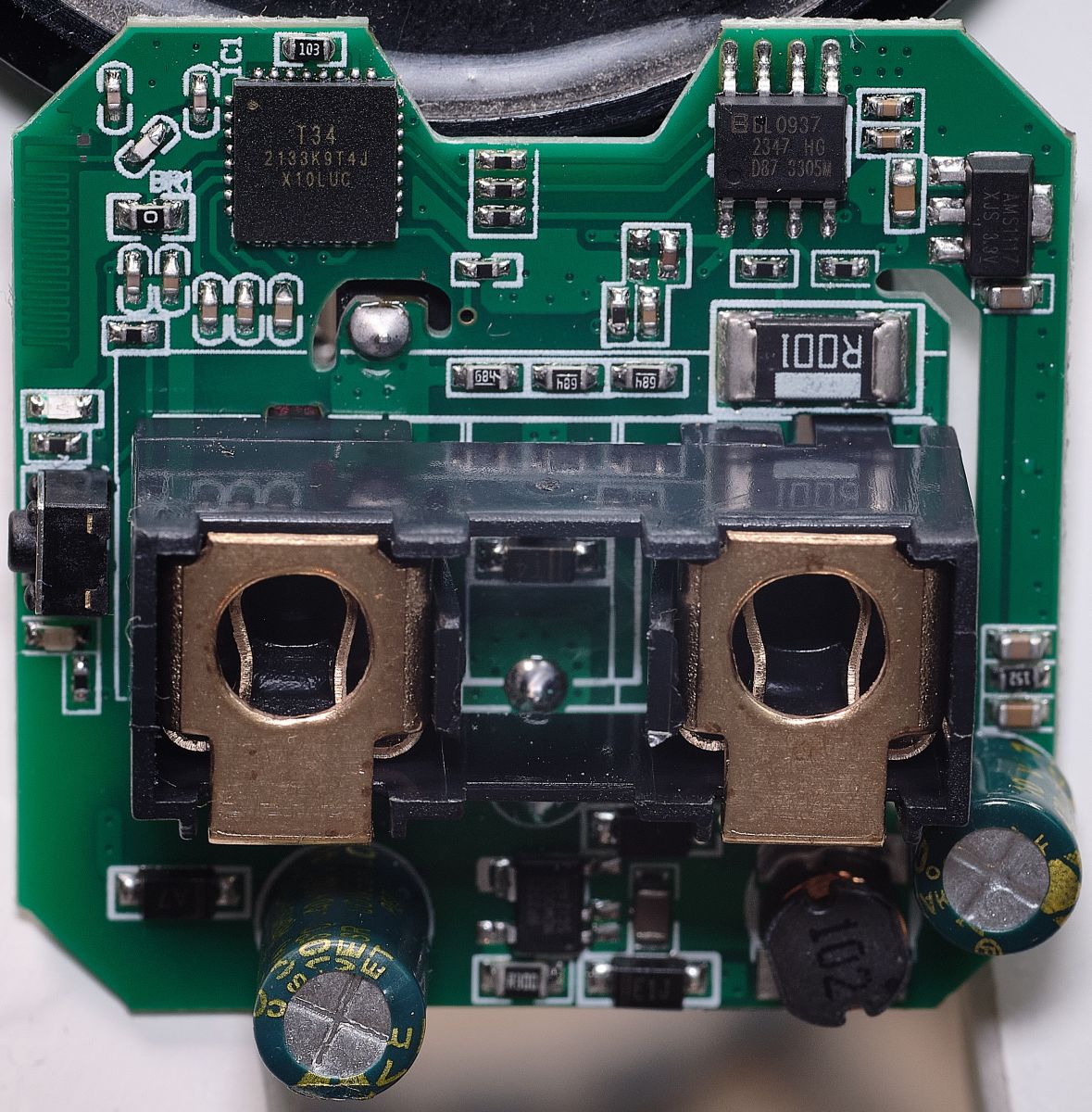

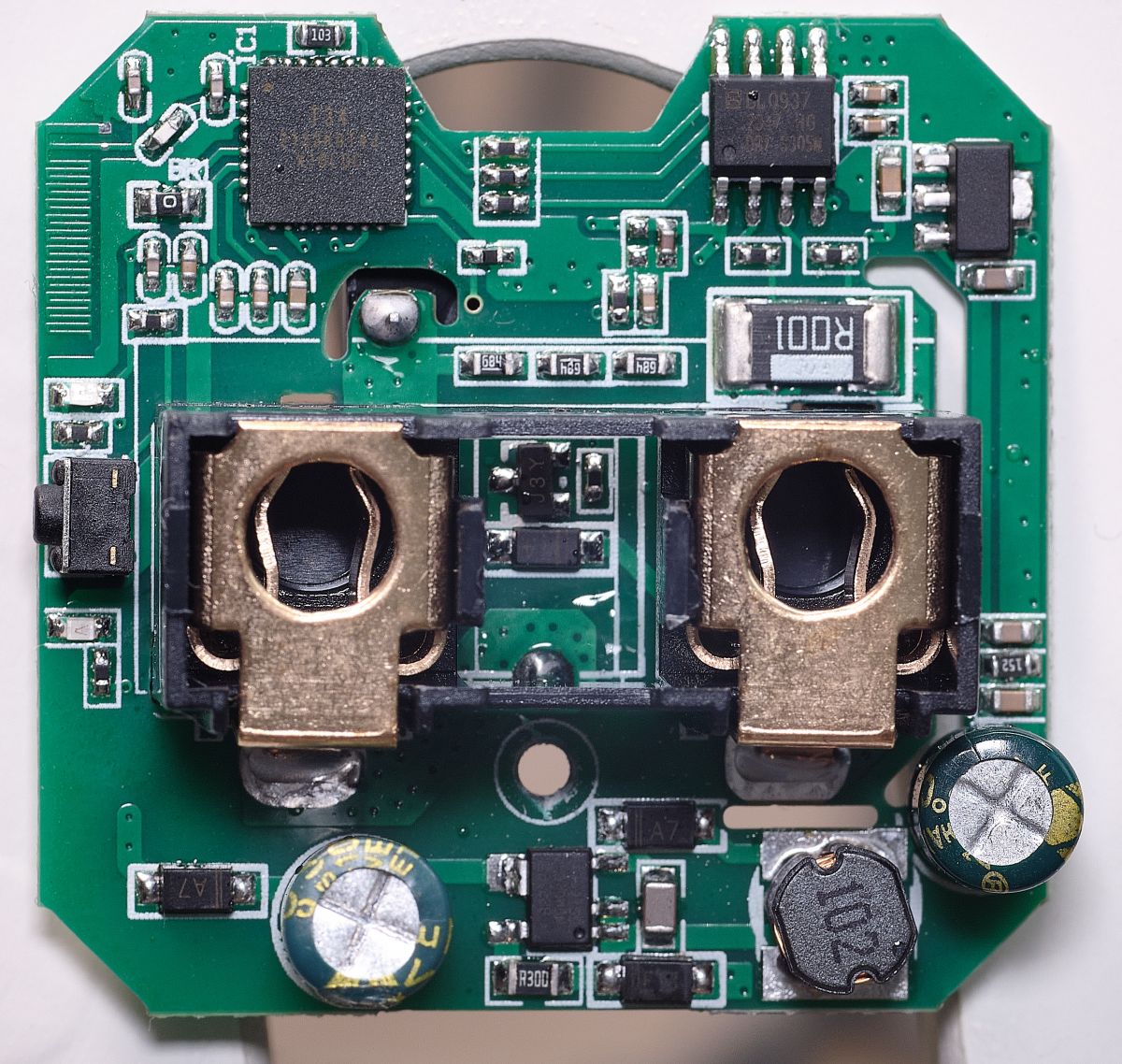

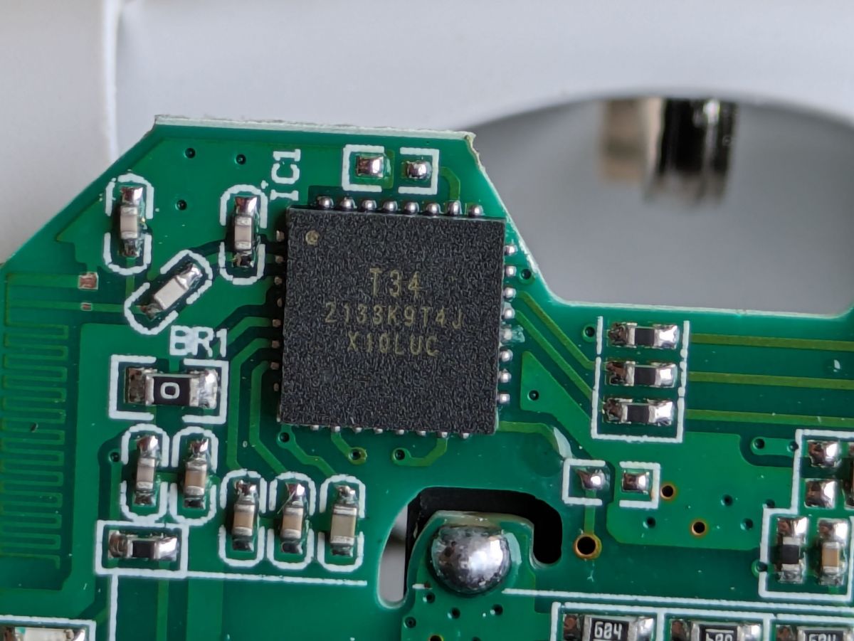

    Then i got my good old Tamron Macro lens and took some pictures of the internals.
    Close-up of the inside of a smart plug showing electronic components on a green circuit board.

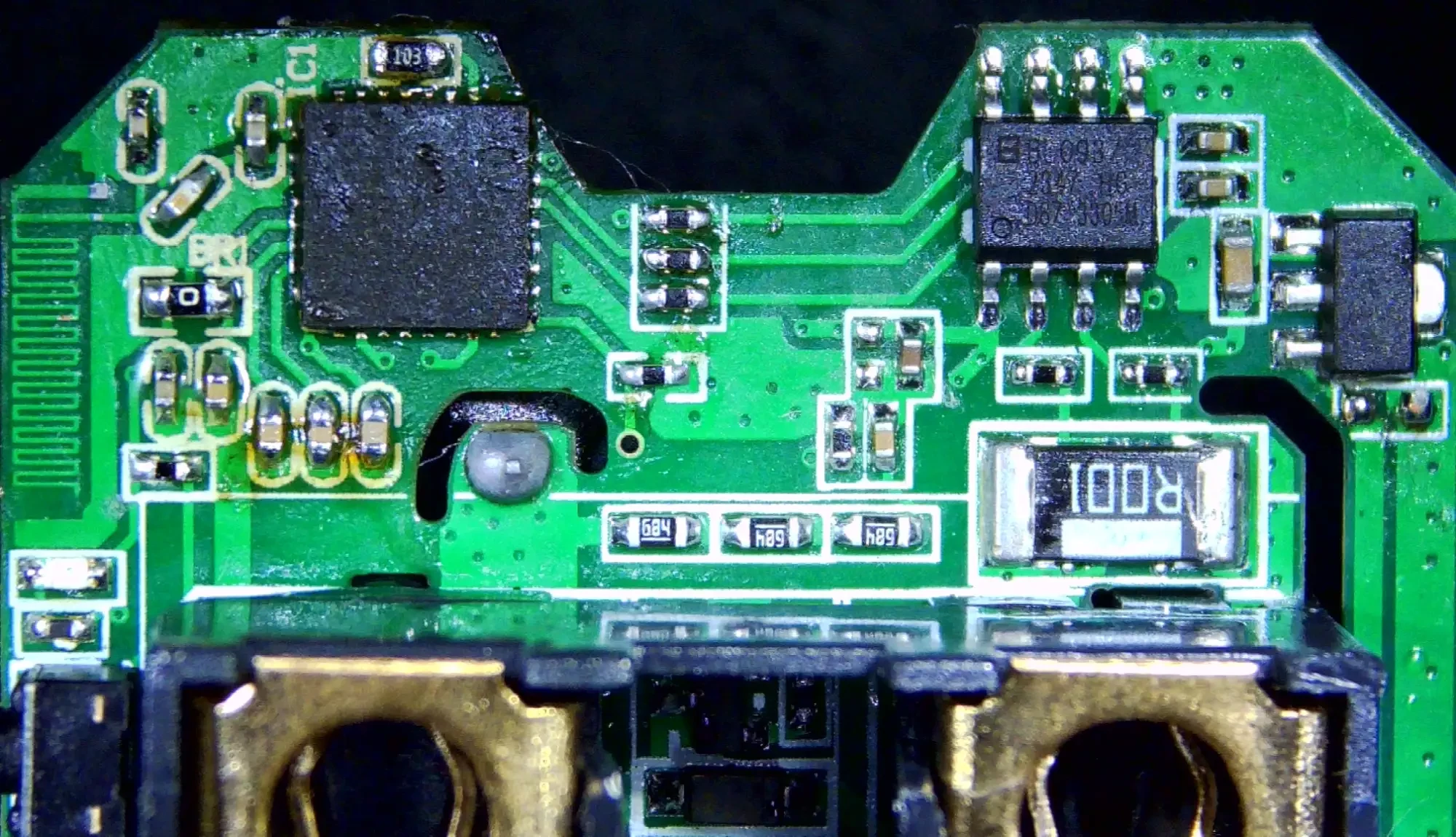

    Better lighting on the interesting chips:
    Close-up of the interior of a smart plug showing electronic components.

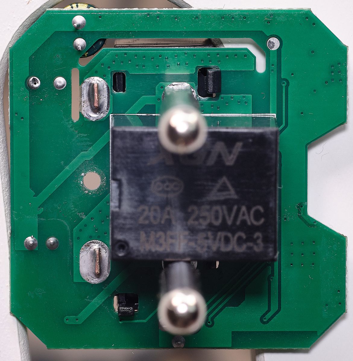

    And the backside:
    Close-up of the interior of a smart plug showing a green circuit board and a black relay.

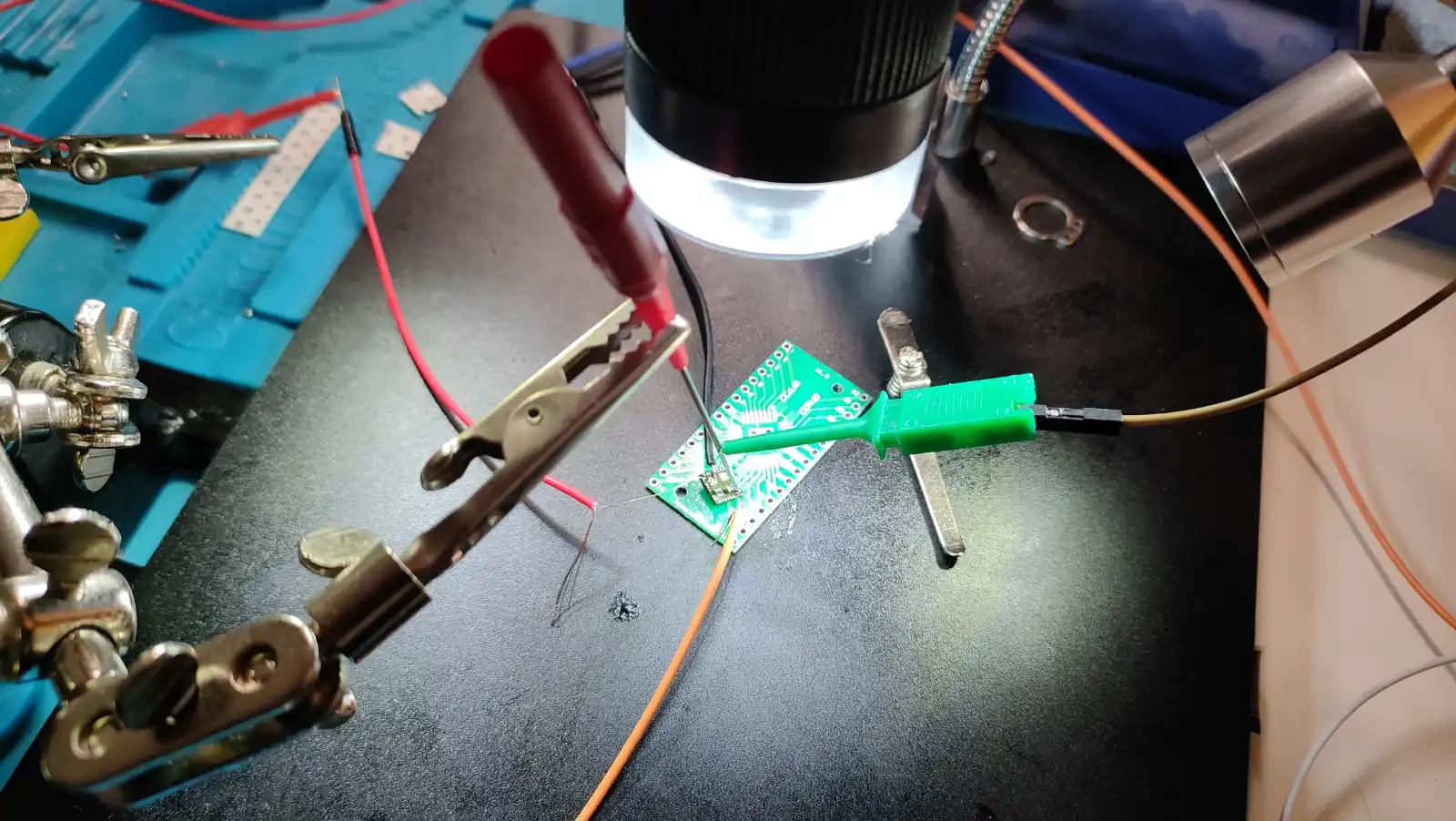

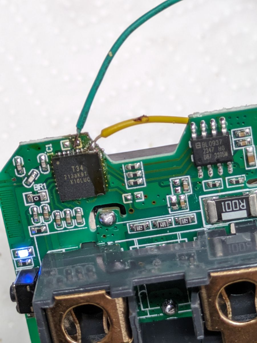

    Soldering the wires to flash it seems to be not that easy. I will try that now and post my experience.
  • #2 21005230
    Posts: 14634
    Help: 655
    Rate: 12649

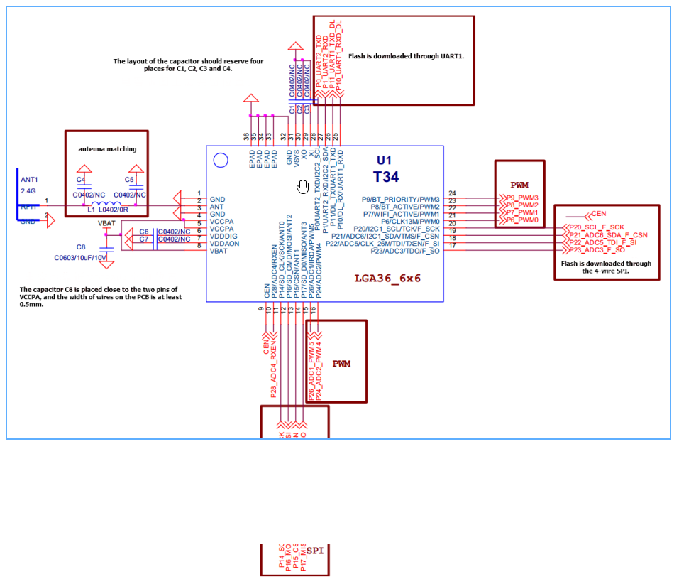

    This indeed looks like somewhat problematic. Are TX1/RX1 routed out anywhere, maybe to a button or a LED?
    If not, in the worst case scenario, you can desolder T34 itself and use approach from this topic:
    https://www.elektroda.com/rtvforum/topic4036975.html

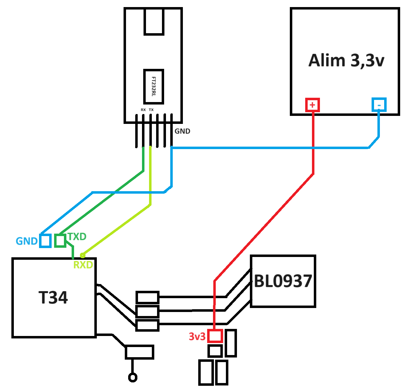

    Hm, I did a brief analysis myself, it seems that only one of UART lines is broken out. You need some flux and some precise soldering.
    Pinout diagram of T34 and BL0937 smart plug with a PCB view
  • #3 21005344
    Raufaser
    Posts: 47
    Rate: 16

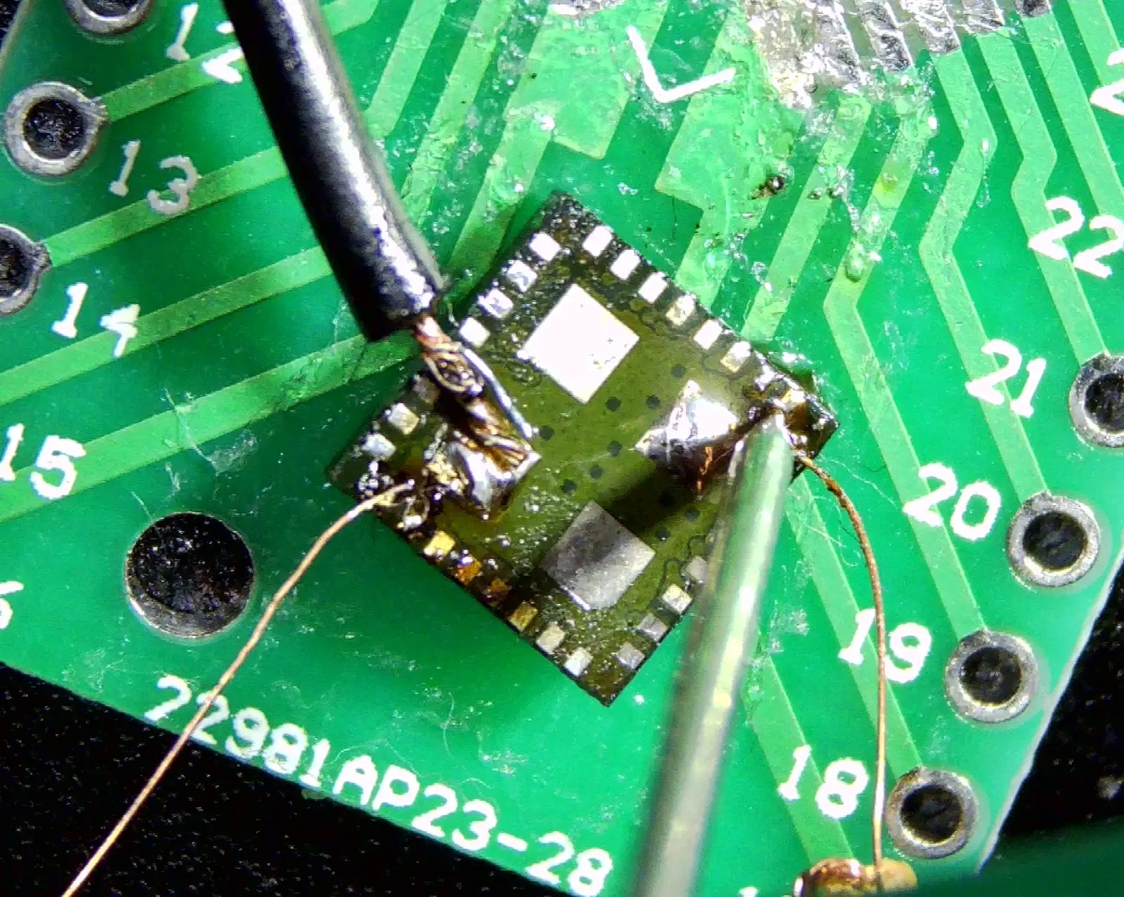

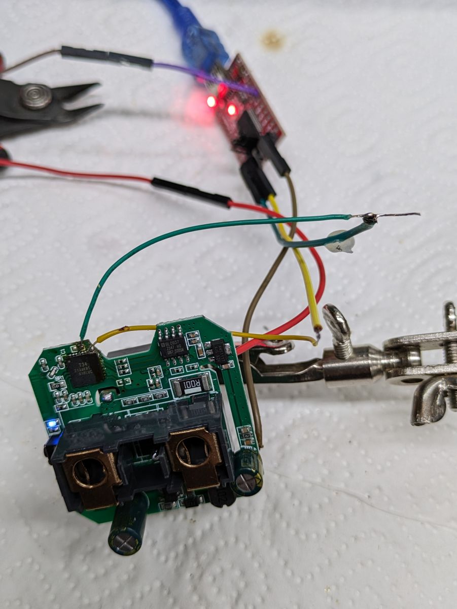

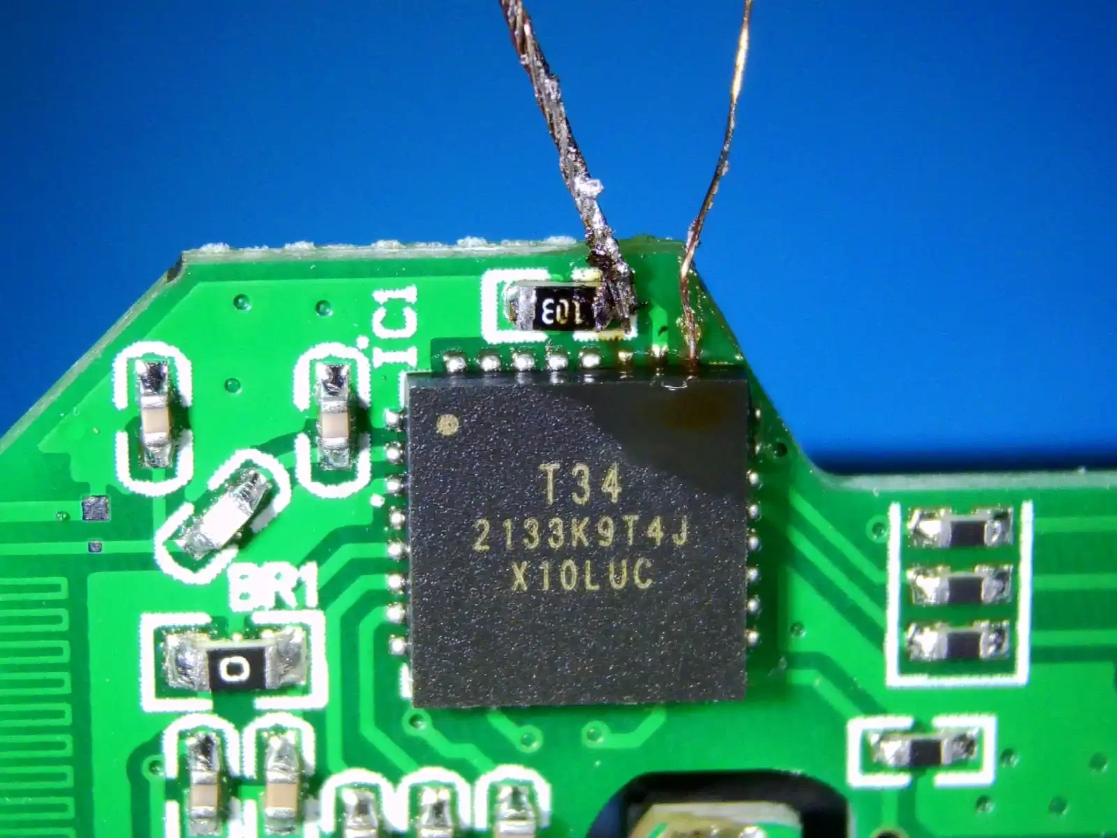

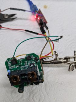

    At first i tried to solder the wires to the T34 as it was still soldered to the board. It didn't work.
    Then i desoldered the T34 from the board using my rework station. I soldered the wires directly to the pads on the bottom of the T34. Unfortunately i seem to have too much leverage when i was connecting the cables to the UART-USB converter and the pad 25 fell off the T34. So RIP my T34 XD
    I would try to avoid these kind of plugs. Much harder to work with than the user variants. I will try to get these probe tips for the next time.
    This is the item i bought. Maybe it helps someone to avoid it. Or if he is seeking for adventure, to get exactly this one.

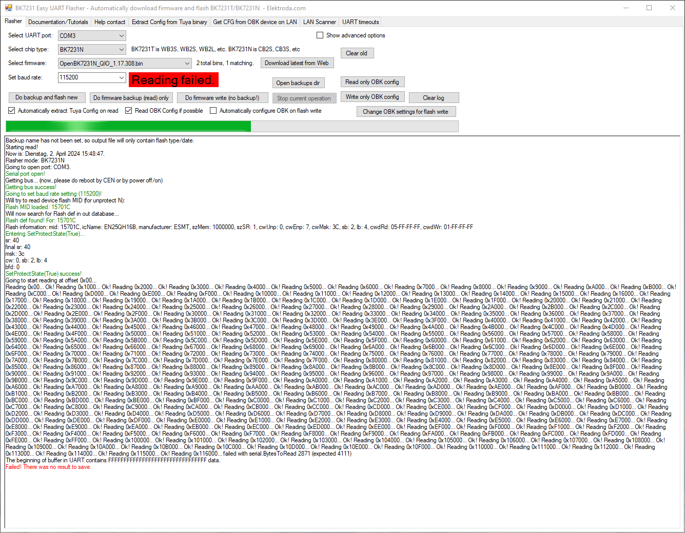

    Today I received three smart plugs like the ones here in the pictures from @Raufaser.
    I did try to solder the critical RXD wire directly to the microprocessor and had luck. TXD was easy because of the missing resistance and 3V3 / GND are as well easy to solder. CEN is not needed.
    After a few times trying to backup the original FW always ending in errors I did flash the T34 with newest OpenBeken. For sure I must have done something wrong with the backup process, but so far everything else works well.
    Now I do have to find the right pins and make things working again.
    Before messing everything up I did measure the power consumption of the device with the Tuya FW. And was surprised about efficiency: 2.5-5mA relay off and 6.5-8.5 relay on There must be something wrong about measuring after my isolating-transformator. Measured again and now it's 5-7mA relay off and 11-15mA relay on.
    And it seems that they set a power save mode even with the BL0937.
    Screenshot of BK7231 Easy UART Flasher showing a Reading failed error during firmware backup attempt. Close-up of a circuit board with several chips and soldered wires.The image shows an open smart plug with visible solder joints and wires.
    Is there something special to know for backing up original FW? So I can try with the other two devices. (I only did experiment with different baud rates, but this was not the problem.)

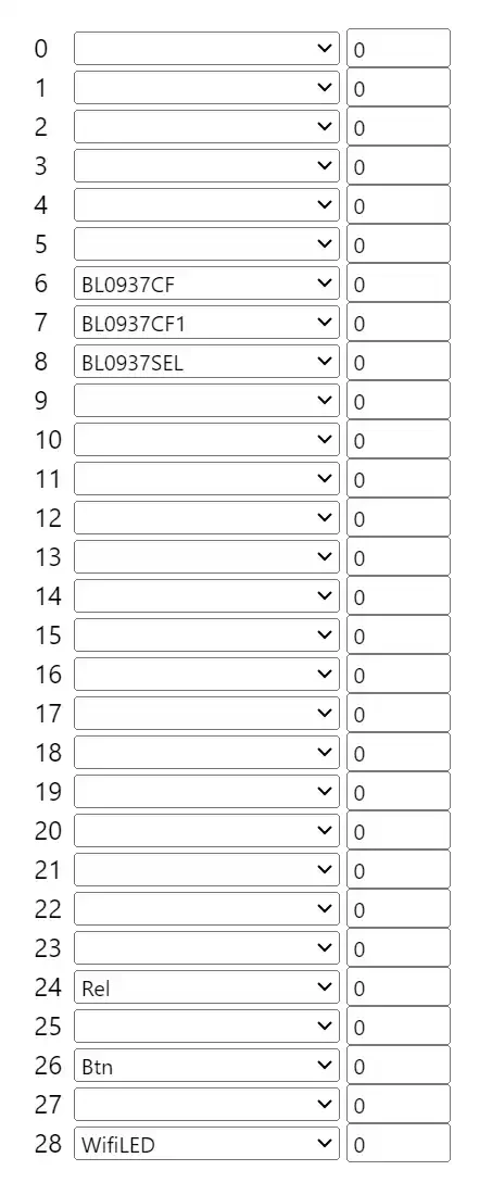

    Pin setting is quiet tricky because T34 and BK7231N have completely different pinouts. (pin numbers are different)
    Wiring diagram of the T34 system with pin and connector descriptions.
    So far I found these pins working:
      "vendor": "Tuya",
      "bDetailed": "0",
      "chip": "BK7231N",
      "board": "TODO",
      "flags": "1024",
      "keywords": [
        "TODO",
        "TODO",
        "TODO"
      "pins": {
        "6": "BL0937CF;0",
        "7": "BL0937CF1;0",
        "8": "BL0937SEL;0",
        "24": "Rel;0",
        "26": "Btn;0",
        "28": "WifiLED;0"
      "command": "",

    Additional setting:
    -remember relay channel state -1 at startup
    Maybe there are still some optimizations missing. But like this, everything works perfect.

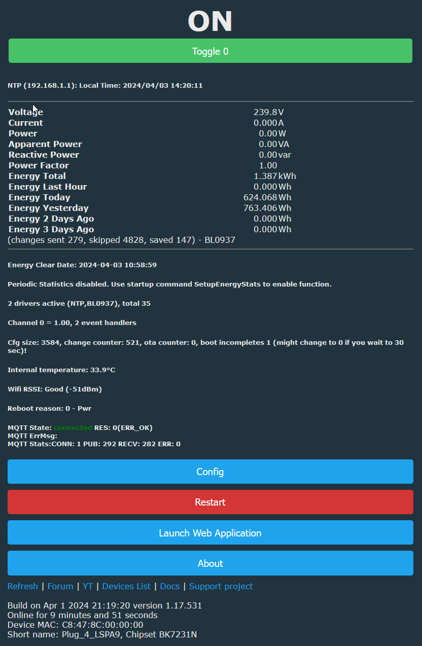

    Finally I added a DHT22 and do start to really love it, even with the T34.

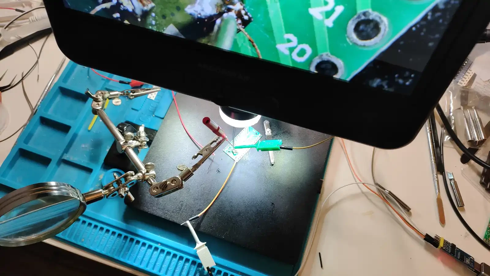

    Raufaser wrote:
    So RIP my T34 XD
    Yesterday I thought: "Hold my beer, while I try to unrip my T34"

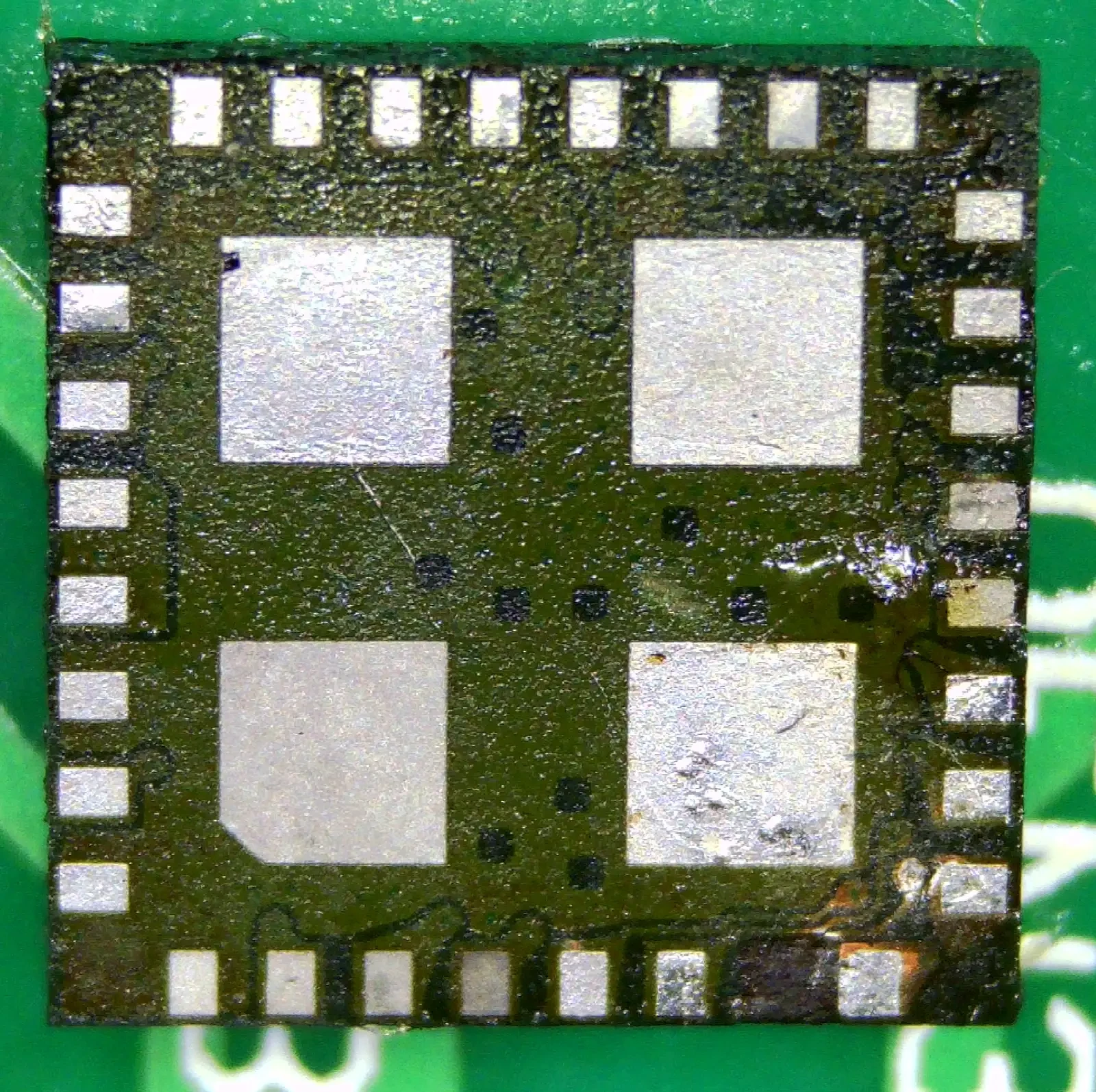

    [T34/BL0937] Teardown Generic Wifi Smart Plug with Energy Measurement
    You can see the ripped off pad No. 26 (which is TXD) Under the microscope, I could see, that there is a tiny trace under the coating going to a slightly bigger trace very close to pad No. 24. So i took a very fine needle and started to scrape off the coating. I was able to get to the underlying trace without damaging it. Soldering something to it didn't work. Everything fell off. So:
    [T34/BL0937] Teardown Generic Wifi Smart Plug with Energy Measurement [T34/BL0937] Teardown Generic Wifi Smart Plug with Energy Measurement [T34/BL0937] Teardown Generic Wifi Smart Plug with Energy Measurement
    It worked :) I was even able to dump the firmware. And then I flashed OpenBeken :D
    readResult...-03-06.zip (1.04 MB)You must be logged in to download this attachment.
    To establish a connection, I had to solder the chip back in place. I have never soldered QFN before. But even that i managed to do.

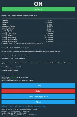

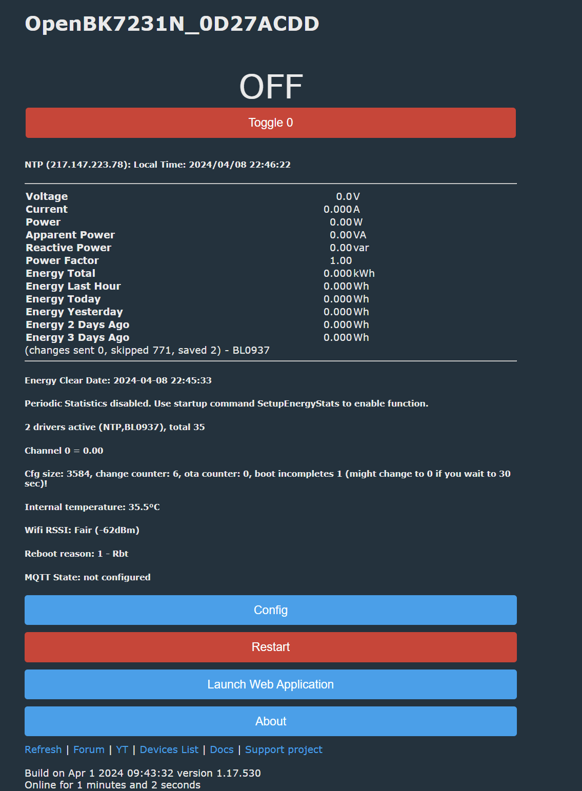

    The energy measurement isn't working.
    User interface displaying the status of the OpenBK7231N device
    At first I was wondering why, then i discovered, that is somehow yeeted a cap of the PCB. You can see that there is a cap missing on my pic of the main PCB on the far right side. I will just take a similar plug and measure what cap is used at this place. I will find a replacement.
    Another thing is, that the Wifi reception is really really bad. I seems, like the antenne is not connected at all. But the solder joint seems to be ok. I am wondering if that can have something to do with the not connected pad 26 ... The trace from this pad is connected to antenna ground via a 10k resistor. Maybe someone has in idea?
    So for me that is an absolute success. Even when i can only use the plug right next to my access point :D

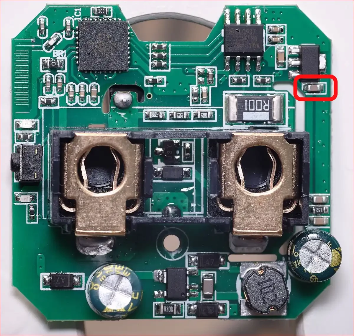

    Obviously not that easy to measure capacitance in place.
    Does someone have an idea what this can be? It is a cap right? But what value? ...

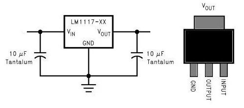

    The part above that cap is an AMS1117 3,3V voltage regulator. And the missing cap has something to do with its input.

    Yes, the marked SMD is a cap. Unluckily I glued my LSPA9 together already. So I can't measure the size atm.
    But I'm not sure if size does matter much.
    About the resistance from TX. My PCB version does not have this resistor at all.
    And another resistance on the line between pin 16 and pin 17 is missing as well.
    Close-up of a circuit board with a chip labeled T34.
    Added after 7 [minutes]:
    It's not a good picture but here we can see little differences:
    Top view of a PCB with electronic components and two metal holders.
    Added after 13 [minutes]:
    Managed to open the plug again without damaging it.
    I measured 9.5uF at the cap without desoldering. Don't know if this is reliable.
    Added after 9 [minutes]:
    I do like these little contact-clamps you have. They seem to be very useful.
    One thought about your wifi problems. Antenna is connected to pin 2 only when you check the schematics design from T34.
  • #15 21039197
    Posts: 14634
    Help: 655
    Rate: 12649
    The capacitor value at AMS117-3.3V is not critical. It seems to be usually 10uF. You can check out application schematics of AMS1117 for more info.
    Circuit diagram and package of LM1117.

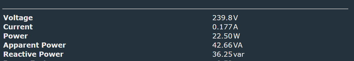

    No success yet. I soldered a 5uF cap in place. I salvaged that from somewhere else.
    These are my pin settings:

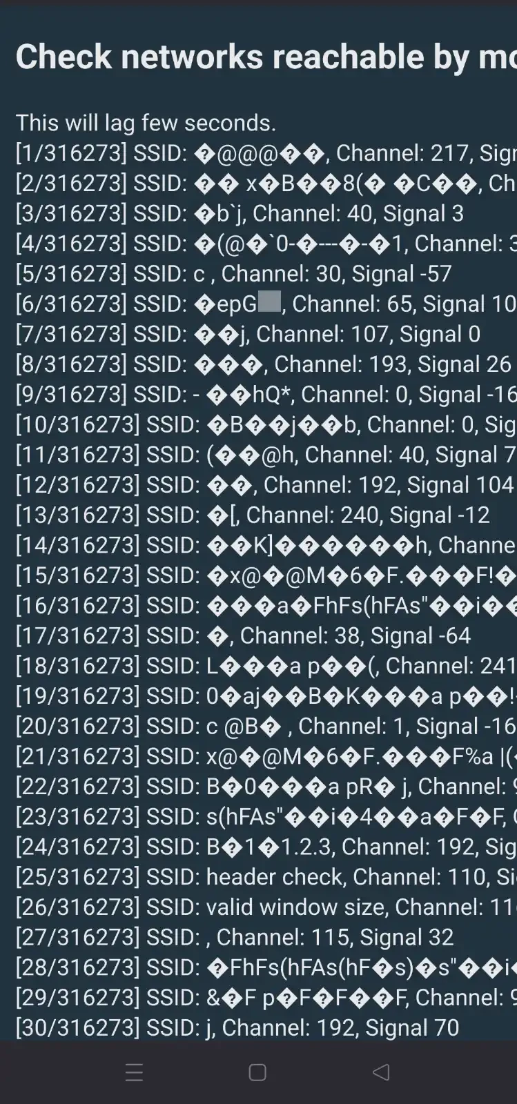

    I noticed something very strange wifi-related. When I bring my plug to emergency mode and scan for wifi networks I get this:
    I reworked all pins with flux and solder. The joints look OK...
    Added after 1 [hours] 12 [minutes]:
    Screenshot showing electrical values: voltage 239.8 V, current 0.177 A, power 22.50 W, apparent power 42.66 VA, reactive power 36.25 var.
    Success :) I replaced the 5uF with a 10uF!
    Wifi is still &!"&$

    - keep the T34 on the PCB
    - use enameled copper wire to attach on the device side ("Kupferlackdraht" in German), I had one with 0.25 mm diameter. The advantage is that this wire is very thin and can fit better to pins of ICs. It also is light and quite flexible - when you move it, it does not provide high forces to the IC pins, so less chance of breaking them off, or stripping off the copper layer of the PCB. Disadvantage: To get the insulation layer off to be able to apply solder is sometimes a bit of a challenge. Then I used ordinary cables to extend these thin wires to attach to PSU and to Serial converter.
    - For P25, I soldered directly to IC pin.
    - For P26, I used the connection at the resistor
    - 3.3V and GND I attached directly to Pins 1 and 2 of AMS1117
    For flashing, I had to power cycle for like 5 times or so until the serial connection was established.

    Please add the device to the list:
      "vendor": "QNCX",
      "bDetailed": "0",
      "name": "Generic Smart Plug with Energy Measurement (T34)",
      "model": "T34 Smart Plug",
      "chip": "BK7231N",
      "board": "T34",
      "flags": "1024",
      "keywords": [
        "power metering,,",
        "smart plug",
        "bl0937"
      "pins": {
        "6": "BL0937CF;0",
        "7": "BL0937CF1;0",
        "8": "BL0937SEL;0",
        "24": "Rel;0",
        "26": "Btn;0",
        "28": "WifiLED;0"
      "command": "",
      "image": "https://obrazki.elektroda.pl/4477082300_1710363453.jpg",
      "wiki": "https://www.elektroda.com/rtvforum/viewtopic.php?p=21044837"

    Sure, I have added this device:
    https://github.com/OpenBekenIOT/webapp/commit/dd2fe7d99e28619a41f182d488ebcf1b1c93dde4

    donotos
    Hey.
    I just finished flashing my own so thanks for the help provided here.
    I wasn't able to flash by powering the T34 with the UART. Every time I disconnected 3v3 it disconnected from USB and killed the flasher app so I had to use an external PSU.
    BTW: inverting polarity did not kill the T34!
    I had some troubles wiring the chip so here is a small schematic:
    Diagram of a connection setup between T34, BL0937, and FT232RL with 3.3V power supply.
  • #30 21055174
    Posts: 14634
    Help: 655
    Rate: 12649
    Did you invert 3.3V polarity on T34 alone or on the whole smart device board?
