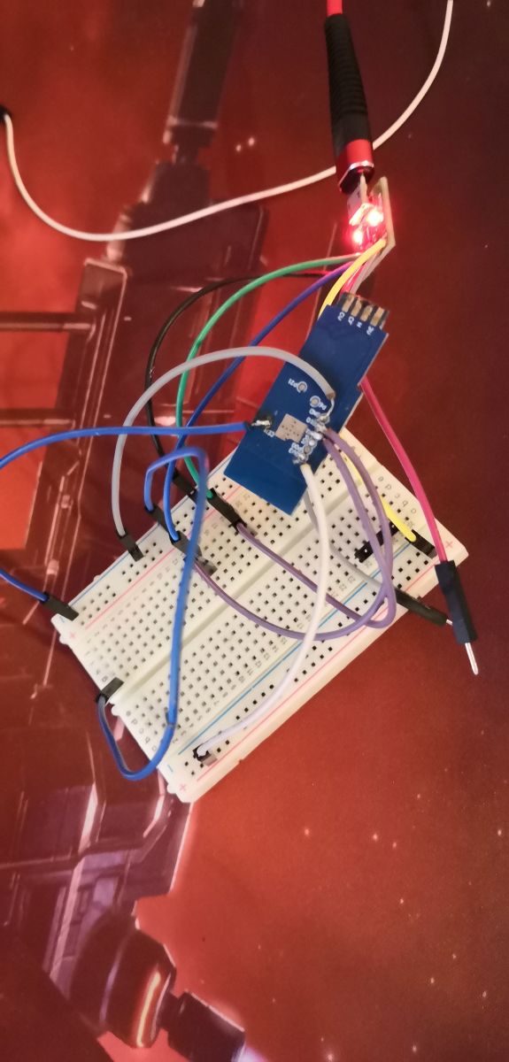

    Flashed Windows BK7231GUIFlashTool release 1.15.305, update to OpenBK7231N_QIO_1.15.391 (release version)
    P10 -> TX (TTL)
    P11 -> RX (TTL)
    3.3 -> 3.3 (TTL)
    GNG -> GND (TTL)
    CEN -> GND (TTL )

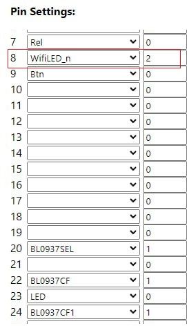

    Configured: Wi-Fi Led, Led, Buttom power ON/OFF & power monitoring
    Option #1 - Wi-Fi led is blue when connected. Turns off when there is no connection.
    [T34 BK7231N] Tuya Wifi Smart Plug: Flashing, Configuration, and Power Monitoring Options
    Option #2 - Wi-Fi led blinks blue when connected and goes out after connection.

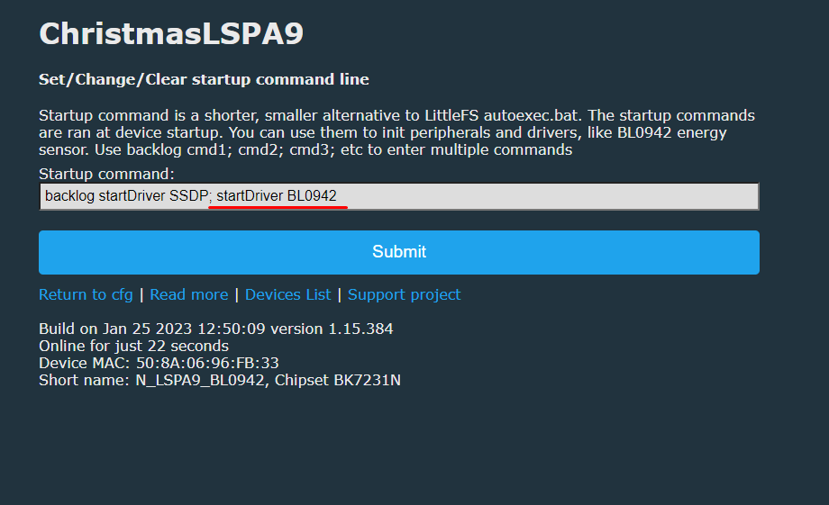

    #4 20414439
    Posts: 14611
    Help: 654
    Rate: 12623
    Regarding power metering - maybe try to start BL0942 driver?
    The power metering chip is usually BL0937 or BL0942. So we have a 50% chance to get BL0942, which is always on the same UART port.
    If it's BL0937, then it can use any pins, so it would be hard...
    But maybe let's try BL0942.

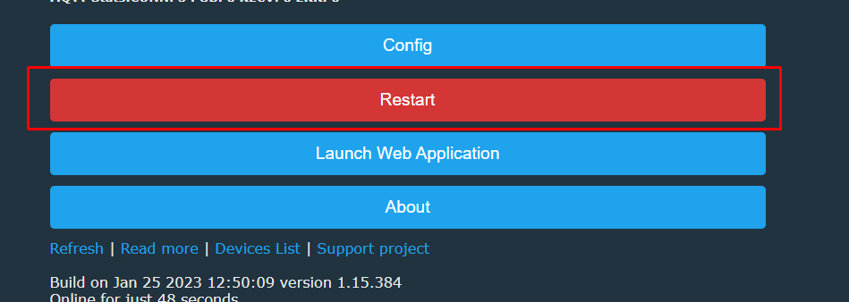

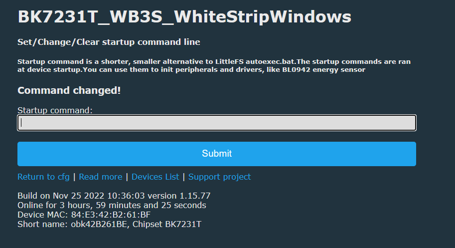

    Step 1: Config->Startup command text:
    Step 2: restart
    Step 3: do you get results?
    Step 4: calibrate with VoltageSet, PowerSet, CurrentSet (like Tasmota)
    https://tasmota.github.io/docs/Power-Monitoring-Calibration/

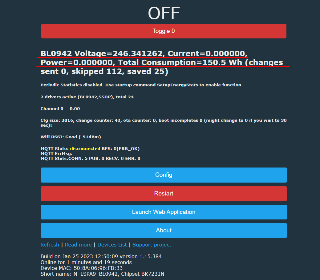

  • #5 20414454
    Svetlaya
    Level 4  
    Posts: 11
    Thank you!
    I tried yesterday to put BL0942.
    Voltage - very big!
    But I did not set it as you showed.
    After activating the driver, I introduced an adjustment.
    In the evening I'll just try to activate the driver.

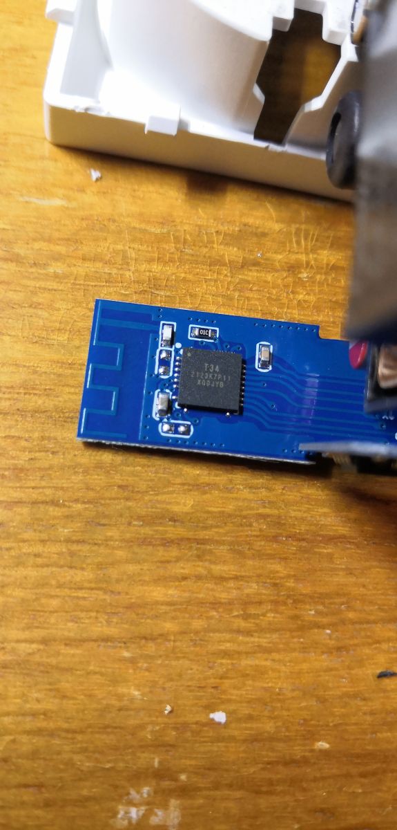

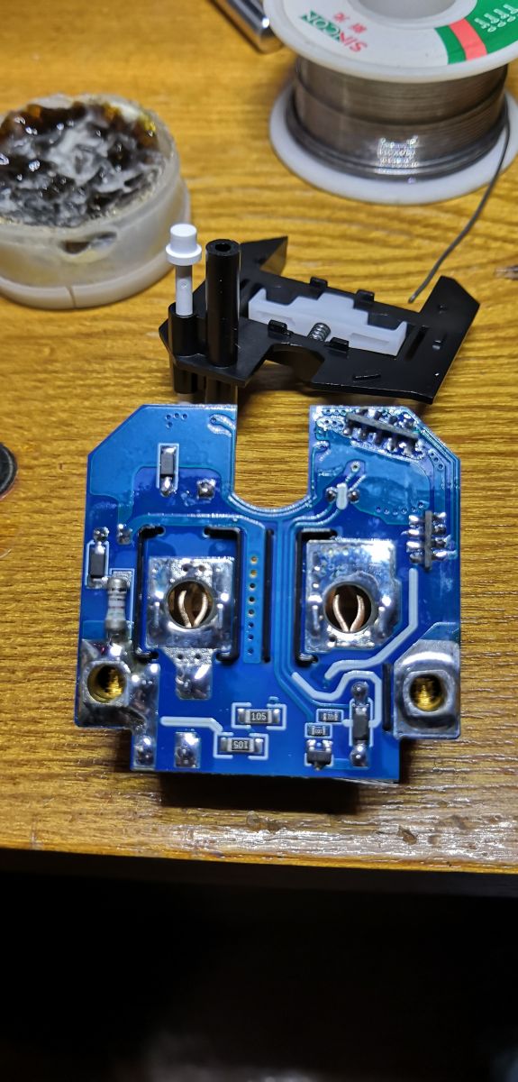

    Svetlaya
    Level 4  
    Posts: 11

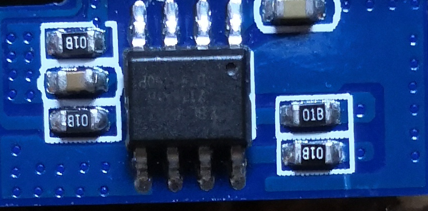

    can not see((
    Added after 6 [minutes]:
    Question.
    # startDriver BL0937
    Will disable BL0942?
    Added after 12 [minutes]:
    If adjustments were made
    # VREF 15987.125000
    # PREF-683.023987
    # IREF 272302.687500
    How to reset to default?

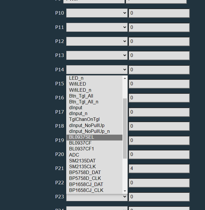

    #8 20414537
    Posts: 14611
    Help: 654
    Rate: 12623
    Wait please. I have some hints.

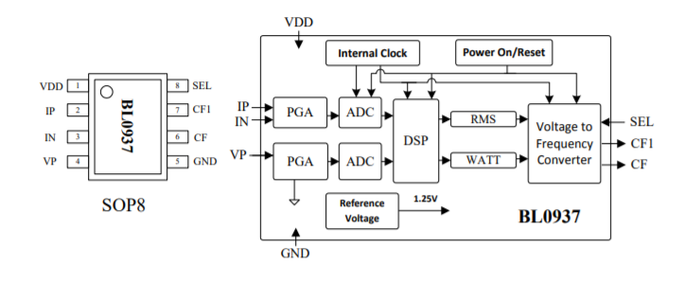

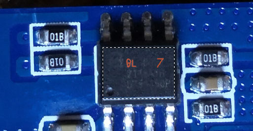

    First, this looks like '7', as in BL0937:
    Second, this is BL0942:
    so chip from photo is not BL0942 because it has 8 and not 10 pins.
    Third, this is BL0937:
    Fourth:

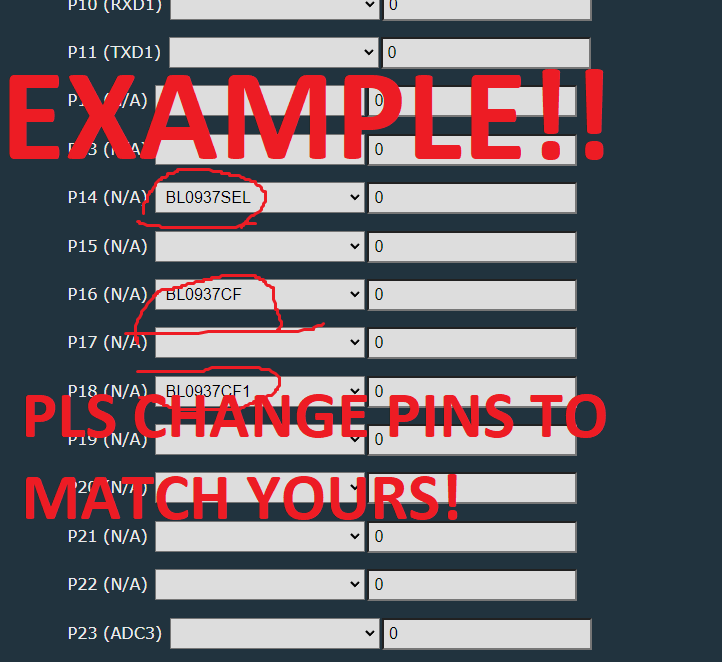

    for BL0937 you must do:
    - remove "startDriver", this is not needed
    - check which GPIO pin is used for CF, CF1 and SEL
    - set those GPIO in Config->Device:
    You need to set all 3 pins. Check which is which with multimeter.
    Well, just remove the line and save empty field.
    And reboot.
    The thing you need to do now is to determine which T34 pins are used for:
    - CF
    - CF1
    - SEL
    of BL0937.
    and of course you might need to reboot for BL0937 driver to start, at least for the first time.

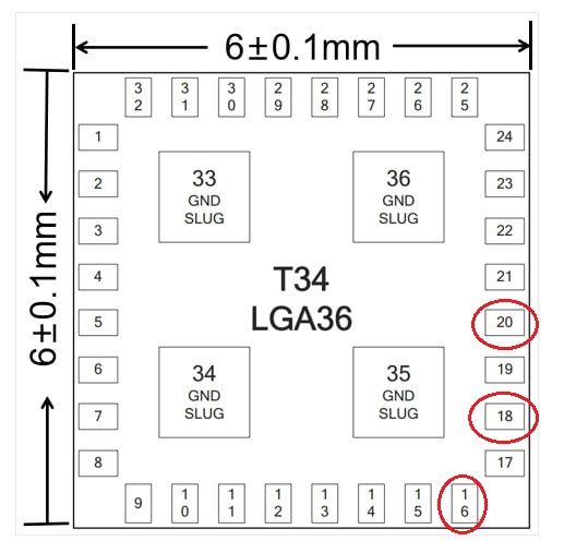

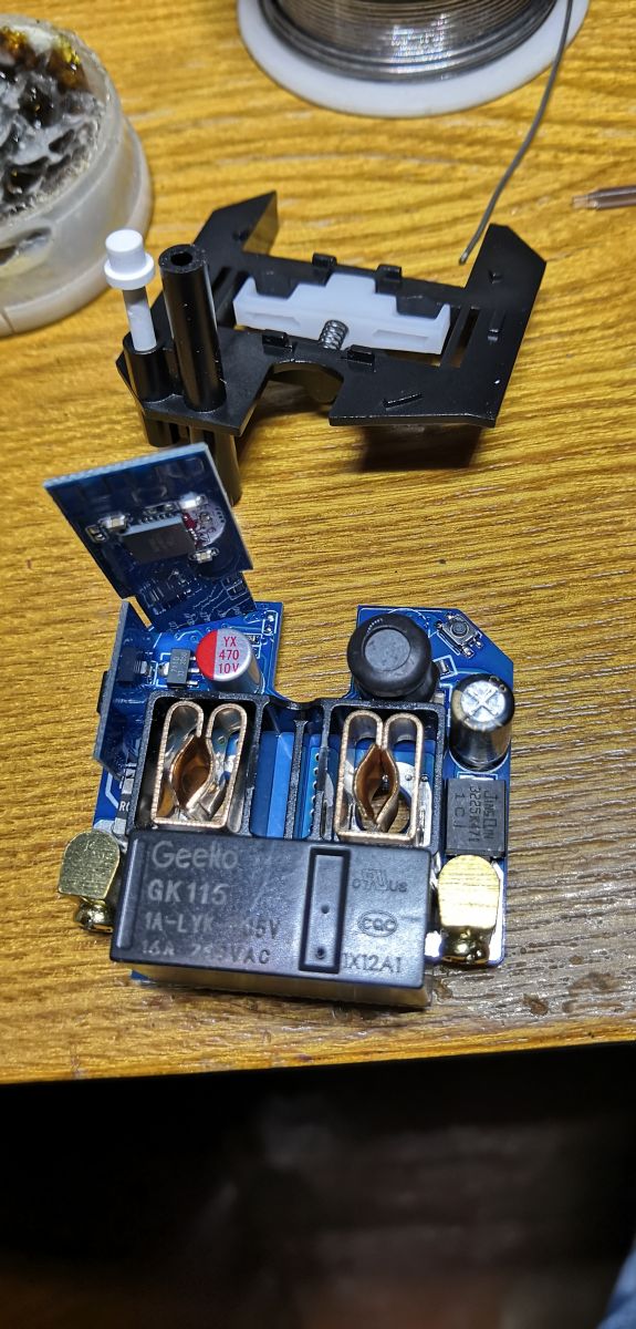

  • #9 20417944
    Svetlaya
    Level 4  
    Posts: 11
    Thank you!

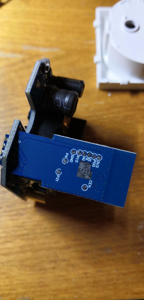

    I had to disassemble again and call contacts)))
    Datashit

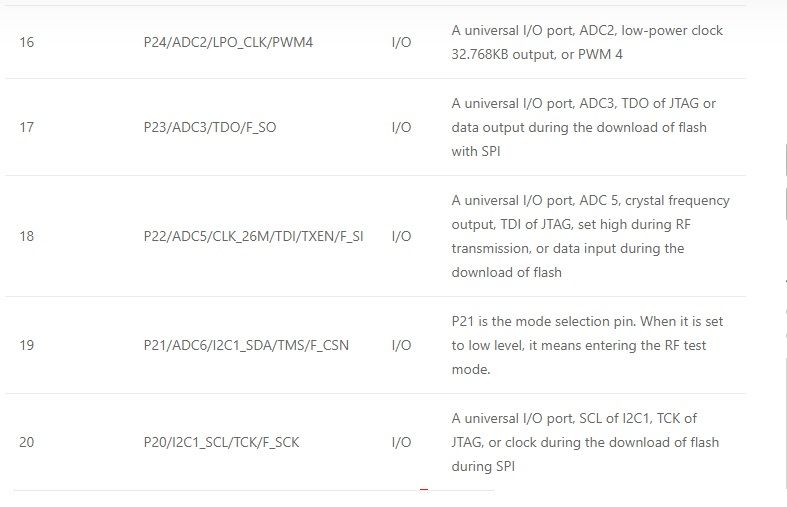

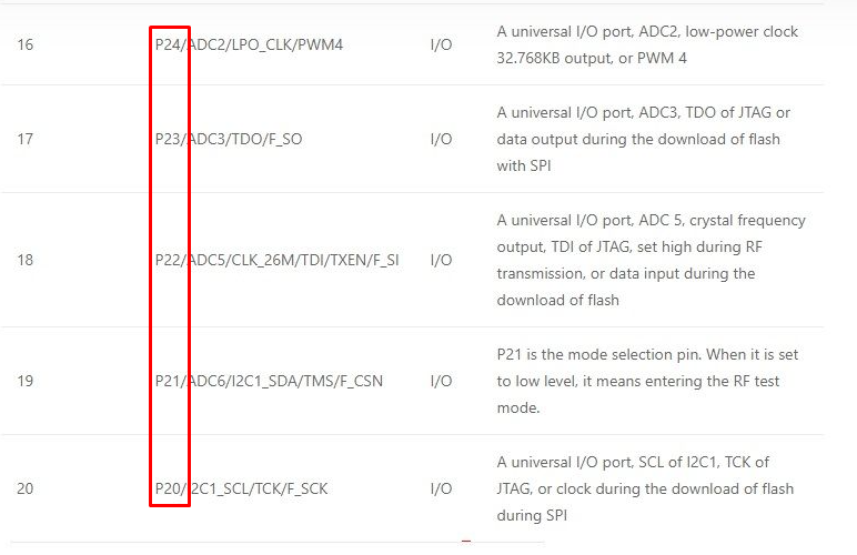

  • #10 20418053
    Posts: 14611
    Help: 654
    Rate: 12623

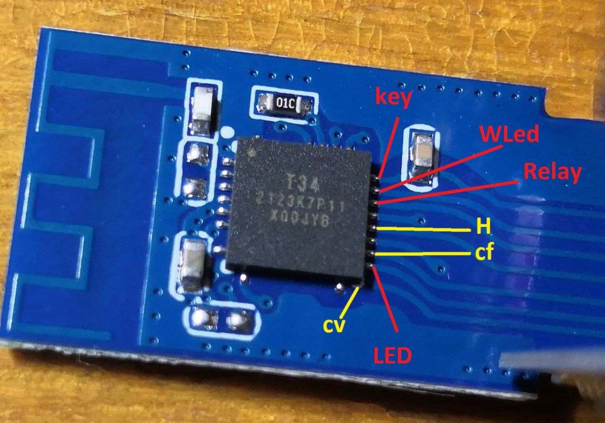

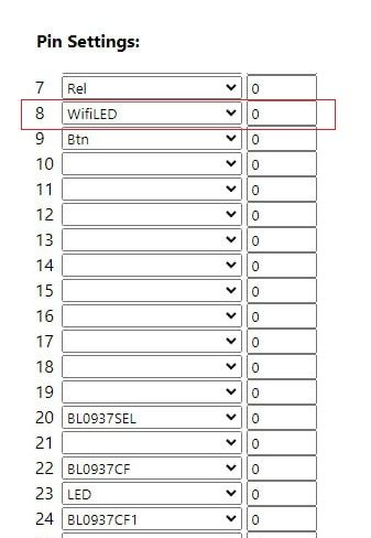

    Sorry, is "cv" a "CF1" ? And "H" is "SEL"?
    Those pin numbers: P22, P23, P24, etc
    are here:

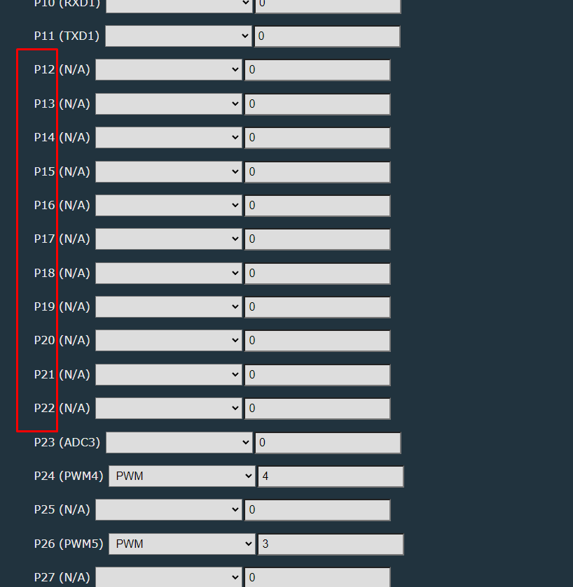

    Do something like:
    and reboot
  • #11 20418440
    Svetlaya
    Level 4  
    Posts: 11

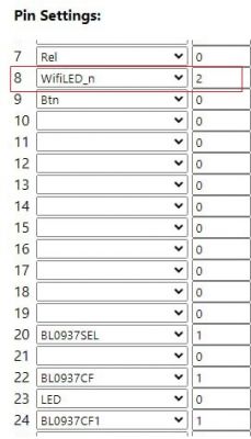

    Yes, is work monitoring.
    Designations on the board. Didn't change. For those who buy such a power plug.
    You can match the numbers by datashit or by looking at my config.
    and reboot
    not work!
    this is work
    [T34 BK7231N] Tuya Wifi Smart Plug: Flashing, Configuration, and Power Monitoring Options [T34 BK7231N] Tuya Wifi Smart Plug: Flashing, Configuration, and Power Monitoring Options
    and reboot
    not work!
    Example, real configuration is different.
    Svetlaya wrote:
    this is work
    Good jobs! Thanks.

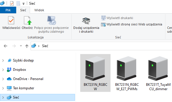

    Remember to try out:
    backlog startDriver SSDP; startDriver NTP
    SSDP is so devices show here:
    NTP is for realtime from web.

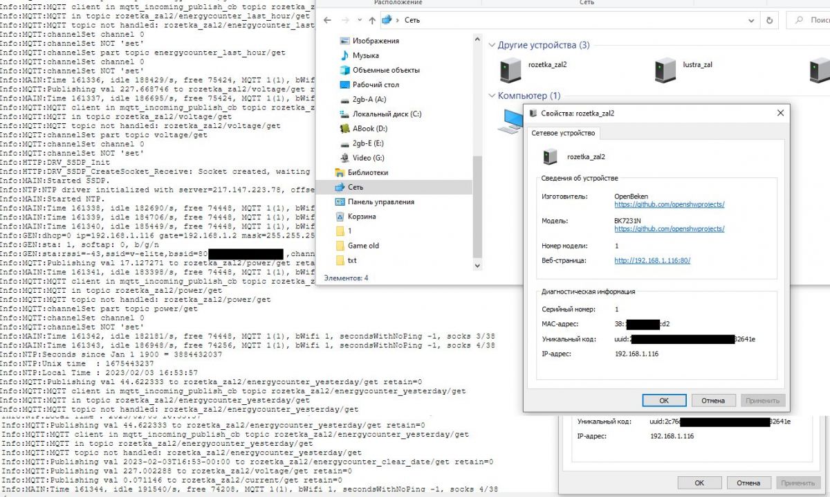

    Work! Thanks!
