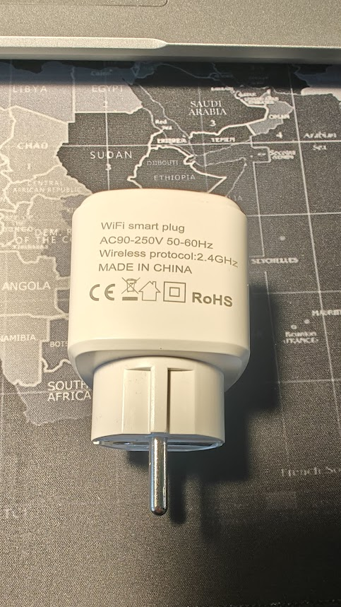

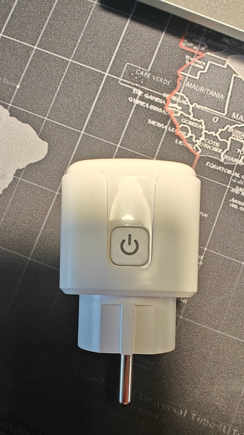

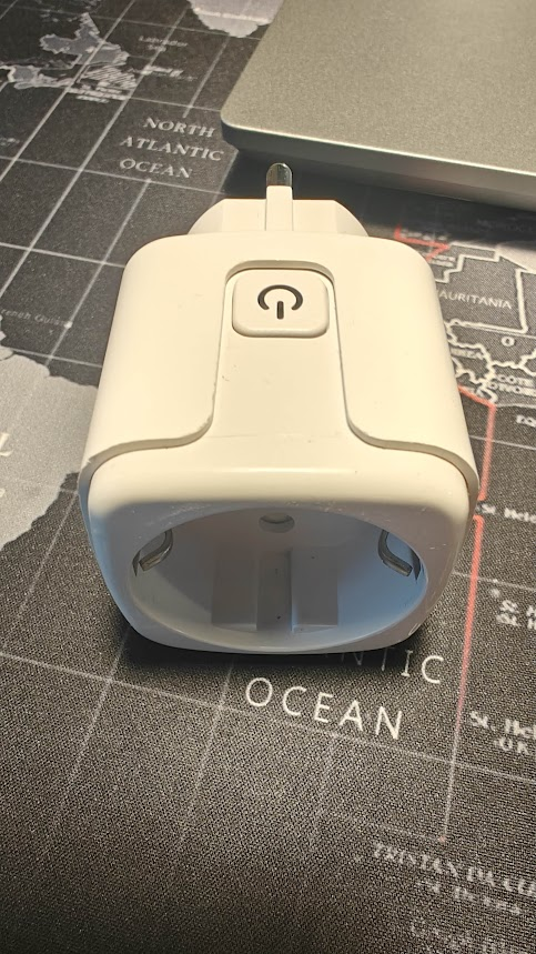

    Teardown of Tuya Smart Socket EU20A Wifi Smart Plug With Power Monitoring Smart Life APP Remote Control Support Google Assistant Alexa bought from aliexpress here https://vi.aliexpress.com/item/10050078840687...6hMe&gatewayAdapt=glo2vnm#nav-description
    Tuya Smart Socket EU20A WiFi power monitoring plug.
    Product looks like this:
    White smart plug with a power button on a dark background. View of a white Tuya EU20A Wi-Fi smart plug with technical specifications on a map background. White Tuya smart plug lying on a world map.

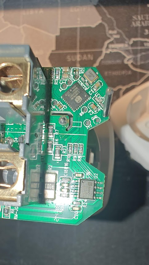

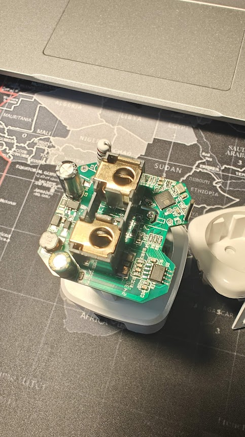

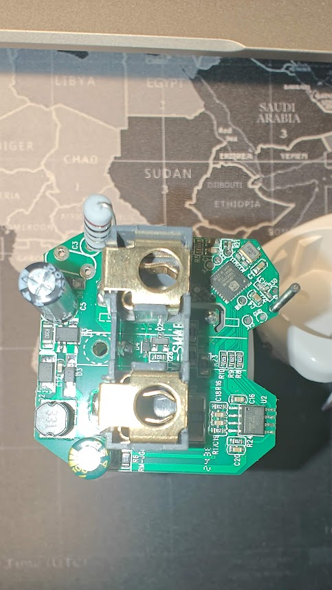

    Disassembled looks like this:
    Disassembled Wi-Fi smart plug lying on a world map. Close-up of the dismantled electronic board of a Tuya smart plug with visible components. Close-up of a circuit board with a microchip in a smart socket. Close-up of a circuit board with a chip labeled LIGHTNING LN882HV16. Close-up of a circuit board with a BL0937 chip and resistors. Close-up of the internal circuit of a disassembled Tuya Smart Socket.

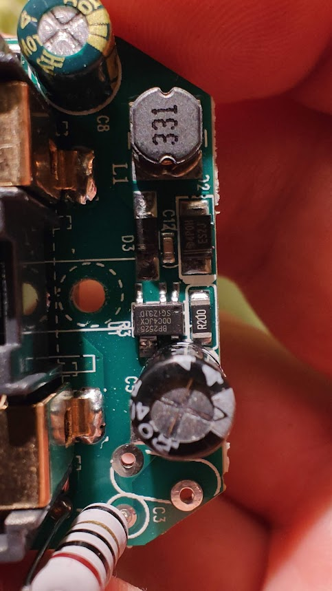

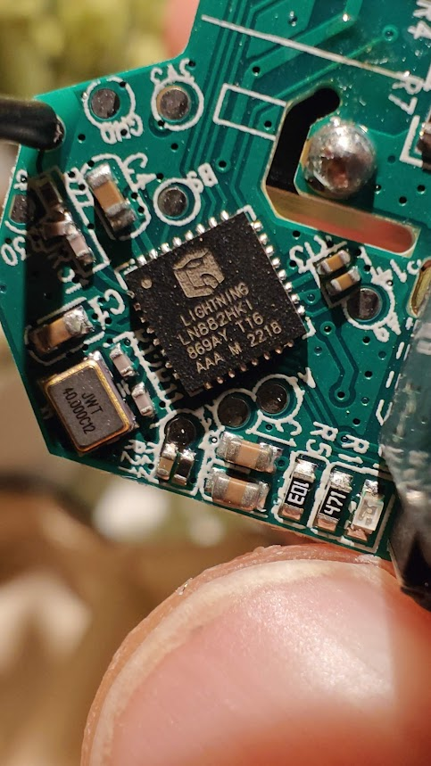

    After some reads on this forum and also some investigation, I'm dealing with :
    Part NumberPackage Flash SizeTemperature
    LN882HKIQFN-32, 5mm pitch2MB Flash-40℃~105℃

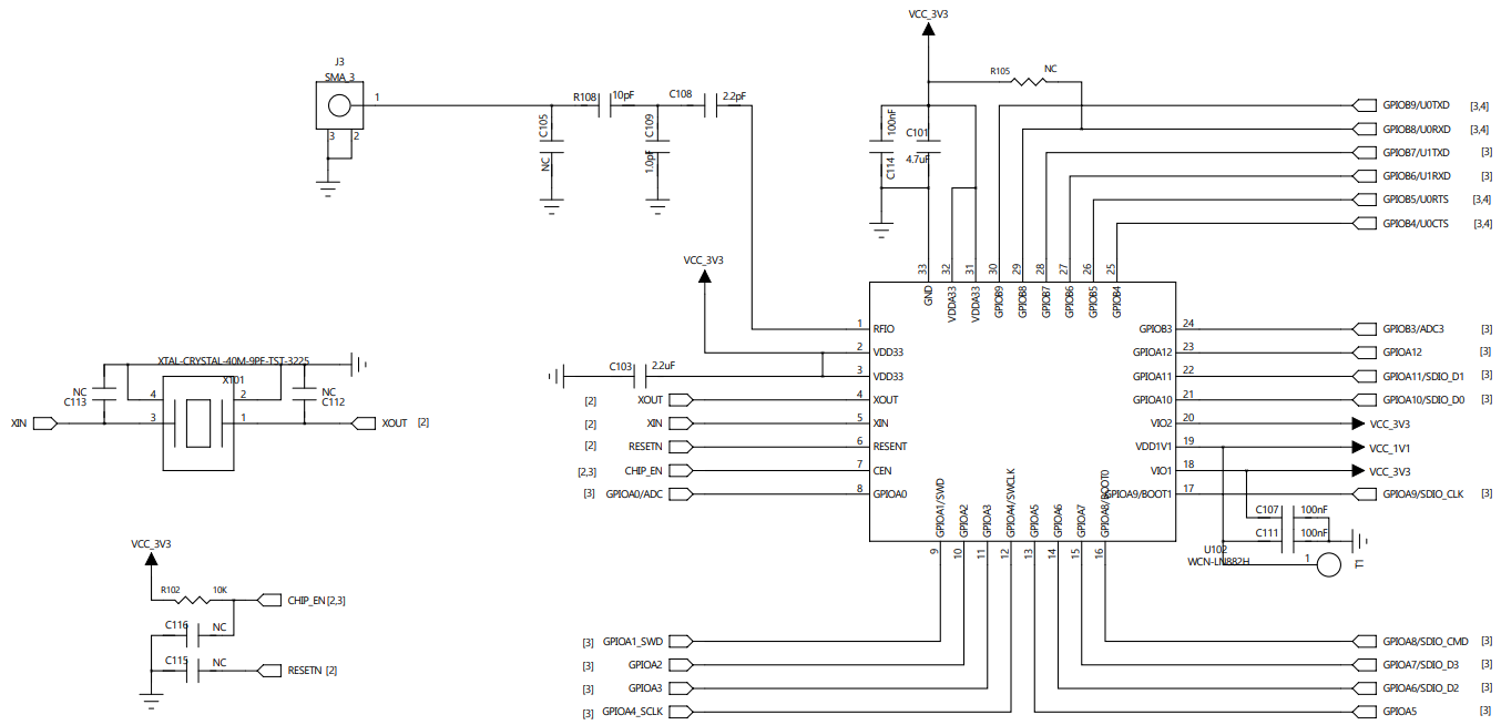

    Haven't found yet documented the pinout of this chip here, and I must admit that my time is very limited on investigation. But I managed to identify on board the following pins: GND, 3V3, A9, B9. Considering the schematic below A9 is for switching the boot mode and B9 is TXD0 of chip which should print out to serial port.
    B8 (RXD0) is missing any breakouts and that's why the delay on hooking into it as I need to figure out how to solder to that tiny pin without breaking anything.
    Electrical schematic showing connections and pin layout for the WCN-LN882H chip.

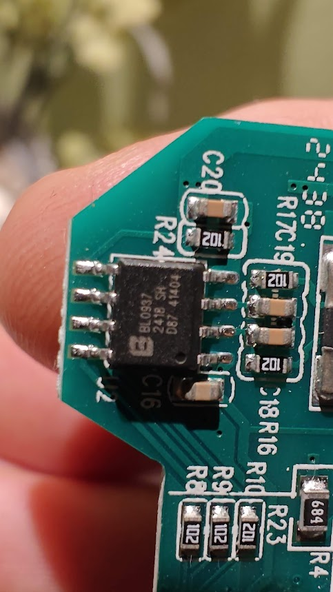

    Chip used for energy monitoring is marked with BL0937, which I didn't investigate about it by now considering my focus on switching firmware of this chip and after that managing the peripherals.
    I'll keep this updated with my investigation while I'm wondering if anyone managed to reflash this specific model.

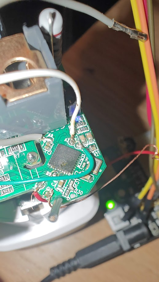

    Thanks Max. I managed to flash it successfully. It seems I was trying the wrong serial :D I haven't managed to dump the original firmware, but I don't care about it.
    Close-up of a PCB with soldered wires in various colors: red, white, gray, green, and an unsheathed wire.
    I soldered the wires as it shows in the picture above and:
    Red is 3v3
    Unshielded one is GND
    Gray is A9 which I shorted to the unshielded GND while flashing
    Green is TX of LN882HKI
    White is RX of LN882HKI
    My time for investigation is done for the day but since flashing is successful tomorrow I'll trace the config to fully functional device (fingers crossed).
    Edit: I used external 3v3 with common ground.

    Good news!
    So next task will be to trace the pins to BL0937 so you can configure them in the config page.
