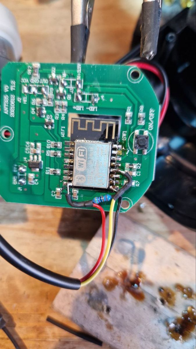

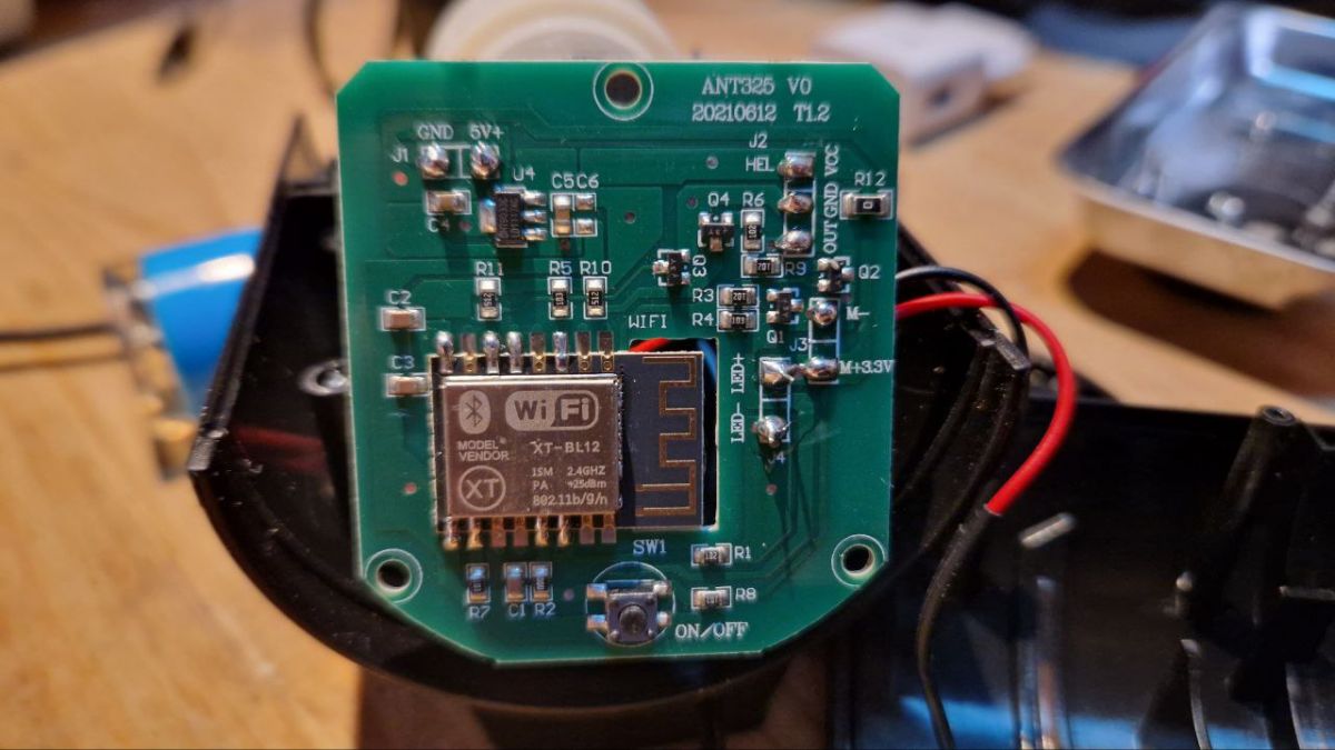

    I have recently purchased Automatic Fish Feeder from eBay.
    It has XT-BL12 chiplet inside. Inside this chiplet, it has BL602. I have successfully soldered my UART jig to it, and flashed OpenBelken firmware.
    Wi-Fi, MQTT works. I can also turn LED on/off, and rotate the drum.
    I have few questions:
    I have soldered DS18B20 temperature sensor to GPIO17. I have put 150k rezistor between data (GPIO17) and VCC, GND to GND.
    But I haven't found out how to configure it properly. GPIO mapper wizzard from the web doesn't help. Toggling the drum doesn't turn it off after one rotation, it keeps rotating. I have to turn it off manually. I know that with Tasmota, identical problem is solved by setting pulsetime1. How can I do the same thing here, ie: Turning the drum will toggle-off automatically after it finishes its single rotation.
    Second issue is that the default template doesn't know anything about temp sensor. I can't pick pin type from pre-defined list.
    It doesn't read correct values.
    Close-up of a circuit board with an XT-BL12 Wi-Fi module in an automatic fish feeder..
    And last, if I'll exclude HomeAssistant for now, how can I automate or mimic behavior of stock firmware, eg: When the drum rotates, LED blinks. When the button is pressed, it turns the drum once. If long-press is used, it forces an action (Pairing on stock, but I would prefer either reboot or safe mode).
    PCB with Wi-Fi module and soldered wires.

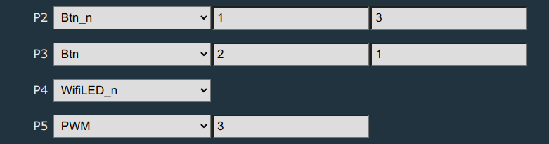

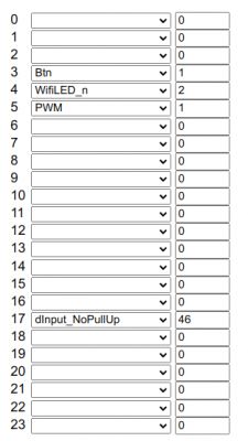

    To summ things up, I have so far identified GPIO03 as a button, GPIO04 as a LED, and GPIO05 as a drum rotation. Setting it to PWM allows me to rotate it through button on board's GUI. GPIO17 has a temp sensor connected.
    I was able to put button and drum rotation to one group, so by pressing the button, the drum rotates (and never stop until pressed again). Toggle in the UI thinks it is a light.
    Screenshot showing GPIO configuration for an automatic fish feeder.
    I am sorry if it was already discussed elsewhere....I tried to search for either BL602 controlling a motor, or BL602 used in fish feeder units, but haven't found anything. Most feeders uses different chiplets which usually work well with Tasmota.
    I have also tried to use gui flasher app to parse tuya mcu gpio config, but the app tells me that there was an error (tried both on Linux and Windows) while choosing tuyamcu dump binary file. The app refuses to download or read from BL602, because it was made for different chip. But it is able to verify connectivity from the unit over network, reads its chip, firmware version, etc. Is there a better or other way for BL602 to convert/parse tuyaMCU GPIO config?
    Also, the unit prints "boot incompletes 1" in its gui. Should I be worried?

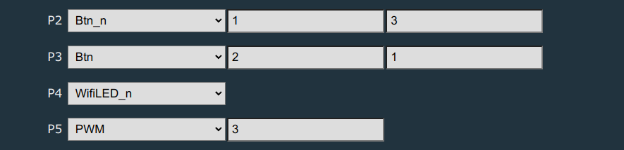

    Update2:
    Bellow button config works, eg: rotates the drum only once, both toggle and the button:
      "vendor": "Vanters",
      "bDetailed": "0",
      "name": "Automatic Fish Feeder",
      "model": "ANT325 V0",
      "chip": "BL602",
      "board": "XT-BL12",
      "flags": "-2080373664",
      "keywords": [
        "Feed",
        "Fish"
      "pins": {
        "2": "Btn_n;1",
        "3": "Btn;2",
        "4": "WifiLED_n;0",
        "5": "PWM;3"
      "command": "waitFor WiFiState 4;waitFor MQTTState 1",
    Screenshot of GPIO configuration for a BL602-based board
    In General/Flags, I had to enable "Flag 6 - [BTN] Instant touch reaction instead of waiting for release (aka SetOption 13)"
    Apart from it thinking about the toggle being a LED light, it works. Only thing remaining is the temp sensor. To me, it seems like device class isn't defined in OpenBeken.

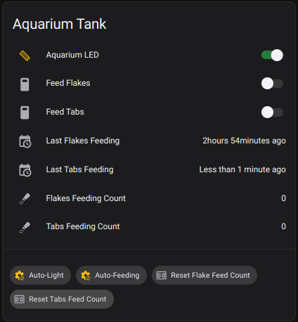

    As for HA integration, I did this:
    configuration.yaml
      - platform: template
        sensors:
           fish_feed_time_tabs:
            friendly_name: "Last Fish Feeding - Tabs"
            value_template: >
              {%- set time = (as_timestamp(now()) - as_timestamp(states.counter.number_of_feedings_tabs.last_changed)) | int  %}
              {%- set minutes = ((time % 3600) // 60) %}
              {%- set minutes = '{}minutes'.format(minutes) if minutes > 0 else '' %}
              {%- set hours = ((time % 86400) // 3600) %}
              {%- set hours = '{}hours '.format(hours) if hours > 0 else '' %}
              {%- set days = (time // 86400) %}
              {%- set days = '{}days '.format(days) if days > 0 else '' %}
              {{ 'Less than 1 minute' if time < 60 else days + hours + minutes }} ago
    mqtt:
      switch:
      - unique_id: "feeder1.iot.lan_switch"
        command_topic: "cmnd/Feeding/led_enableAll"
        state_topic: "Feeding/led_enableAll/get"
        availability_topic: "Feeding/connected"
        payload_on: 1
        payload_off: 0
      - unique_id: "feeder1.iot.lan_reboot"
        command_topic: "cmnd/Feeding/restart"
        payload_on: 1
        payload_off: 0
        state_off: "Feeding/online"
        state_on: "Feeding/offline"
    I have added helpers to serve as a counter(s), and input boolean toggles to serve as a virtual on-off switch. I have two feeders, one based off of WBR3 - so used with TuyaLocal, and second one with BL602 I am playing with now, named Feeder1 (Tabs).
    Aquarium control panel with various options and counters.
    Aquarium LED Strip as seen in the dash panel screenshot is different controller entity not related to BL602

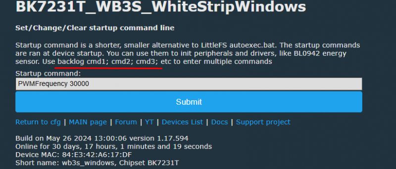

    For PulseTime, you need to see:
    In case of BL602, you can put those scripts in short startup command. Maybe something like this:
    // This aliased command will turn off relay on CH1 after 10 seconds
    // addRepeatingEvent	[IntervalSeconds][RepeatsOr-1][CommandToRun]
    alias turn_off_after_time addRepeatingEvent 10 1 setChannel 1 0
    // this will run the turn off command every time that CH1 becomes 1
    addChangeHandler Channel1 == 1 turn_off_after_time
    We don't get BL602 devices often so we haven't ported LFS to this platform yet.

    Thanks for the tip! This MCU (not Tuya apparently) has a break relay, which breaks/disconnects right after turning it on. So, I mapped it like this:
    Screenshot of Pin Configuration settings with four different configurations.
    And it does work correctly. So one turn only. If I'll toggle PWM, then it will do two rotations. From this perspective, I achieve what I wanted - the feeder is remotely controllable without a Chinese cloud provider. But the temperature I wanted to get....I can live without it, but it is sad.

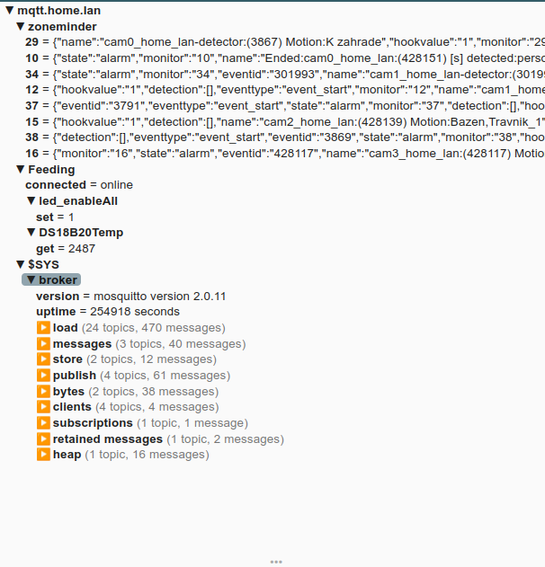

    Sorry for too many edits. I was able to make it work after reading the manual again....I had to specify the driver to start:
    startDriver DS1820
    Now I can read the sensor, although the value was initially off. But now it looks like it is reading correct value. So it works. thanks a lot and again, sorry for confusion!
    #18 21290549

  • #22 21291298
    Posts: 14770
    Rate: 12912
    If you want to run multiple commands in the short startup line, you need to use "backlog":
    Screenshot of a user interface for setting startup command line for BK7231T device.
  • MQTT temperature published without decimal point
    #23 21291312
    Virnik0
    Posts: 16
    Thanks!
    Didn't noticed this to be honest.
    Using bellow fixed the issue, now it correctly starts the repeating event:
    backlog startDriver DS1820 5; waitFor WiFiState 4;waitFor MQTTState 1; addRepeatingEvent 60 -1 publishFloat DS1820Temp $CH5;
    OpenBelken FW does what it promissed to do. Data is output to proper MQTT queue/topic. Processing it correctly is another story, because it prints this:
    Feeding/DS18B20Temp/get:
    2487
    Is there a way to add decimal point to the value before it is going to be exported? To show like 24.87 in mqtt instead of 2487 it does now?
    Screenshot of an MQTT console showing various topics and values, including DS18B20Temp.
    If anyone is interested, bellow yaml snippet works in HA to collect the temperature and move decimal split to proper place:
