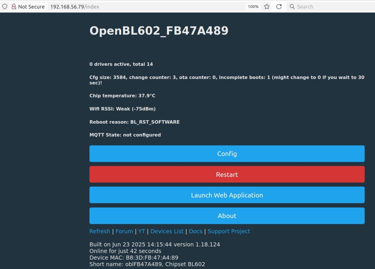

    I'm having troubles with instability with the BL602 chip. It's in a SM-028_V1.3 module that I'm using to experiment and gain more knowledge about OpenBK.
    I've successfully flashed several different OpenBK versions, but it seems that they all eventually end up with the BL602 in a boot loop.
    To learn more, I've practiced flashing using two different methods: direct UART using Boufallo DevCube (sometimes erasing the chip), and OTA through the OpenBK WebApp.
    At first I thought the problem might be mistake(s) with my config, so I ended up not configuring anything except the Wifi. Most recently, I flashed a stock copy of 1.18.124, connected to the AP at 192.168.169.1, configured the Wifi for my home network, and rebooted. All this was done successfully and I could reach the BL602 easily (IP address is 192.168.56.79):
    BL602 SM-028_V1.3 Boot Loop After OpenBK Flashing - [APP] [EVT] Unknown code 11, 5795
    After doing a full power cycle, the SM-028_V1.3 "disappeared". Checking log output via a UART showed that the BL602 was in an endless boot loop. This had also happened immediately prior to the last flash, when I had accessed the unit and then just left the unit running undisturbed for several hours. So it seems I run into this problem whether I'm accessing the unit via the web interface, or just leaving it alone.
    I've pasted the log below. You can see that the error immediately prior to the reboot is:
    I'm still new to OpenBK so I haven't yet learned the process (i.e. where to search) for determining and solving a problem such as this.
    Any help is much appreciated.
    Thanks.

    Ok, power supplies arrived and wired up. Booted and connected to wifi perfectly right away. I'll keep it running for several days and report back again. (Though if everything works just fine, it's possible I'll forget because "everything is just working" properly!)
