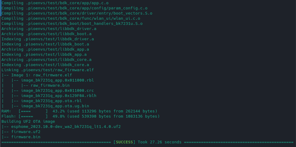

WA2 module BEKEN BK7231QN40 / Beken/HLK-B30 WA2 does not work with openbk7231
anderson007104 6393 49
Why does OpenBK flash successfully on my WA2 BK7231Q module but the module does not work afterward?
OpenBK7231 T/N firmware does not work on WA2 because this module uses a different BK7231Q variant with an incompatible bootloader and Wi‑Fi blob, so the usual T and N SDKs are not compatible with it [#20624538] The module’s flash is reportedly not encrypted, but the bootloader is different and does not unprotect flash properly, which also makes flashing unreliable [#20624538] Another reply confirmed that BK7231Q is a different chip and that even if the firmware compiles, the result is likely the same as LibreTiny: no Wi‑Fi [#21596923] In practice, the issue is not just the flash offset or programming tool; it is a missing/unsupported BK7231Q firmware stack for WA2 [#20624538]

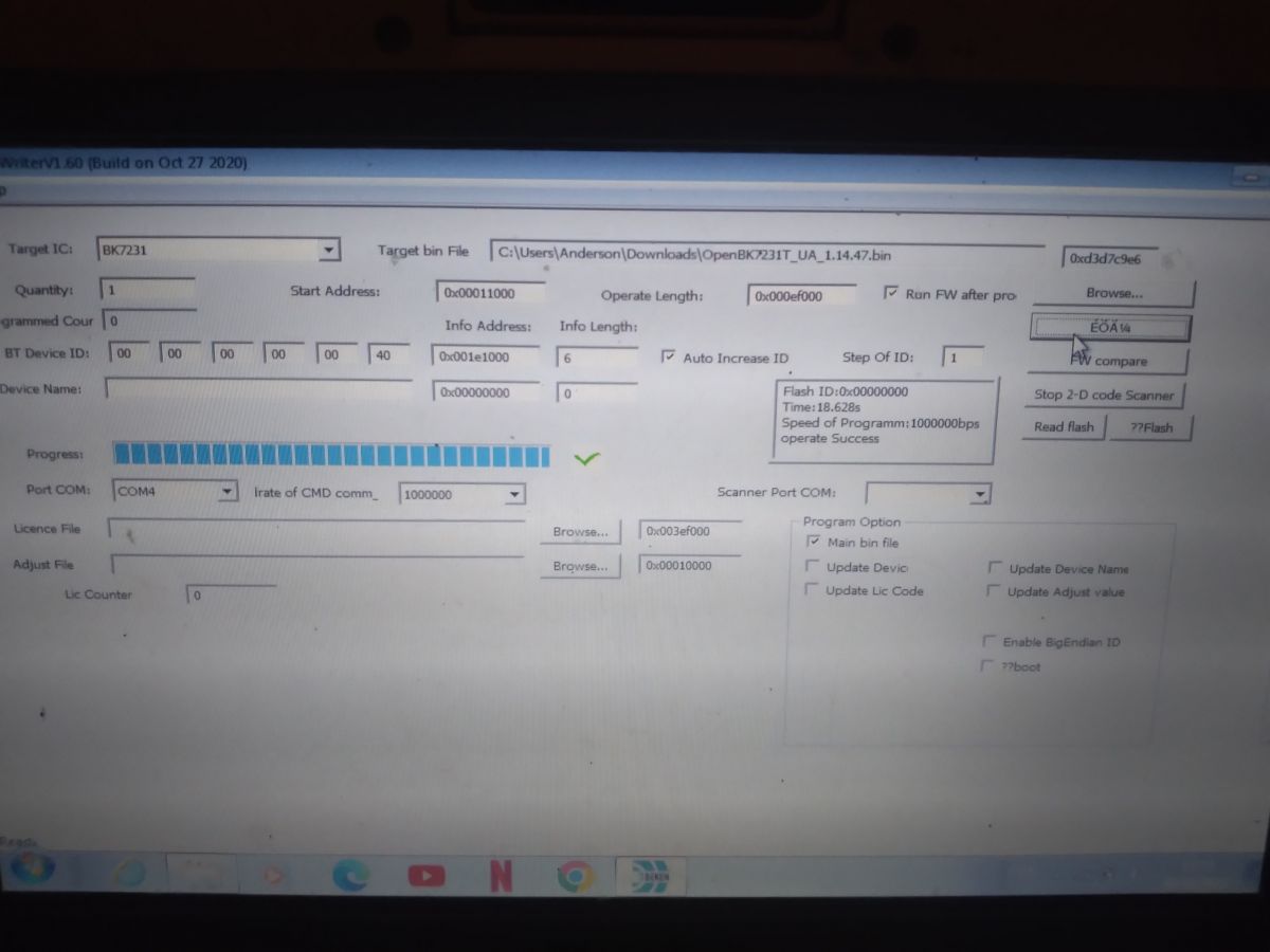

    I tried to flash openbk in the WA2 module, it flashes successfully but it doesn't work. Could anyone help me to solve the problem?

    #2 20256277
    Posts: 14743
    Rate: 12839
    Hello, I will try to help you, but in those cases, can you provide some basic diagnostic information?
    1. Do you get OpenBeken access point visible and if so, have you managed to configure your WiFi SSID and pass?
    2. If not, have you tried connecting UART RX to TX2 (log output; TX1 is programming; TX2 is log), what does the log say?
    3. Can you show us the screenshot from programming tool to confirm that it did flash correctly? Did you use a correct bin file for your platform? For T, you flash UA at default offset. For N, you flash QIO at 0.

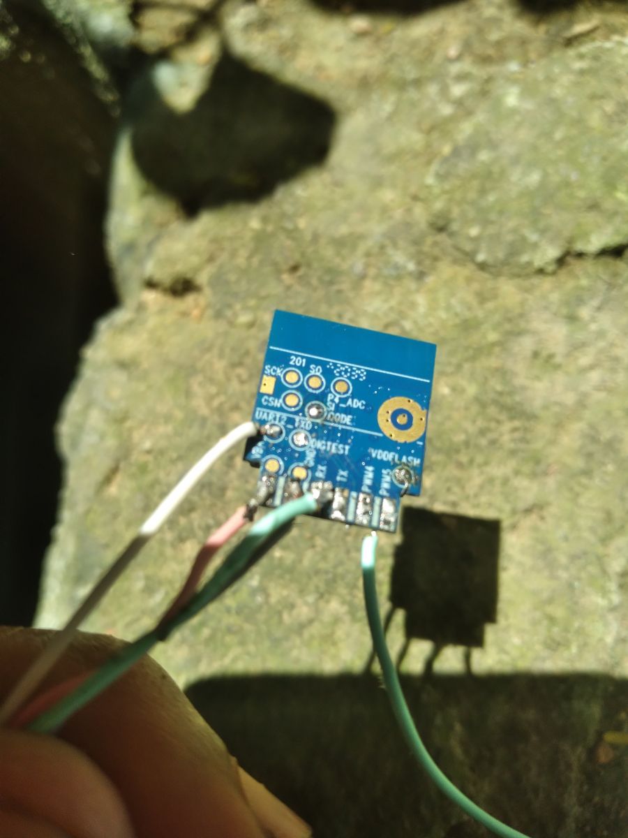

    I have a doubt how to use Writer V1.60 to get the log. My WA2 module only has the TX2 I didn't find the RX2.
    Here flash image successfully

    TX2 is good. You have to connect RX of USB to UART dongle to TX2 to receive log. Use any app for UART communication, RealTerm can work, Putty can work as well. Remember to set 115200 baud rate

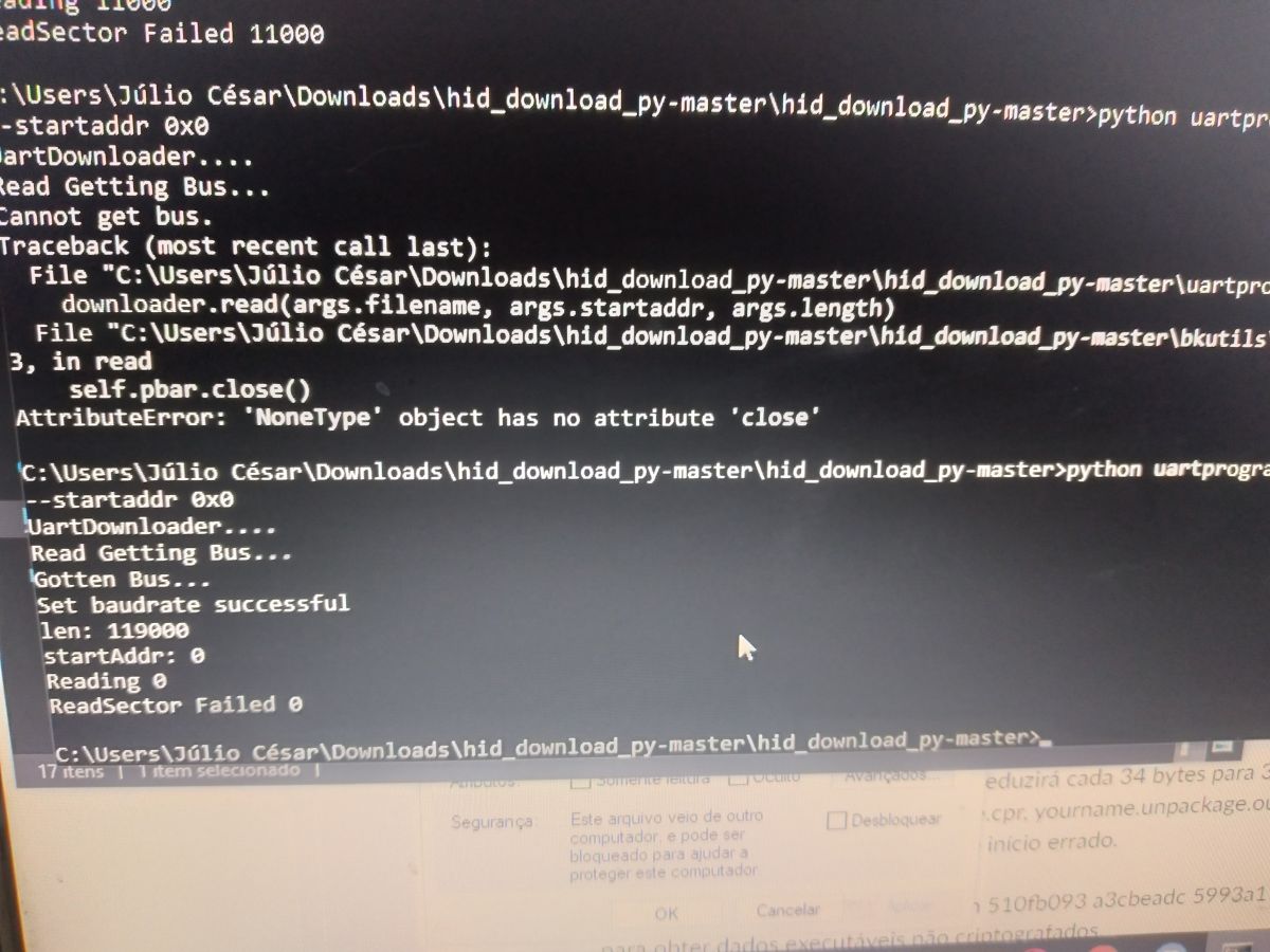

    The log repeats this message infinitely
    =~=~=~=~=~=~=~=~=~=~=~= PuTTY log 2022.10.28 21:56:27 =~=~=~=~=~=~=~=~=~=~=~=

    �����v1.1
    [I/FAL] Fal(V0.4.0)success
    [I/OTA] RT-Thread OTA package(V0.2.4) initialize success.
    v1.1
    v1.1
    v1.1

    I tested two firmware versions and the log is the same

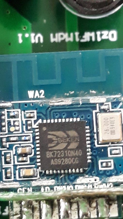

    It looks like it may be using a different variation of BK chip. What was the original firmware printing?
    This is the original firmware log
    12:14:58.749 -> [I/OTA] RT-Thread OTA package(V0.2.4) initialize success.
    12:14:58.749 -> [01-01 18:12:15 TUYA Info][lr:0x998a5] mqc app init ...
    12:14:58.749 -> [01-01 18:12:15 TUYA Info][lr:0xa297f] thread_create name:sys_timer,stackDepth:4096,totalstackDepth:4096,priority:5
    12:14:58.796 -> [01-01 18:12:15 TUYA Info][lr:0xa297f] thread_create name:cmmod,stackDepth:4096,totalstackDepth:8192,priority:4
    12:14:58.796 -> [01-01 18:12:15 TUYA Debug][lr:0x99853] mq_pro:5 cnt:1
    12:14:58.796 -> [01-01 18:12:15 TUYA Debug][lr:0x99853] mq_pro:31 cnt:2
    12:14:58.796 -> [01-01 18:12:15 TUYA Debug][lr:0xa280b] Thread:sys_timer Exec Start. Set to Running Stat
    12:14:58.796 -> [01-01 18:12:15 TUYA Err][lr:0x95373] logseq empty
    12:14:58.796 -> [01-01 18:12:15 TUYA Debug][lr:0xa22ef] svc online log init success
    12:14:58.796 -> [01-01 18:12:15 TUYA Info][lr:0xa297f] thread_create name:wk_th-0,stackDepth:5120,totalstackDepth:13312,priority:3
    12:14:58.796 -> [01-01 18:12:15 TUYA Notice][lr:0x749dc] < TUYA IOT SDK V:2.3.1 BS:40.00_PT:2.2_LAN:3.3_CAD:1.0.3_CD:1.0.0 >

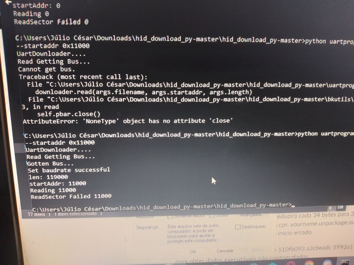

    I tried and got these errors
    WA2 module BEKEN BK7231QN40 / Beken/HLK-B30 WA2 does not work with openbk7231 WA2 module BEKEN BK7231QN40 / Beken/HLK-B30 WA2 does not work with openbk7231
    I tried to flash the firmware and it gave an unprotected error. I tried without using --unprotected in the command and it was flashing the firmware, the result is that the module does not rewrite anymore. I have another module of the same to try.

  • BK7231QN40 incompatibilities and broken Wi-Fi blob
    #24 20624538
    kuba2k2
    Posts: 120
    Rate: 13
    Hi,
    I have this device as well. It is noticeably different from BK7231T (and most likely older). The main differences (incompatibilities) are:
    - the flash is not encrypted (existing firmware solutions will not work out-of-the-box)
    - the bootloader is different (a bit like T's bootloader, not N)
    - it doesn't have Bluetooth - thus, the T and N SDKs are not compatible with it. "bdk_freertos" is also incompatible
    - it seems not to have IrDA, "real" timers (only "pwm" timers) and few other peripherals
    - I have managed to compile my firmware for this chip, and got it to boot up (this required a few hacks). However, the Wi-Fi part is completely broken (STA, AP, scanning, nothing works). It requires a different WiFi blob.
    - the bootloader doesn't unprotect flash, which is quite an annoying issue. Flashing usually doesn't work right away. Sometimes hid_download_py is able to flash, but I need to power-cycle it first (CEN won't work). Then ltchiptool is also able to flash it, but only once.
    I'm not sure how to proceed from here. Adding support for this chip would be quite a challenge, as it has a different SDK (and everything is old there).

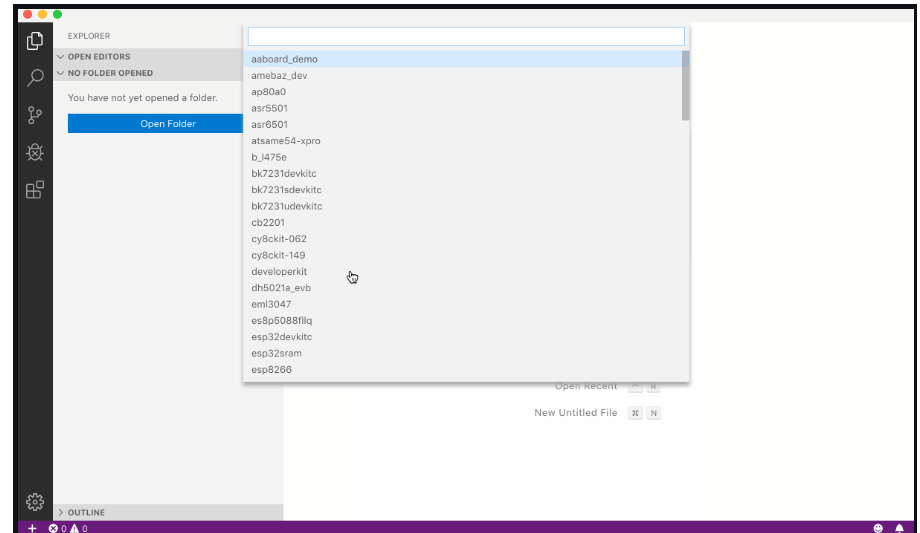

    One SDK might be what we look for, it is Alibaba's AliOS SDK.
    It has support for bk7231, but it is super complicated, although they have text instructions on how to start developing using their platform, but most of it is in CN.
    Apparently, Baken is based on ARM Cortex-M4.
    https://github.com/alibaba/AliOS-Things/wiki/AliOS-Things-Hardware#arm-cortex-m4
    They have a quick start for Linux: https://github.com/alibaba/AliOS-Things/wiki/Quick-Start
    They also have one in CN for Windows using VSCode plugin of theirs: https://github.com/alibaba/AliOS-Things/wiki/AliOS-Things-Studio
    User interface with a dropdown list of available board models.
    That is all great, but it means you need to build your own firmware from scratch, and that is before we even know if Q is among the supported devices or not.

    #29 20859869
    BDFp
    Posts: 6
    I decided to look some more into libretiny and in fact they indeed have support for Q variant.
    I am capable of building an image.
    I followed the esphome libretiny instructions on https://docs.libretiny.eu/docs/projects/esphome/
    I did this:
        Open a terminal/cmd.exe, create esphome directory and cd into it.
        git clone https://github.com/libretiny-eu/libretiny-esphome
        cd into the newly created libretiny-esphome directory.
        Check if it works by typing python -m esphome
    The last step failed so I needed to run to install esphome library into python:
        pip install -e . --break-system-packages
    --break-system-package is there because it would not let me install it otherwise.
    Then you run the wizard that will create basic yml file:
        python -m esphome wizard yourdevice.yml
    The file looks like this:
    esphome:
    bk72xx:
      board: wa2
      family: bk7231q
    # Enable logging
    logger:
    # Enable Home Assistant API
    api:
      password: "xxxxx"
    ota:
      password: "xxxxx"
    wifi:
      ssid: "xx"
      password: "xxxxxx"
      # Enable fallback hotspot (captive portal) in case wifi connection fails
      ap:
        ssid: "Test Fallback Hotspot"
        password: "F0gJM6nfV6S9"
    Now you need to add the rest of the config and this is where the link I mentioned in previouse post comes into use: https://docs.libretiny.eu/boards/wa2/#pin-functions
    I have no clue which pin does what but I guessed that the new config looks something like this:
    esphome:
    bk72xx:
      board: wa2
      family: bk7231q
    # Enable logging
    logger:
    api:
      password: "xxxxx"
    ota:
      password: "xxxxx"
    wifi:
      ssid: "xx"
      password: "xxxxxx"
      ap:
    text_sensor:
      - platform: libretiny
        version:
    binary_sensor:
      - platform: gpio
        pin:
          number: P6
          inverted: true
          mode: INPUT_PULLUP
        on_press:
          then:
            - switch.toggle: switch_1
    switch:
      - platform: gpio
        pin: P18
    status_led:
      pin:
        number: P8
        inverted: true
    With that we have everything we need to build an image.
    Screenshot of the esphome compilation in a terminal.
    Files are located in the libretiny-esphome folder, to be precise in:
        /libretiny-esphome/.esphome/build/test/.pioenvs/test/
    There is a command that allows you to upload the files directly to the device:
        python -m esphome upload testdevice.yml
    For me this is where it failed.
    Here you should see two options, one for ota upload and second for hardware flashing.
    Maybe because I didn't have anything connected for hardware flashing, esphome tried to connect to a device for ota update and failed to find any devices
    It is suppose to be as simple as in this tutorial https://www.youtube.com/watch?v=yXvPMAv4bIQ&ab_channel=thebatu89
    OTA firmawere is 1.8Mb, the same is firmware.bin, so it is rather big for what wa2 has, I think.
    That said raw_firmware.bin is only 526.8 KB
    I can't really test if it works or not.
    I don't have any flashing setup, I was really hoping for ota to work.
    Build folder has tons of files pulled for compilation, there are c libraries for bk7231q, bunch of config files for it.
    I'm sure it will be helpful to someone.
    This is where I am now and that will be it for me, since I have no clue which files to upload, even if I would attempt to do it manually.
    I really don't want to brick my device.
    • bk7231qImageFiles.zip (9.25 MB) You must be logged in to download this attachment.

    ValueError: Chip CRC value 6A339F12 does not match calculated CRC value 4A5A80CD
    If I'm not mistaken, the above error message means that the CRC from the file does not match what was calculated after the transfer, right?
    Which means either the data transfer was corrupted, the programmer is at fault, or something is wrong with the image?
    I don't have another programmer, so the only thing I could try is to shorten the cables, but I don't think that would work.
    I guess it is something to try another time.
    Unfortunately, once again, I'm not able to proceed further.

Has anyone booted LibreTiny on BK7231Q?
A custom LibreTiny-ESPhome image compiled, but upload failed with the same CRC mismatch, and no confirmed boot exists yet [Elektroda, BDFp, post #20859869]
