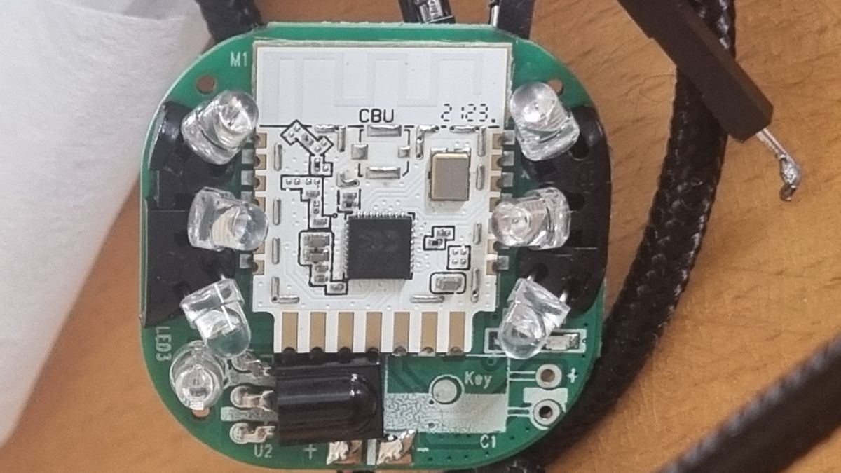

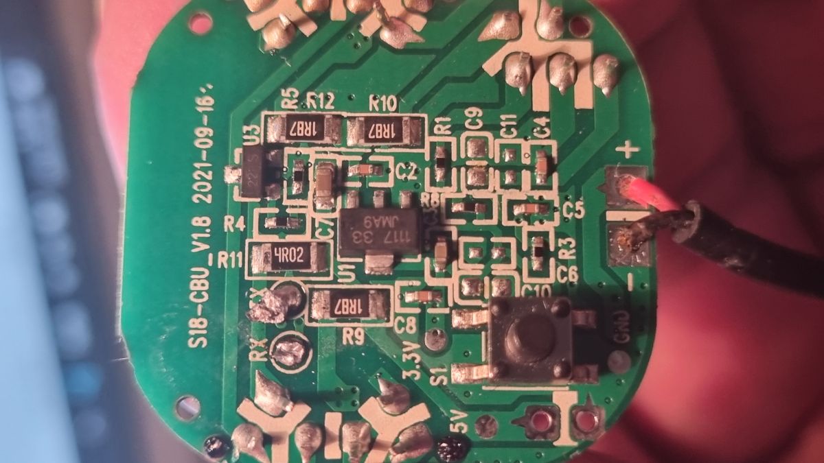

    Flashing S18-CBU_V1.8 with OpenBK7231N_QIO_1.18.138.bin failed. Did get OK after flash, but no wifi hot spot.
    The program on the unit seems to not start.
    No output on TX2
    I have tried to flash again , it do flash ok, but I don't have to boot for it to flash so I think the main program isn't started.
    Any advice ?
    S18-CBU_V1.8 Flashing OpenBK7231N_QIO_1.18.138.bin: No WiFi Hotspot or TX2 Output
    AI: How did you flash the OpenBK7231N_QIO_1.18.138.bin file to your S18-CBU_V1.8? (e.g., which tool or method did you use, and did you use serial or another interface?)
    I flashed with BK7231Flasher
    AI: Does the device show any signs of life after flashing, like LEDs turning on or any heat from the board, or is it completely unresponsive?
    No led or wifi, but I can read config, write config and flash with BK7231Flasher.
    Added after 5 [hours] 30 [minutes]:
    Tested and googled some more. Found a solution.
    Installed ltchiptool
    flashed bootloader with : ltchiptool flash write -s 0x0 -l 0x11000 -f bk7231n OpenBK7231N_QIO_1.18.139.bin
    Then normal flash with : ltchiptool flash write OpenBK7231N_QIO_1.18.139.bin
    Everyting is OK!
