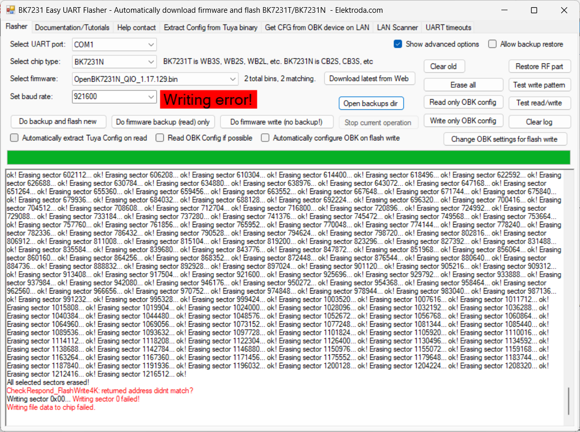

    Hi,

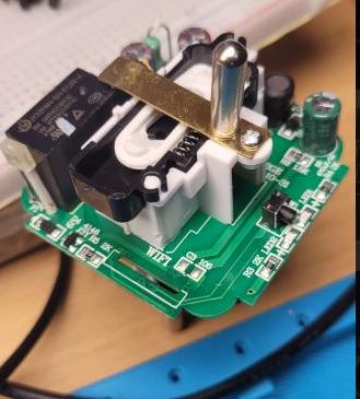

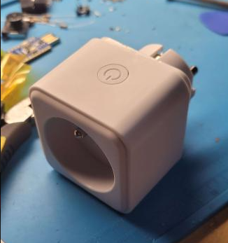

    I've actually the same issue with an electrical plug. Got the same "Failed to read device MID!".
    CB2S with BK7231T? Failed to read device MID - wrong WiFi module label?
    I attach the first dump for this device with a few pictures.

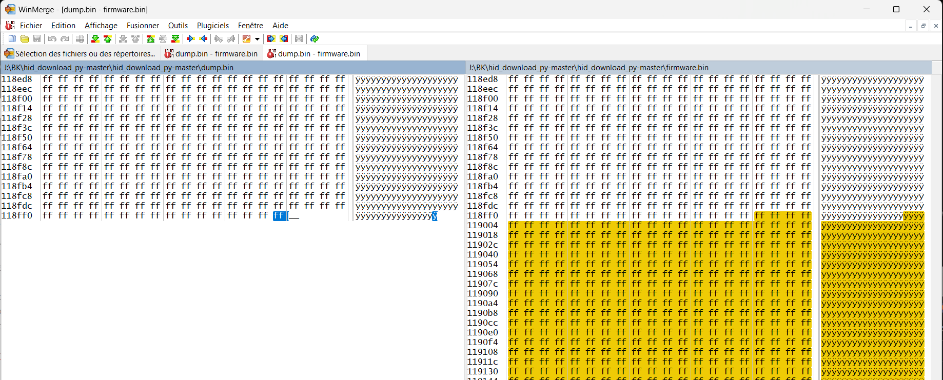

    It seems I've been able to write the h118ffb first byte with hid_download correctly compared to your last firmware but no hotspot once this one started. I am also unable to use the "Unprotect" option.

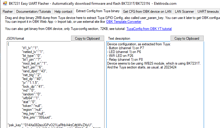

    EDIT: Wait, I can see the problem! What a strange issue! You have BK7231T marked as CB2S, but CB2S should be BK7231N! Try using BK7231T mode. It's not the first time they have swapped chips/markings!

    Here's extracted config from the binary:
    - Button (channel 1) on P7
    - LED (channel 1) on P6
    - WiFi LED on P26
    - Relay (channel 1) on P8
    Device seems to be using WB2S module, which is using BK7231T.
    Added after 28 [seconds]:
    Your firmware dump also identifies as WB2S/BK7231T:
  • #3 20598516
    viandoxone
    Hi,
    You have lynx eyes mate !!
    It works fine with T firmware.
    Thank you very much.

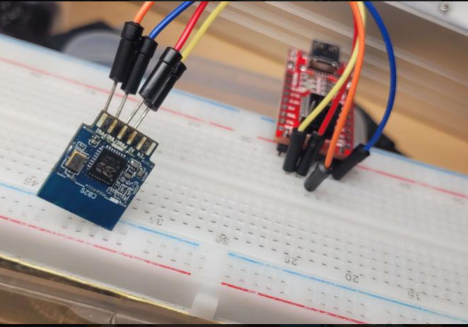

    andraskszabo
    Level 4  
    Posts: 10
    I have four similar plugs, bought as a bundle. Two had swapped pin markings, two had correct ones. Crazy.

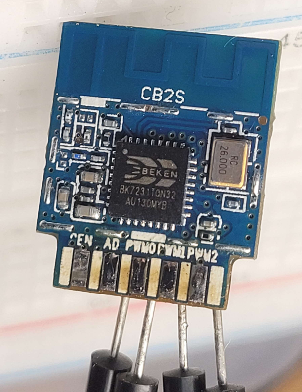

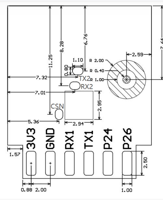

  • Misleading silkscreen swaps 3.3V and GND pads
    #6 21438589
    Posts: 14756
    Rate: 12883
    Usually the quality control catches that kind of faulty boards even before the elements are soldered, but it seems that people at Tuya product factories may just don't care or don't want to waste any boards...
    I can quote my old message:

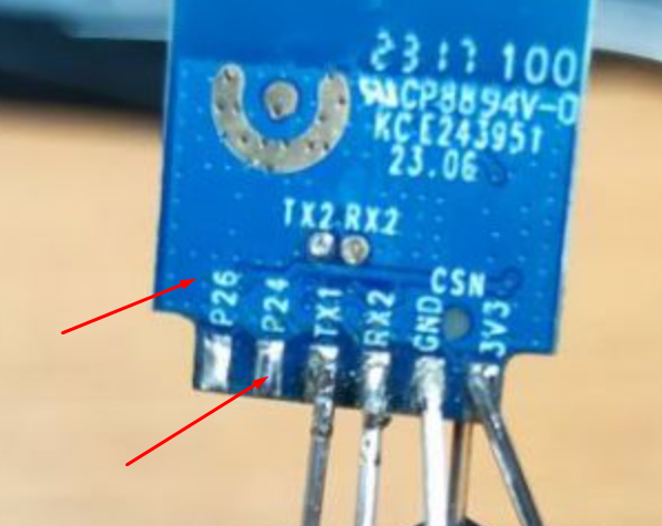

    You are connecting your wires incorrectly.
    I had this module.
    It has misleading silkscreen. The 3.3V and GND are not where you think they are.
    Please double check with your PCB.

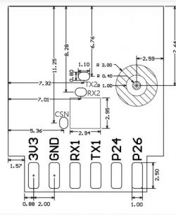

    I think the real 3.3V and GND pads are as shown here:
    Module schematic with incorrectly labeled 3.3 V and GND pins.
    Your module has mixed pad markings and they are misleading. Again, please double check, but I already had module looking exactly like yours and I flashed it the way like I would flash old CB2S...
    PS: To be honest, when you look at the pin marked as "P24", you can see it's really a ground pour plane:
    Close-up of a board with pin labels, with two arrows pointing to pins P26 and P24.
    So I think my idea checks out.
