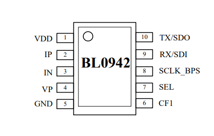

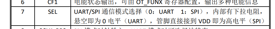

  • Dual BL0942 configuration still needed
    #13 20853030
    ajay100
    Posts: 14
    Yes, I do need help with the configuration please. This is a *dual* BL0942 AC power meter only. I am monitoring a 60W light bulb on both channels. Working in the web app, so far I have:
    Autoexec.bat

    They may be in SPI mode. Can you try using BL0942SPI?
    Are you able to check how they are connected and to which CBU pins are they connected?
    Schematic drawing of the BL0942 integrated circuit with pin descriptions.
    How is SEL connected? Is it in SPI or UART mode?
    Close-up of a table displaying configuration settings with Chinese characters and the words SEL and UART/SPI.

    The BL0942 ICs pin 10 TX are connected to pins 6 (RX2) and 16 (RX1) respectively of the CBU module.
    BL0942 ICs pin 9 RX are connected to pins 7 (TX2) and 15 (TX1) respectively.
    SEL is 0V (UART mode).
    This is very important information. So they simple use two UART ports. So far I have only seen single BL0942 devices that are using TX1/RX1.
