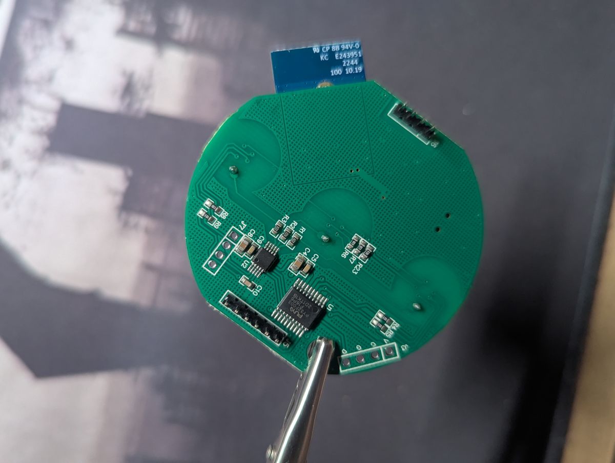

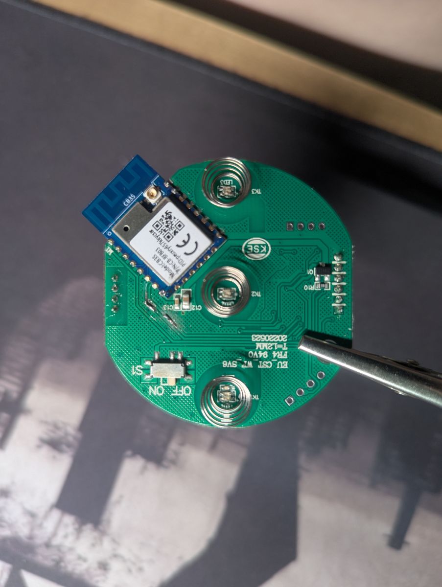

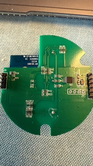

    I need help finalizing my device.
    I have a few CurryCurry Gen5.3 Curtain switches running in my home and for me, it was time to move on from Tuya.

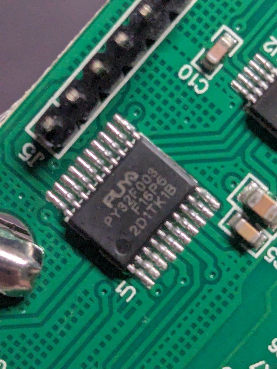

    After a bit of research, I noticed the device has a CB3S chip and a TuyaMCU (Puya PY32F003).
    PCB of CurryCurry device with visible components and CB3S wireless module
    CB3S module on circular PCB with touch buttons and labeled TX/RX points
    Close-up of Puya PY32F003 chip on a green PCB with visible component labels

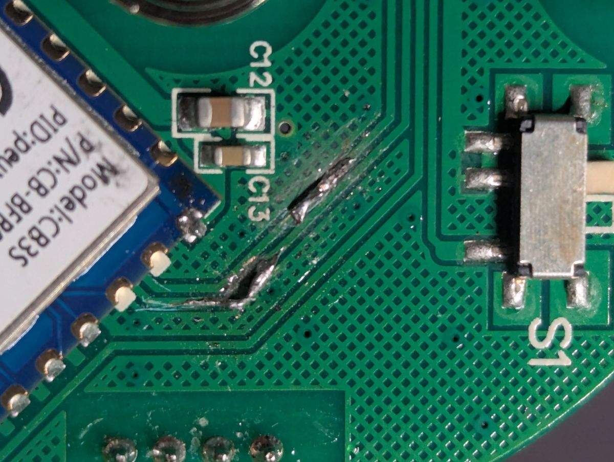

    Since we have a TuyaMCU, we need to cut the connections of TX and RX between it and the CB3S. I did that and managed to flash OpenBK.
    The only setting the BK7231 Easy UART Flasher was able to read was a baud rate of 9600.
    After finishing, I resoldered everything again, though I did kind of a sloppy job (I'm terrible at soldering)..
    Close-up of a PCB with poorly cut TX/RX traces near a CB3S module and switch labeled S1
    Still, I managed to boot the device and got onto the OpenBK UI.

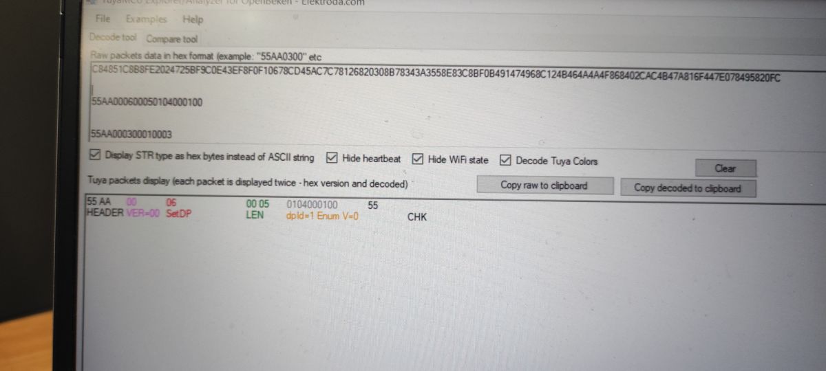

    What I can read from that is:
    Info:TuyaMCU:ParseState: id 1 type 4-enum len 1
    Info:TuyaMCU:ParseState: byte 2
    dpId 1 is a type 4 - enum and was set to 2. This is most likely the button press for "curtains down", which is on channel 1 and the value that was written is 2.
    Info:TuyaMCU:ParseState: byte 1
    dpId 1 was now set to enum val 1, which should be the "stop" button.
    Info:TuyaMCU:ParseState: byte 0
    dpId 1 was set to val 0 - I would say this means up.

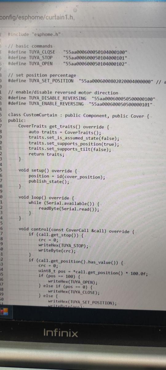

    There are a few other parameters like dpId2 which is most likely the percentage of the position (100 - open, 0 - closed) and another boolean type dpId 101 which I have no idea yet what this is for.
    Anyway, using this information and getting the example from the CurrySmarter Gen6 Curtain switch (https://www.elektroda.com/rtvforum/topic4046987.html#21033819) I tried writing my own autoexec.bat:

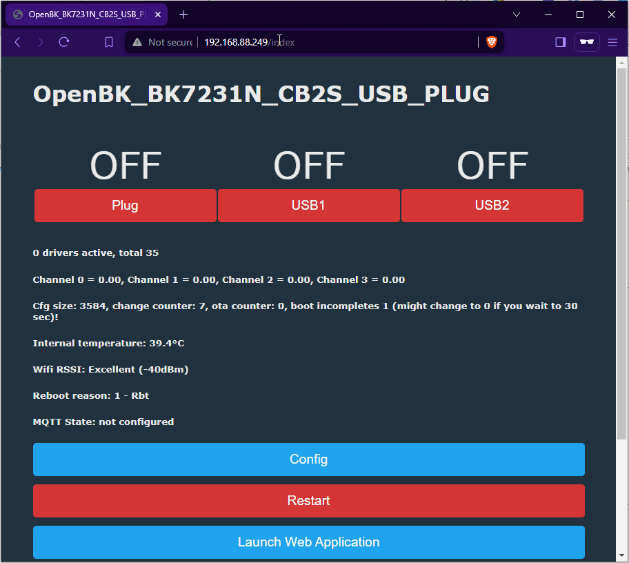

    OpenBK control panel with three OFF buttons and system information displayed

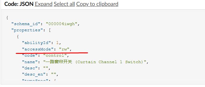

    This is actually a good idea that dpID1 is RO. I might have to do some per-hand debugging throughout more channels.
    • BK7231N_TuyaConfig_obk1FE8955E.bin (72 KB) You must be logged in to download this attachment.
  • TuyaMCU schema exposes curtain switch and calibration controls
    #5 21616846
    Posts: 5236
    Help: 450
    Rate: 920
  • Backlight switch is writable for testing

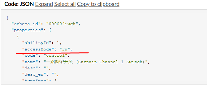

    #6 21616851
    Posts: 14795
    Rate: 12952
    Well it says RW...
    Screenshot of JSON structure showing accessMode set to rw
    Ok maybe, just for a test, you can check if you can control backlight?
          "abilityId": 7,
          "accessMode": "rw",
          "code": "switch_backlight",
          "name": "背光开关 (Backlight Switch)",
          "desc": "",
          "desc_en": "",
          "typeSpec": {
            "type": "bool"
  • Heartbeat invalid despite working TuyaMCU serial link
    #7 21618254
    HansWorst7
    Posts: 7
    I have tried doing this but also to no avail.
    I noticed something strange though. I set the logs to ExtraDebug and get the heartbeat_valid = 0 string
    ExtraDebug:TuyaMCU:TuyaMCU heartbeat_valid = 0, product_information_valid=0, self_processing_mode = 1, wifi_state_valid = 0, wifi_state_timer=0
    I can however receive data from tuyaMcu to CB3S, so the baud rate should be correct if I'm not wrong. Is it possible that it is the soldering after all?
    If I have more time on my hands, I could try to resolder everything properly.
  • #8 21618258
    Posts: 14795
    Rate: 12952
    Try running tuyaMcu_sendQueryState command in commandline to ask TuyaMCU for current state and check if you are getting replies
  • #9 21618262
    HansWorst7
    Posts: 7
    >>21618258
    Debug:API:POST to api/cmnd
    Debug:CMD:cmd [tuyaMcu_sendQueryState ]
    Info:CMD:[WebApp Cmd 'tuyaMcu_sendQueryState ' Result] OK
    This is all I get.
  • #10 21618265
    Posts: 14795
    Rate: 12952
    You should get lots of new dpID updates after executing that. dpIDs, types and their current values.
  • #11 21618269
    HansWorst7
    Posts: 7
    >>21618265
    Thank you for your help. I think CB3S TX -> TuyaMCU RX may have a cold solder joint. I will redo it properly and report back.
  • #12 21618273
    Posts: 14795
    Rate: 12952
    It seems likely now, please check this contact. Check continunity with a multimeter.

  • #16 21618618
    HansWorst7
    Posts: 7
    Yes, it was indeed the soldering. I did a quick fix for that and now the backlight controls work like a charm! I will write a short summary once I'm done with the full setup (most likely tomorrow).
    The only other thing that's left for me to figure out is why the "Curtains Up" LED keeps blinking.

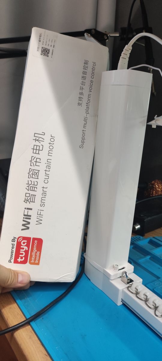

    Hello! I have a tuya electric curtain with the following motors:
    WiFi curtain motor with Tuya-branded box on a workstation table
    I used to use esphome firmware, and with it, these motors work in home assistant. But I want to flash it in openbeken. Inside is a WBR3 chip. I desoldered it and soldered a CB3S. Now I get the opening percentage and can close and pause with the buttons, but the opening doesn't work for me. I am aware of the tuya msu commands
    TUYA curtain control code in curtain1.h file on a laptop screen
    deciphered
    Screenshot of a Tuya packet decoder program with visible HEX data and analysis.

  • #20 21658799
    mvz0209
    Posts: 20
    Success, sending to UART, added checksum
    addEventHandler OnChannelChange 4 uartSendHex 55AA00060005010400010010 # up
    addEventHandler OnChannelChange 5 uartSendHex 55AA00060005010400010111 # stop
    addEventHandler OnChannelChange 6 uartSendHex 55AA00060005010400010212 # down
