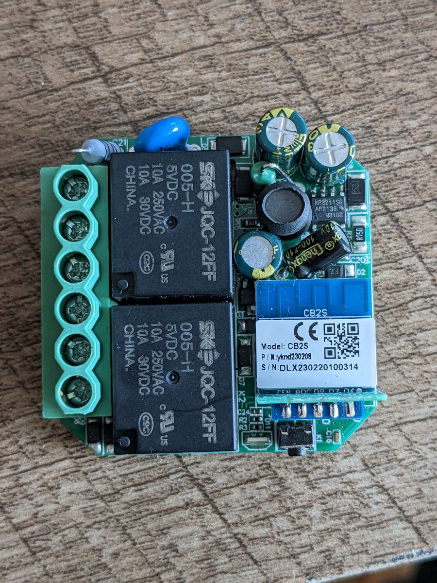

    obersdoog
    https://www.tomtop.com/p-s6563-6.html

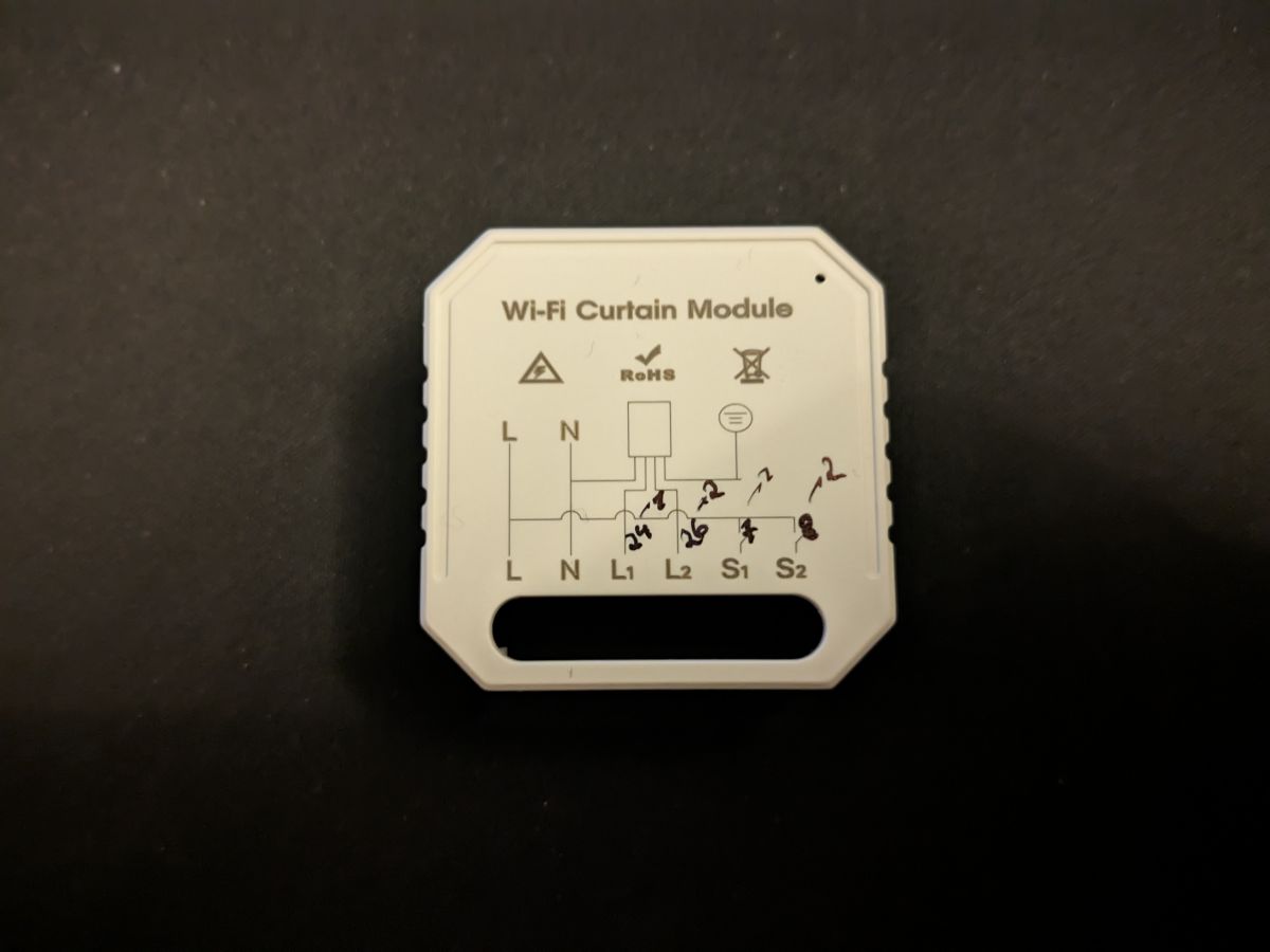

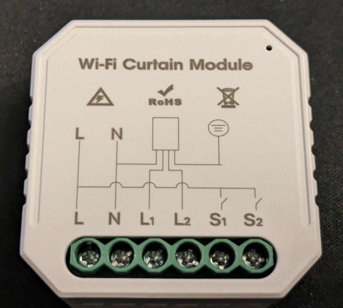

    TUYA WiFi Curtain Switch - or - a 2 Gang Switch
    Photos:
    Exploring BK7231N/CB2S TUYA WiFi Intelligent Curtain Switch: Teardown, Flashing, and Configuration Exploring BK7231N/CB2S TUYA WiFi Intelligent Curtain Switch: Teardown, Flashing, and Configuration Exploring BK7231N/CB2S TUYA WiFi Intelligent Curtain Switch: Teardown, Flashing, and Configuration

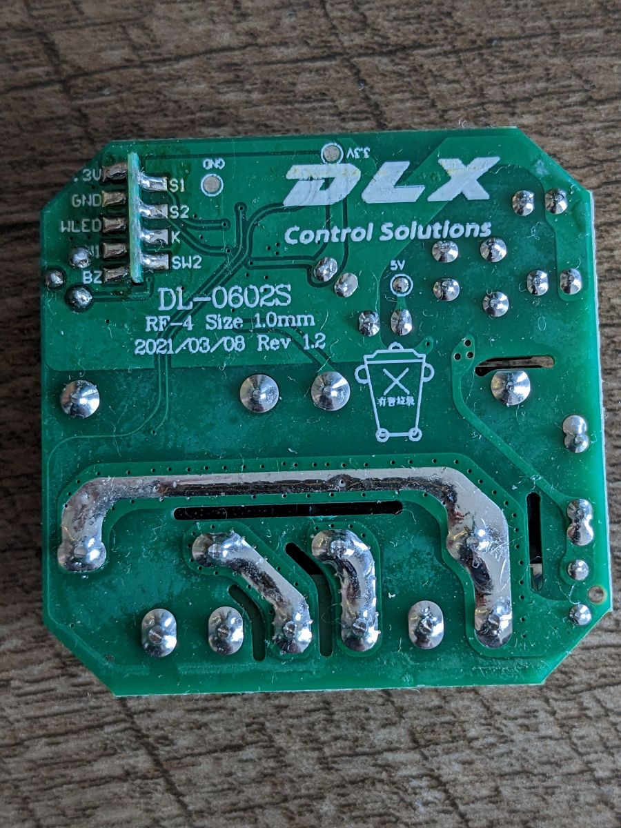

    Teardown:

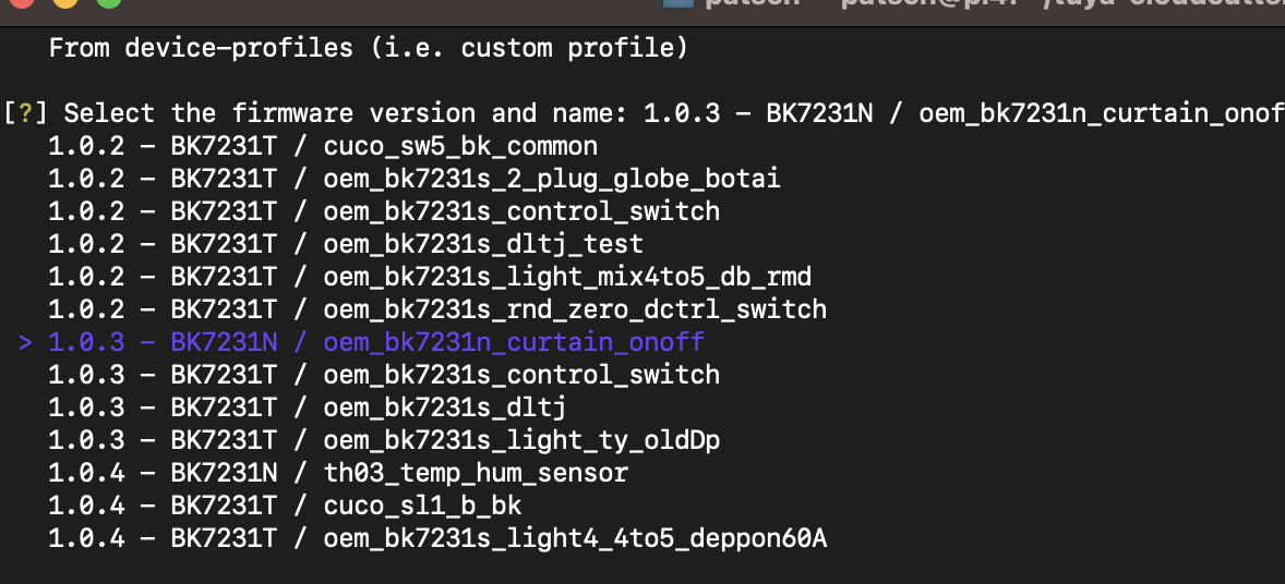

    Flashed with: https://github.com/openshwprojects/OpenBK7231T_App
    V1.0.3
    Config:

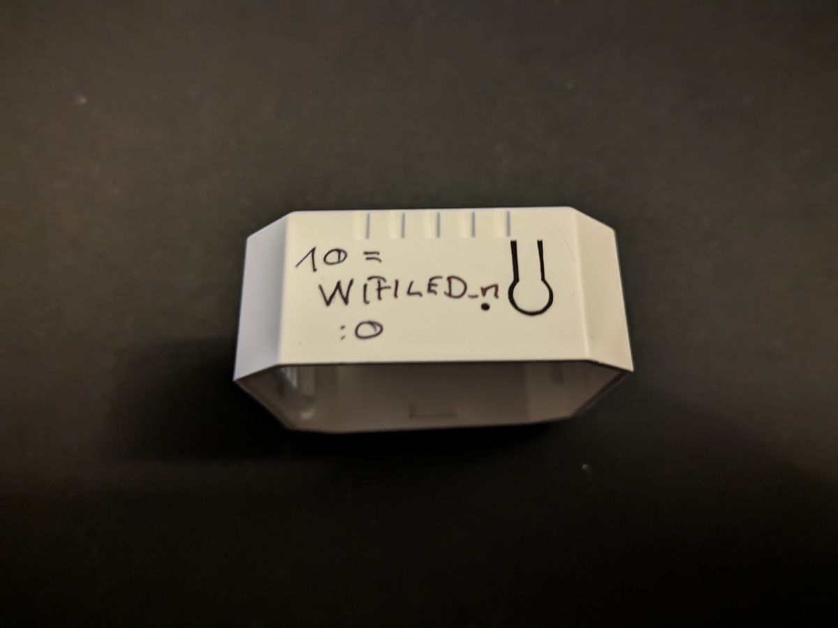

    PinRoleChannelNote
    7TglChanOnTgl / Btn1S1
    8TglChanOnTgl / Btn2S2
    10WifiLED_n0-
    24Rel1L1
    26Rel2L2

    Thanks. It is also worth to add the name from the PCB - DL-0602S
