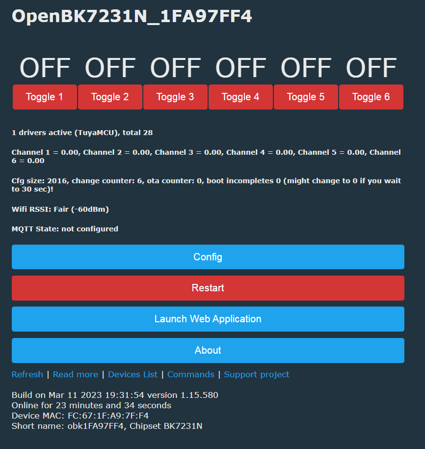

    Hi,
    I am new to OpenBeken firmware but I have some experience with an ESP8266.
    I have a 6-gang switch with TuyaMCU and CB3S.
    TuyaMCU & CB3S 6-Gang Switch: Changing Serial Baud Rate to 115200bps with OpenBeken Firmware TuyaMCU & CB3S 6-Gang Switch: Changing Serial Baud Rate to 115200bps with OpenBeken Firmware
    I desoldered and flashed CB3S with OpenBK7231N_QIO_1.15.580.bin and soldered it back on the board.
    It connects to my router without any problem and I uploaded autoexec.bat.
    startDriver TuyaMCU
    setChannelType 1 toggle
    linkTuyaMCUOutputToChannel 1 1 1
    setChannelType 2 toggle
    linkTuyaMCUOutputToChannel 2 1 2
    setChannelType 3 toggle
    linkTuyaMCUOutputToChannel 3 1 3
    setChannelType 4 toggle
    linkTuyaMCUOutputToChannel 4 1 4
    setChannelType 5 toggle
    linkTuyaMCUOutputToChannel 5 1 5
    setChannelType 6 toggle
    linkTuyaMCUOutputToChannel 6 1 6
    Now the web interface shows six ON/OFF buttons like this.
    It looks like everything is working as intended in setting up OpenBeken.
    However, the relays neither turn on nor turn off by pressing web interface buttons.
    I looked at the log and it looks like the CB3S is not able to communicate with the TuyaMCU.
    ExtraDebug:TuyaMCU:TuyaMCU heartbeat_valid = 0, product_information_valid=0, self_processing_mode = 1, wifi_state_valid = 0, wifi_state_timer=0
    Nothing is received when I press the touch button on the wall switch.
    I think this problem is due to serial baud rate.
    I have a few of the same wall switches and replaced one of them with ESP-12F flashed with Tasmota.
    I had to set TuyaMCU serial baud rate to 115200bps in Tasmota using the command "SetOption97=1" in order to establish communication with TuyaMCU.
    Is there any way to set the TuyaMCU serial baud rate to 115200bps in OpenBeken?
    I could not find any option or command for changing the baud rate.
    Any help would be appreciated.

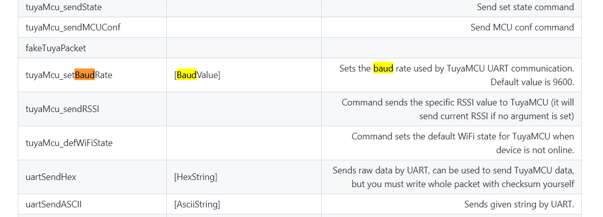

    Hello, if you open the autogenerated md-docs:
    https://github.com/openshwprojects/OpenBK7231T_App/tree/main/docs
    and then commands list:
    then while searching for 'baud', you will find:

    Thank you for your answer.
    The wall switch is now in communication with TuyaMCU.
    I have another question regarding this Tuya device.
    After I set the baudrate to 115200, the CB3S started to receive data from TuyaMCU.
    I was able to turn on and turn off relay from Web UI.
    However, when I press the touch button on the wall switch, the states of relays were not reflected to Web UI. That is, when I turn on the relay by pressing the touch switch, nothing changed on Web UI (the same for turning off).
    Then I tried the command "tuyaMcu_defWiFiState 4" and it worked!
    The states of the relays were reflected on the Web UI and everything is working.

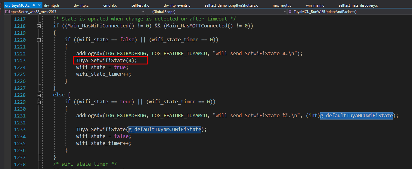

    Wow, you have solved it very quickly. Good job.
    Regarding this:
    This is very interesting. I didn't experience it with my devices.
    I think the same could be achieved by connecting both MQTT and WiFi, because by default our software sends it when it has also MQTT connection:

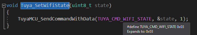

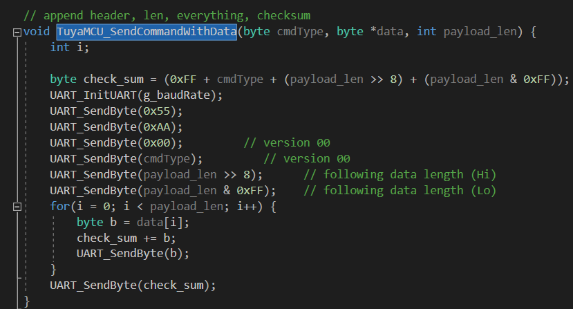

    The following sends 0x03 command with payload 0x04:
    And if you break it down:

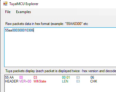

    On the other hand, the packet you have posted contains that:
    So your proposed hex packet is very similar, but not the same. It has payload 0x03 instead od 0x04.

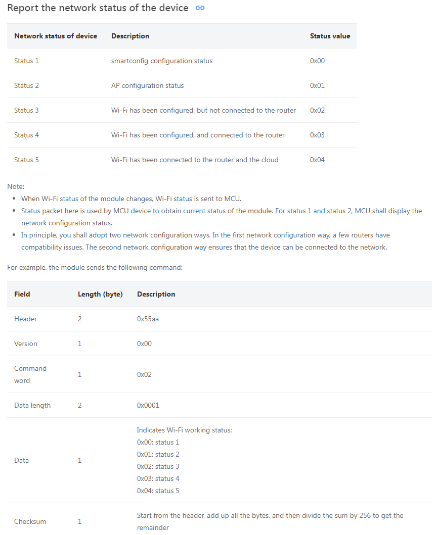

    Here is the difference between 0x04 and 0x03 network states in TuyaMCU:
    Connection StatusDescription Status ValueLED Indicator Status
    Smart network configuration0x00The indicator blinks at 250 ms intervals.
    AP network configuration0x01The indicator blinks at 1500 ms intervals.
    The Wi-Fi is configured. However, the device fails to connect to the router.0x02The indicator is off.
    The Wi-Fi is configured, and the device successfully connects to router.0x03The indicator is steady on.
    The device connects to the router0x04The indicator is steady on.
    The Wi-Fi device is in low power consumption mode.0x05The indicator is off.
    So, in the end, it's virtually the same. It's just interesting that Tuya decided to lock their device before it's paired.

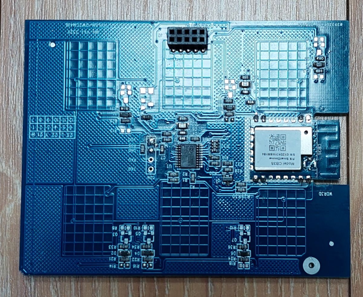

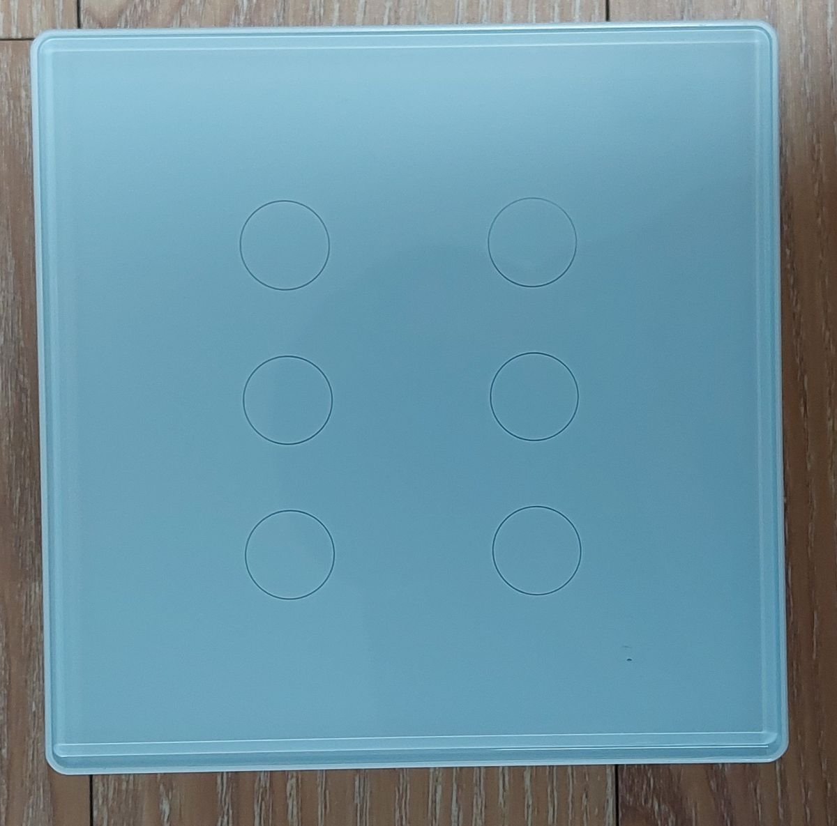

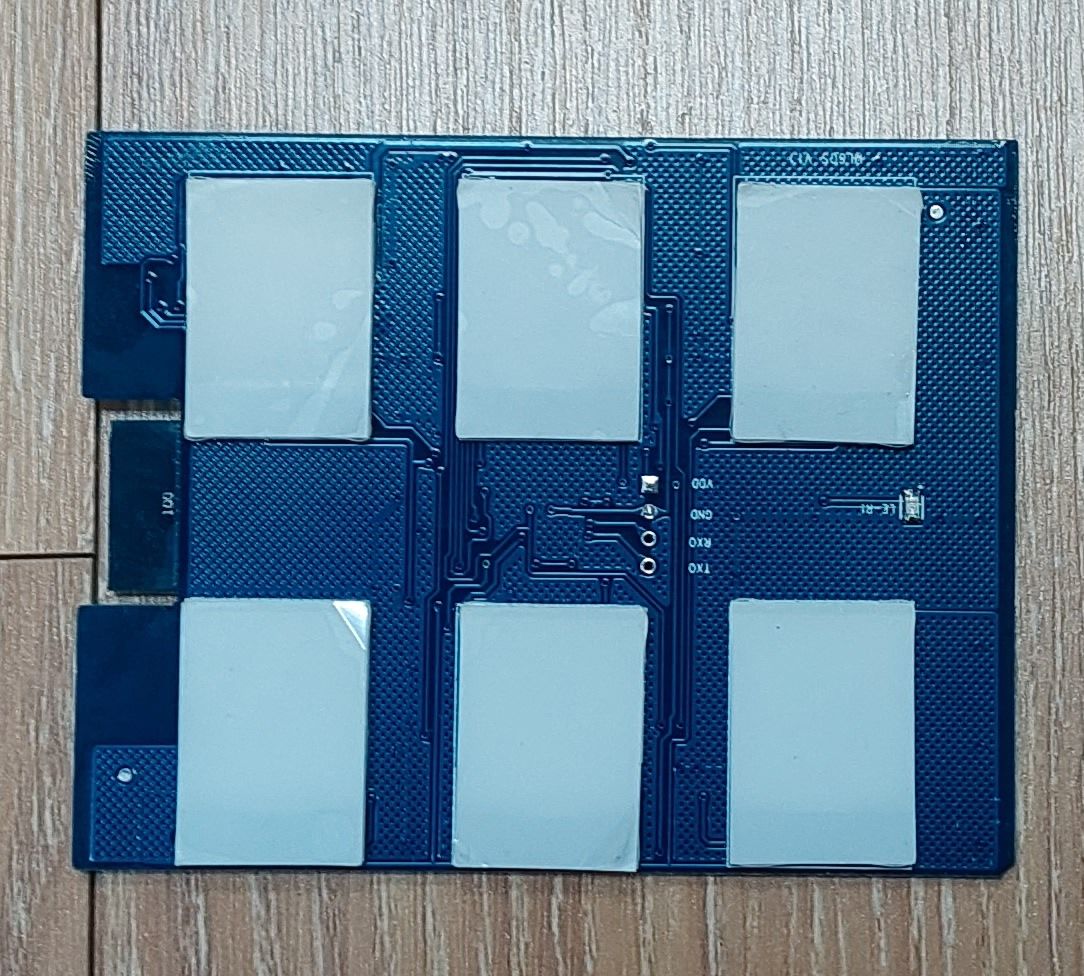

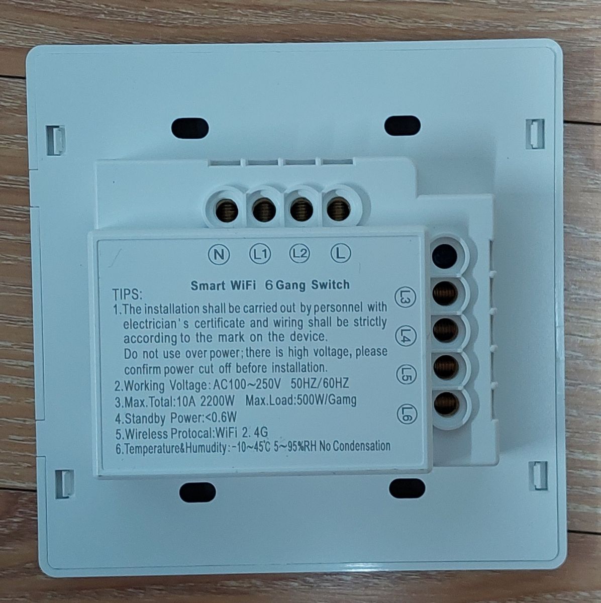

    Here are the photos of the 6-gang wall switch.
    TuyaMCU & CB3S 6-Gang Switch: Changing Serial Baud Rate to 115200bps with OpenBeken Firmware TuyaMCU & CB3S 6-Gang Switch: Changing Serial Baud Rate to 115200bps with OpenBeken Firmware TuyaMCU & CB3S 6-Gang Switch: Changing Serial Baud Rate to 115200bps with OpenBeken Firmware TuyaMCU & CB3S 6-Gang Switch: Changing Serial Baud Rate to 115200bps with OpenBeken Firmware
    I bought them from:
    https://www.aliexpress.com/item/1005004136972...order_list.order_list_main.295.59351802kaqxEY
    I bought 4 of them and I replaced one of the switches' CB3S with ESP-12F flashed with Tasmota.
    However, I was stuck at not receiving any response including the states of the relays (therefore no change in the Web UI the same as OpenBeken).
    That is why I turn to OpenBeken to see how it goes.

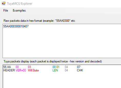

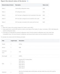

    It looks like the commands "tuyaMcu_setBaudRate 115200" and "tuyaMcu_defWiFiState 4" must be issued at boot to be able to receive any response from TuyaMCU.
    After posting this ("tuyaMcu_defWiFiState 4"), I looked into Tuya serial protocol and found out that hex code 55AA000300010407 makes TuyaMCU begin reporting the states of the relays.
    According to Tuya serial protocol, hex code 55AA000300010407 represents "Wi-fi is connected". (may be the same as tuyaMcu_defWiFiState 4?)
    I tried this hex code with Tasmota by issuing the command "serialsend5 55AA000300010407" and the wall switch started working immediately just like the one with OpenBeken.

    PS: 55AA000300010407 is the same as WiFi state packet with 0x04 argument:

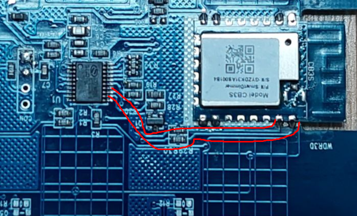

  • #7 21130029
    yasirshahzad918
    Can anyone tell me which touch IC is used here? I am looking for a touch IC for my custom touch PCB. @patentjyp, I think you can solve my problem. The picture you posted has clear markings, whereas the markings on other touch PCBs are removed.
  • #8 21130077
    patentjyp
    Posts: 20
    >>21130029
    This is a Tuya MCU device with only ONE PCB. Two photos are front and back sides of the PCB.
    There is only one chip (except CB3S) at the center of the PCB as shown in the photo.
    This chip is Tuya MCU and it looks like this chip handles touch without separate touch chip.
    I hope this helps.

    >>21130077 Hi @patentjyp, the center IC of PCB is not a Tuya MCU; it actually features a touch IC. Could you please provide the exact markings on that central IC? If I can obtain the markings of that IC, it would greatly assist in resolving my main issue
  • #11 21130997
    Posts: 14756
    Rate: 12881
    Actually it's TuyaMCU (MCU, programmable, with UART bus). It's connected to WiFi module via UART:
    Close-up of a circuit board with a WiFi module and TuyaMCU microcontroller connected via UART bus.
