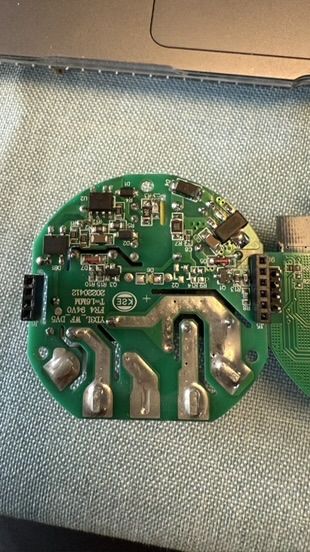

    I have a request for the roller shutter controllers I want to use openbeken because on the org tuya in HA I could not do stop-pause
    I have uploaded the software to the device (CB3S) but have no idea how to set the configuration.
    I have already come to the conclusion that the device does not have tuyaMCU

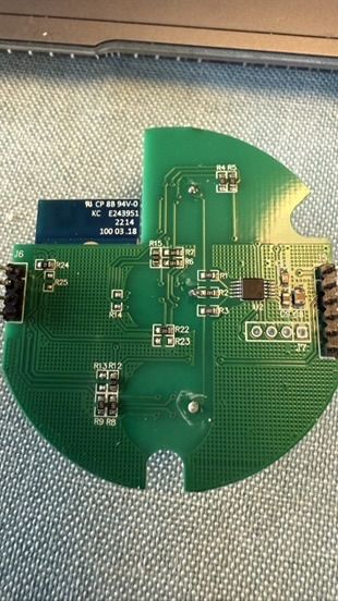

    Roller shutter controller PCB with visible pins and component labels
    PCB controller board for roller shutters with visible CB3S module and SMD components .
    I have a backup and in openbeken I made a gpio download
    Please help

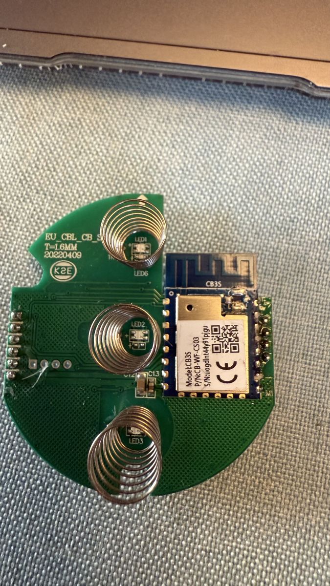

    I would, however, bet that it is TuyaMCU. Show these CB3S from the top. Are there no tracks next to RX1/TX1?

    PCB with Wi-Fi module CB3S and three spiral battery holders .

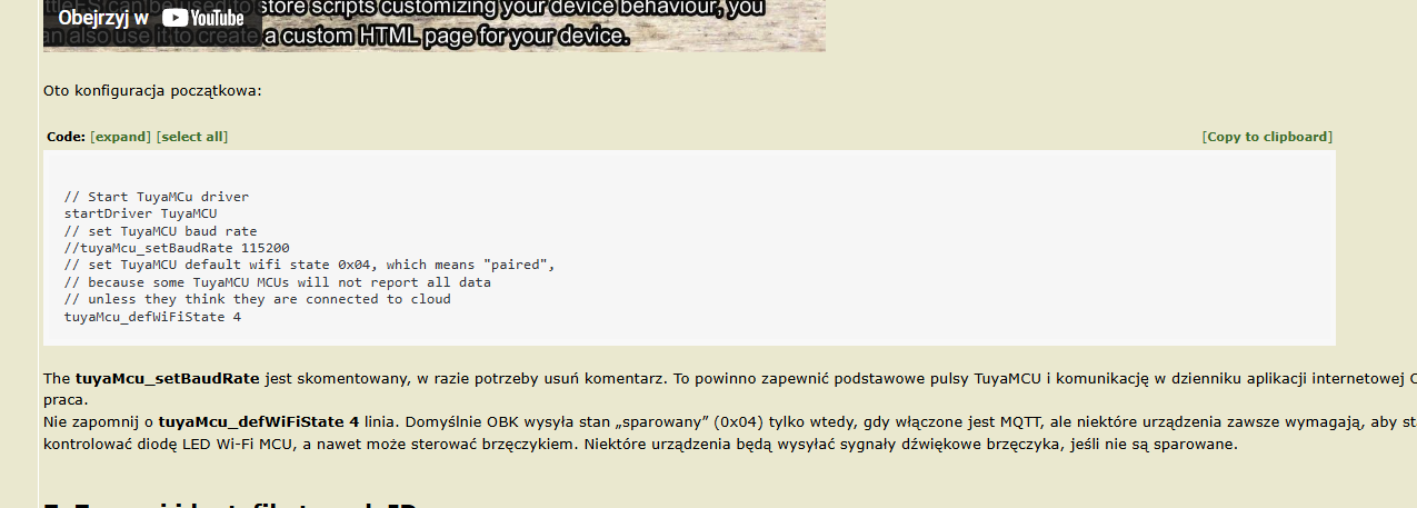

    It will help you a lot to check the topic of what I have linked, such as this passage:
    TuyaMCU configuration code with comments for OBK initialization .
    In the web app console turn on the logging level of everything and there will be more info, including from TuyaMCU every now and then info whether "heartbeat valid" - 1 or 0.
    So you upload autoexec starting TuyaMCU, reboot the device, look to see if heartbeat valid, if not you try a second baud.

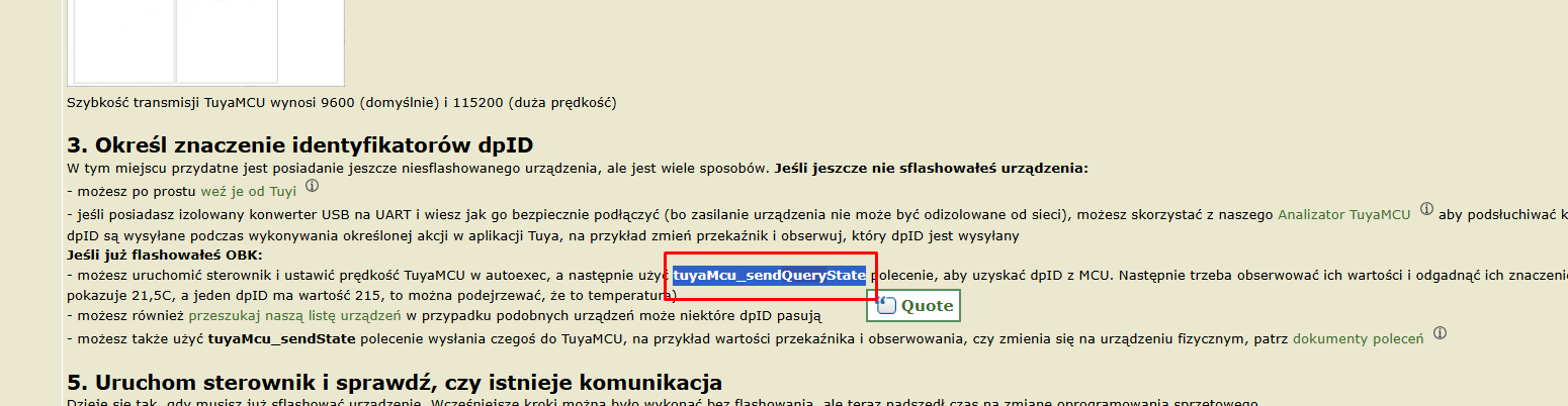

    You can instead of heartbeat valid then after start try the command:
    Screenshot of a forum page with TuyaMCU dpID setup info and tuyaMcu_sendQueryState command. .
    Well, but as I said:
    ------> TuyaMCU flashing, installation and configuration guide - configure dpID for Home Assistant .

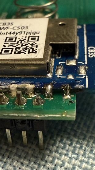

    And with RX1/TX1 you didn't accidentally damage the pads? Do you have a multimeter? Can you check with a multimeter if RX1/TX1 goes to this little MCU?
  • #11 21618879
    PSlowik
    Posts: 80
    >>21618873 i definitely did not damage the soldered under the microscope and i soldered under the cb3s.

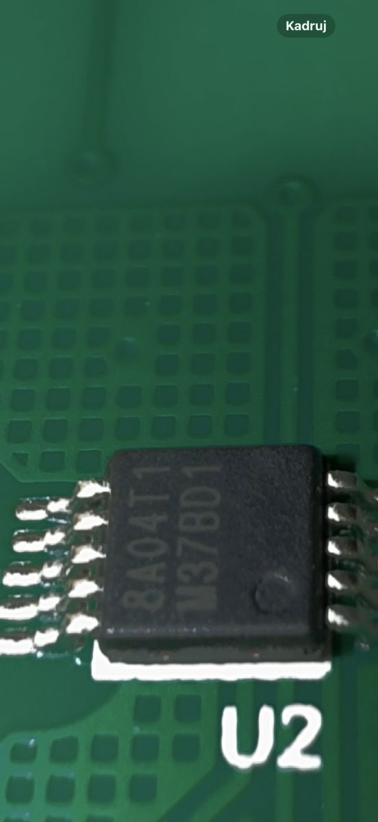

    this small circuit with legs is
    Small IC labeled 8A04T1N37BD1 on a green PCB marked with U2
    Close-up of CB3S electronic module with visible solder joints .

    Posts: 5212
    Help: 446
    Rate: 914
    • Feature_C_OB38A04T1-Datasheet(SC)-20180628.pdf (282.49 KB) You must be logged in to download this attachment.
  • #13 21618897
    PSlowik
    Posts: 80
  • #14 21618899
    Posts: 14755
    Rate: 12881
    There is information there that it is not TuyaMCU after all.
    In that case, try GPIODoctor to search for pin roles.
    GPIODoctor in OpenBeken - a convenient way to find out GPIO roles in an IoT device .

    #19 21618916
    PSlowik
    Posts: 80
    Is that P6 and P9 are relays or buttons? Because you wrote in such a way that I don't understand.
    GPIO Doctor only looks for basic pins such as relays for switching, LEDs or there buttons (inputs). You can ignore the channel, it is not important, what matters is which pin is what.
    You will not find the delay time there, because it results from the algorithm, which unfortunately will have to be prepared somehow on the OBK...
    I will write figuratively - GPIODoctor is simply an overlay on pins, imagine that in pins you set the relay mode on each pin in turn and check if it works. This is what you do in GPIoDoctor.
    P6 relay - opening
    P9 relay - closing
    unfortunately i can't find anything else :/ it works so unstable that shock... I set Btn, press High and then it stutters and reboots :/ or it changes itself to Rel :/
    A little progress I found the LEDs
    P14 LED red on opening touch key
    P23 LED red on the closing touch button
    P26 LED green always flashed before connecting to wifi or during pairing - I set it to WiFiLED_n and it works like this.
    P7 Btn closing
    P8 LED red from touch button STOP
    P24 Btn opening

    I currently have this configuration
    "pins": {
    "6": "Rel;1",
    "7": "Btn;2",
    "8": "LED;0",
    "9": "Rel;2",
    "14": "LED;1",
    "23": "LED;2",
    "24": "Btn;1",
    "26": "WifiLED_n;0"
    And the opening and closing touch works, then the red LED is switched on.
    The LED indicating the connection to the WiFi is working.
    Not working:
    Touch button from Pause stop I couldn't find it or it worked differently?
    The On/Off key light is not working, it is on all the time :/
    The problem now is:
    When I press open or close the relay switches on and works without time limit....
    it is possible to open and close at the same time and the org used to be that when opening and closing is working, the opening relay switches off and the LED goes out.
    The pause function is a repeat key press.

    Posts: 14755
    Rate: 12881
    Remember that at this stage we are just looking for GPIO roles - where is the relay, where is the diode, etc. There is no device logic at this point. Rather, you will need to do this logic yourself in OBK. I wouldn't expect it to work like a roller shutter controller right off the bat right now.

    P11 LED switch on switches on the key light
    Unfortunately, the stop key has not been understood and I have checked everything.
    I found this json on github
    "manufacturer": "MOES",
    "name": "WS-Y-EUTC-WH-MS Curtain Switch v1.1.0",
    "key": "key59dudtpsurhn5",
    "ap_ssid": "smartLife",
    "github_issues": [
    654
    "image_urls": [
    "moes-ws-y-eutc-wh-ms-curtain-switch-v1.1.0.jpg".

    #28 21620297
    Posts: 14755
    Rate: 12881
    So this leaves you with the software.... now you are basically left to search the forum, as users have already published scripts for the roller shutter controller autoexec.bat.
    Here there is a small problem, because I have no way to help with this directly, because I simply don't have such roller shutters - I don't have any electric roller shutters at home, so necessarily I have no way to test this.
    Alternatively, you could still try to do it differently - you would describe to me from the technical side how it would work, and I would make a controller for it for OBK in C language, testing it only in the simulator.... only so slightly worse without a real device to work with.
  • Simple relay and LED interlock logic for shutter control
    #29 21620335
    PSlowik
    Posts: 80
    >>21620297 .
    ok great would
    the operation is quite simple:
    after switching on the mains it checks what time it is and if it is between 5 and 7 o'clock it switches on the key light
    on pressing open it switches on the relay and the LED on this key
    the same happens when closing
    if the Open relay is on and the Close key is pressed, the Open relay and LED are automatically switched off and the Close relay and LED are switched on.
    operation of the relays for a set period of time
    during operation the relay switches off after pressing stop
    I think that's roughly it?
