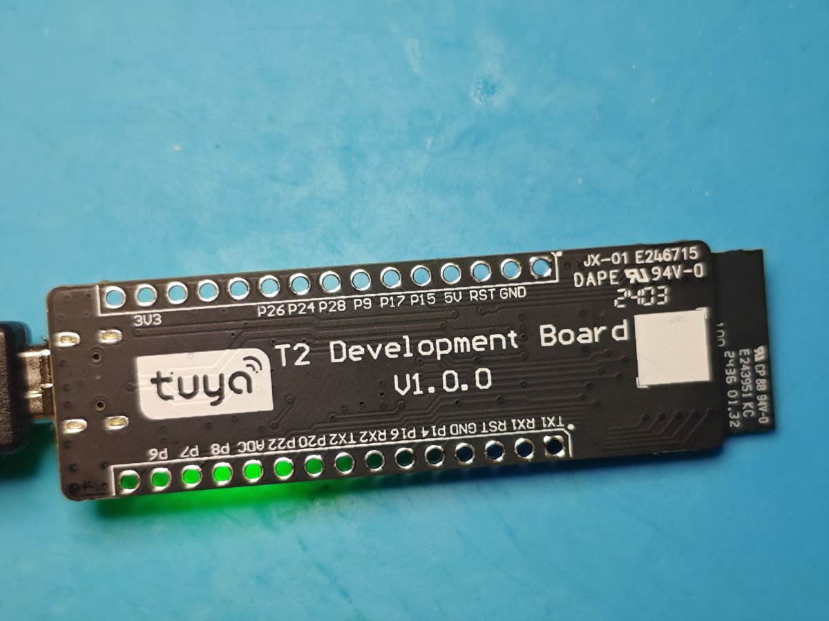

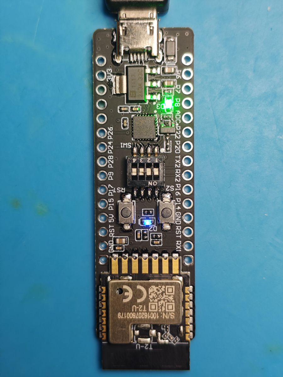

    I got T2-U module on hand
    Close-up of T2-U electronic module with T2 GU3433F0 microchip in center
    Will try more with it soon

    T2 is BK7231N I think?

    insmod wrote:
    T1 - BK7238
    T2 - BK7231N
    T3 - BK7236
    T5 - BK7258

    Screenshot from PuTTY terminal showing TUYA module initialization logs
    N module confirmed
    V:BK7231N_1.0.1
    REG:cpsr spsr r13 r14
    SVC:000000D3 00401C1C 000033AC
    IRQ:000000d2 00000010 00401e0c bf7e798f
    FIR:000000d1 00000010 00401ffc ffff7ff7
    SYS:000000df 0040192c 00000158
    ST:00000000
    J 0x10000
    bk_misc_init_start_type 0 0
    prvHeapInit-start addr:0x411fa0, size:122976
    [Flash]id:0xeb6015

    Check GPIO, and make detailed photos of this board. Check if P16 (SPI output) is routed out - can it driver WS2812 easily? Once testing complete, I will make a detailed board article and devices list entry.
