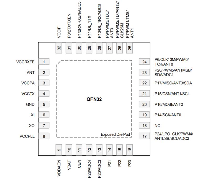

    Let's start with considering T1 pinouts. The most important pins for flashing are UART1 (TX1 and RX1), which are used for programming, and TX2, which is a debug log output at 115200.
    T1 QFN32 Pinout and Descriptions:
    Pin mapping diagram of the BK7238 chip in QFN32 package with labeled functions.
    Pin # Name I/O Type Description
    1VCCRXFE-Analog inputRF receiver power supply
    2ANT-RF2.4 GHz RF signal port
    3VCCPA-Analog inputRF PA power supply
    4VCCTX-Analog inputRF Transmitter power supply
    5GND-GNDGround
    6XI-Analog input26 MHz crystal input
    7XO-Analog output26 MHz crystal output
    8VCCPLL-Analog inputRF PLL power supply
    9VDDAON-Analog outputAlways-on/digital LDO output
    10VBAT-Analog inputChip power supply
    11CEN-Analog inputChip enable, active high
    12P28/ADC4I/ODigital/AnalogGPIO28 / ADC4
    13P20/ADC3I/ODigital/AnalogGPIO20 / ADC3
    14P21I/ODigitalGPIO21
    15P22I/ODigitalGPIO22
    16P23I/ODigitalGPIO23
    17P24/LPO_CLK/PWM4/ANTLSB/SCL/ADC2I/ODigital/AnalogGPIO24 / 32 kHz clock output / PWM4 (diff w/ PWM5) / BT LE antenna select (LSB) / I2C: SCL / ADC2
    18NC-NCNo connect
    19P14/SCK/ANT0I/ODigitalGPIO14 / SPI: SCK / BT LE antenna select 0
    20P16/MOSI/ANT2I/ODigitalGPIO16 / SPI: MOSI / BT LE antenna select 2
    21P15/CSN/ANT1/SCLI/ODigitalGPIO15 / SPI: CSN / BT LE antenna select 1 / I2C: SCL
    22P17/MISO/ANT3/SDAI/ODigitalGPIO17 / SPI: MISO / BT LE antenna select 3 / I2C: SDA
    23P26/PWM5/ANTMSB/SDA/ADC1I/ODigital/AnalogGPIO26 / PWM5 (diff w/ PWM4) / BT LE antenna select (MSB) / I2C: SDA / ADC1
    24P6/CLK13M/PWM0/TCK/ANT0I/ODigitalGPIO6 / 26 MHz clk (รท1/2/4/8) / PWM0 (diff w/ PWM1) / JTAG: TCK / BT LE antenna select 0
    25P7/PWM1/TMS/ANT1I/ODigitalGPIO7 / PWM1 (diff w/ PWM0) / JTAG: TMS / BT LE antenna select 1
    26P8/PWM2/TDI/ANT2/CLK26MI/ODigitalGPIO8 / PWM2 (diff w/ PWM3) / JTAG: TDI / BT LE antenna select 2 / 26 MHz clk output
    27P9/PWM3/TDO/ANT3I/ODigitalGPIO9 / PWM3 (diff w/ PWM2) / JTAG: TDO / BT LE antenna select 3
    28P10/DL_1RX/ADC6I/ODigital/AnalogGPIO10 / UART1: RX (Flash DL) / ADC6
    29P11/DL_1TXI/ODigitalGPIO11 / UART1: TX (Flash DL)
    30P1/2RX/RXEN/ADC5I/ODigital/AnalogGPIO1 / UART2: RX / RX enable / ADC5
    31P0/2TX/TXENI/ODigitalGPIO0 / UART2: TX / TX enable
    32VCCIF-Analog inputIF power supply
    Die padGND_SLUG-GNDGround

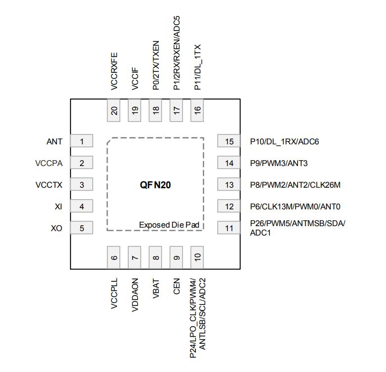

    T1 QFN20 Pinout and Descriptions:
    Pinout diagram of T1 (BK7238) chip in QFN20 package
    Pin #NameI/OTypeDescription
    1ANT-RF2.4 GHz RF signal port
    2VCCPA-Analog inputRF PA power supply
    3VCCTX-Analog inputRF Transmitter power supply
    4XI-Analog input26 MHz crystal input
    5XO-Analog output26 MHz crystal output
    6VCCPLL-Analog inputRF PLL power supply
    7VDDAON-Analog outputAlways-on/digital LDO output
    8VBAT-Analog inputChip power supply
    9CEN-Analog inputChip enable, active high
    10P24/LPO_CLK/PWM4/ANTLSB/SCL/ADC2I/ODigital/AnalogGPIO24, 32 kHz clock output, PWM4 (differential with PWM5), Bluetooth LE antenna select (LSB), I2C: SCL, ADC2
    11P26/PWM5/ANTMSB/SDA/ADC1I/ODigital/AnalogGPIO26, PWM5 (differential with PWM4), Bluetooth LE antenna select (MSB), I2C: SDA, ADC1
    12P6/CLK13M/PWM0/ANT0I/ODigitalGPIO6, 26 MHz clock output (divided by 1/2/4/8), PWM0, Bluetooth LE antenna select 0
    13P8/PWM2/ANT2/CLK26MI/ODigitalGPIO8, PWM2 (differential with PWM3), Bluetooth LE antenna select 2, 26 MHz clock output
    14P9/PWM3/ANT3I/ODigitalGPIO9, PWM3 (differential with PWM2), Bluetooth LE antenna select 3
    15P10/DL_1RX/ADC6I/ODigital/AnalogGPIO10, UART1: RX (Flash download support), ADC6
    16P11/DL_1TXI/ODigitalGPIO11, UART1: TX (Flash download support)
    17P1/2RX/RXEN/ADC5I/ODigital/AnalogGPIO1, UART2: RX, RX enable, ADC5
    18P0/2TX/TXENI/ODigitalGPIO0, UART2: TX, TX enable
    19VCCIF-Analog inputIF power supply
    20VCCRXFE-Analog inputRF receiver power supply

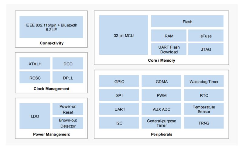

    T1 internal diagram:
    Block diagram of T1 (BK7238) chip divided into functional sections

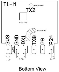

    T1-M Module Pinout
    T1-M is a T1 (BK7238) equivalent of WB2S/CB2S/TYWE2S. It exposes PWM, ADC, and UART 1. UART 2 is on the module back.
    Top view of T1-M module with dimensions and labeled pins CEN, ADC, P8, P6, and P26 Bottom view of T1-M module with labeled pins and spacing measurements
    Pin No.SymbolI/O typeDescription
    13V3P3.3V power pin.
    2P26I/OSupport hardware PWM, corresponding to Pin 11 on the IC.
    3GNDPGround pin.
    4P6I/OSupport hardware PWM, corresponding to Pin 12 on the IC.
    5RX1I/OUART_RX1 to receive user data, P10 corresponding to Pin 15 on the IC.
    6P8I/OSupport hardware PWM, corresponding to Pin 13 on the IC.
    7TX1I/OUART_TX1 to send user data, P11 corresponding to Pin 16 on the IC.
    8ADCI/OADC pin, GPIO 1, corresponding to Pin 17 on the IC.
    9P9I/OSupport hardware PWM, corresponding to Pin 14 on the IC.
    10CENI/OThe reset pin, active low, and pulled up internally. Corresponding to Pin 9 on the IC.
    11P24I/OSupport hardware PWM, corresponding to Pin 10 on the IC.

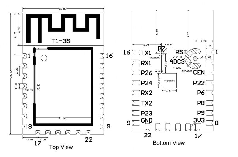

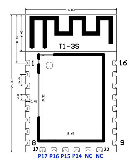

    T1-3S Module Pinout
    T1-3S is a T1 (BK7238) equivalent of CB3S/WB3S/TYWE3S.
    Top and bottom view of Tuya T1-3S module with labeled pins and precise dimensions.
    Pin No.SymbolI/O typeFeature
    1RSTIThe low-level reset pin, active high, and pulled up internally, corresponding to CEN on the IC.
    2ADC3I/OADC pin, corresponding to P20 on the IC.
    3CENIEnable pin, pulled up internally. When externally pulled low, it can be used as a reset pin.
    4P22I/OGPIO_22, corresponding to P22 on the IC.
    5P6I/OGPIO_6, corresponding to P6 on the IC. Support hardware PWM0.
    6P8I/OGPIO_8, corresponding to P8 on the IC. Support hardware PWM2.
    7P9I/OGPIO_9, corresponding to P9 on the IC. Support hardware PWM3.
    83V3PPower supply pin (DC 3.3V).
    9GNDPGround pin.
    10P23I/OGPIO_23, corresponding to P23 on the IC.
    11TX2I/OUART2_TXD (used for log printing), corresponding to P0 on the IC.
    12RX2I/OUART2_RXD (used for log printing), corresponding to P1 on the IC.
    13P24I/OGPIO_24, corresponding to P24 on the IC. Support hardware PWM4.
    14P26I/OGPIO_26, corresponding to P26 on the IC. Support hardware PWM5.
    15RX1I/OUART1_RXD to receive the user data, corresponding to P10 on the IC.
    16TX1I/OUART1_TXD to transmit the user data, corresponding to P11 on the IC.

  • #10 21877186
    Posts: 14755
    Rate: 12878
    So how do you know it's P16, etc? P16 pin is very useful, it has MOSI role for SPI master port, so it can control WS2812.
    https://www.elektroda.com/rtvforum/topic4057187.html
  • #11 21877188
    Posts: 5209
    Help: 446
    Rate: 914
    I used GPIO dr on each pad with T1-3S removed from ir device. each pad was low mv until pulled high, then 3.3v high. multimeter on each. NC pads were 0v, not even low mv.
    also, resistance. 0.425-0.429mohms for all apart from the NCs which were '0.L' reading
  • #12 21877207
