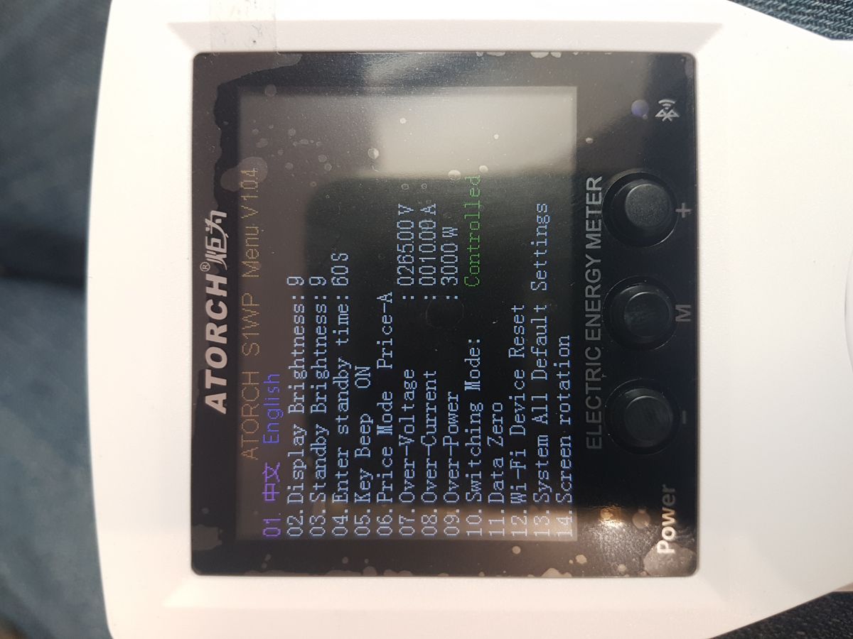

    Hi everyone,

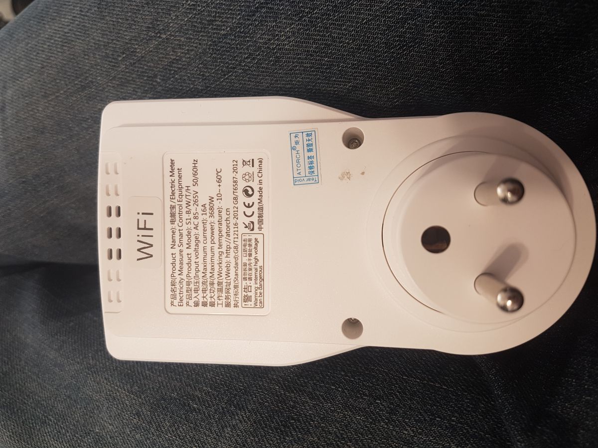

    I just received my new ATORCH Smart Socket Energy Monitor from AliExpress (https://www.aliexpress.com/item/1005005210540660.html).
    White smart energy socket with display and three buttons on a dark background.
    ATorch Smart Socket Energy Monitor with visible labels and European plug.
    Close-up view of the ATORCH Smart Socket Energy Monitor screen displaying the menu.
    The UI does look like almost similar to the ATORCH AT4P (https://www.elektroda.com/rtvforum/topic3941692.html)

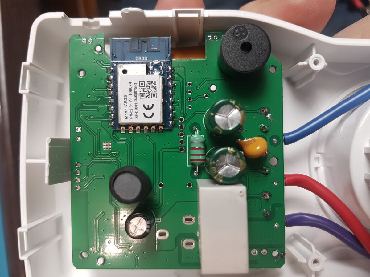

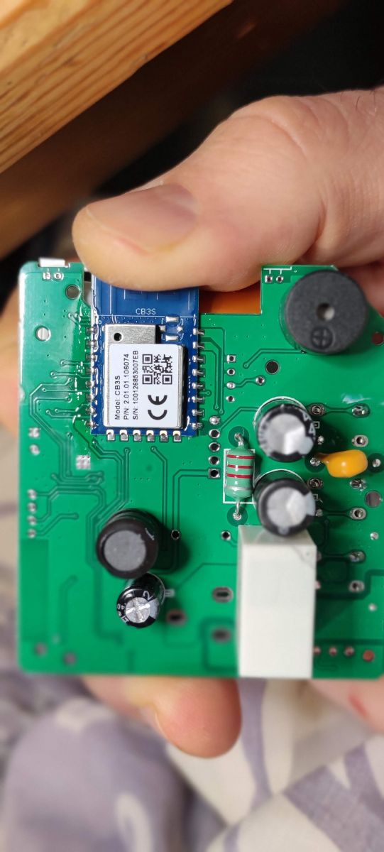

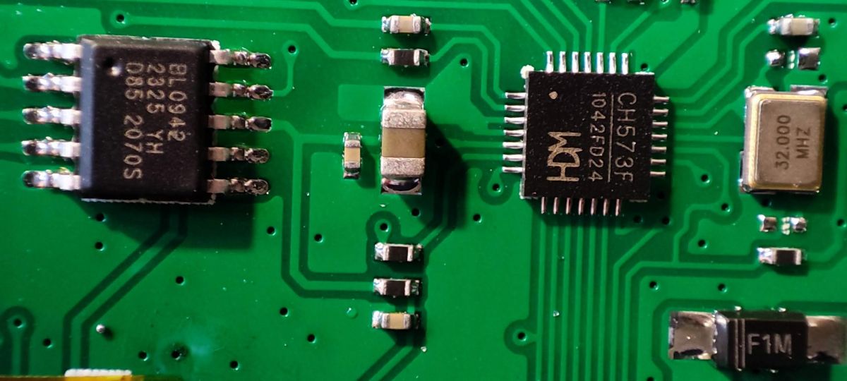

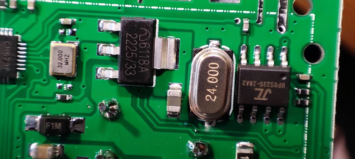

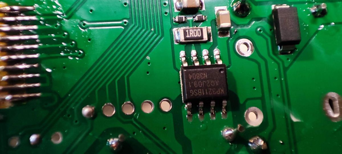

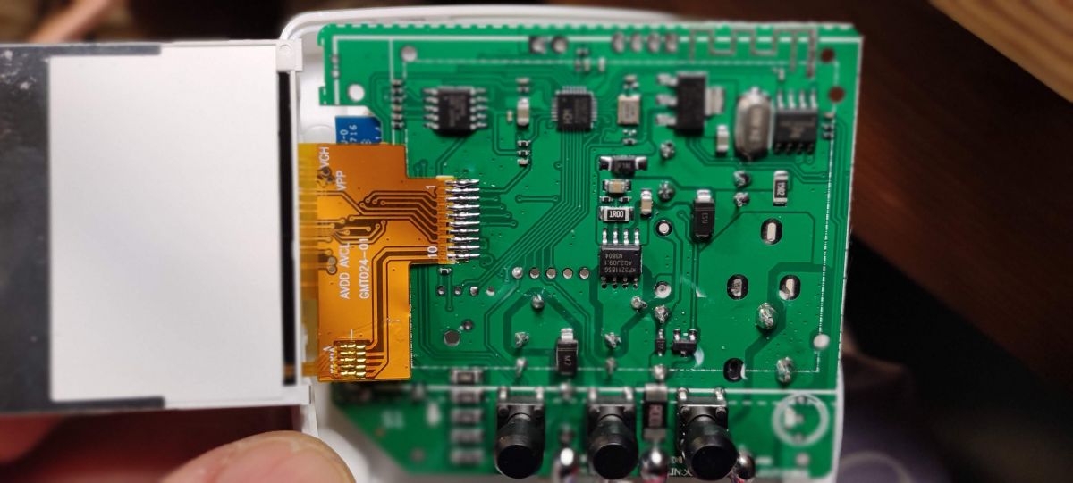

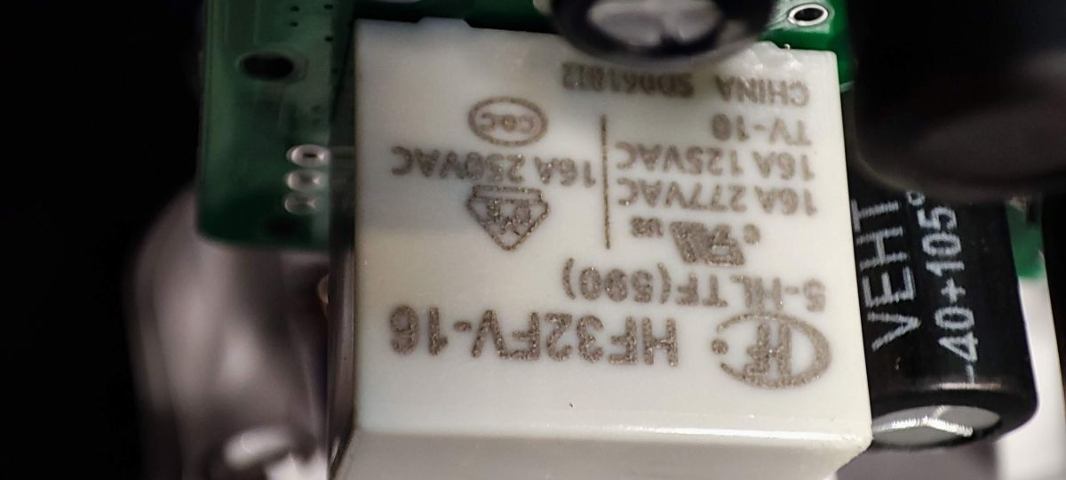

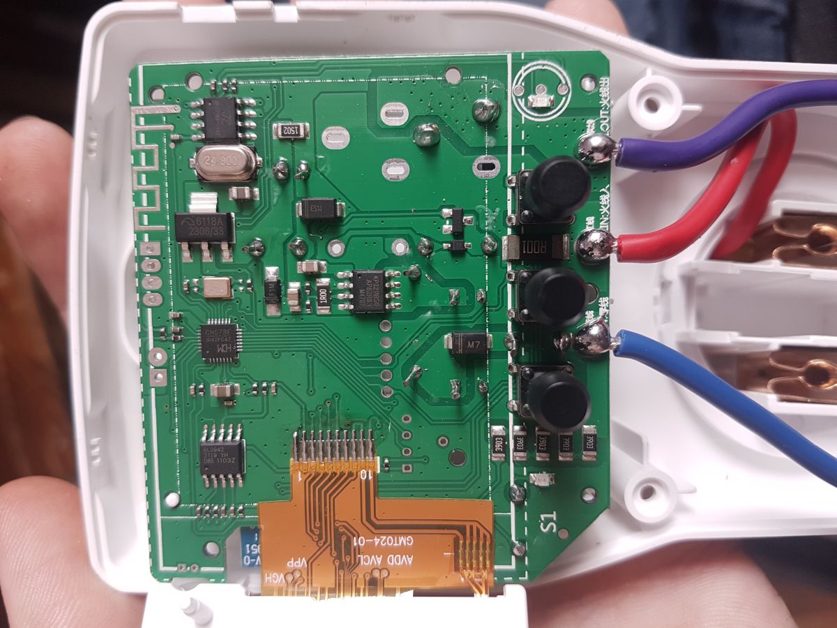

    I took it apart and the inside looks like this
    Interior of ATORCH Smart Socket Energy Monitor showing C3BS and CH573F chips.
    Interior of the ATORCH Smart Socket energy monitor with visible electronic components.

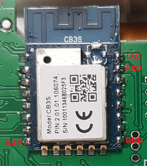

    The smart chip is a C3BS (BK7231N), the main logic chip is a CH573F, and the metering chip is a BL0942.

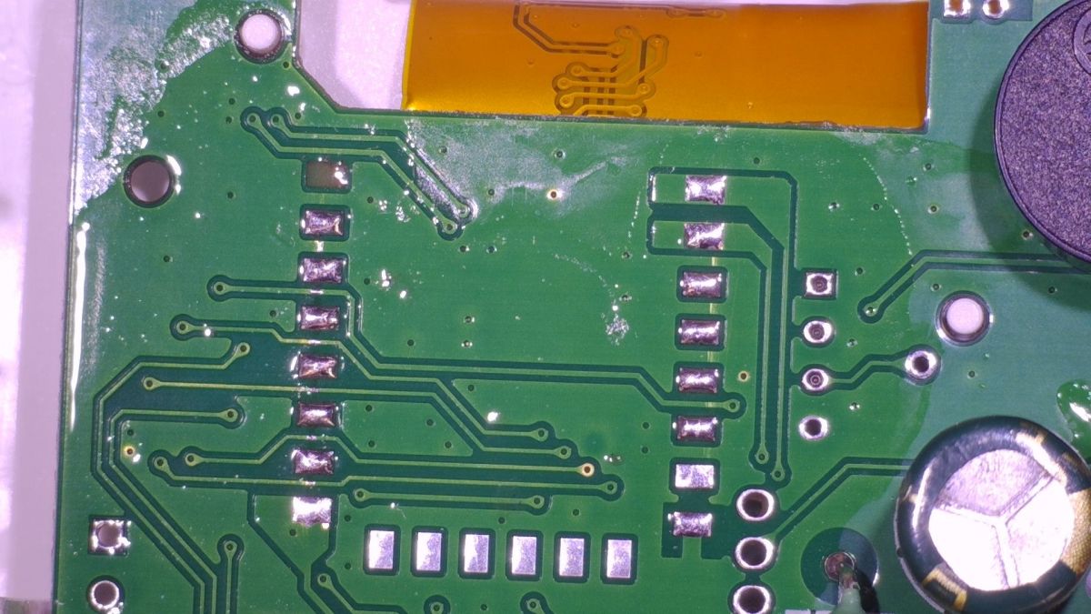

    The C3BS can be flashed with OpenBeken. I wasn't able to flash it when it was soldered on the board, but once I desoldered it, it was fine. However, beware of the pads not connected to anything, they do rip apart very easily (but since they're useless, who cares)
    Close-up of a circuit board with visible traces and soldered components. Circuit board with mounted CB3S module and labeled pins.

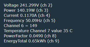

    I've reused the openbk autoexec.bat from the AT4P (since the modules are from the same manufacturer and they're very similar) and it kind of works, but there are only two small issues:

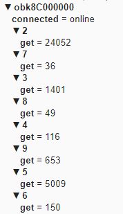

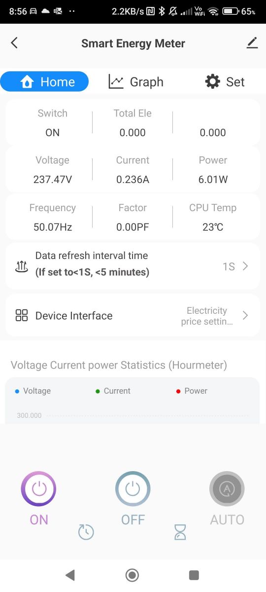

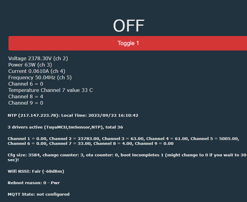

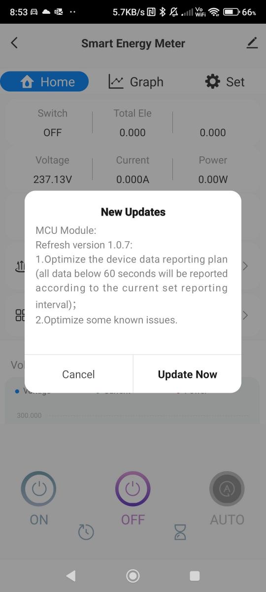

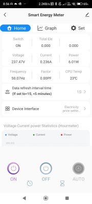

    Display screen of the ATORCH energy monitor with incorrect voltage readings.
    The voltage is a bit broken, it reads 10x higher (2378.80v instead of 237.83v), and the relay button doesn't work.
    I don't have the time to look further now, but I will provide updates when I find the time to do it.
    If you have any ideas or tips to fix it, feel free to write a comment!

    Hello, can you post the current autoexec.bat so we can work from there?

    tmSensor is most likely not needed, who put that here? Please link to original post, I will edit that as well.
    If voltage is ten times too high, change:
    Voltage_div10
    to
    Voltage_div100

    I've upgraded OpenBeken to version 1.17.251 but I don't think the Voltage_div100 was merged in this build.
    Also, I've got some news:
    On Channel 1, the toggle button doesn't act on the relay when pressed, but the state of the button does change when I toggle the relay on the device itself.
    On Channel 3, the power (watts) is also reading 10x too high with Power_div10, and Power_div100 doesn't exist.
    On Channel 6, I can't find any field for energy cost, if in the future such a field exists, it should be EnergyCost_div1000 for this device.
    On Channel 8, The PowerFactor is reading 10x too low with PowerFactor_div1000, and PowerFactor_div100 doesn't exist.

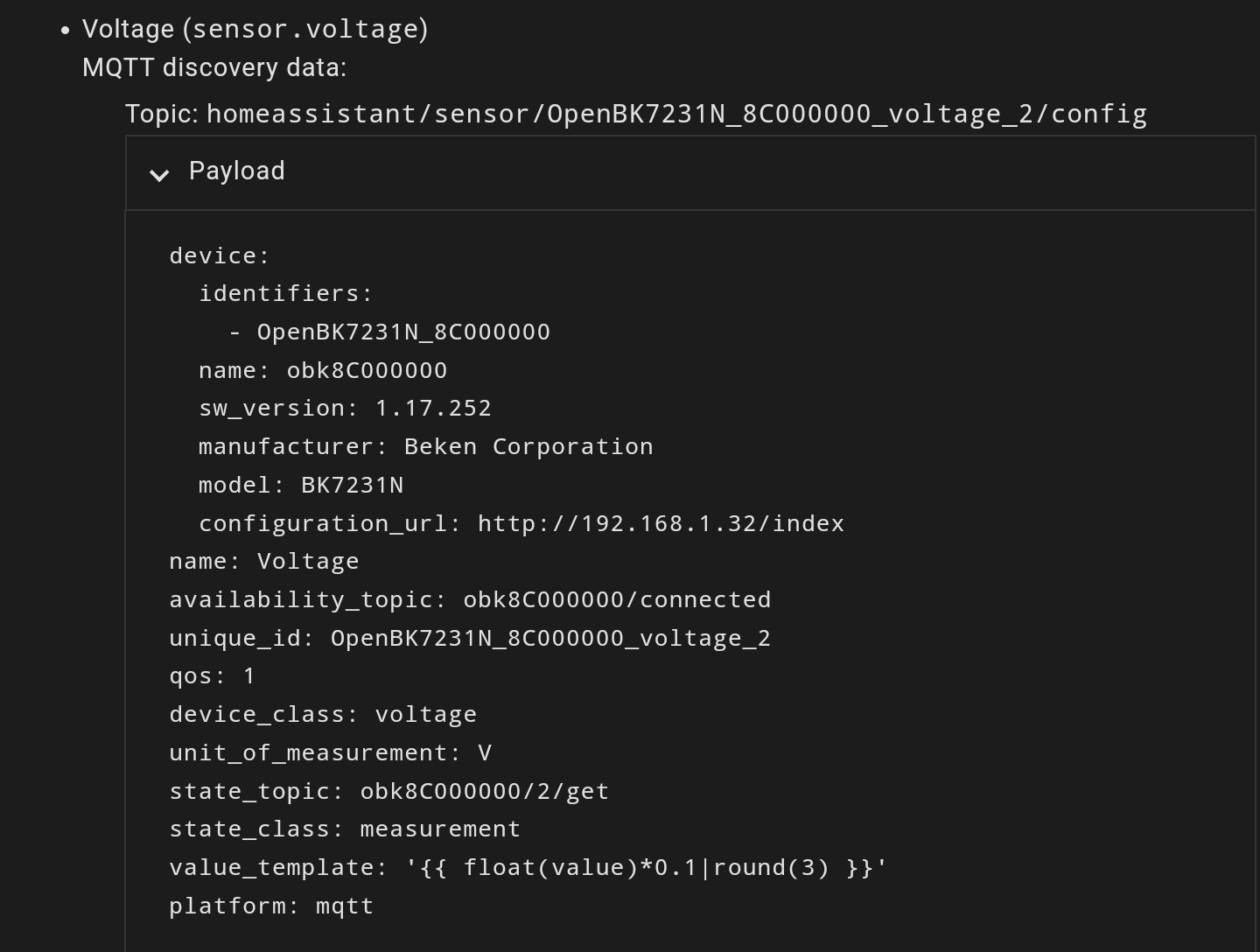

  • #11 20744877
    maximesharp
    Posts: 13
    Thanks a lot for your work.

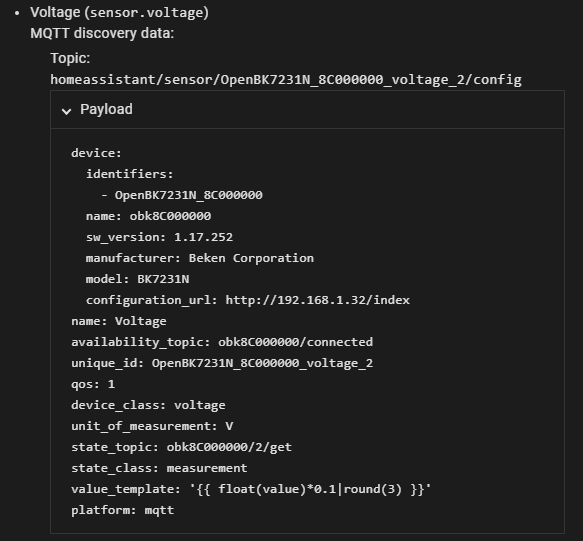

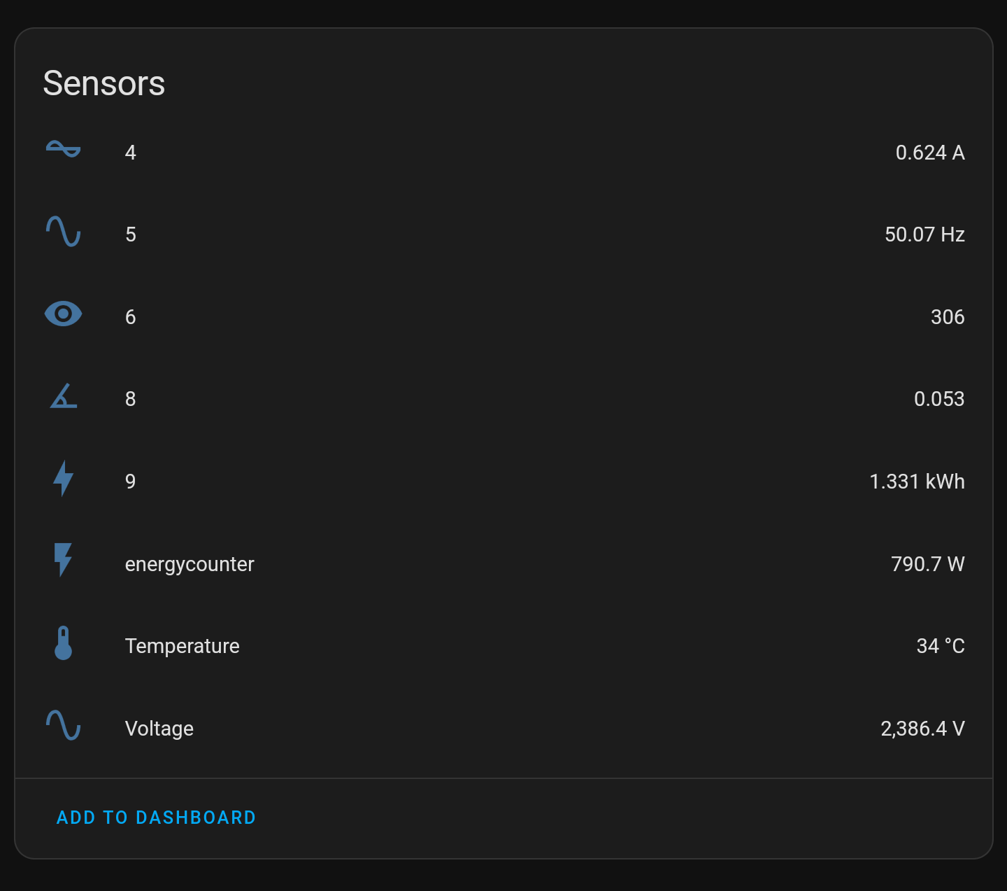

    I've flashed version 1.17.252, it does fix the issue on the device itself but the HASS template is still broken
    Screenshot of the ATORCH S1-B/W/T/H device measurement interface. MQTT configuration interface for OpenBK7231N voltage sensor, showing configuration details. Screenshot with parameter values of device obk8C000000 when connected.Screenshot displaying electrical parameters of a device.
  • #12 20744901
    Posts: 14770
    Rate: 12913
    I think that you just need to redo the HASS discovery so the new change is send correctly to HA. Please try and confirm
  • #13 20745050
    maximesharp
    Posts: 13
    I've already tried it, but it does not send the correct configuration payload.
    Screenshot of a sensor panel with various readings. Screenshot of MQTT configuration for the OpenBK7231N device, showing voltage data.
  • #14 20745067

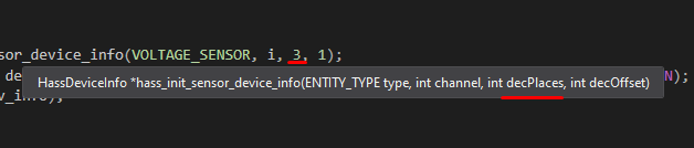

    Posts: 14770
    Rate: 12913
    Sorry, I must have confused number of dec places with dec offset, I will push a fix now.\
    Screenshot of programming code with a highlighted segment and tooltip.

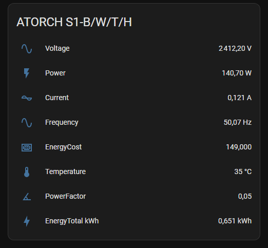

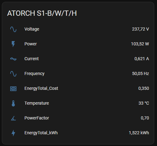

    It's working fine now, yesterday I tried to edit the HASS Payload part but I wasn't able to find which one of the two values was the dec offset or dec places (and Visual Studio wasn't giving me the hint).
    I've modified the fw to display the value correctly on HASS, so if it can help you, here's the code:

    Panel displaying electrical parameters of the ATORCH S1-B/W/T/H device.

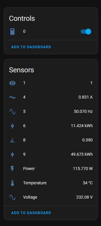

  • Working OpenBK channel mapping and NTP setup

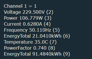

    #16 20910128
    maximesharp
    Posts: 13
    Big thanks for your work.
    Just seen that Power_div100 has been added yesterday with OpenBK 1.17.406 (and PowerFactor_div100 back in December 16).
    I've updated my device to the latest release, everything works fine.
    Still missing a channel type for energy total cost, but using EnergyTotal_kWh_div1000 will work for now.
    Also, is there a setting for NTP daylight saving?
    Here's my current working autoexec.bat for the device:

  • dpId 131 controls relay on/off mode
    #17 20919583
    Ggaljoen
    Thank you for this device integration, I love IT.
    Took my time to figure out the rest of the dpId meaning; main goal was to switch on/off, managed to get this done with dpId 131 enum(4) 0 = ON, 1 = off, 2 = auto
    dpId 1 is more like a STATUS display ("wake" function I wrongly thought) <= corrected on previous comment
    How can this be configured right the "Enum(4)" entity? Got now a dirty work around going.
    List of discovered dpIds:
      1 bool(1)	power relay indicator 	0 = off, 1 = ON
      9 val(2)	mode AUTO ?		0 = active ?
    101 val(2)	factor ?		100 _div100 factor ???
    102 val(2)	???
    104 val(2)	OVP 			xxxx V _div10
    105 val(2)	OCP			xxxx A _div100
    106 val(2)	OPP			xxxx W
    107 Enum(4)	set language		0 = Chinese, 1 = English
    108 val(2)	set Brightness		1 - 9, dark - bright
    109 val(2)	set Brightn standby	1 - 9, dark - bright
    110 val(2)	Standby time		3 - 99, seconds
    111 bool(1)	key beep		0 = off, 1 = ON
    112 Enum(4)	Switch Mode		0 = Controlled, 1 Normally Open
    113 bool(1)	Data Zero		1 = reset
    114 bool(1)	Wifi Reset		1 = active (not tested)
    115 bool(1)	System All Defaults 	1 = active
    116 bool(1)	Screen Rotate		1 = active
    117 Enum(4)	Standby screen		0 = Original, 1 = Measurement
    118 Enum(4)	Device Interface	0 - 7, Security Protect, Electricity price, Smart Power Off /B, Timing CutOff/On/Cycle/CountDown
    119 val(2)	Power low A		xxxx W
    120 val(2)	Time to Last A		xxxx minutes
    121 val(2)	Power over		xxxx W
    122 val(2)	Time to Last B		xxxx Hour
    124 val(2)	Timer value ?		xxxxx Seconds
    125 val(2)	CountDownTime(Coff)	xxxxx Seconds
    126 val(2)	Timer Set (ON)		xxxxx Seconds
    127 val(2)	Cycle - ON		xxxx Seconds
    128 val(2)	Cycle - off		xxxx Seconds
    129 val(2)	CountDown - ON		xxxx Seconds
    130 val(2)	???
    131 Enum(4)	relay			0 = ON, 1 = off, 2 = auto
    132 Enum(4)	???
    136 Enum(4)	Price Mode		0 = A, 1 = B, 3 = C
    137 val(2)	OV recovery delay	0 - 119 minutes
    138 Enum(4)	Power-up status		0 = ON, 1 = off, 2 = Memory
    139 Refresh	?home screen APP?	1 - 90 S  (If set to<1S,<5 minutes)

    #22 20919694
    maximesharp
    Posts: 13
    Ggaljoen wrote:
    How do I manage to have a selection between 0 / 1 / 2 for the 131 Enum?
    I'm just using the Toggle_Inv channel since "0 = ON, 1 = off, 2 = auto", by sending 0 or 1 we can close or open the relay.
    I don't know what "Auto" should do, but I've tried with the "OffDimBright" (send 0, 1 or 2), 0 and 1 does switch the relay but 2 doesn't do anything.
    For HA, you may need to delete the device and use the "Start Home Assistant Discovery" button on the webui of the device, but it does work.
    User interface with a control panel and sensors displaying electrical parameters.
    isn't there already a channel type for that? If not, I can add one, it seems like a very common requirement
    They're a few that send the required 0,1,2 like "OffDimBright' or "LowMidHigh", but nothing for "OnOffAuto".
    As I wrote, Auto (2) didn't do anything here.

    For those who fear removing the CB3S module, a small suggestion: you don't need to desolder the WiFi module.
    Instead, I used a USB to serial that is capable of powering the 3V3 line with enough current (to start up the unit completely), and then you can program the CB3S without removing it.
    Just be sure NOT to plug it into a wall socket at the same time while programming.

    hwti
    Ggaljoen wrote:
    For those who fear removing the CB3S module, a small suggestion: you don't need to desolder the WiFi module. Instead, I used a USB to serial that is capable of powering the 3V3 line with enough current (to start up the unit completely), and then you can program the CB3S without removing it.
    For me, even with a dedicated 3.3V supply, it didn't work with a CH343P USB-serial (firmware backup was always interrupted), but it worked with a CP2102 one.
    Maybe it also needs the ability to drive the UART pin with enough current to avoid issues with the MCU trying to send data to the CB3S module.
    I added the "tuyaMcu_defWiFiState 4" to bypass the Tuya pairing screen, else I had to press the + key on each boot.

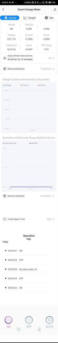

    What was the resolution shown in Tuya app?
  • Tuya app shows CPU temperature reading
    #28 20945733
    Posts: 5220
    Help: 449
    Rate: 918
    Screenshot of the Smart Energy Meter app showing voltage, current, power, frequency, and CPU temperature data.
    by coincidence my S1 arrived last week. I've only just opened it up.
    Printed circuit board with visible components and CB3S module. Close-up of a green circuit board with several electronic components and a connected ribbon cable. Close-up of a circuit board with various electronic components. Close-up image of an electronic circuit board with visible components. Close-up of a circuit board with visible SMD components, including integrated circuits and a quartz crystal resonator. Close-up of an electronic component S1 with manufacturing markings. Smart Energy Meter app screen with a notification about a new update version 1.0.7. Screenshot of device firmware update. Smart Energy Meter app screen displaying voltage, current, power, and CPU temperature data.
    cool device. initially quite impressed.
    Added after 9 [minutes]:
    also, the app shows a CPU temperature. Is this something that could be added to OBK for all Beken devices, like the LN temp?
    Screenshot with technical information about the OpenLN882H_C25E1088 device.

    maximesharp
    Posts: 13
    I can't relate to what he said about both the power resolution and the additional line to bypass the pairing screen.
    Using the latest firmware (1.17.450) and my latest autoexec.bat, I don't have any issue with the power resolution and the pairing screen disappears once the device is connected to the Wi-Fi network.
    Data displayed on a screen with values for voltage, power, current, frequency, energy, temperature, power factor, and total energy.
    (Note that channel 6 is set on kWh but should be in currency)
