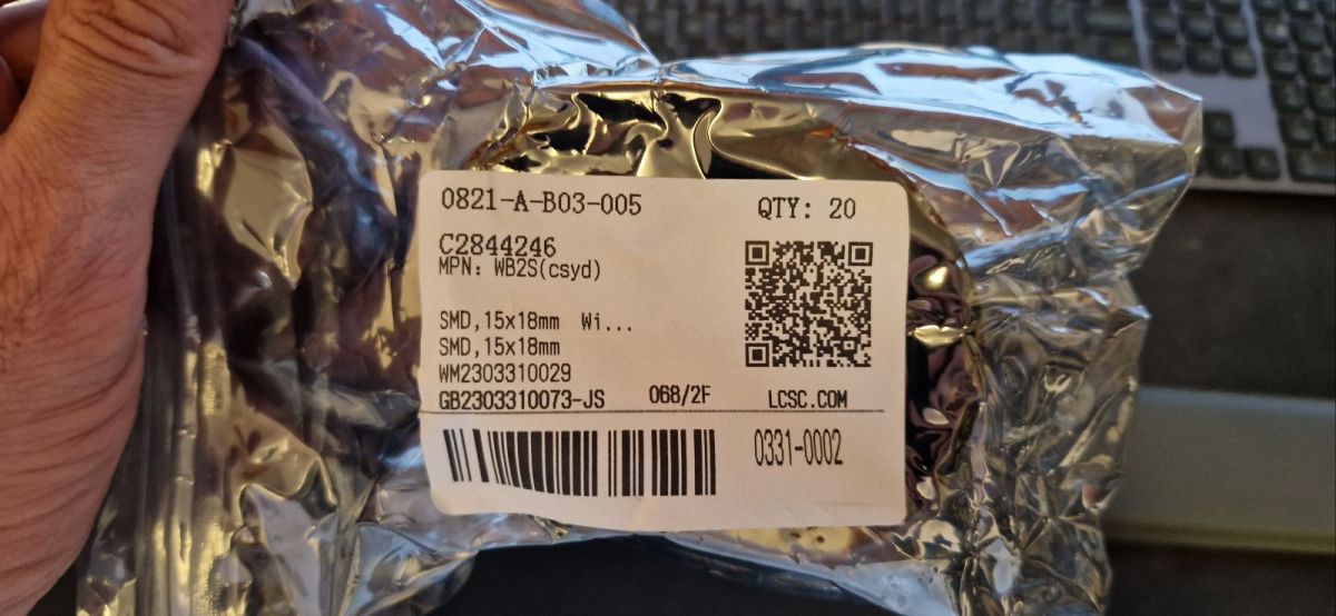

    We've been recently looking for a way to buy brand new Tuya modules, especially CB3S/CB2S (BK7231N) and WB2S (BK7231T). BK7231N is a bit newer and has more advanced support in OpenBeken (deep sleep and WS2812B), so it was our primary focus. Here I will write down our experience.

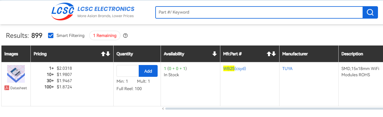

    Our modules were ordered from a Chinese reseller, the unit price is about 2% per piece, we weren't sure whether they are reused or resold by Tuya, so we decided to make some tests.
    First module we'll test is WB2S:
    Screenshot of a webpage showing search results for WiFi modules on LCSC Electronics.
    Photo of a hand holding a package of WB2S modules with a visible label.

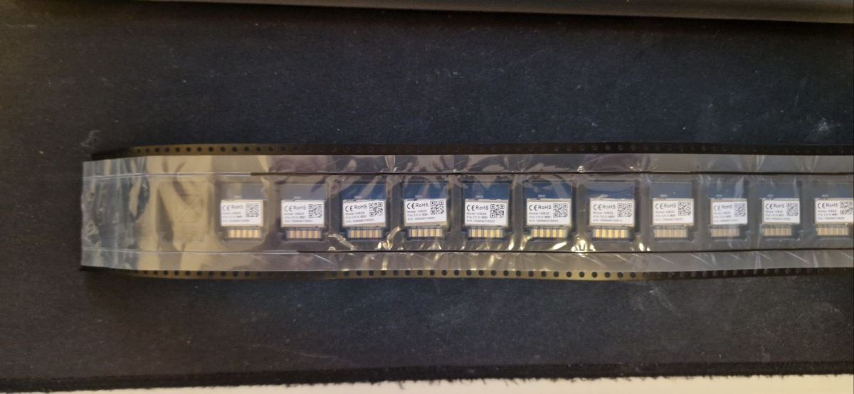

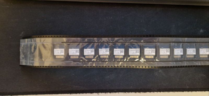

    It comes in a nice strip form:
    A strip of WB2S electronic modules packaged in plastic shields.

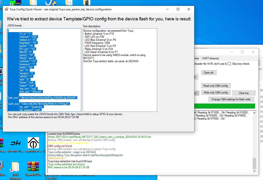

    We've checked the flash content with out flasher:
    Suprisingly, something is there:
    Screenshot of Tuya Config Quick Viewer with extracted GPIO configuration.
    This device already contains a SmartLife flash dedicated for something that looks like a RGB lamp with extra Relay, Button and WiFi LED. It even has specified PWM frequency. It must have been dedicated to run in some smart device...

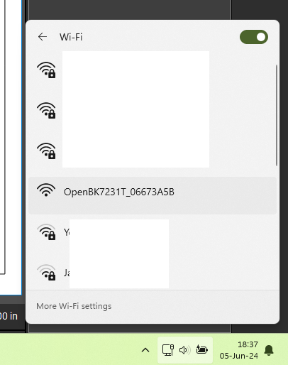

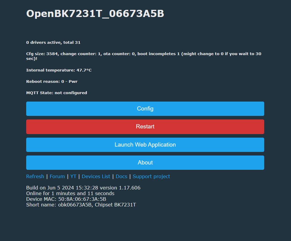

    Then we also flashed OBK:
    OBK access point shows up correctly:
    List of available Wi-Fi networks on a computer screen with the OpenBK7231T network highlighted.

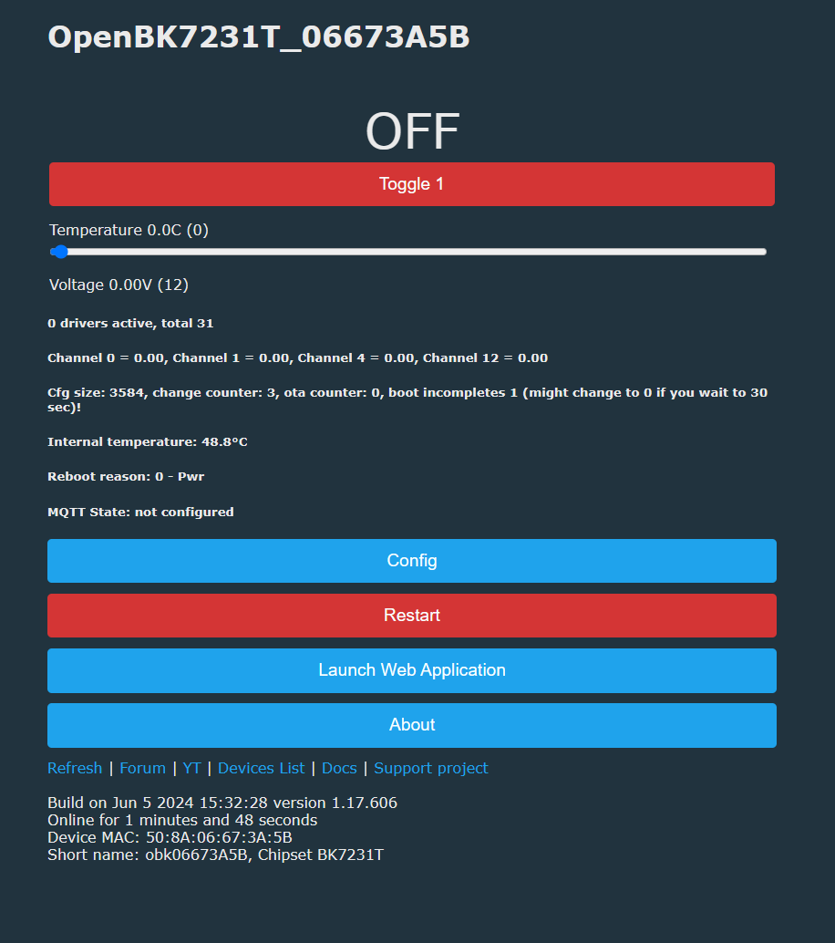

    And it's possible to configure OBK easily:
    Screenshot of the OpenBK7231T interface with configuration buttons.
    OpenBK7231T interface displaying device status.

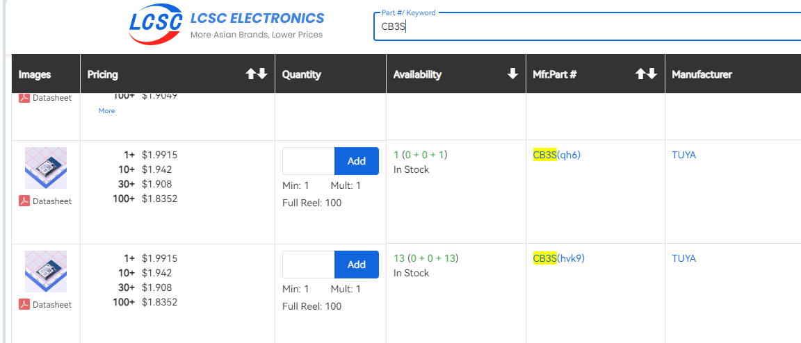

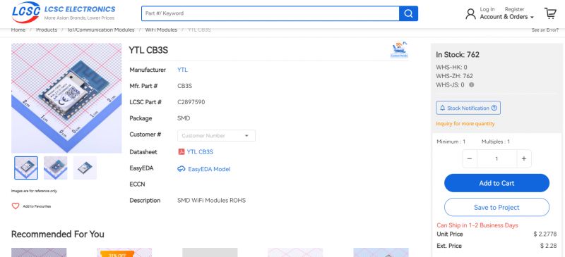

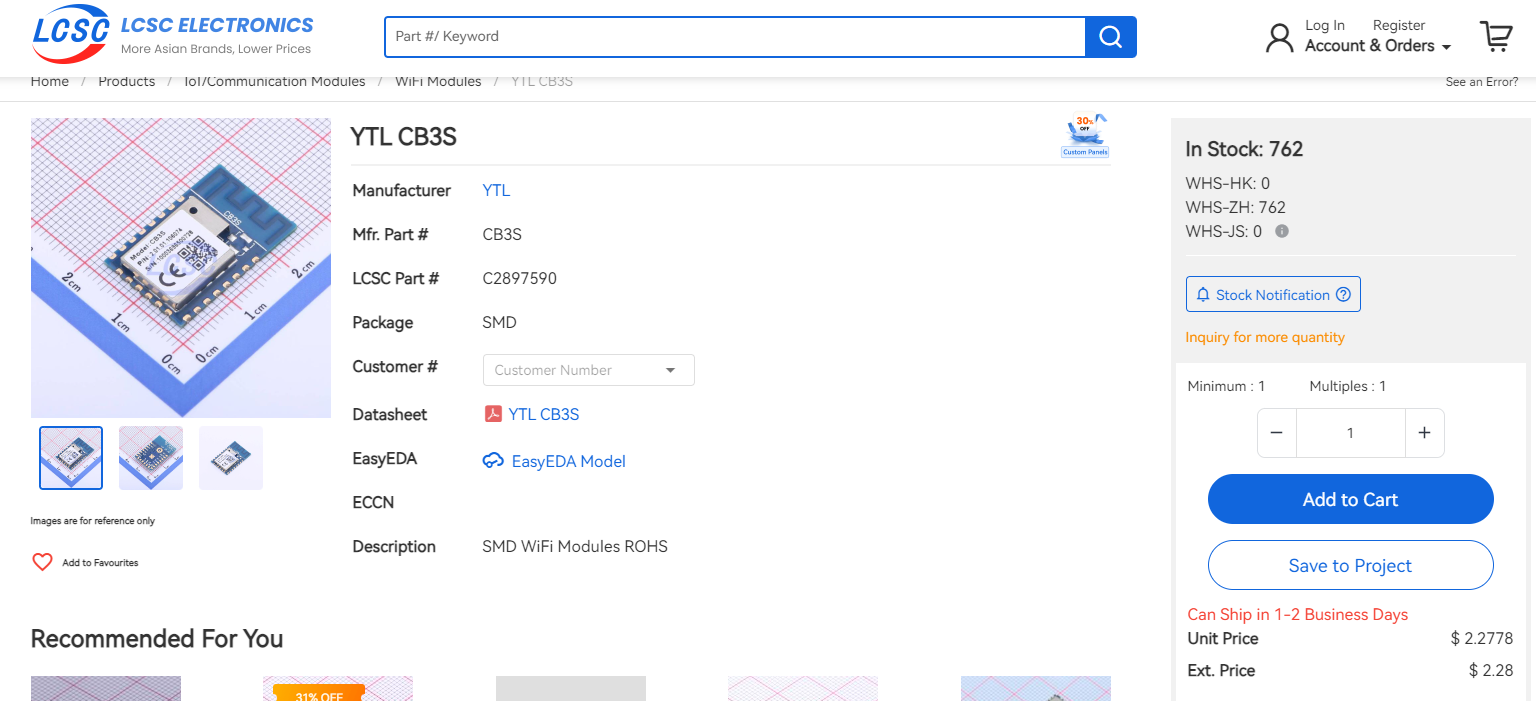

    Second module we'll test is CB3S:
    Screenshot of LCSC Electronics showing prices and availability for CB3S modules from Tuya.
    Product image of the YTL CB3S module on the LCSC Electronics website.

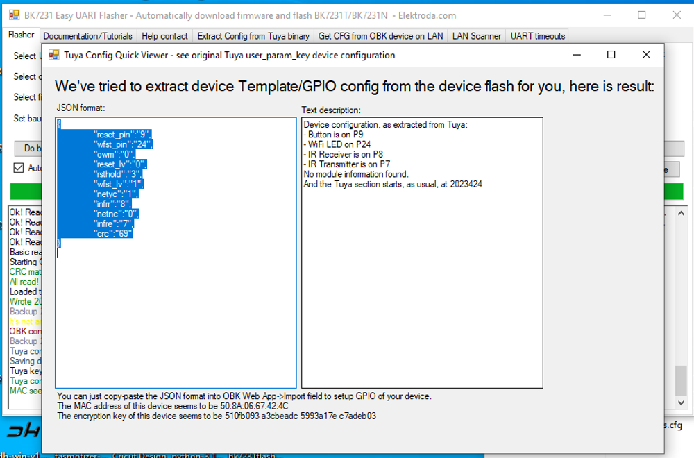

    There is again something in the config:
    The config specifies a reset pin (button) on P9, a WiFi LED and both IR receiver and IR transmitter. It seems that this device was a smart IR remote module/repeater that could receive, learn and send IR signals.

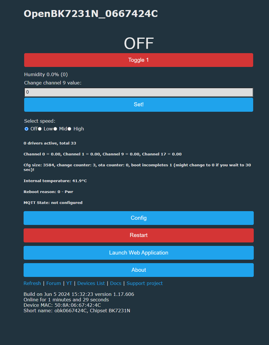

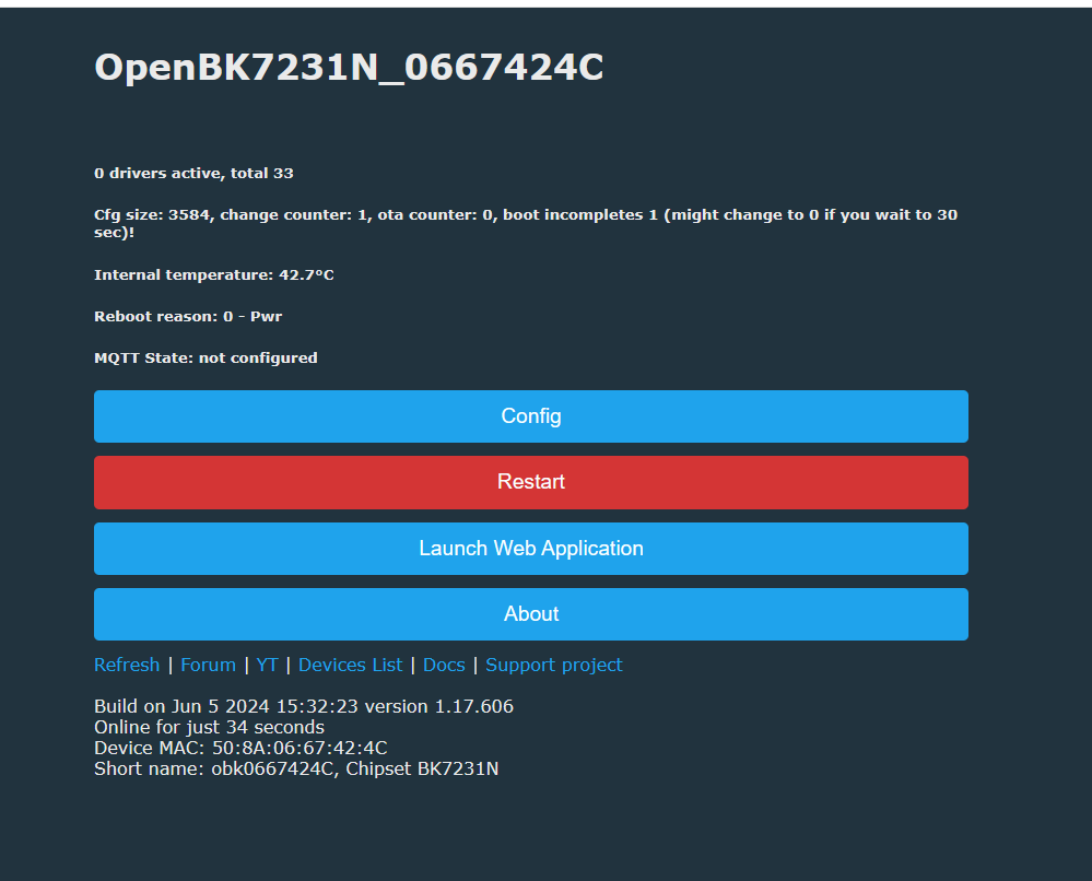

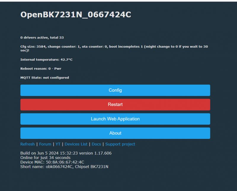

    Again, we've tried to flash OBK on that - no problems:
    User interface screen of OpenBK7231N displaying configuration details and management options.
    Screenshot of the OpenBK7231N user interface panel showing configuration options.

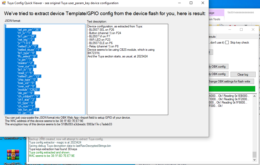

    Third module we'll test is CB2S:
    Screenshot of Tuya Config Quick Viewer showing device configuration in JSON format.
    This time modulke seems to be coming from a BL0937 smart socket. BL0937 pins are clearly visible in the config. There is a also a Button, a Relay and WiFi LED.

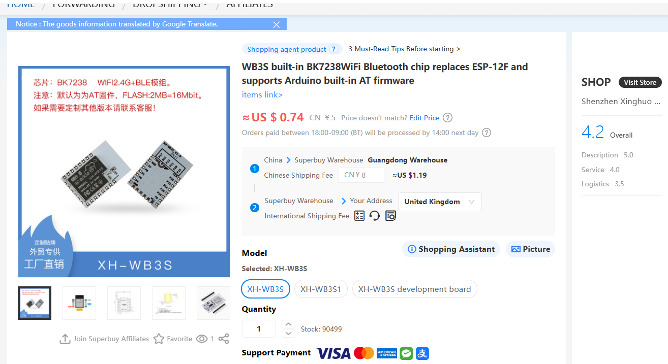

    I don't know much about bulk ordering modules. SparkleIoT have a 1688 store though and they sell the module from there https://detail.1688.com/offer/811437204979.html
    I've not bought from 1688 before, but I have used a shopping agent like superbuy.com to buy from Taobao/China. Postage from Superbuy warehouse to final destination is an additional cost to consider though

    WB3S actually probably works out best, at $1 each on ali.
