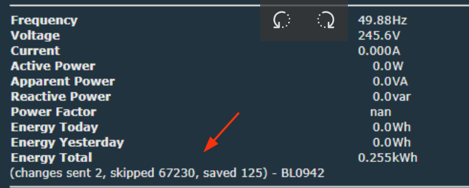

    I just flashed my first smart socket using a T34 and BL0937 with OpenBeken. 🎉 Had to fiddle a bit with the baud rate, but once that was sorted, everything went smoothly.
    After calibration, the socket is working well. However, I have a question regarding the BL0937 message output:
    Screenshot with energy data and BL0942 change counter statistics
    What do the terms "changes sent, skipped, and saved" actually mean? Are these related to MQTT messages? In my case, the skipped counter keeps increasing steadily, but I have no idea what it signifies. I couldn’t find any explanation in the GitHub documentation, wiki, or forum posts.
    Also, a newbie question: How can I reduce the output shown on the "main" page? Is that controlled via the log level settings?
    Thanks in advance!
    Best regards, Dirk

    This is related to stat_updatesSent variable in code https://github.com/search?q=repo%3Aopenshwpro...BK7231T_App%20changes%20skipped&type=code
    Long story short, the values are published via MQTT only if there is a change between reads or if given time interval between publishes passes.
    I don't remember the exact logic behind it, but it just reduces MQTT overheat, more or less.

    Thank you for clarification and the link to the code.
    That really helped to understand that message.
