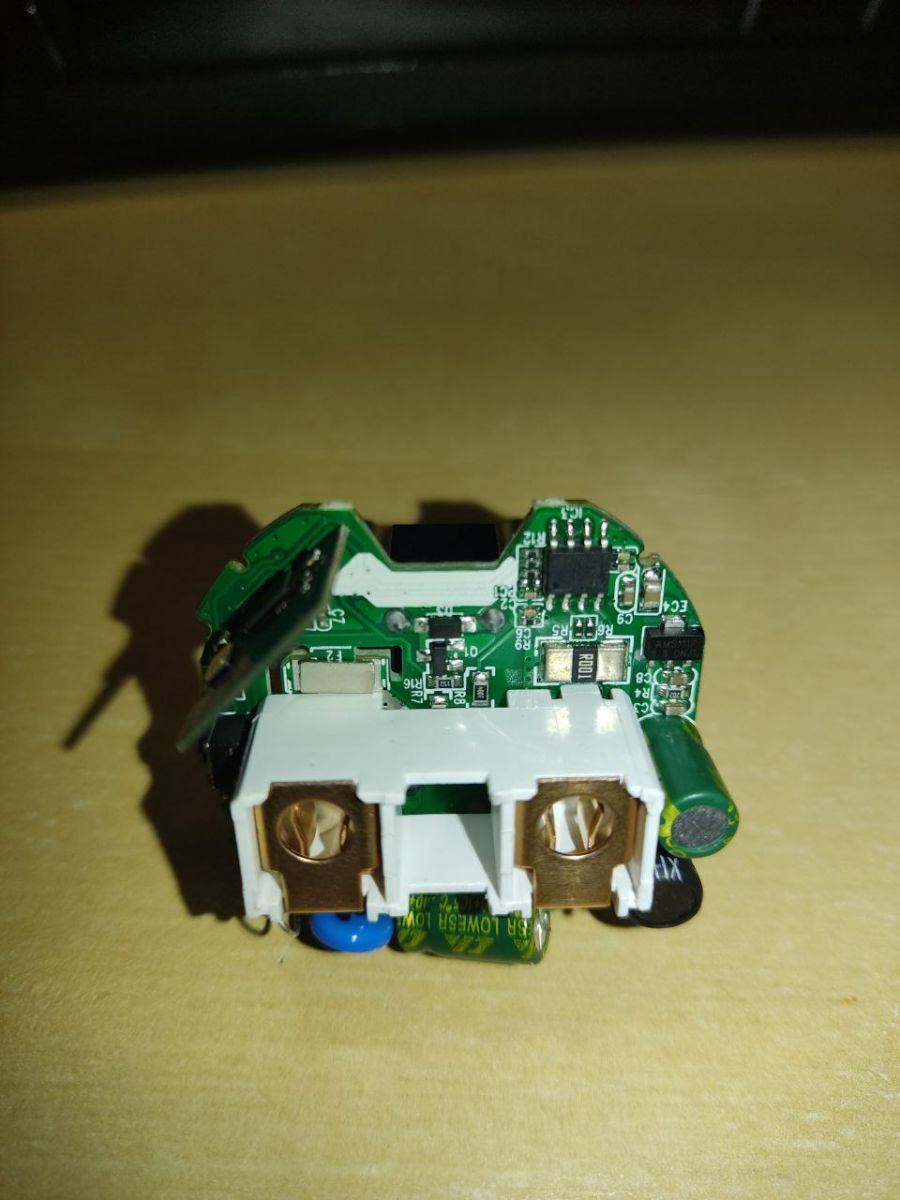

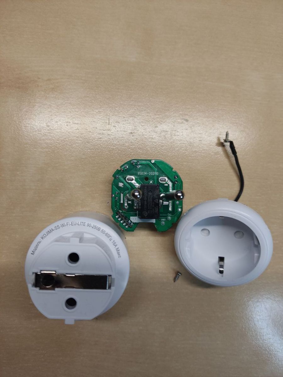

    Circuit board with labeled TX, RX, GND, and VCC pins, visible relay. Interior of an electronic module with visible soldered components. Disassembled smart plug with visible PCB and casing. CB2S module with a PCB and components

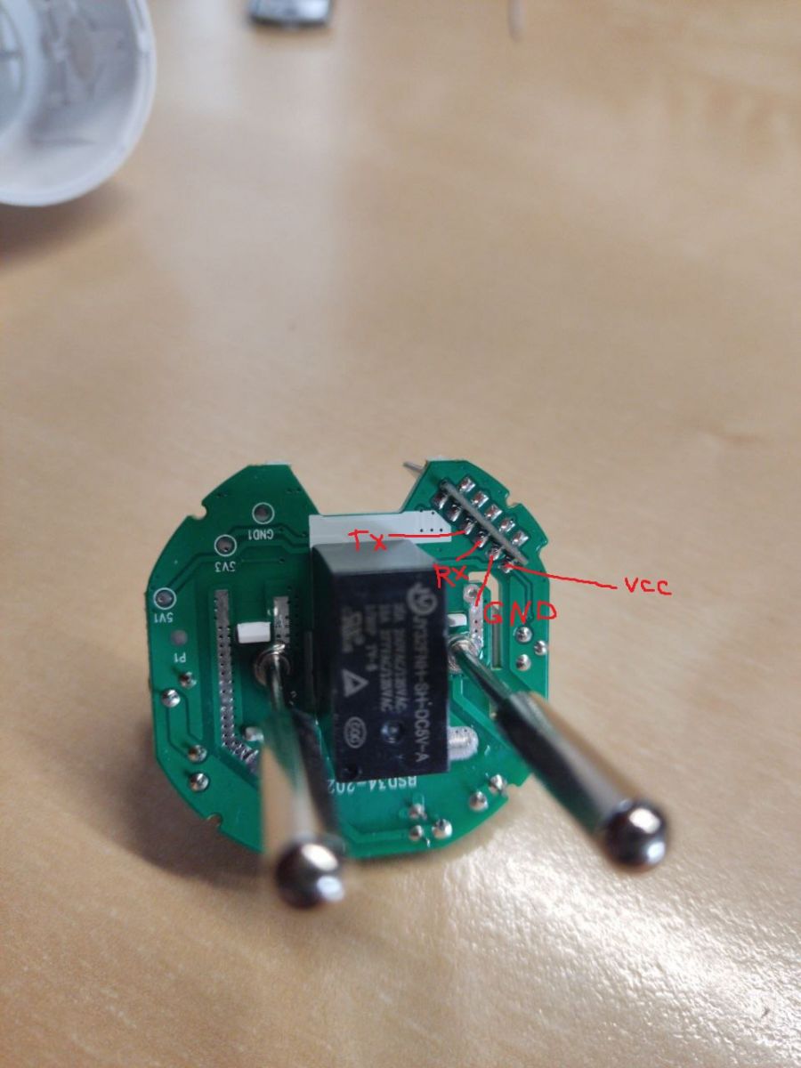

    Open up, solder pins and flash OpenBK7231N_QIO_1.17.306.bin with bk7231_flasher, baud 115200, others rates wont work.

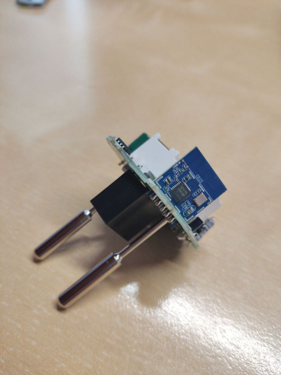

    Device seems to be using CB2S module, which is using BK7231N.

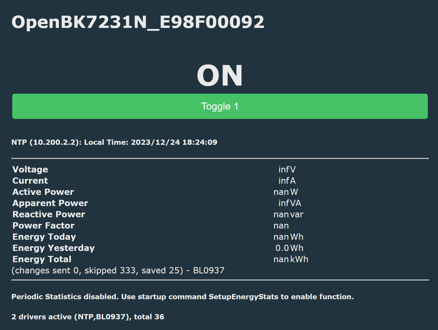

    Everything works, except power meter, which shows something firstly but after voltageset,currentset,powerset shows only inf.
    In logs
    Info:EnergyMeter:Power reading: inf exceeded MAX limit: 3680.000000, Last: nan

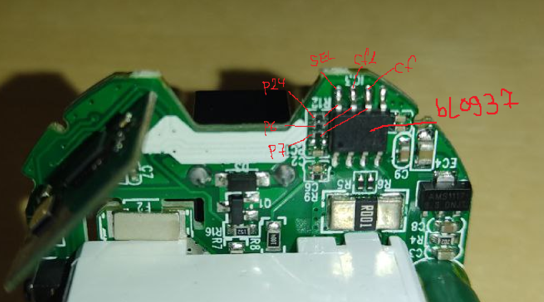

    I trace bl0937 pins via resistors to cb2s pins
    Printed circuit board with BL0937 chip and labeled pins.
    So pins cfg should be right.
    Please tell me where to look, I recheck my soldering twice

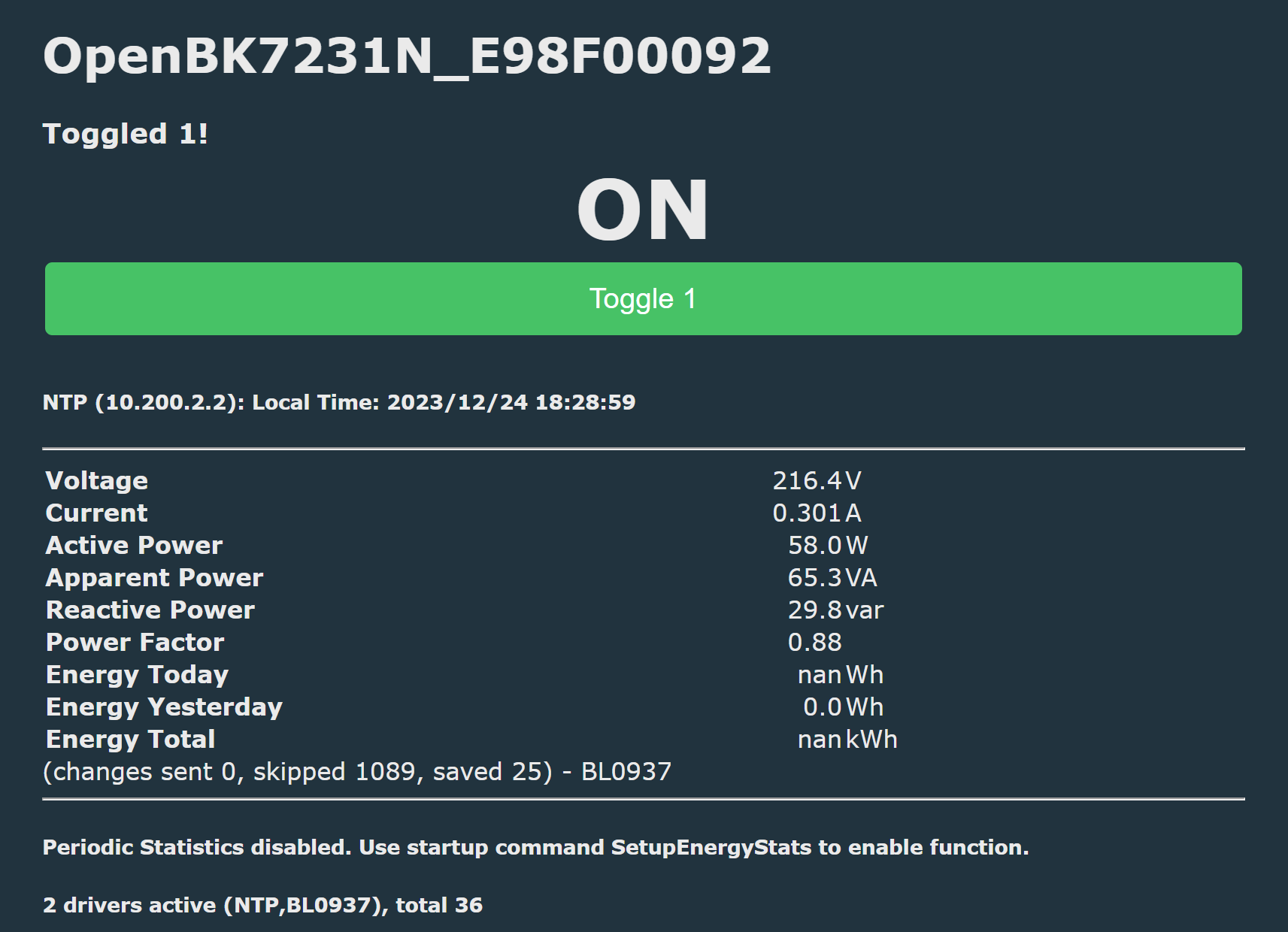

    Added after 4 [minutes]:
    Got it to work after PowerSet 50.00, maybe have issues cause put calibrations commands in autoexec.bat first. Don't know.
