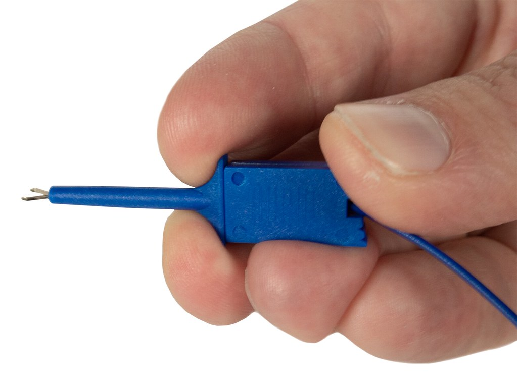

    Has anyone 3d printed some kind of pogo stick pin adapter that you can just press against the module solder pins during flashing?
    Not yet, depending on how the cb2s is positioned on the pcb, I'd just use this mini grabber clips to make contact

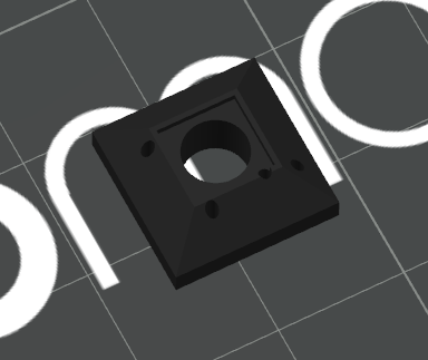

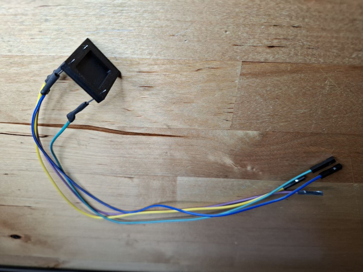

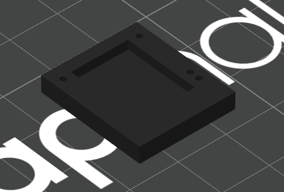

    I have 3D-printed adapters for the CB3S and T24 modules to press against them during flashing.
    Sorry, I have only just noticed that this is a 3-year-old topic. Please delete if preferred. Sorry.
  • #25 21804690
    Posts: 14395
    Help: 650
    Rate: 12317
    No problem, can you share more information about your adapters?
  • #26 21804826
    Dnomis77
    Posts: 18
    For CB2S
    Black rectangular enclosure with four holes and a central recess
    For T34
    Black plastic part with central hole and four smaller holes around it
    The holes are sized to take dressmaking pins to which I then soldered wires. Looks like this...

Is there an adapter to flash BK7231N without desoldering?
No printed pogo-pin jig is shared yet. Users succeed with mini grabber clips attached to module pads, avoiding full removal [Elektroda, ferbulous, post #20476218]
