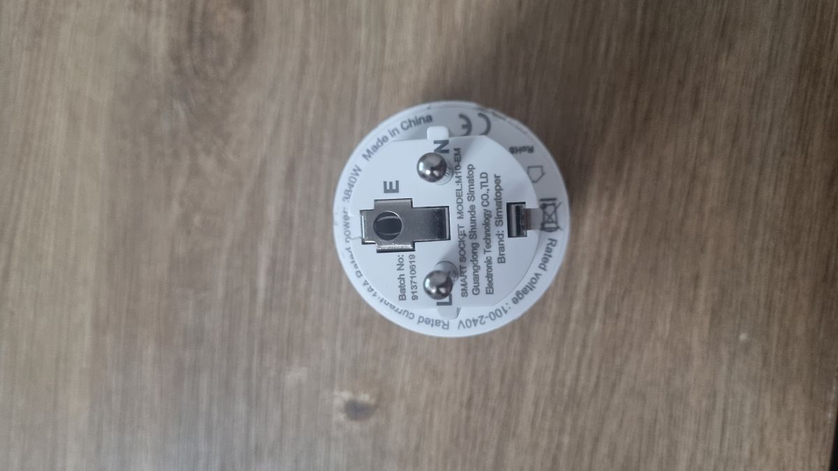

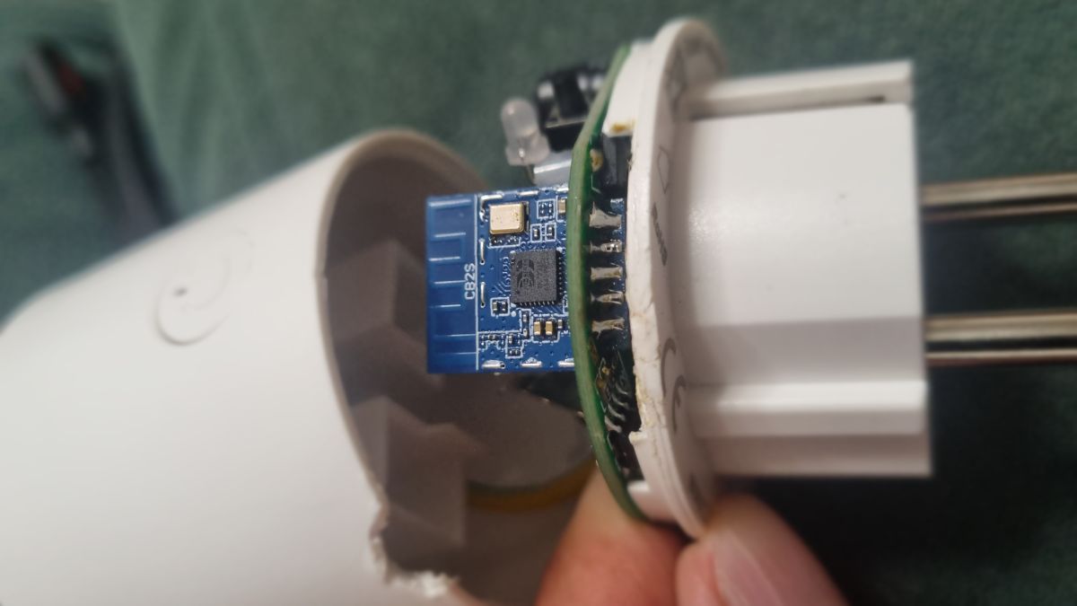

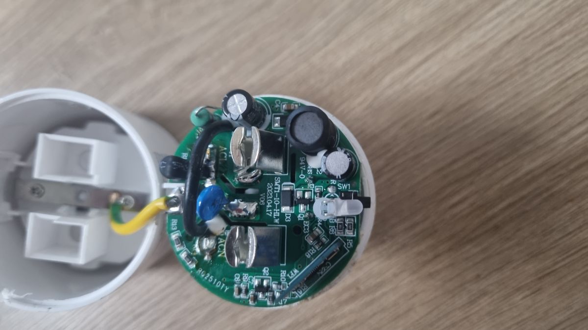

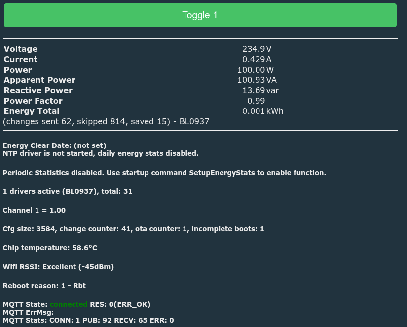

    Hi there,
    I flashed this socket to tasmota and calibrate the Voltage, Current and Power consumption. But now if I disconnect the load it still shows me 0.4A of current.
    Tasmota interface screen showing voltage, current, and energy stats
    With 100W lamp.

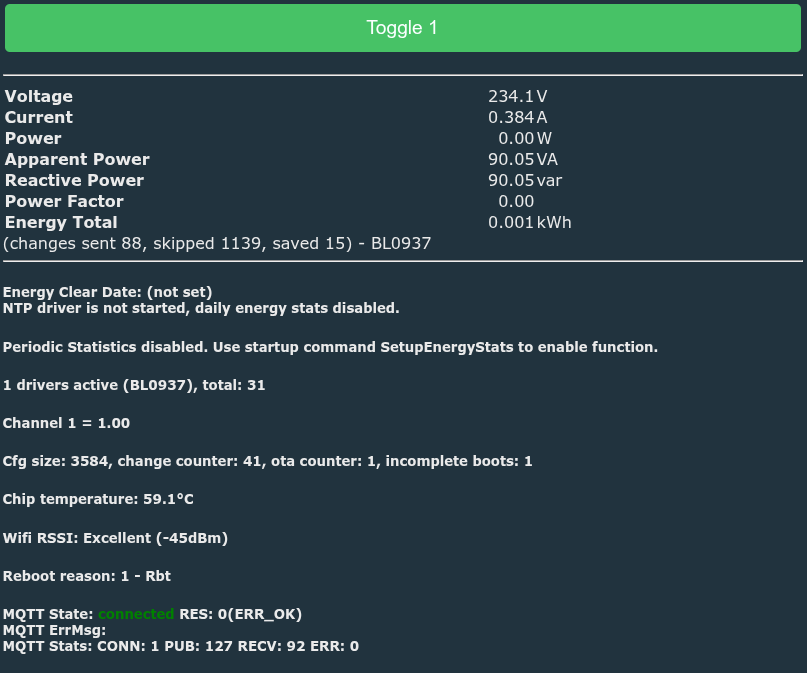

    Tasmota screen showing false current reading with no load connected
    No Load. The current, the apparent power and the reactive power are showing strange values.
    What I am doing wrong?
    Thanks.
  • #2 21636244
    Posts: 14767
    Rate: 12906
    This is a known issue with BL0937. You can try to mitigate by calibrating at lower load and by enabling flag to zero power when relay is open
    [Power] Set power and current to zero if all relays are open
    https://github.com/openshwprojects/OpenBK7231T_App/blob/main/docs/flags.md
